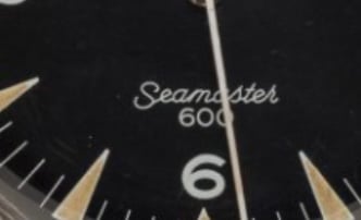

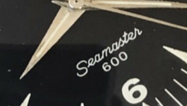

What can be said about the variance in font for seamaster or the S in seamaster ? I see two different S’s in my searches.

The “hanger” S (looks like a coat hanger), was used until around 1962, there was some overlap on a couple variants earlier in the transition. It should also be noted that the “m” in Seamaster also can vary with a slant entrance to the letter versus a hump. I always thought the slant was the tell tale of an original but I have seen others. There were different contractors that made the dials so there are a few slight variants, but they were very consistent.
A refinished dial was commonly done if the original dial was damaged from moisture ingress. Some were better than others, but any redial will affect collectibility. There are still excellent original examples out there, so it “being too clean” is not an indicator of a redial.
That’s said, there are several sellers on eBay who sell clearly refinished dials- some even stating as much with no intention of deception- and they can sell for insane money. If originality is important to you, then it’s important to know what they should look like. The devil is in the details.
