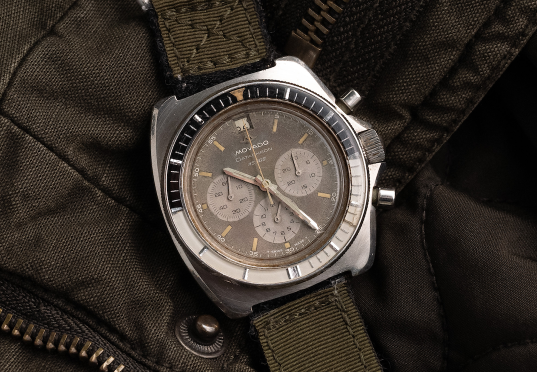

Short question: I thought the first Datachron labelled chronos were all without a turning bezel ? So, the Space one might be re cased later to serve better as a time measuring instrument? Any thoughts?
I wasn't aware that early Datachrons didn't have a turning bezel.
Based on a picture from Hodinkee of Carr's watch, the bezel is slightly askew, which indicates that his turned, as you also pointed out.
I have no facts regarding how Carr acquired his watch but i would expect that he purchased it off the shelf, as opposed to it being retooled for his special use. The Astronauts like Carr, Pogue, Conrad and Cooper wore their personal watches. They probably just went to the store like anyone. I don't think Movado was aware that their watch was being worn in space. By 1973 when this mission was flown, the mechanical movements made by Zenith-Movado were being shut down. It's hard to see the company modifying their watch. Unless you're thinking Carr had it done privately for his own use, which is possible. Hard to know as just the existence of his watch was a bit of a surprise itself.
I am guessing here but think it's more likely that if the early watches did not have turning bezels then some time later during the same reference the turning feature was added. Cleatly someone who knows more about Movado than I do needs to jump in.

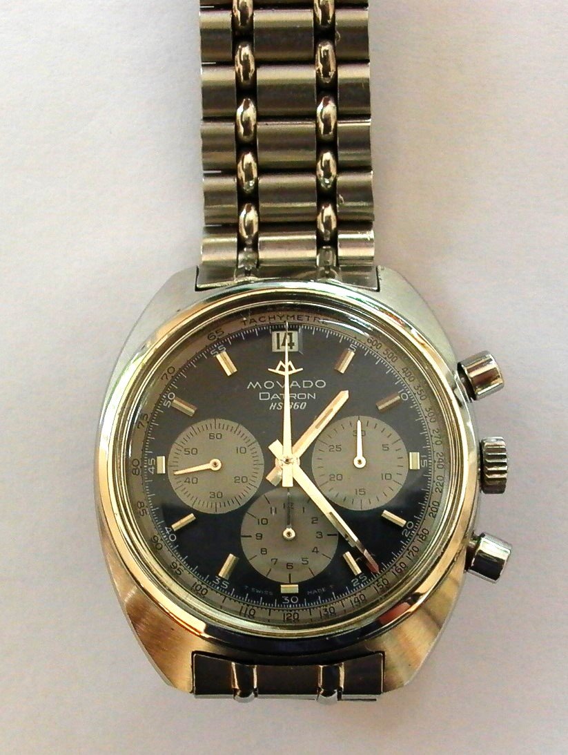

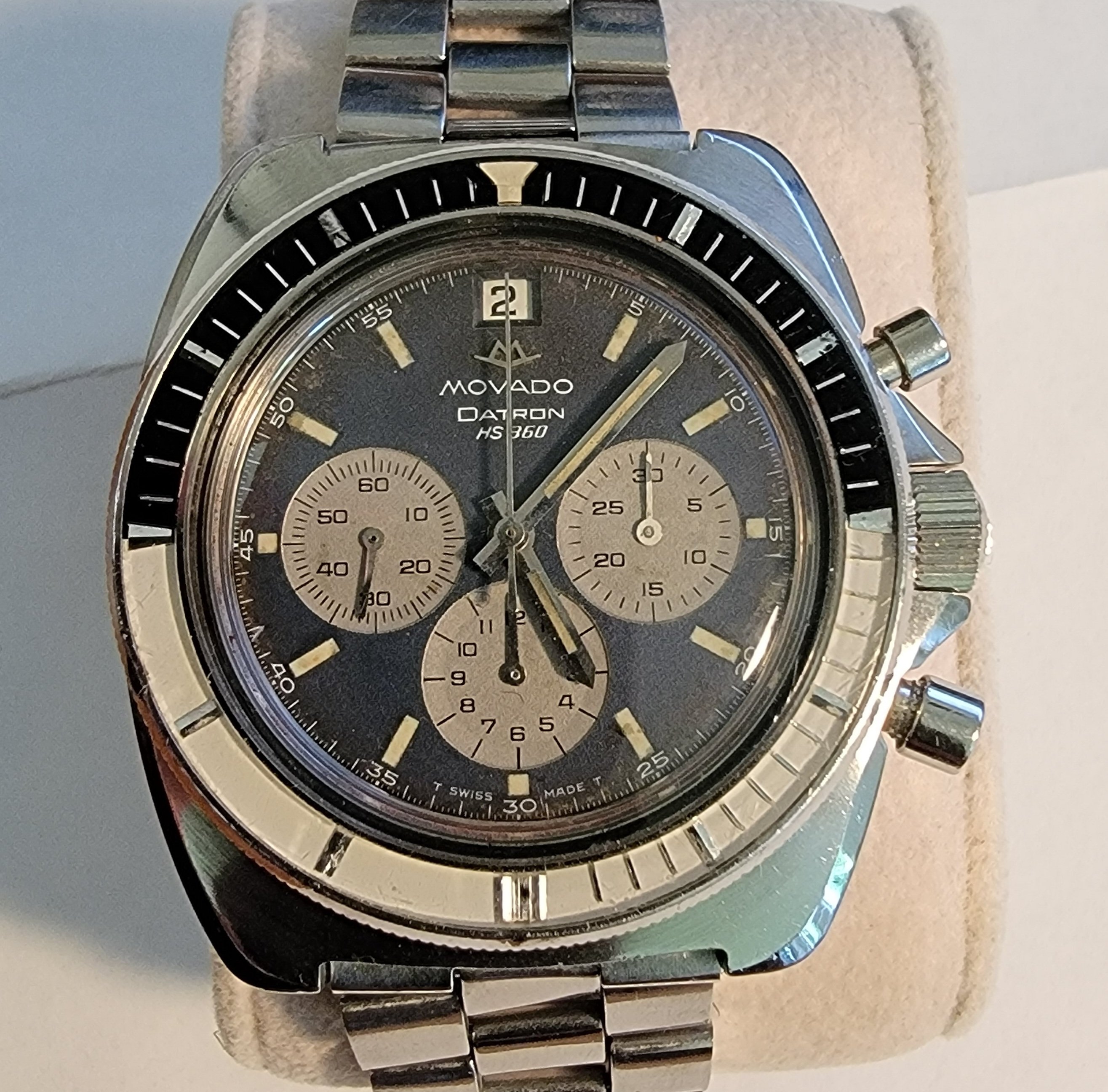

I tried to find a Datachron but couldn't. This blue dialed Datron was the closest I could get.

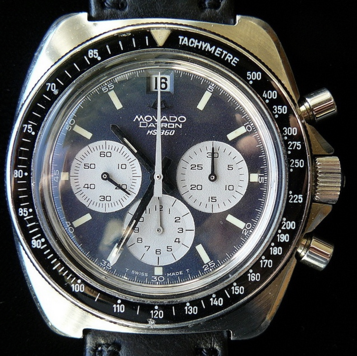

The only one I believe that did not have a rotating bezel was the reference that had the tachy on the bezel. But, it was a Datron not Datachron

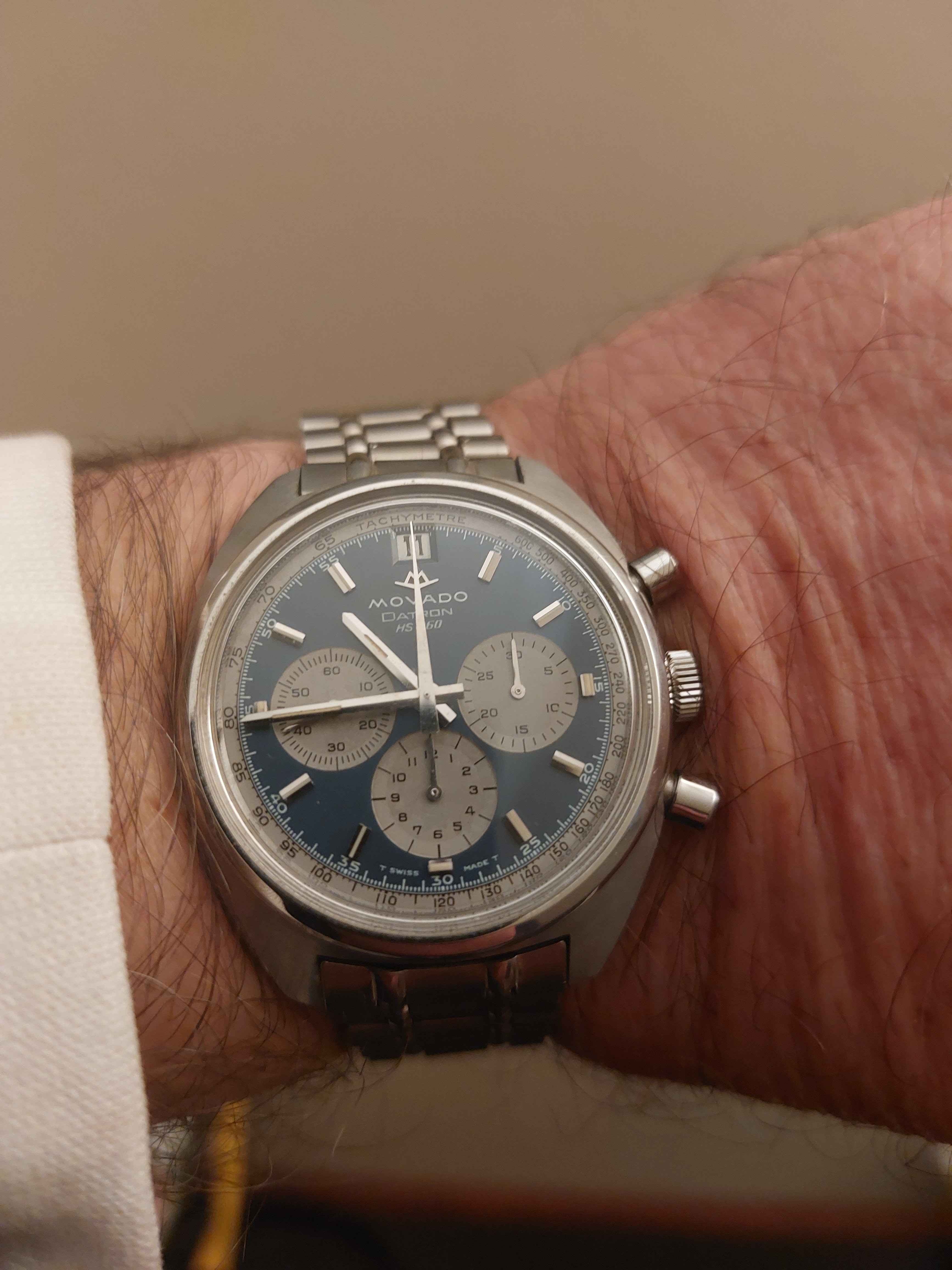

Here is my “Skylab Commander” Datachron Chronodiver:
The only advertisement I’ve seen for Datachrons is this one from the New Yorker (November 29, 1969). The Datachron was therefore available in 1969; this ad places the Datachron among the earliest examples of the El Primero.

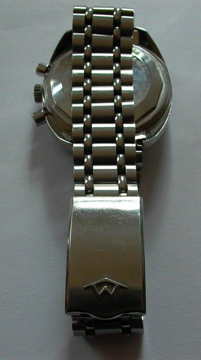

I have seen more than one of these Datachron/Datron Chronodivers on a GF ladder bracelet dated first quarter of 1969 and stamped with the reference number (138 705 501) of its dive watch twin, the Super Sub Sea 300 Tempomatic. It appears that Movado sold some Chronodivers with surplus bracelets meant for the Tempomatic.
The NYT ad seems to show the Datachron early versions without a turning bezel as well. All Datachron 's, I've seen, had no turning bezel and Tachy on the dial. But I've seen not many, so....

With the 50th anniversary of the end of Skylab-4 mission in sight, we now know that in the spring of 1970 Thomas Stafford (Chief of the Astronaut Office and a wrist watch aficionado - he became Omega USA Board member in November 1979) was interested in seeing a self-winding automatic chronograph being used in micro-gravity, so he knew about William Pogue's Seiko 6139-6005 automatic chronograph and by 1971 he bought a Movado Datachron HS360 automatic chronograph which he gifted to Gerald Carr who was announced commander of SL-4 in January 1972.
In fact the Datachron HS360 (Caliber 3019 PHC ( Power , Hour-totalizer , Calendar ) had a turning black/white bakelite bezel.
Throughout 1971-1973 Skylab training Carr very often wore the Movado Datachron and it can be spotted in numerous SL-4 mission photos 😉
(Photo: NASA)
(Photo: NASA)

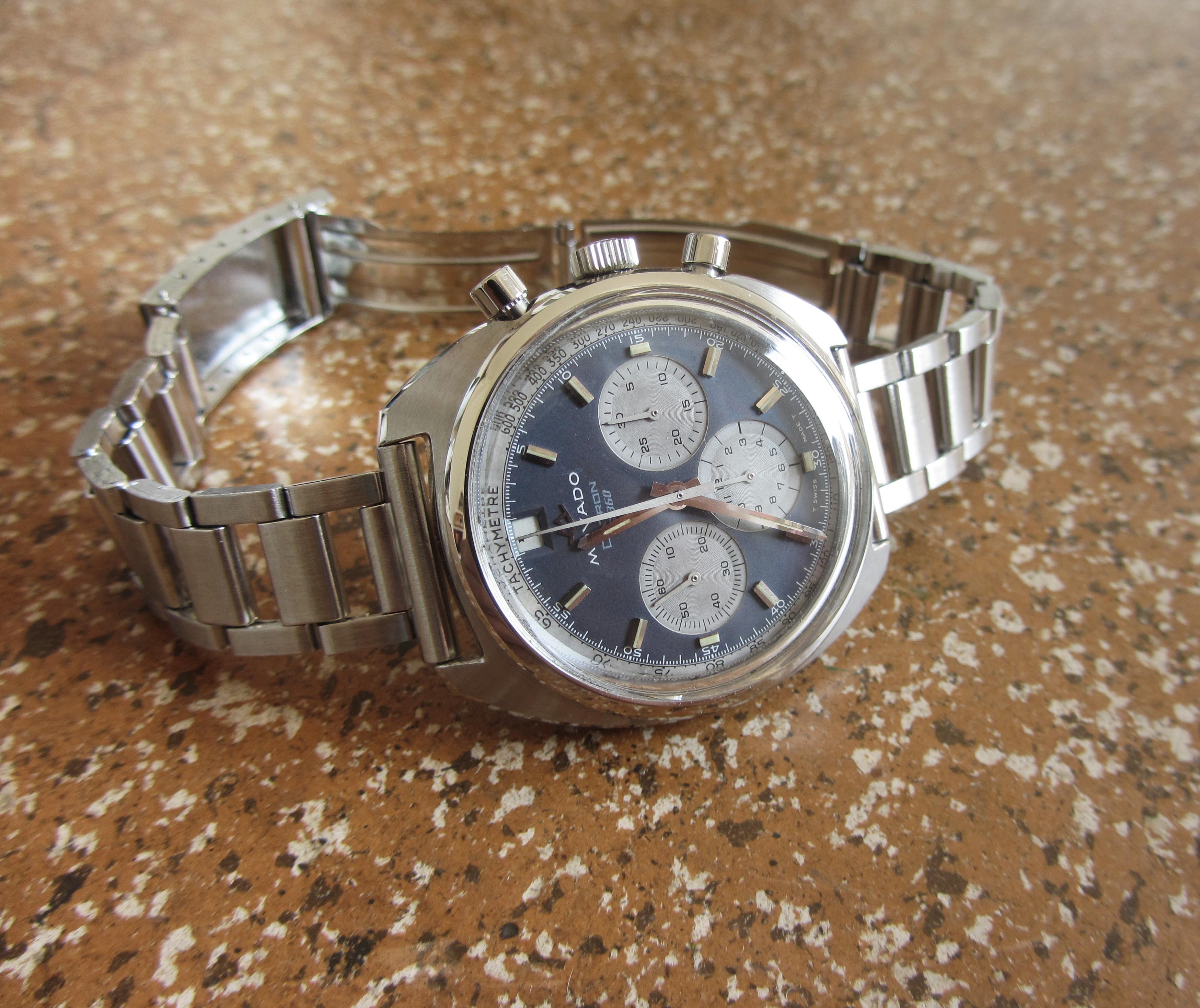

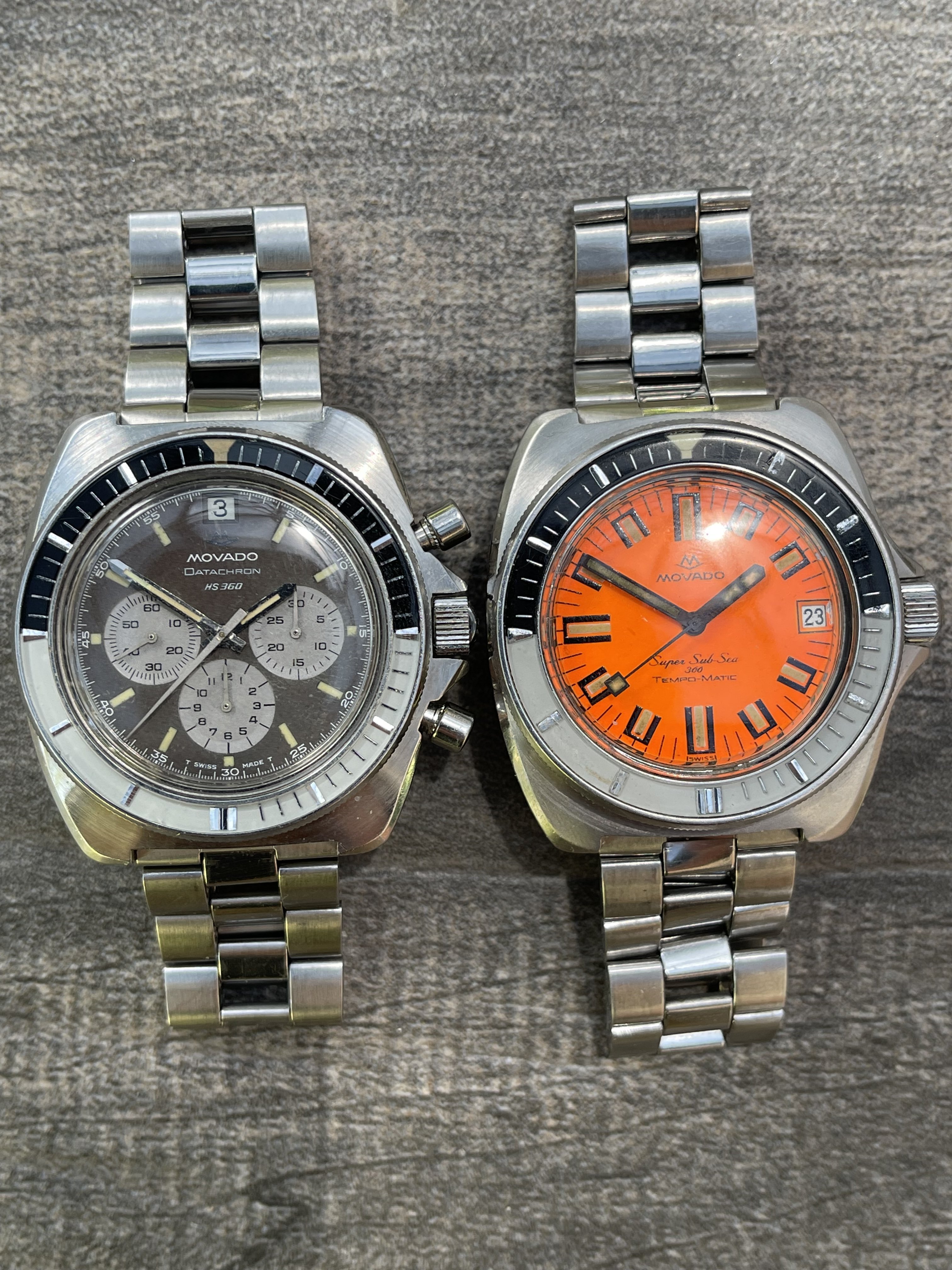

Here's mine.
If you are interested, I've opened a thread about this watch in the Zenith section of this forum.

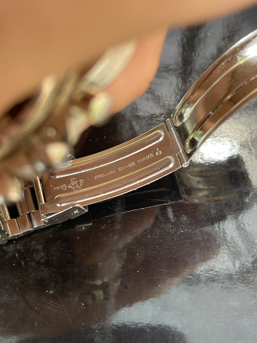

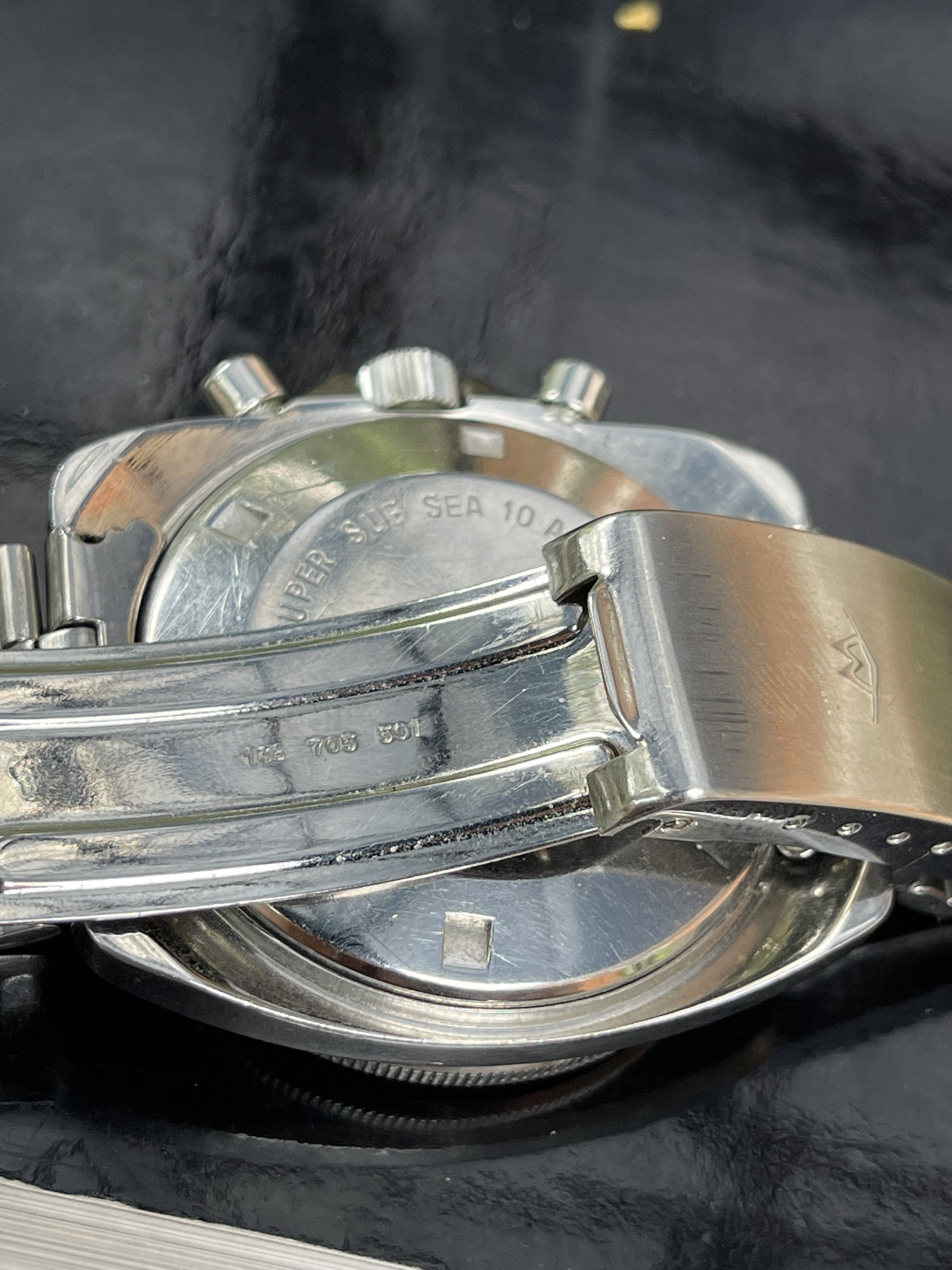

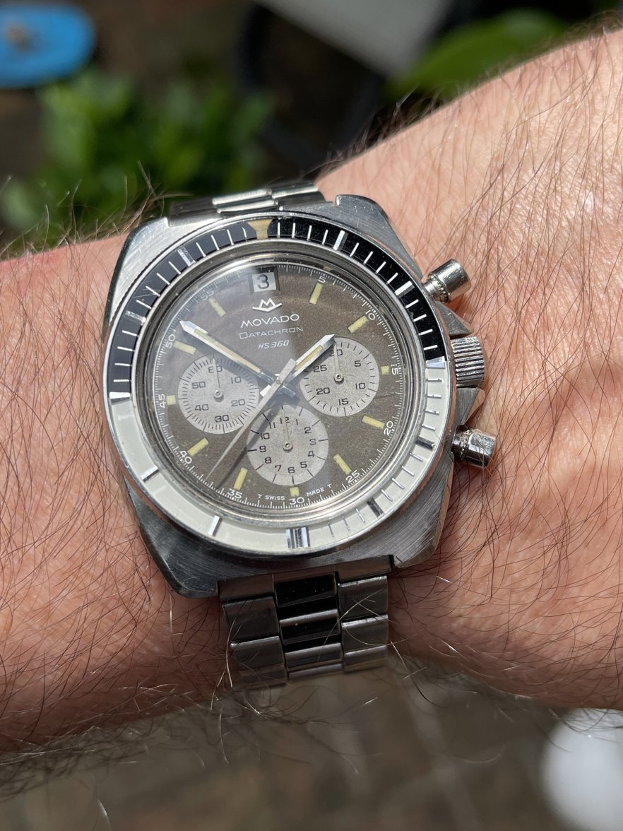

I owned a diving Datachron with bakelite insert turning bezel some years back. 17-jewel version and had the Gay Freres "ladder" bracelet w/ diving extension stamped w/Breveté (Patent) notation & "1/69" date code. Hope this helps & some pix for posterity below. 🍻
Best,
T.
