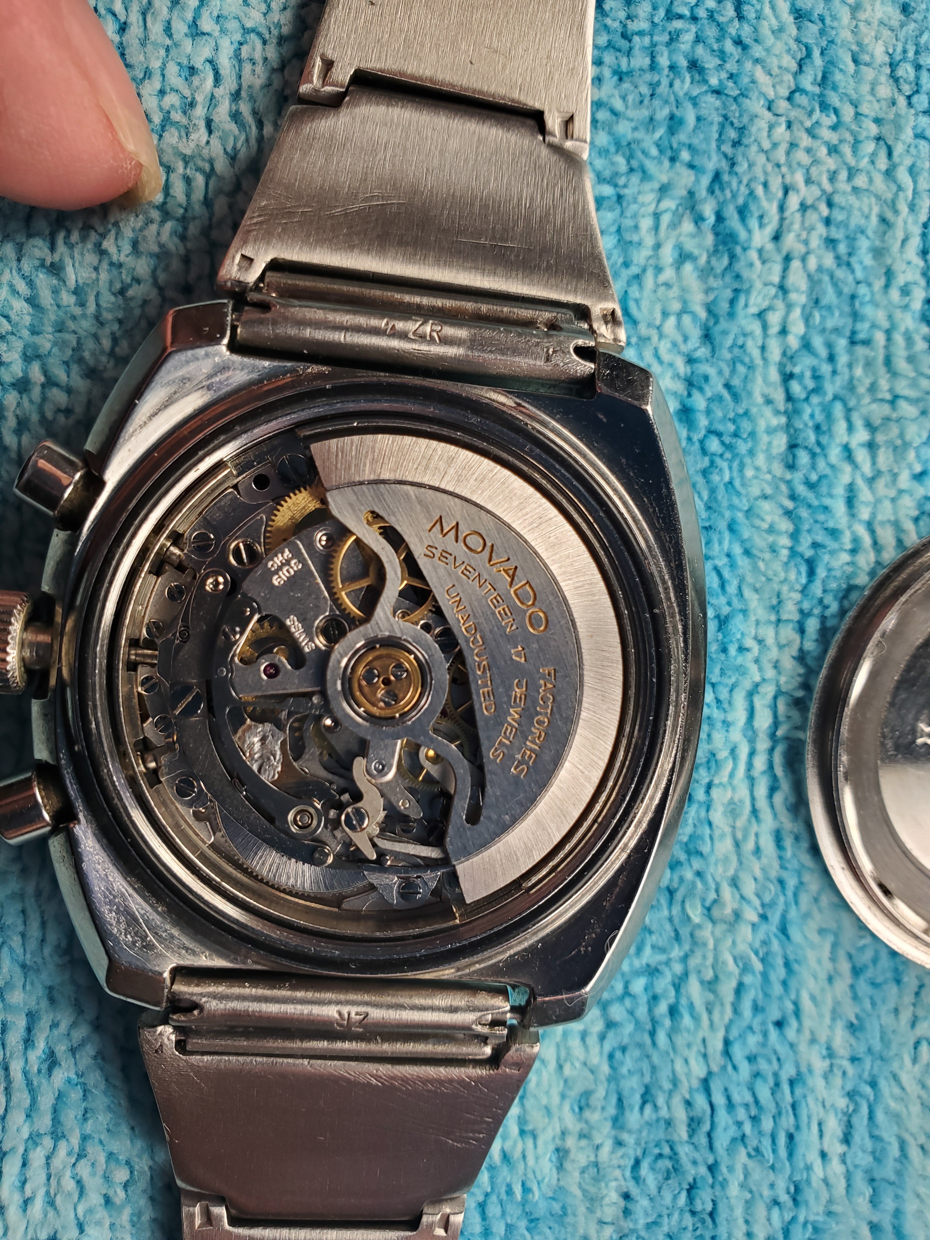

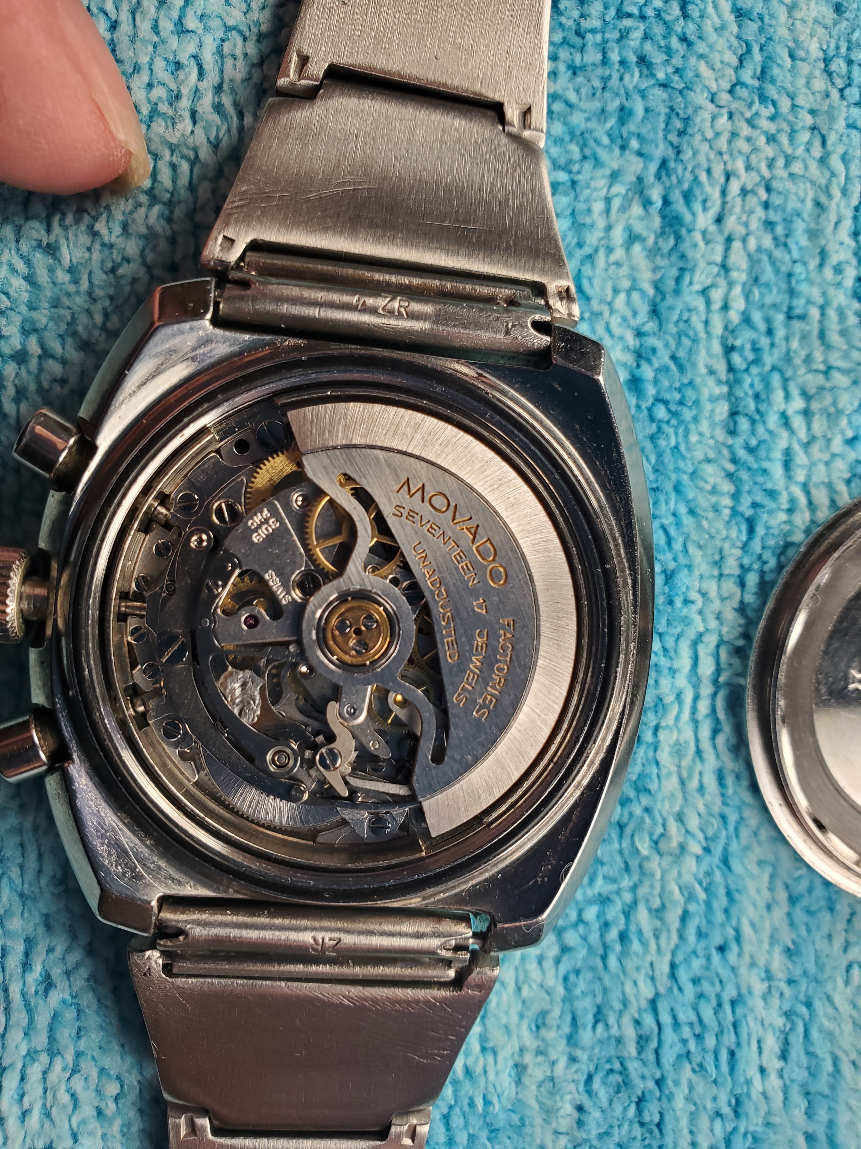

I recently purchase a Movado HS 360 on Ebay ( i know , don't hate me too much ) . I had one of these in the early 80's as a gift which is long since gone . I've always been seeking another & found a really nice example . After waiting for the authentication process ( questionable at best ) my local trusted watchmaker opened up the case and to my horror the reset hammer had been grinded/soldered over the set screw !
Vintage Movado/Zenith Datron HS360 | eBay
The original owner ( since 1974 ) states that he had the watch serviced @ Gray & Sons in Bal Harbor . He provided just the header of the repair ticket w/ the watch description , serial # and the invoice # but no detailed description of the work performed . I sent the seller an email with a pic and the current state of affairs & i'm waiting for a response . Even though he has a no return policy i'm sure that the item was misrepresented ( knowingly or not ) & i'll get satisfaction .
All of the function are working and the reset is working correctly ( but for how long ? ) and i'm currently checking the reserve time on it . .
I'm posting here on your site for any help you can provide and again please don't be too harsh . I'd appreciate any help.

Me as well , i sourced a replacement part from Switzerland that should be here soon . IDK why the PO did not have one installed as the part does not appear to be unobtanium .. The watch is running great with all functions working perfectly w/ 50 + hours of reserve .

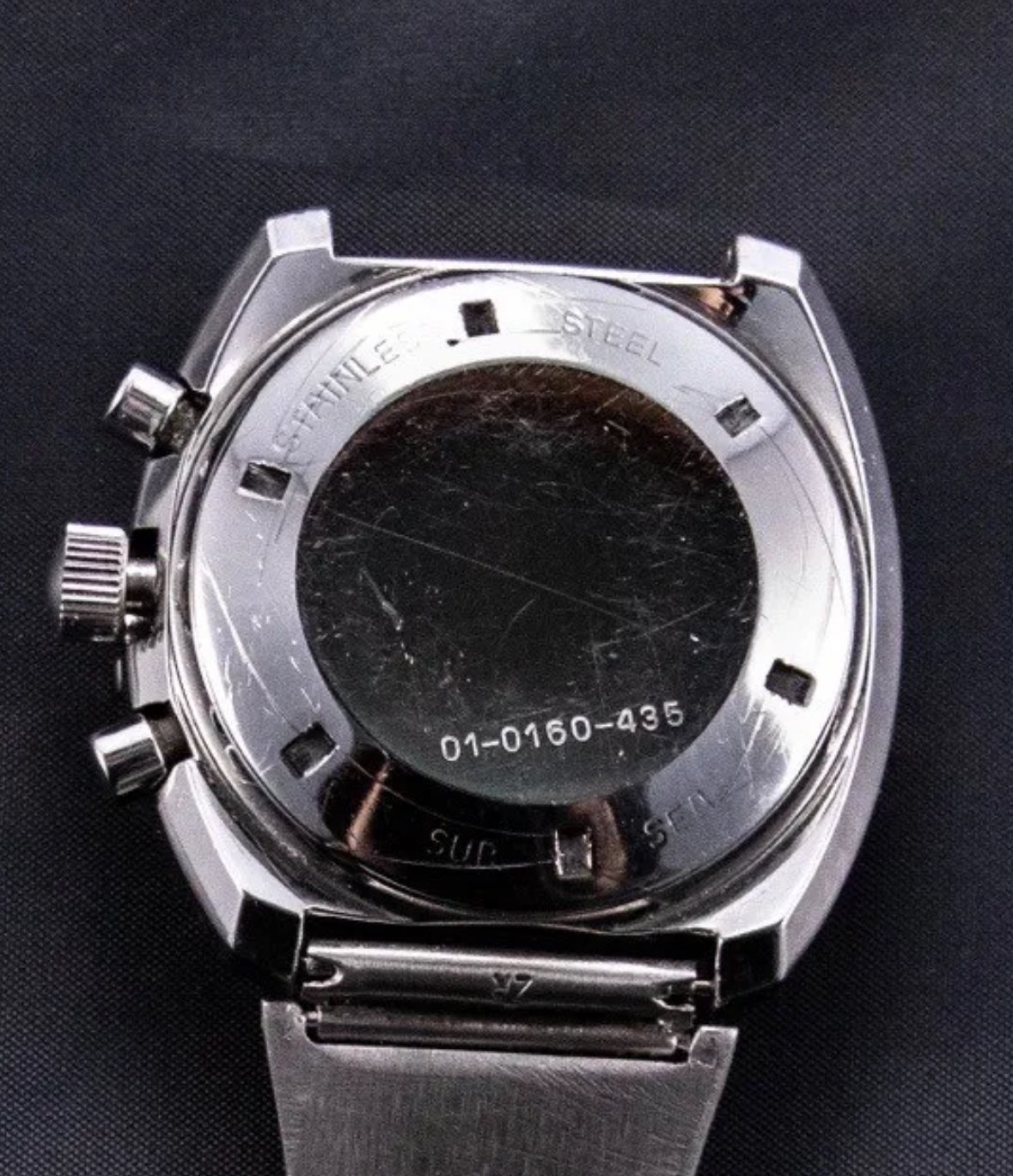

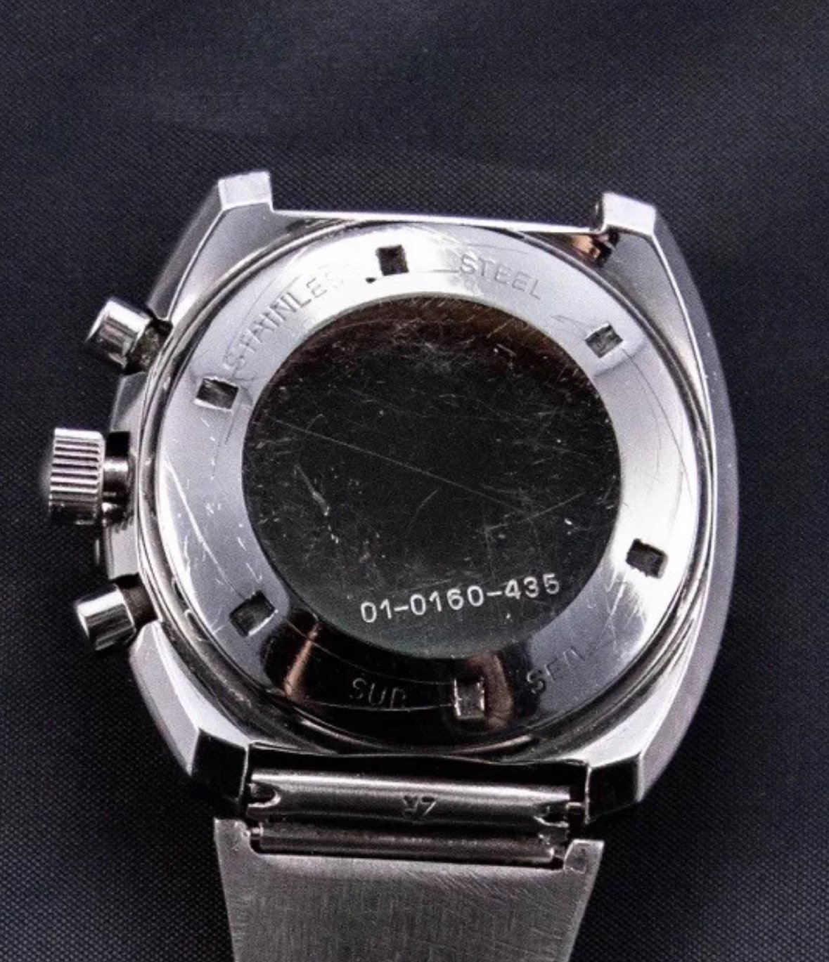

So now i have a mint fully function Movado Datron HS 360 Pilot for 5K
Mint seems like a bit of a stretch. Photo from the eBay listing you linked above.
8
3
You paid $1100 for the repair?
No , i just threw that # out there for a bargaining point
8
3
The face & case is in great condition , I'm not anal about the back . . Much better than the 7K watches i've seen .
