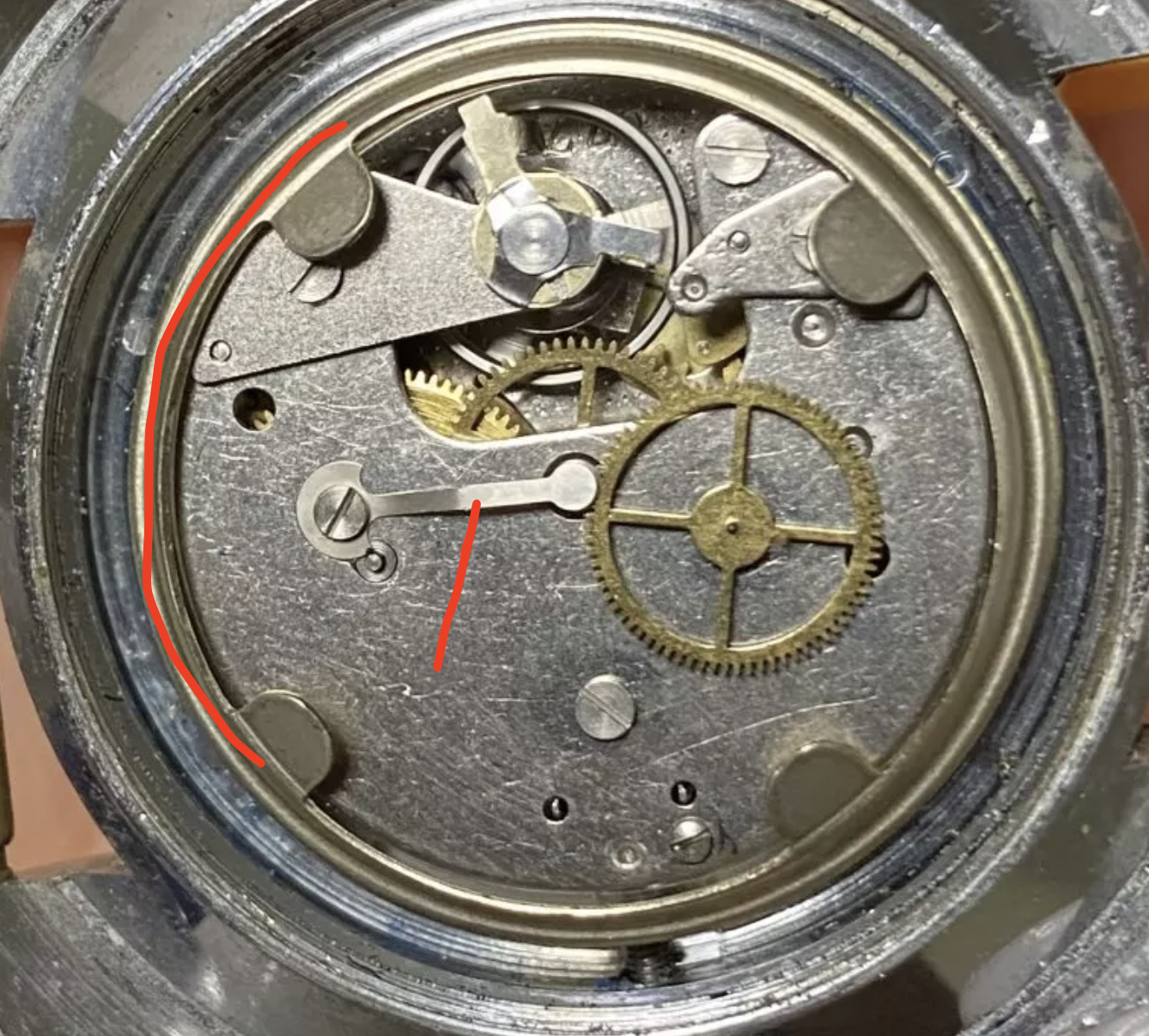

Should be a solid watch to work on. These "Meister-Anker" watches were one of the bread-and-butter exports from East Germany (the GDR), and IIRC they were manufactured in a VEB in Glashütte. Sold in great numbers in West Germany at discount coffee chains like Tchibo, and everywhere else ... I had one of those as a youth, but can't for the life of me remember how it looked.
Thanks for the info! The collective knowledge in this forum is incredible. My stash of movements comes from my mother-in-law who collected them to use for art projects. This watch must have come with her from Germany when she came to the US over 30 years ago. She even still had a watch that belonged to a boyfriend from her teens. Although, I'm unsure how to work on some of these movements with top plates that look riveted on instead of individual bridges. Showing my ignorance here. I'll have to take a look at some of them more closely.

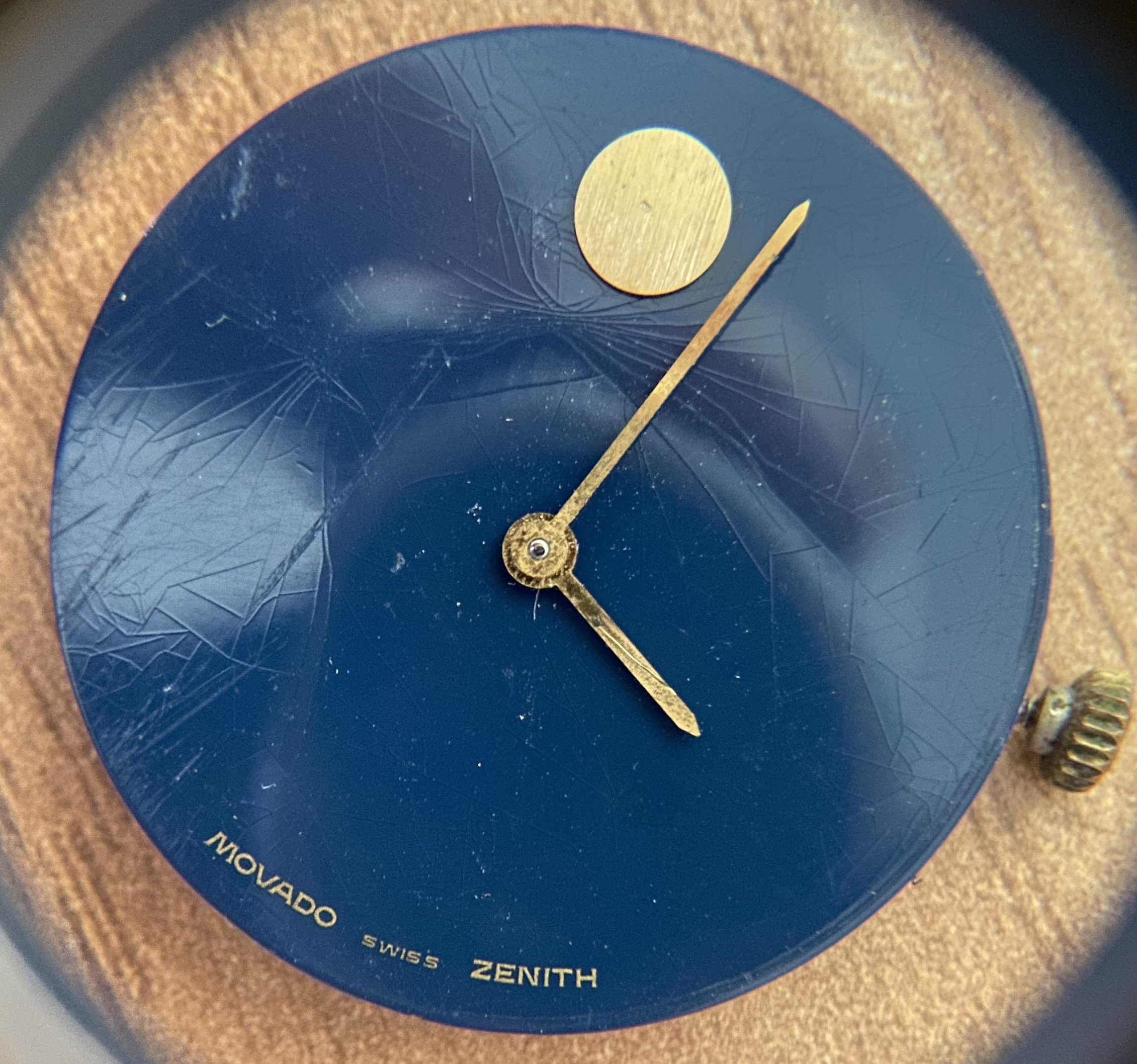

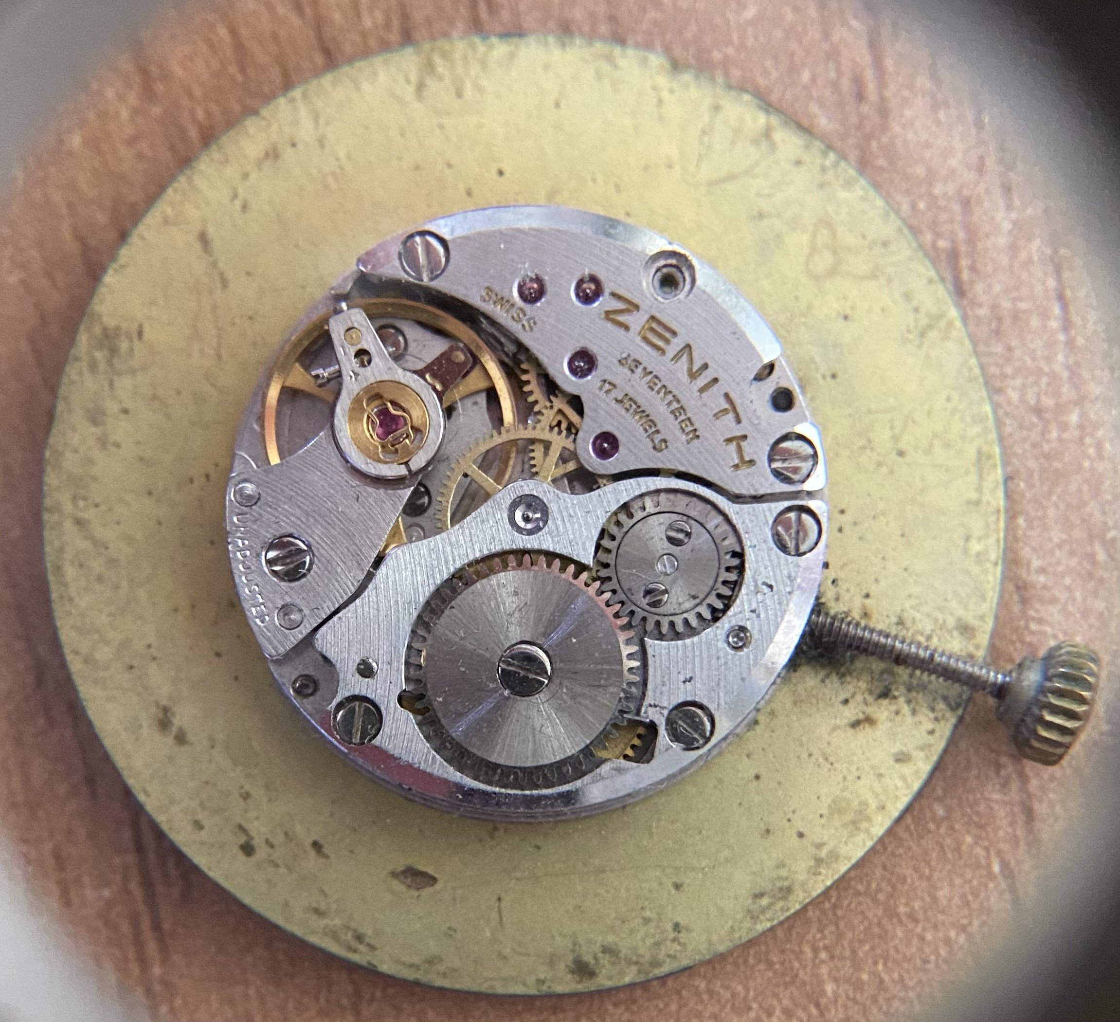

Here’s another interesting non-runner. Movement is about the size of a US nickel. I feel bad sacrificing some of the nicer movements but I suppose they’ve already been tossed anyway and this one actually has the stem. I’m sure it’s not worth the headache of trying to sell for parts to someone else.

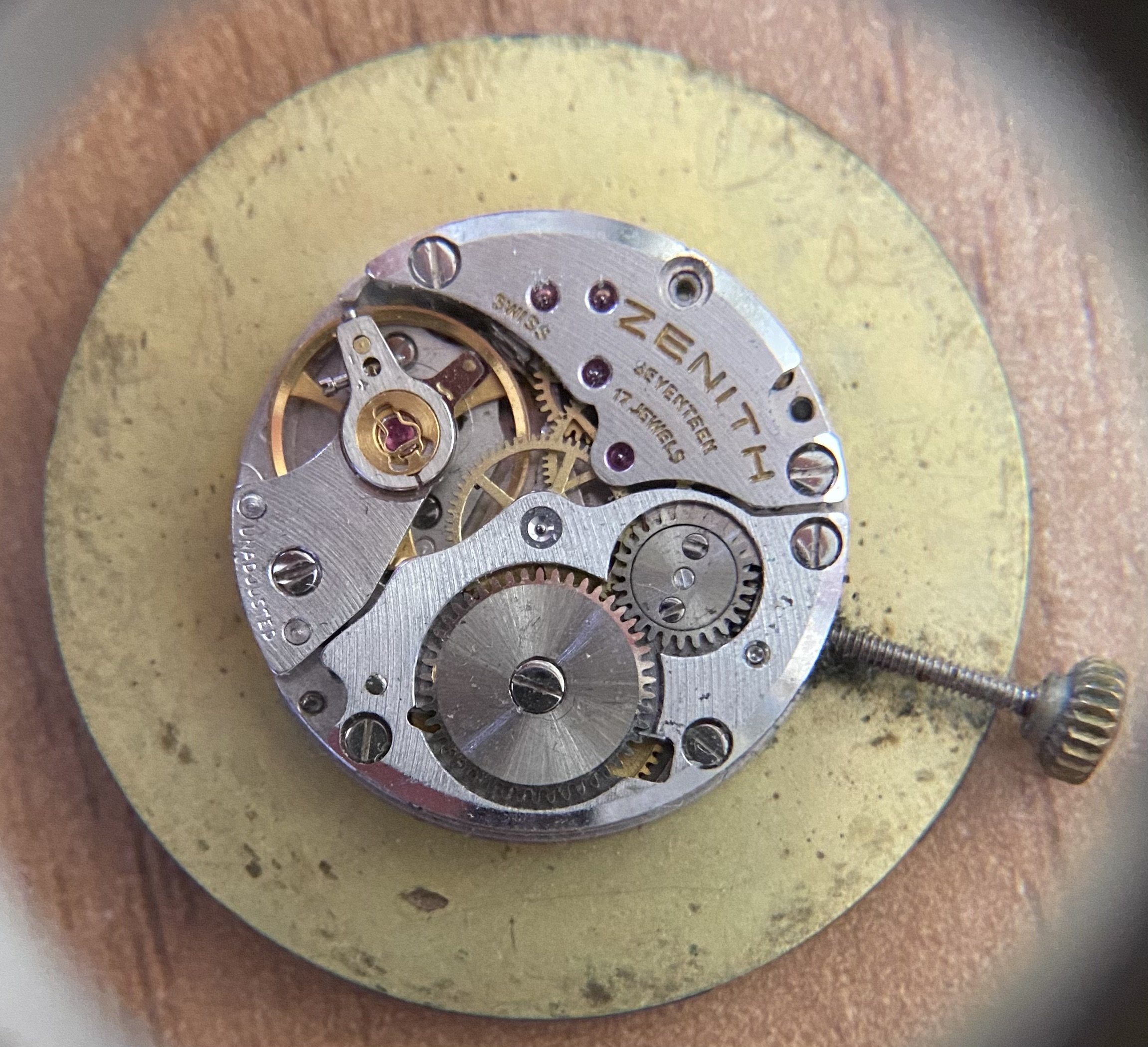

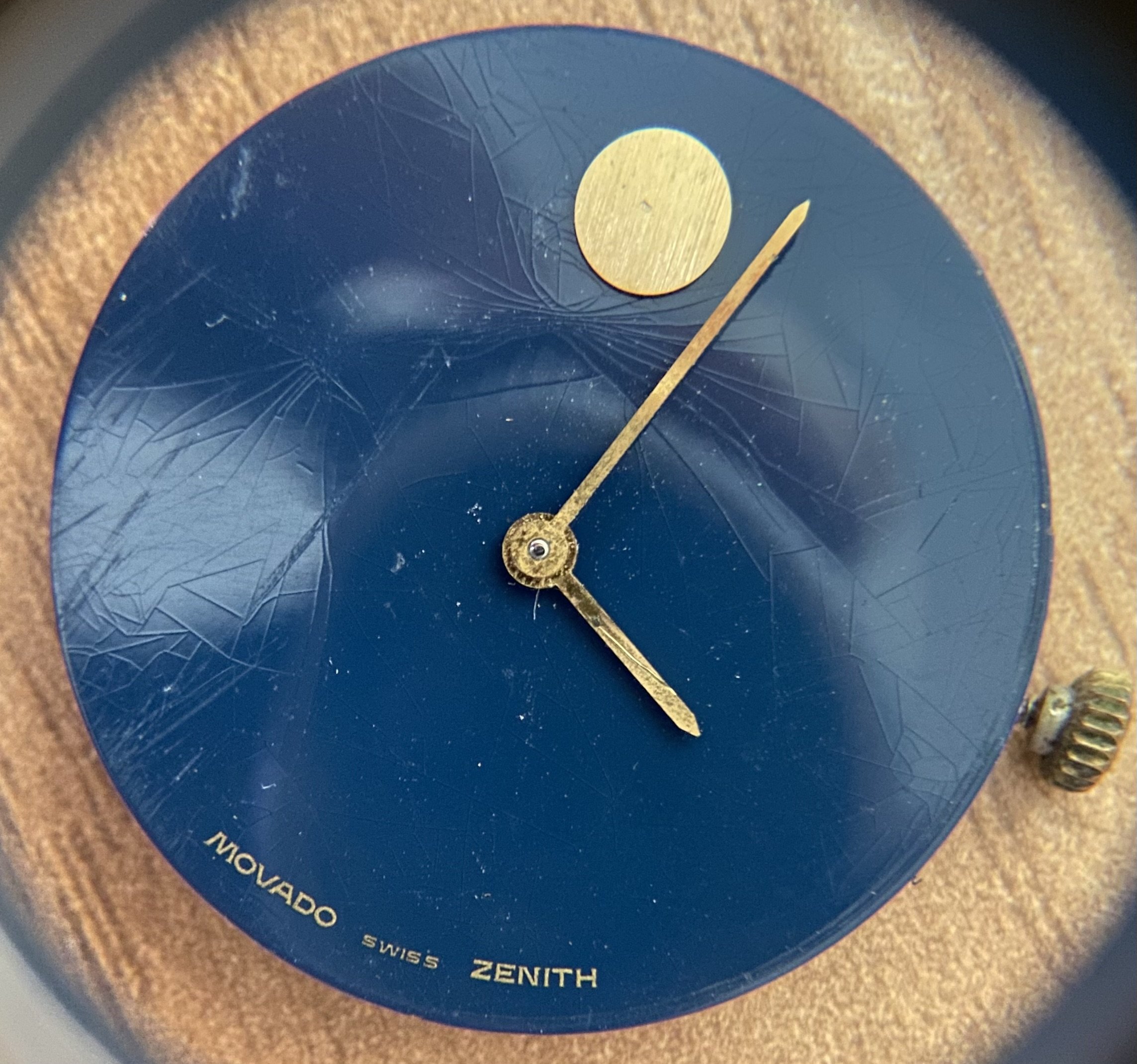

How confident are you?
https://www.google.com/search?q=movado+zenith+museum+watch
I'd keep hold of every thing and not let any piece got to waste. As a hoarder I going to be biased but as a collector save it or strip for parts and sell on this one IMHO.

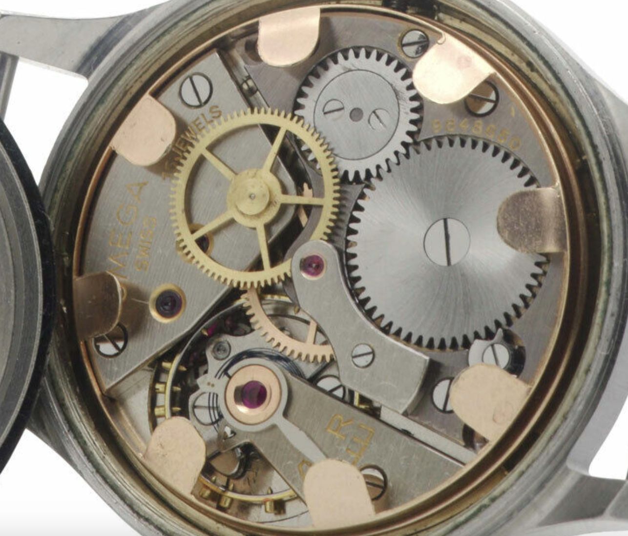

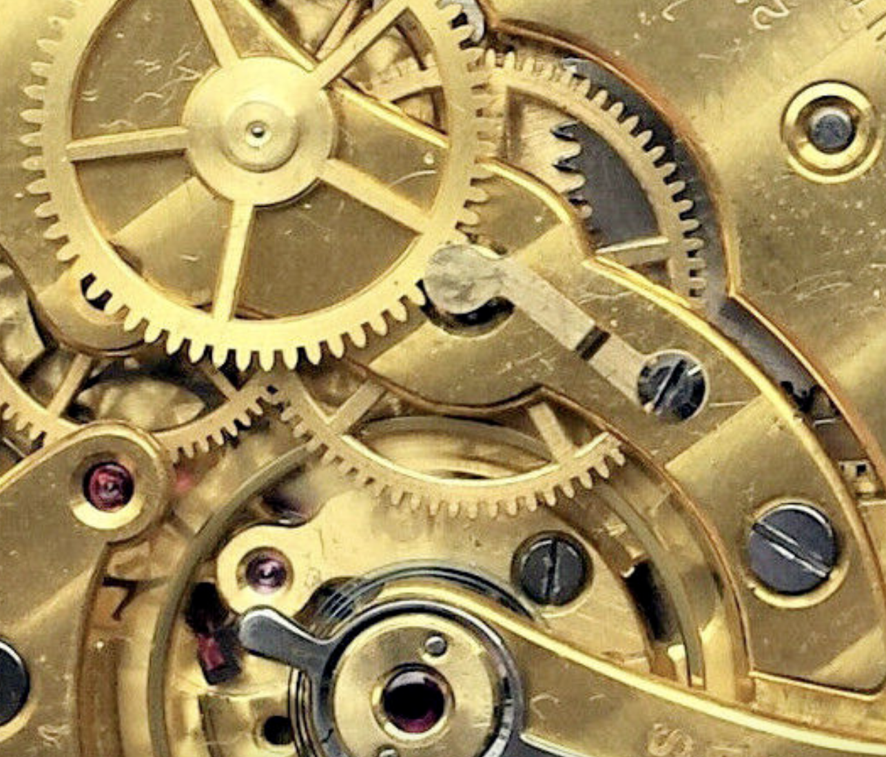

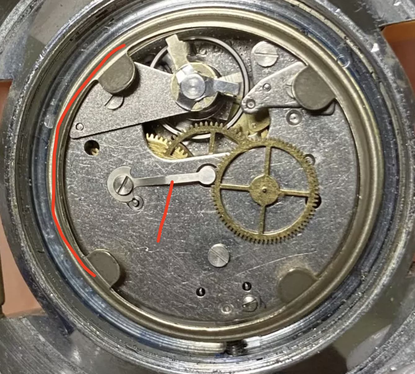

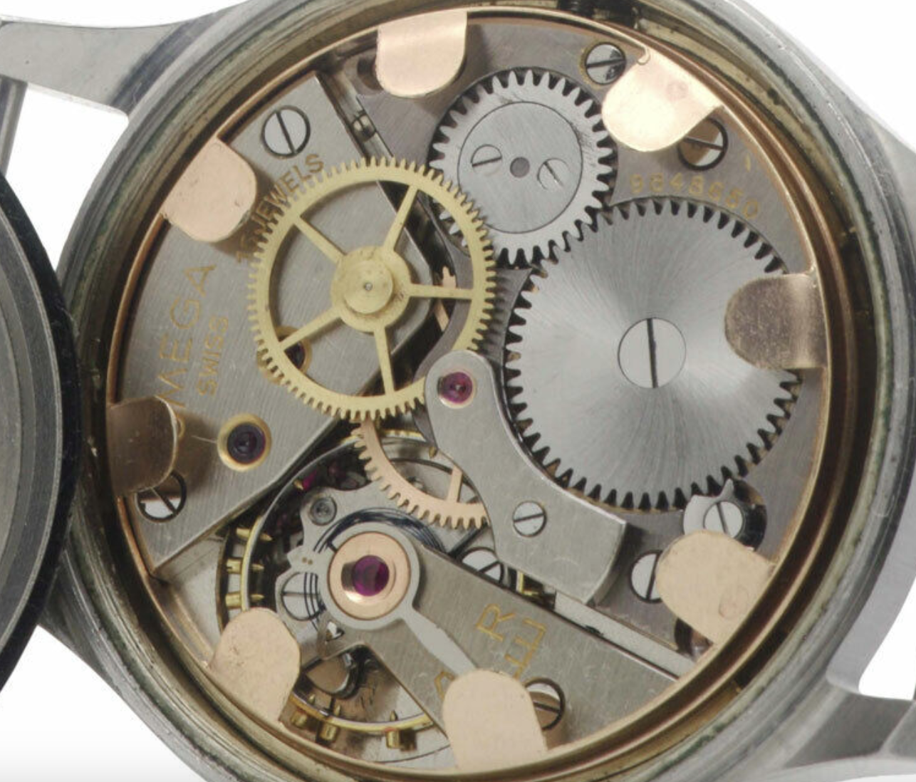

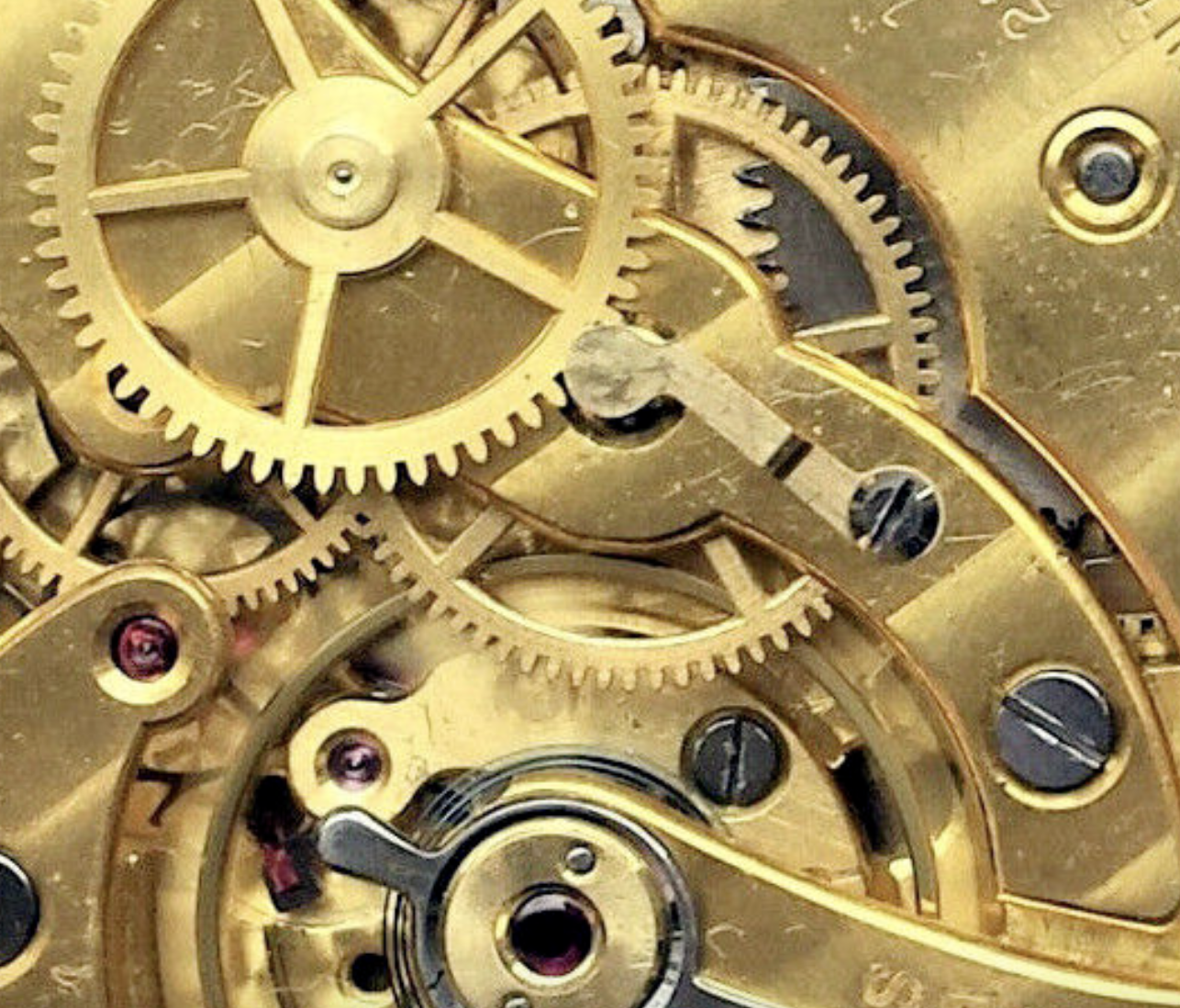

Re the East German watch you showed it has a two common parts I've seen used on 40 Mil watches.
- Specifically the outer movement surround.
- The spring/tensioner for one of the gears
I'll let the more knowledgeable give their proper names.
Image borrowed from ebay for illustration of components
You can see the spacer/shroud on an Omega 6b/159
A hack/tensioner/spring? on a JLC 6b/159
I’m 100% confident that I will damage whatever I touch. 😁 I’ll spare these for now. Most of the tiny movements I have are actually nicely finished Bulovas and a couple Hamiltons I don’t want to ruin either. I’ll probably start looking for some cheap pocket watch movements on eBay again. Maybe I’ll just start using my practice movement sooner than later. They’re relatively cheap.
More info on this watch here:
https://omegaforums.net/threads/zenith-movado-museum-watch.38967/
The Zenith is probably the closest to a 'real' watch. The pin levers and roskopff, were used in the lowest grades which got replaced with quarts. These require a different skill set. They were created with automation and mass produced with early robot devices some of which were driven with stacks of cams like the dolls I like and Babbage's 1830s computer. Often they are assembled upside down.

Yea I didn’t think many of these were meant to be serviced. I’m not worried about casing practice movements. I just want to learn on them. Perhaps I should put the Movado Zenith on flea bay and see if I can get a few bucks for it. I’m still waiting for the Elgin I found in the junk pile to come back from service. Should be pretty soon I hope.

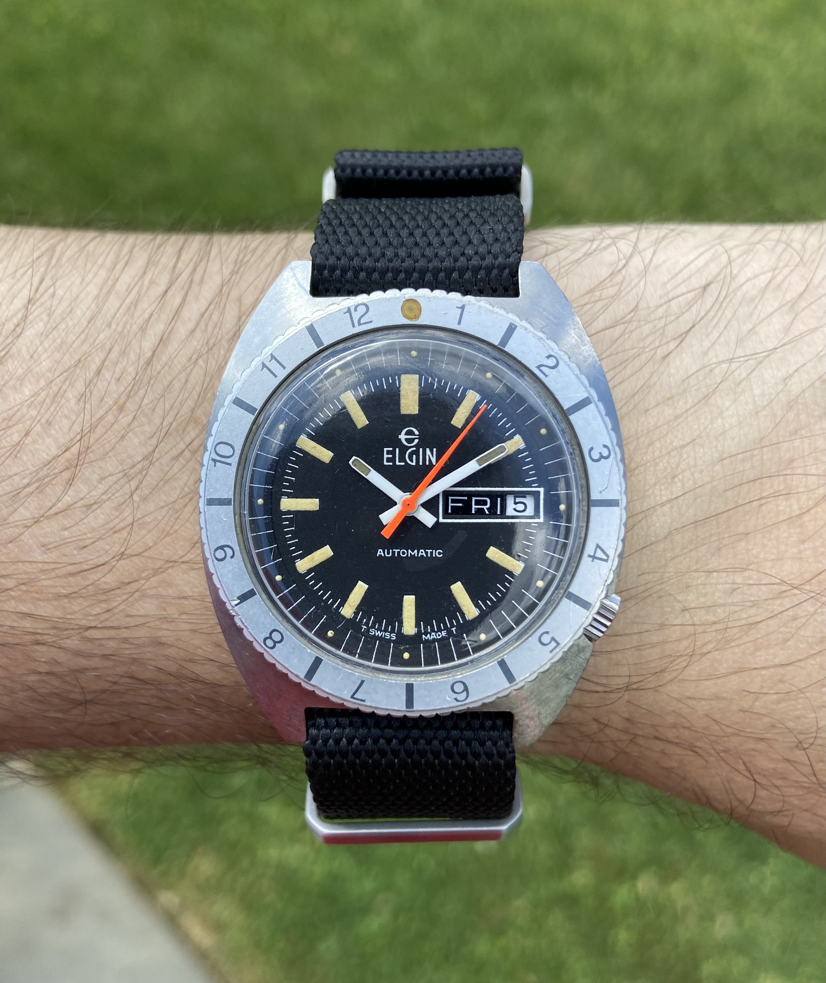

I have always been fond of Elgin. I think they developed the design that became the 'modern' swiss watch.
I have an A11 which I have been acumulating parts for. I also have some like your example with the Felsa movement. This is the sort of movement that is best to learn on.
Omega call it the friction spring for sweep second pinion in the 550 series movements.

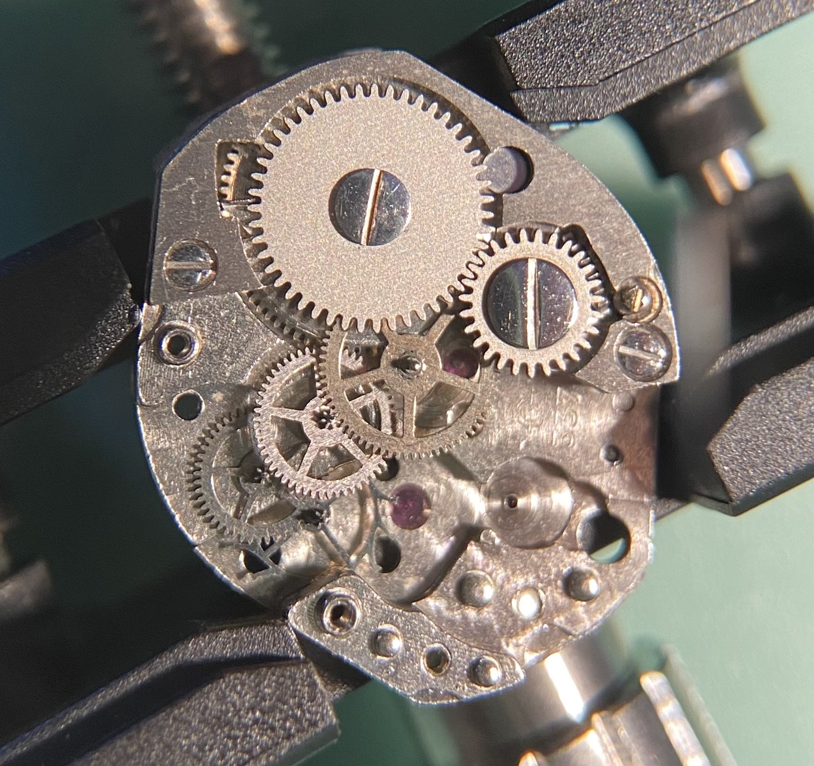

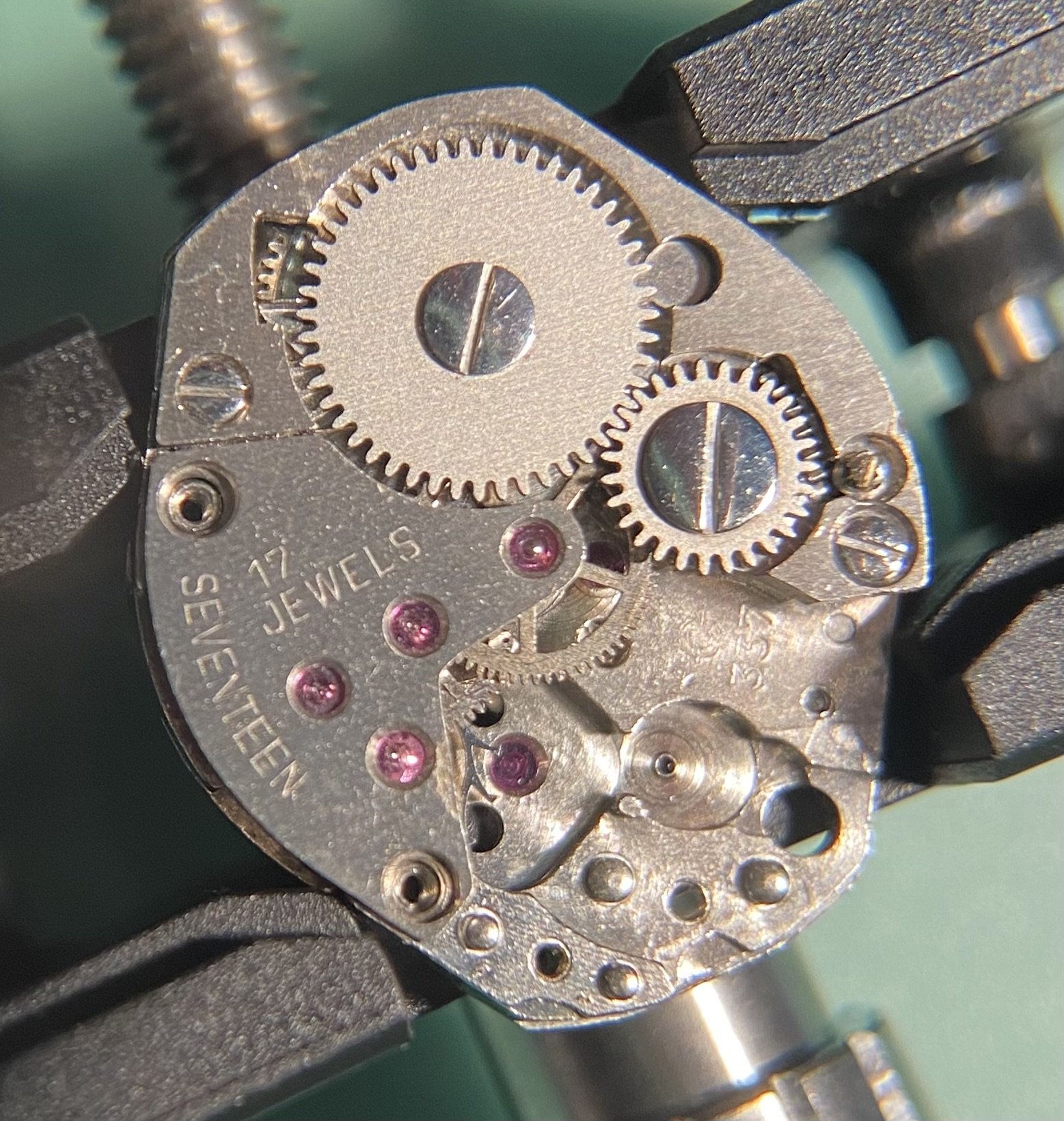

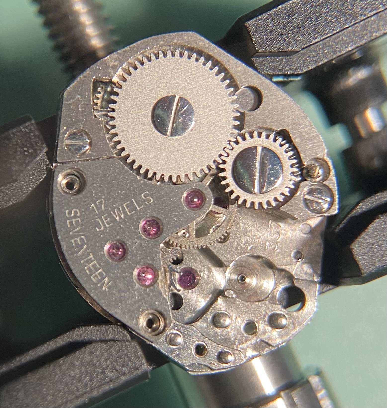

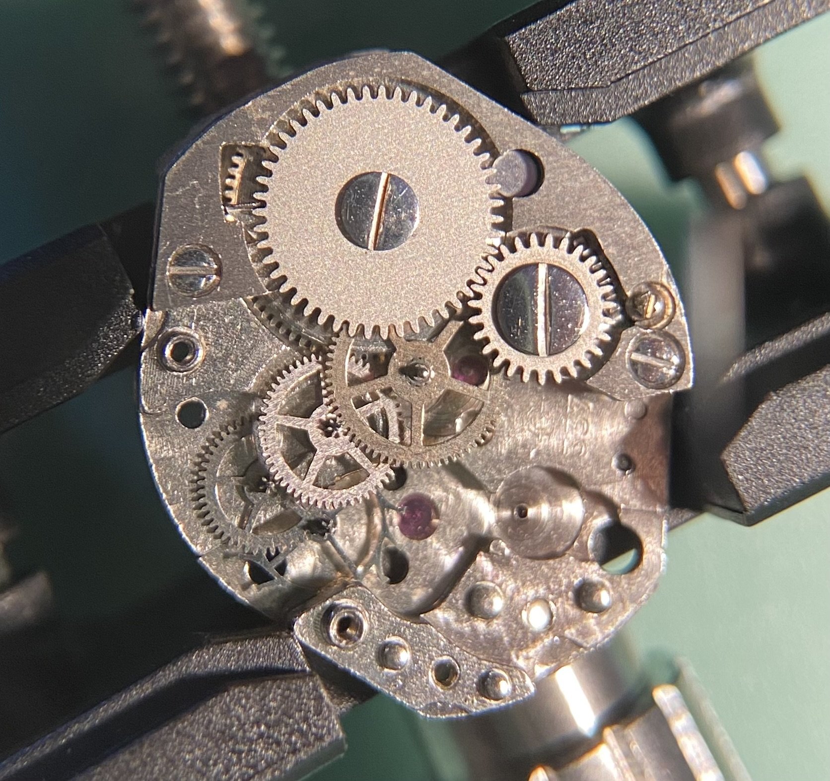

Decided to give one of the tiny ladies movements a try. This train bridge is going to be the death of me trying to get it back on with everything lined up.

I got it on! Back together and running. This must be why they say watchmakers have patience.

how was the high when the balance started to go again?
It was actually more like relief. I was starting to think I wouldn't be able to get that bridge back on. And I may or may not have broken some other things recently so my track record is currently pretty poor. The train bridge on my practice movement falls into place with just about no effort. Seeing the balance start up again was definitely encouraging though.
