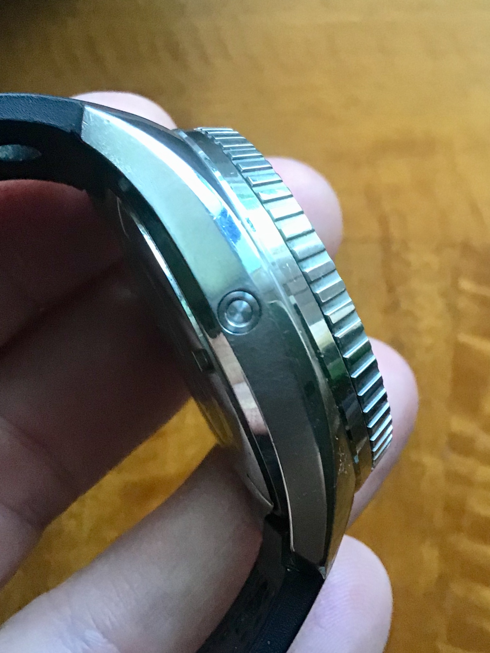

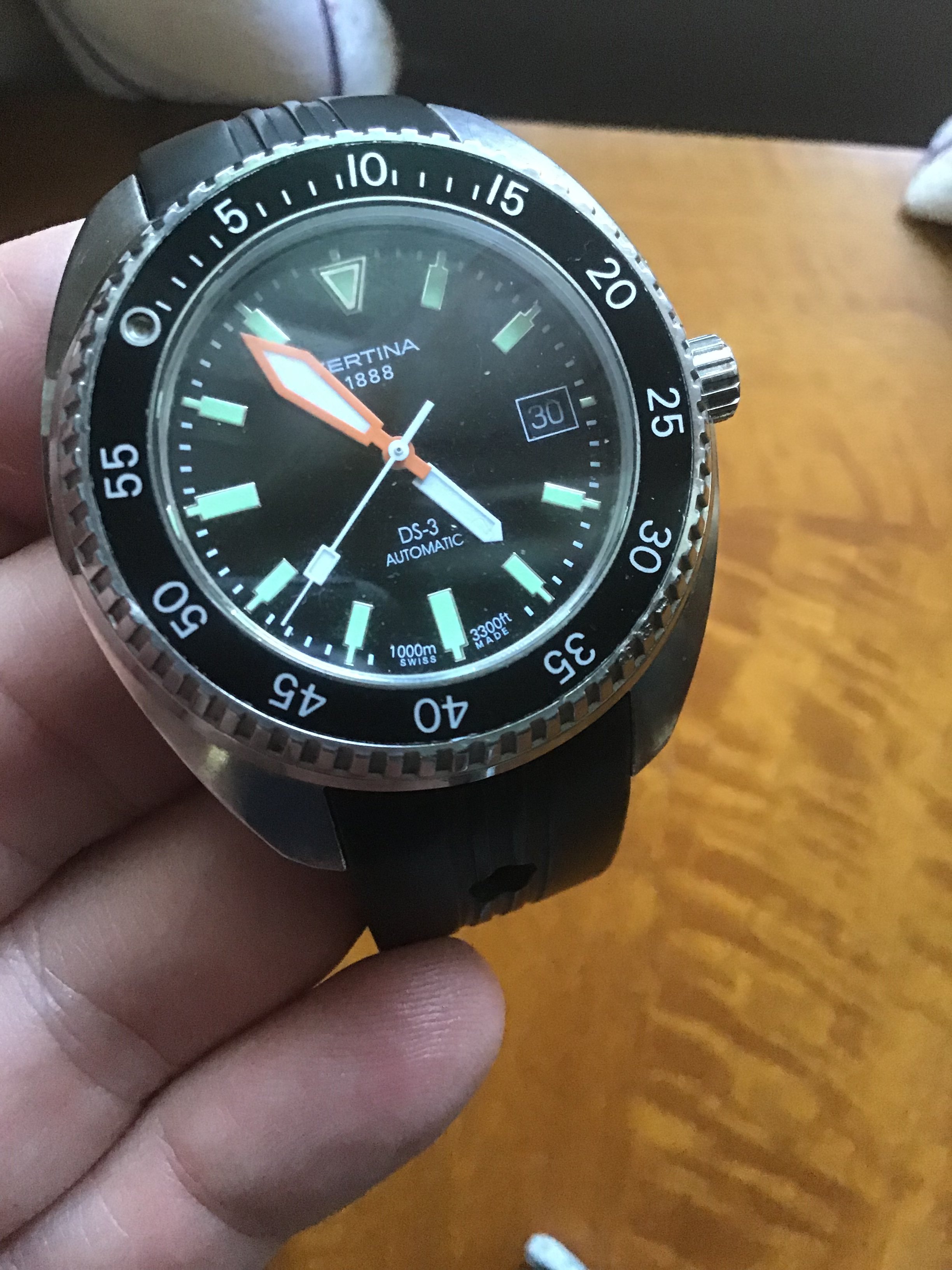

It’s a design gimmick that Omega wants to keep.
If swatch can have this on a 1000m Certina
2,709
17,429
Still don’t know how it works, but I’ll provide photo of wart on my wrist bling.
How nice!!!

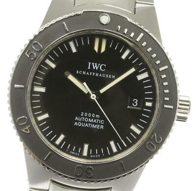

So the question is, is there a "curve" where the pressure/depth rating and the requisite methods/design/style of the seals make a relief valve redundant? Even my 1000m Oris has a relief valve.
Would the manufacturer of that 2000m rated watch tell a customer that decompression (of the watch) is not a concern?
I think to suggest that there is an intended or even direct correlation between depth/pressure rating and a watch's resistance to decompression failure is wrong. There might be an incidental or casual relationship only because those higher-rated watches have more robust sealing systems and can withstand a higher differential pressure for longer periods of time.
