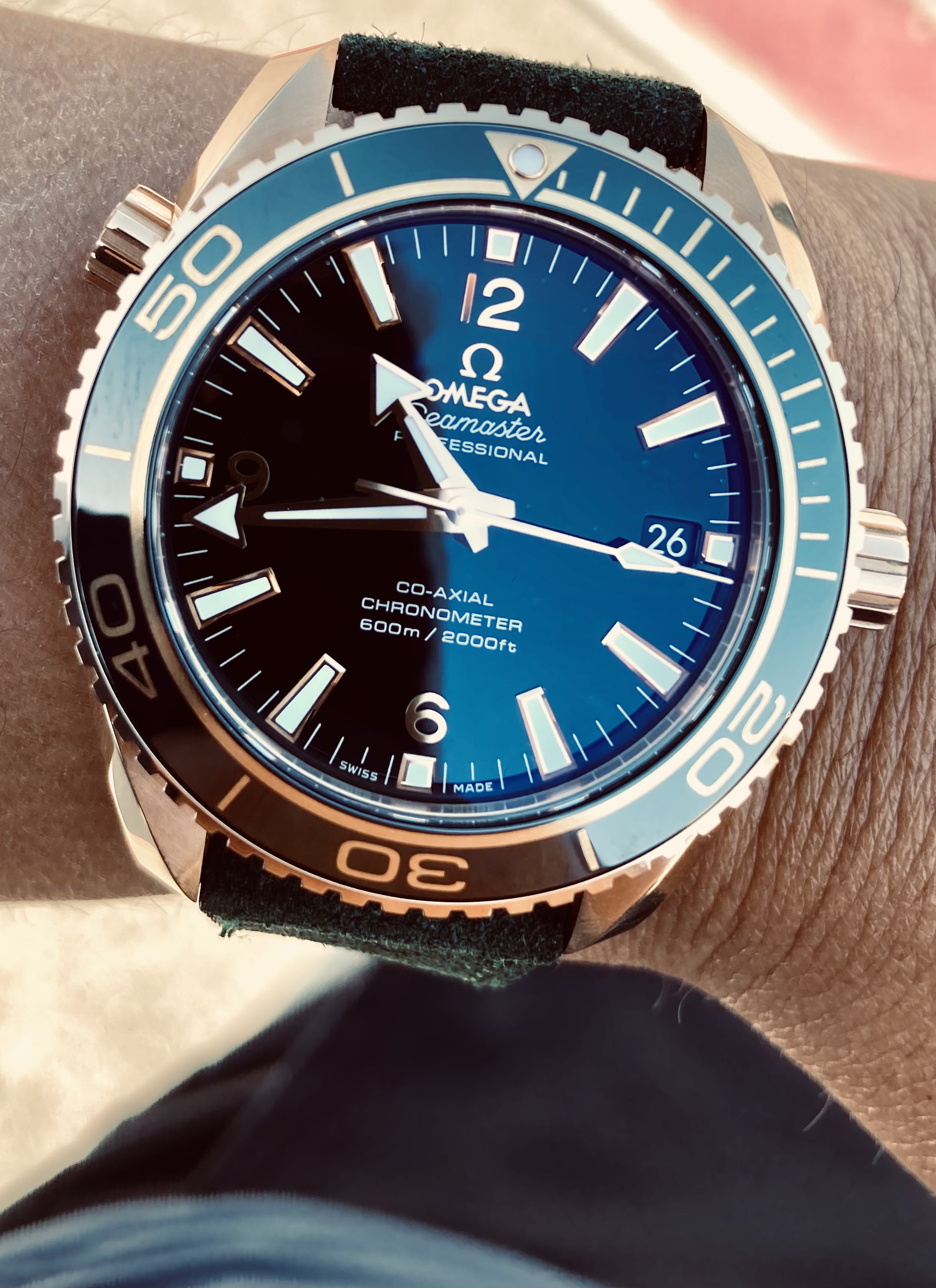

Still don鈥檛 know how it works, but I鈥檒l provide photo of wart on my wrist bling.
