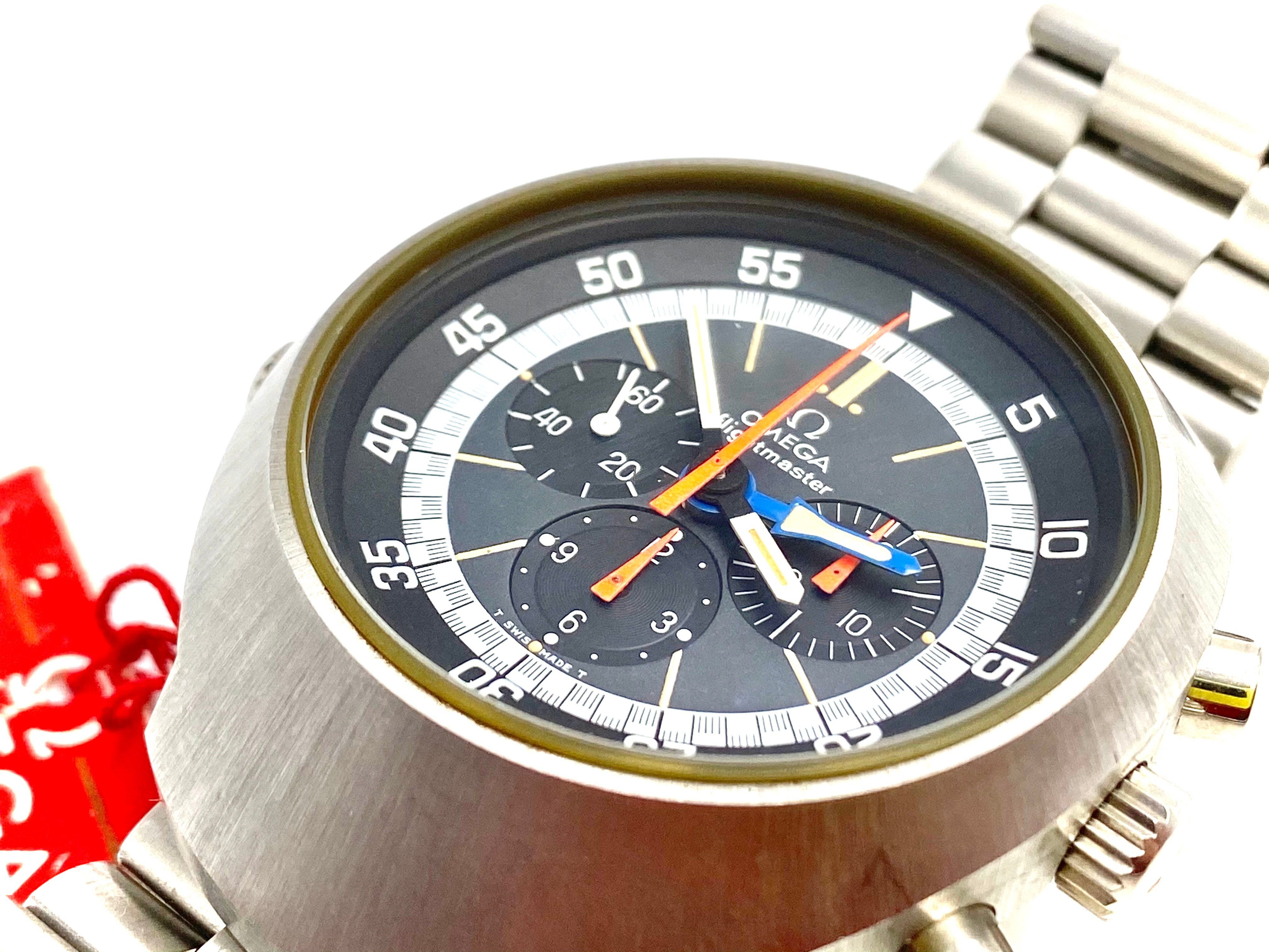

If it is 026, only reference with the dots and red hands are showing the year 1971.
If it is 036, the year is 1976.
Only way to find out is to open it. The receipt shows the year 1974 when it was bought, probably used at AD as pre-owned watch at JB Hudson store in Minnesota. There is a big possibility that is the case.
The watch is unpolished, everything is intact.
21
36

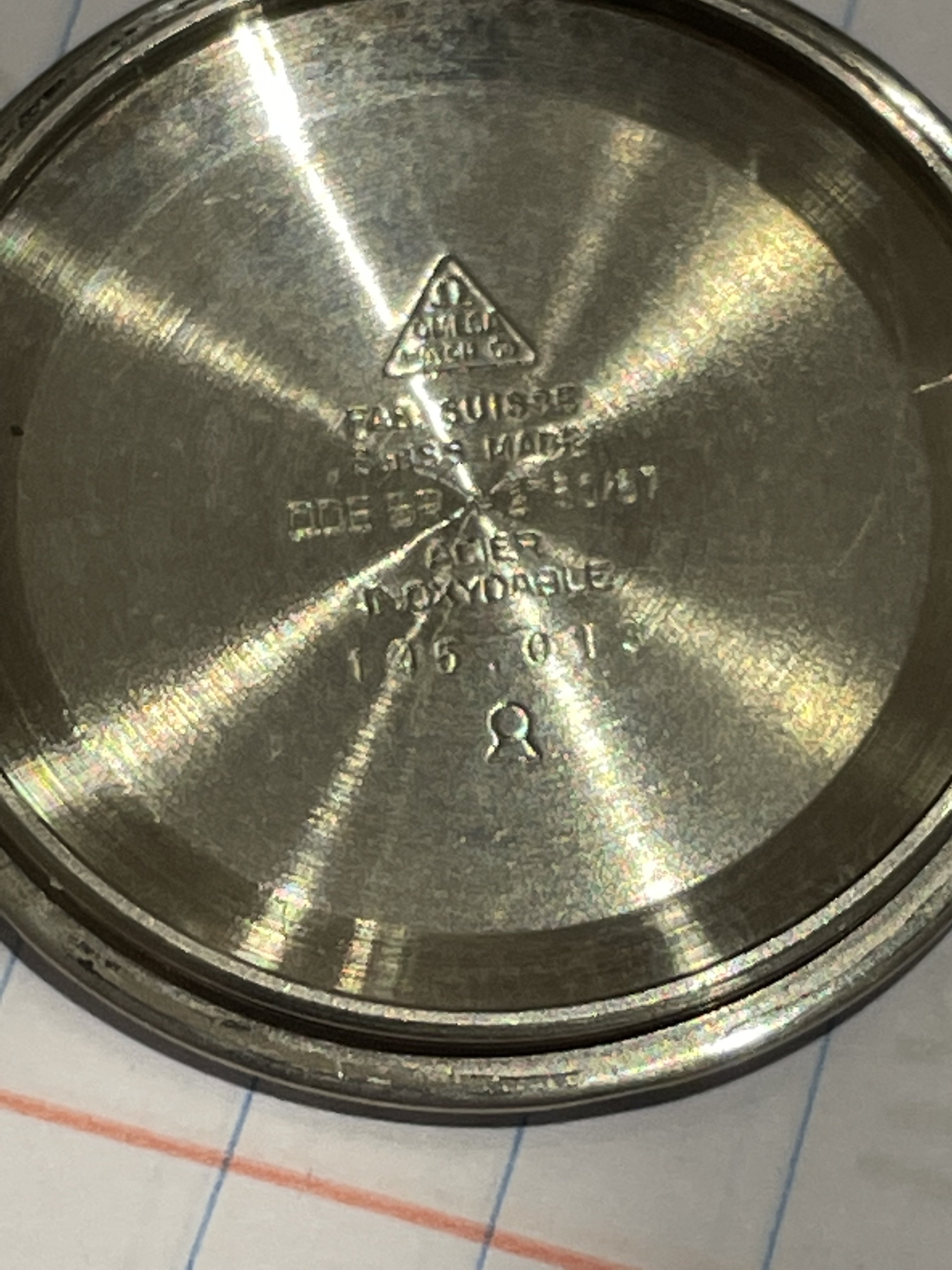

Just got the pic of the mechanism from the seller and the serial number is 33,XXX,XXX as he informed me.
So the watch is 026 from the 1971?
Again, sorry to bombard this topic but just needed the clarification. Thank you!

33m serial puts the watch to a 1972 or 1973 production year.
As 026 and 036 are both in this serial range, the engraving in the caseback and the full serial will give the complete story. As I said, your dial was produced over the period from 71 to 77.

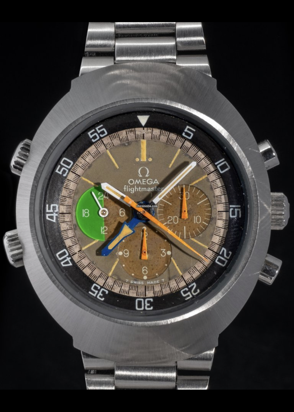

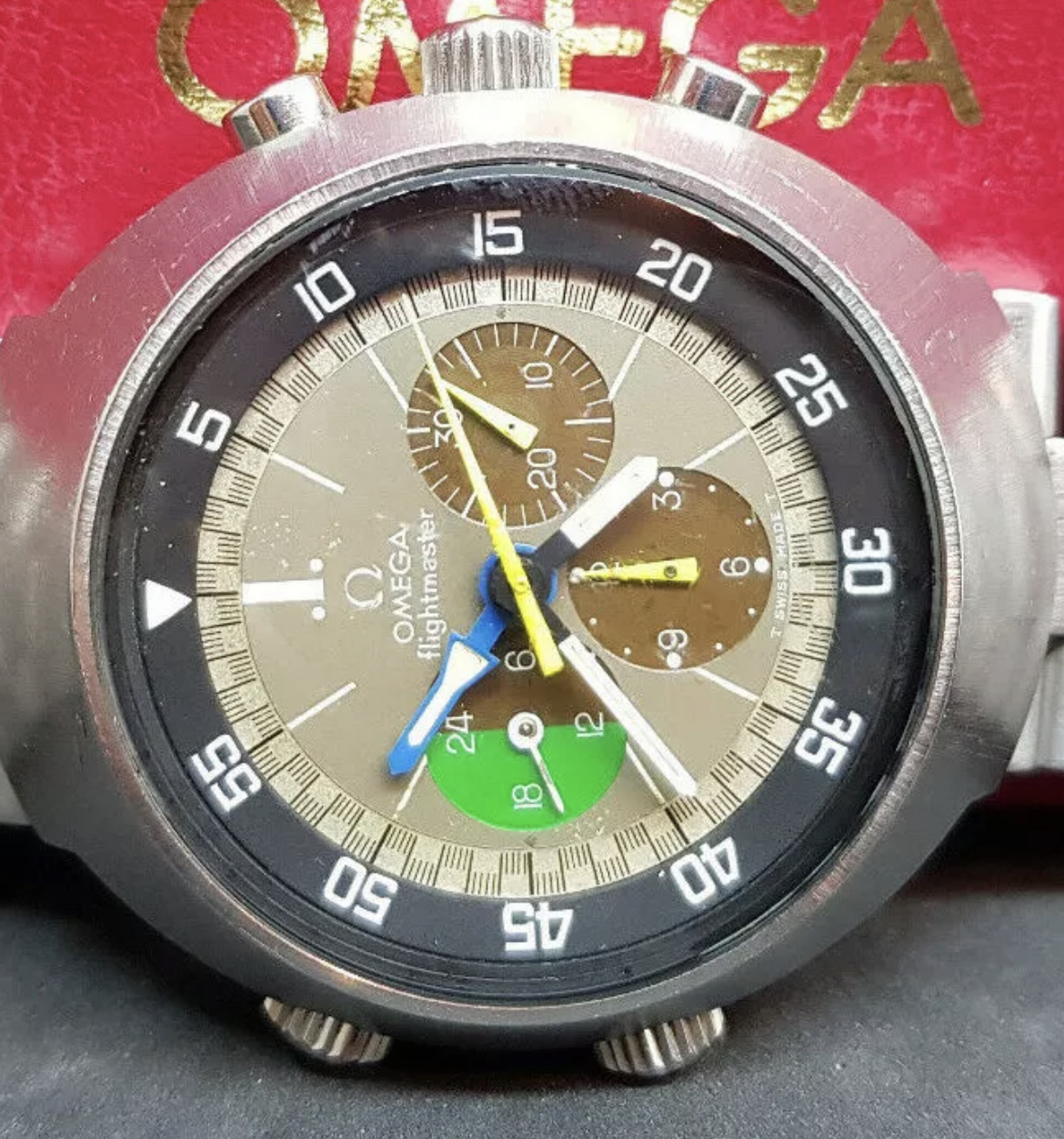

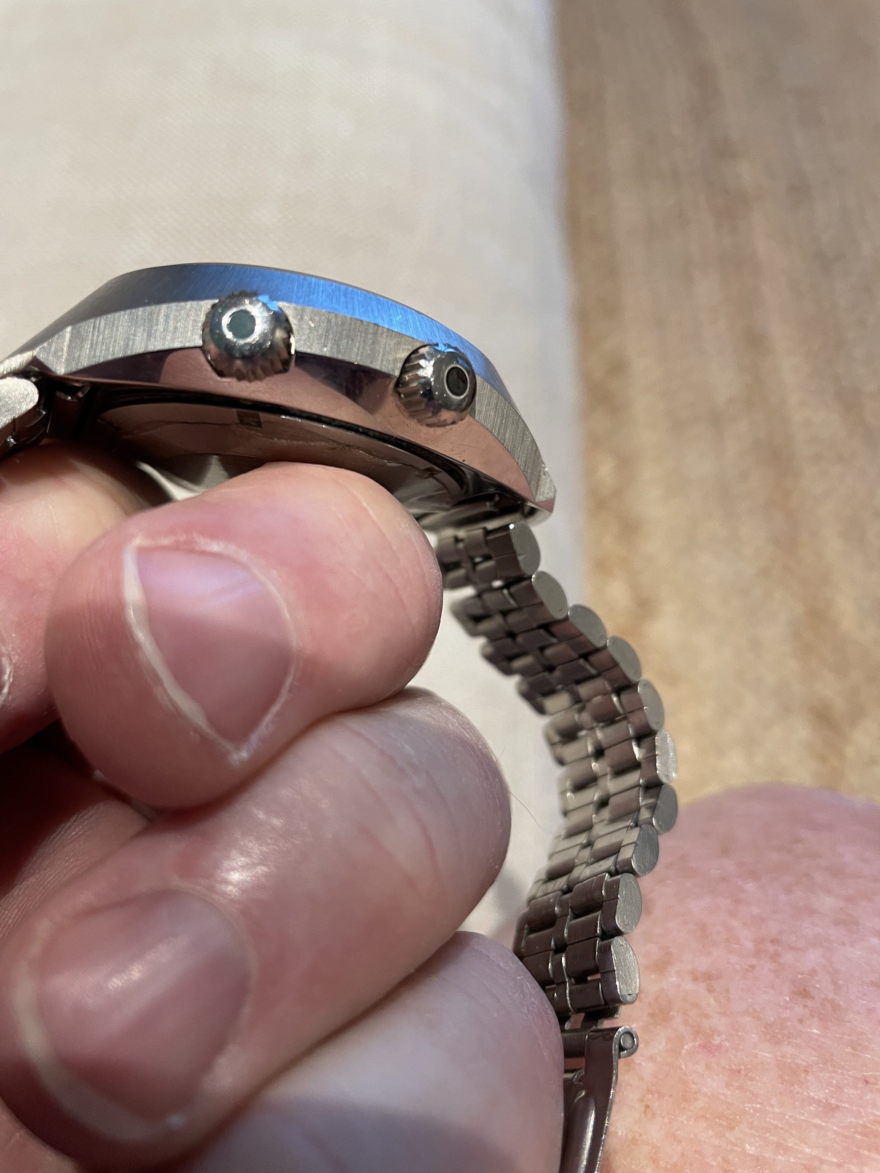

Could I kindly ask your thoughts on the originality of this piece?
It has been offered as fully original and the price was quite high. But to be honest I simply cannot whether it has after market parts.
Many thanks.
976
4,533
We need images of the sides and back to be able to offer informed opinion. The case is in exceptional condition for one of these, which tend to show at least some micro dings and dents acquired over the last fifty years. The dial and hands look absolutely right - the hands have the right amount of fading. However the case could have been refinished by Omega, or by a case specialist with similar skills (it just seems a little too good). That may not bother you, of course.
If it is all original it certainly is worth a premium, as many Flightmaster offerings that have been badly polished still ask absurd prices. My Flightmaster is all original, and I was very lucky to find it.

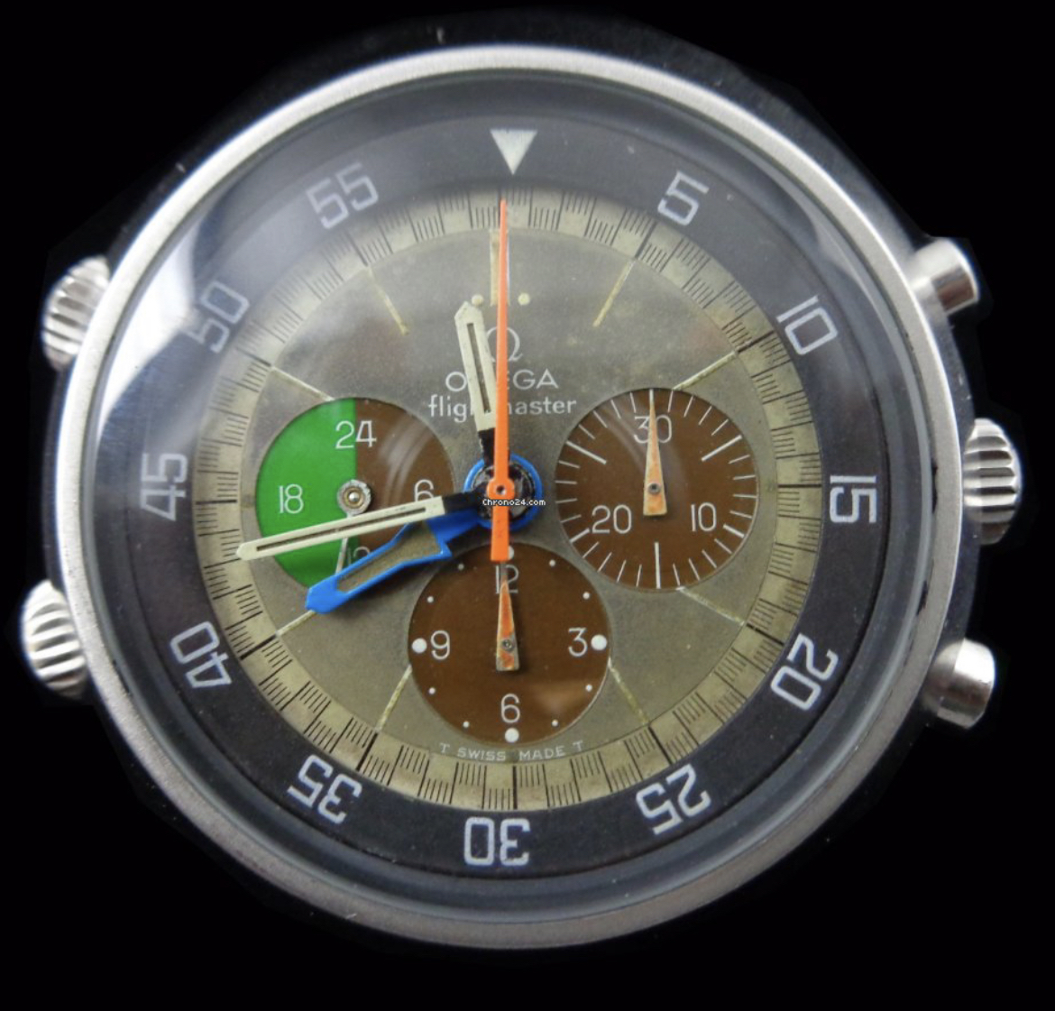

Hello

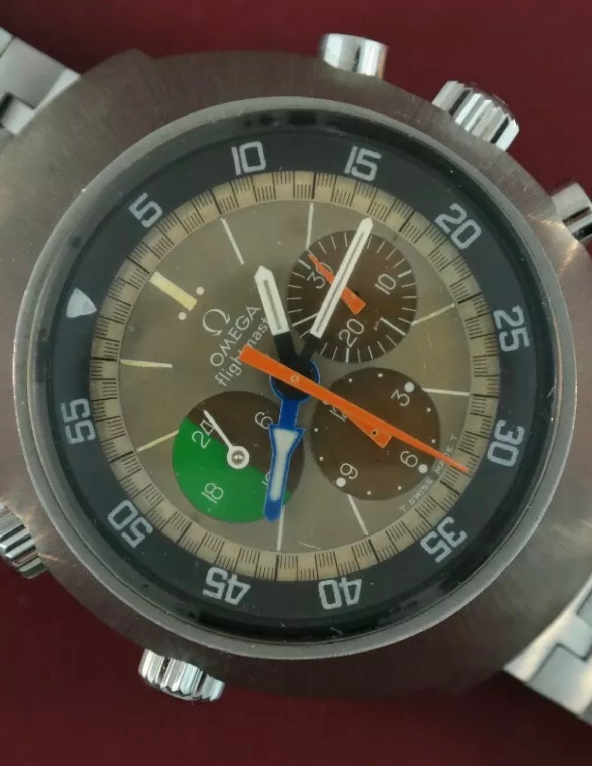

Has any one solved the mistery of the dial for the 145.013 without the dot at 3, 6 and 9, like in the picture. I have really seen many of them. For some, one could think that the dots have fallen, there is a vaguely discolored area where the dot should be. However for others like this one there is no trace of the dot at al.
I am asking this because the dial with no dots at 3, 6 and 9 is not described in the flightmaster only book

Here is an example of one with the faded area in the place of the dots

And three example of fallen/dots dials , i.e the ones with the discolored area at 3, 6 and 9

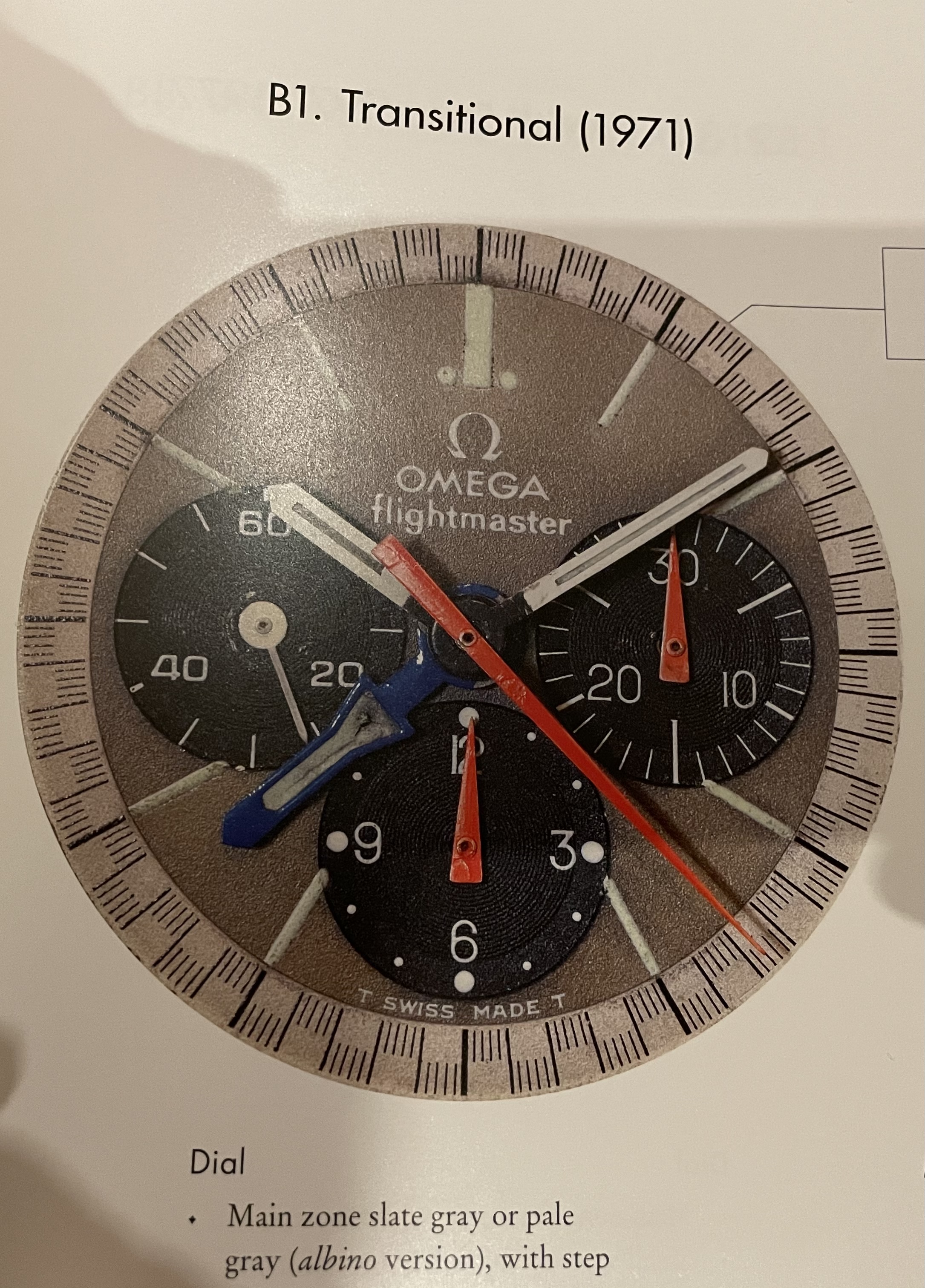

May be I found an explanation
In the flightmaster only book they describe a transitional dial that was originally a 145.013 dial that was refitted with a different left sub-dial to accelerate the sale of the 145.026 model.
Now if you look at the picture of this transitional dial there are the two dots at 12 but no dots at 3, 6, 9
Consequently I think that there must have been two version of the dial for the 145.013 with two luminous dot at 12: one with luminous dots also at 3, 6 and 9 and another one without. The latest version was also used for the transitional dial.
So guys what do you think I am completely delirious or it could be.
I am new do d茅lirions would be ok

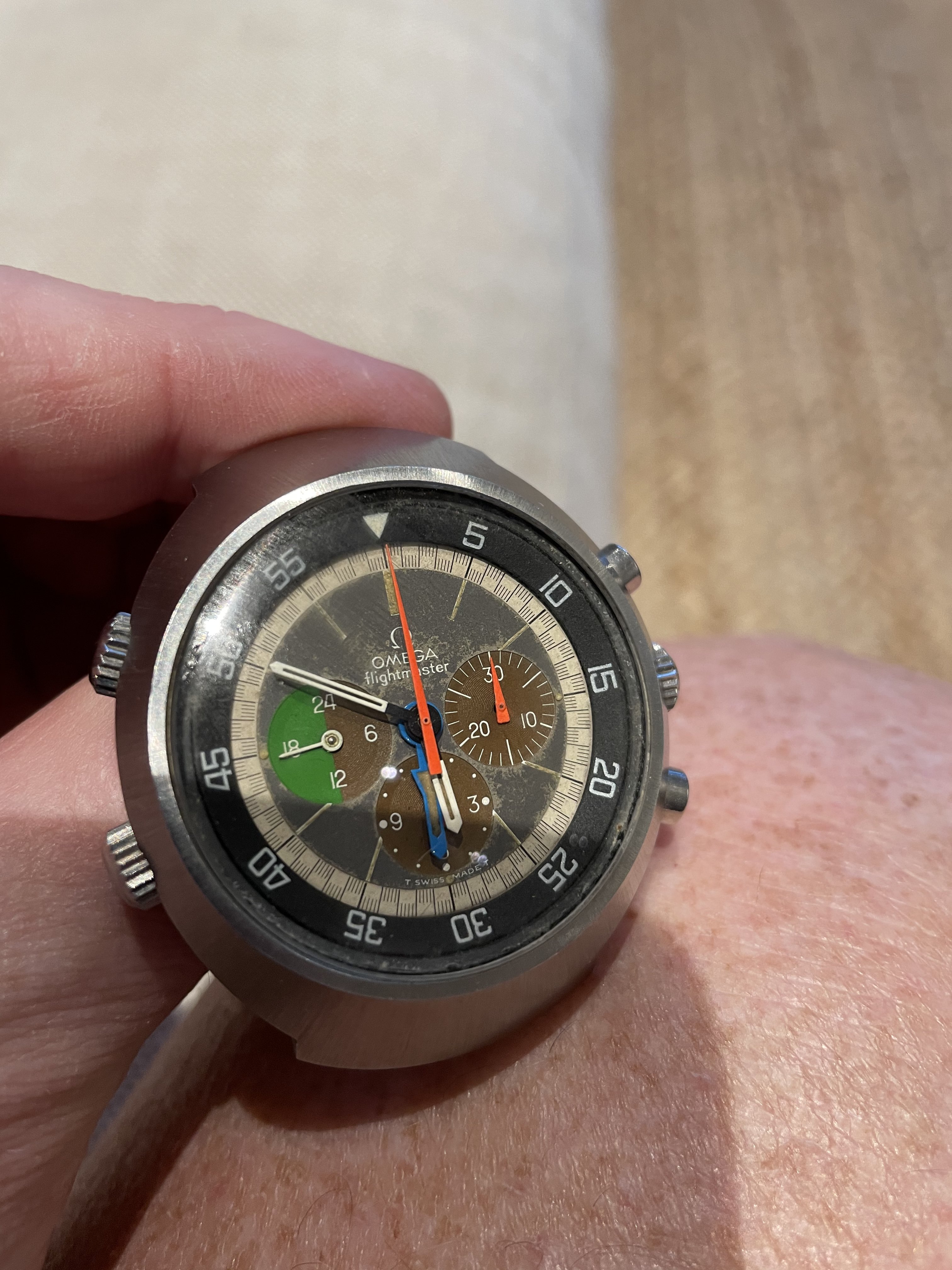

Here's my 911, no clue about its history. 馃檨
Hi it could be a 145026 with a transtional dial
