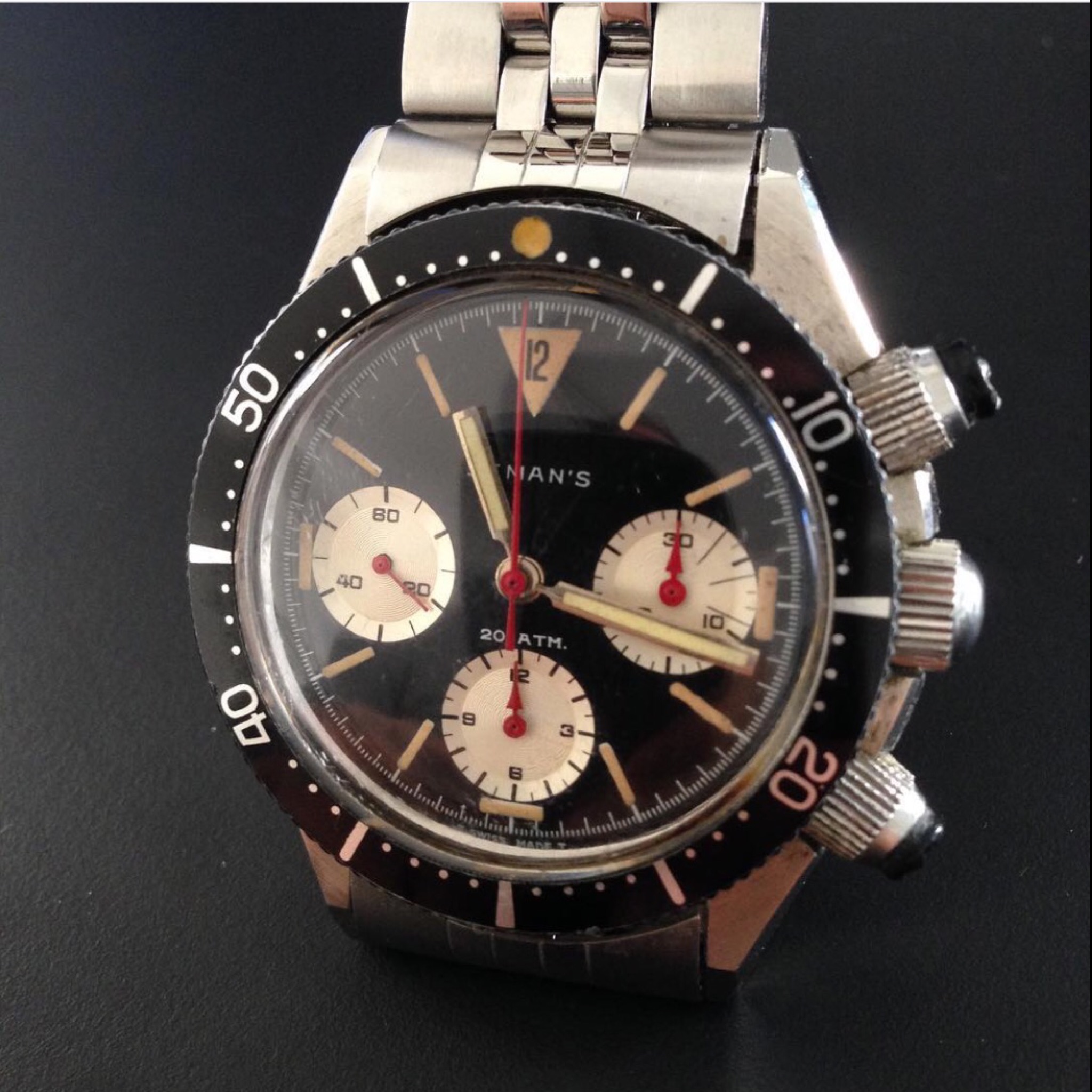

Thread revival, but justified.
Found this on the inter web. A Seamen's (unfortunate name, yes) V72 chrono.
I suspect this watch is the correct home for the bevelled lugged imposters.

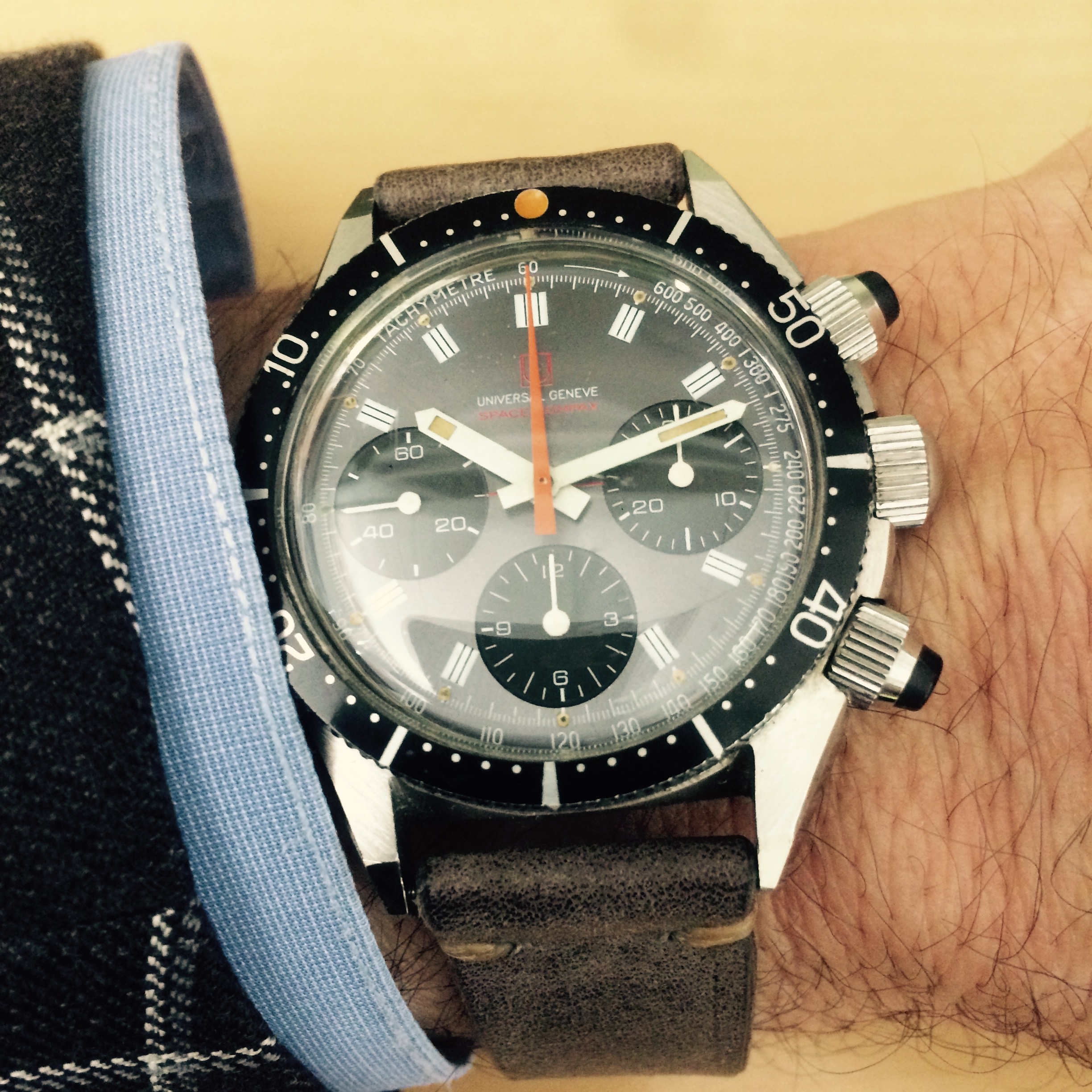

Spotted, on my wrist, the 'fake' Space Compax
...or the fake 'Space Compax'

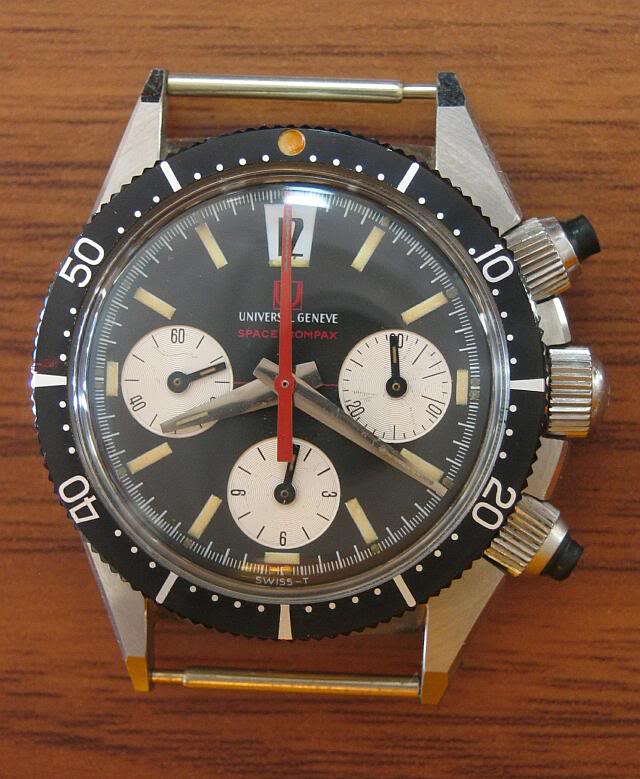

Here's one with Mk2 dial , handset, bezel and pushers but the 'fake' case ...
very high quality reproductions of this dial are available out of Vietnam
yes I've seen them on eBay. But I haven't seen reproductions of a mk1 dial

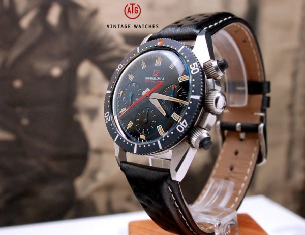

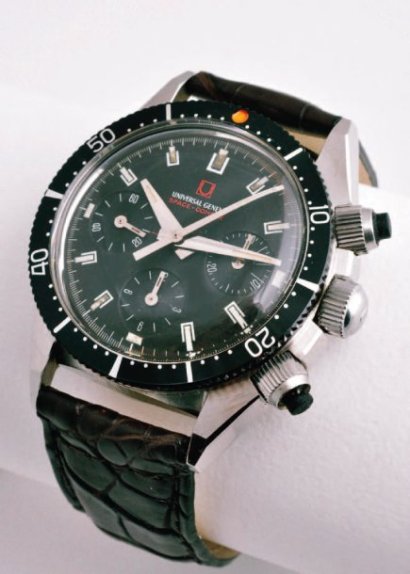

and a couple more examples where everything appears legit / genuine but for the 'fake' case

Please understand I'm not trying to be argumentative. I just find it very interesting that there are so many variants here with the 'fake' case, and while yes it is possible to get a high quality reproduction mk2 dial out of Vietnam, bezels, complete handsets, crowns and of course these pushers are not being reproduced, as far as I am aware ...
Thanks for letting me kick this around here
If you really want to prove that. Perhaps you can try to find a UG ad or catalogue from the time with the said case. There are plenty of UG issued documents on the space compax from that time period (with pictures) but so far I think there is none with the case shape you are talking about.
