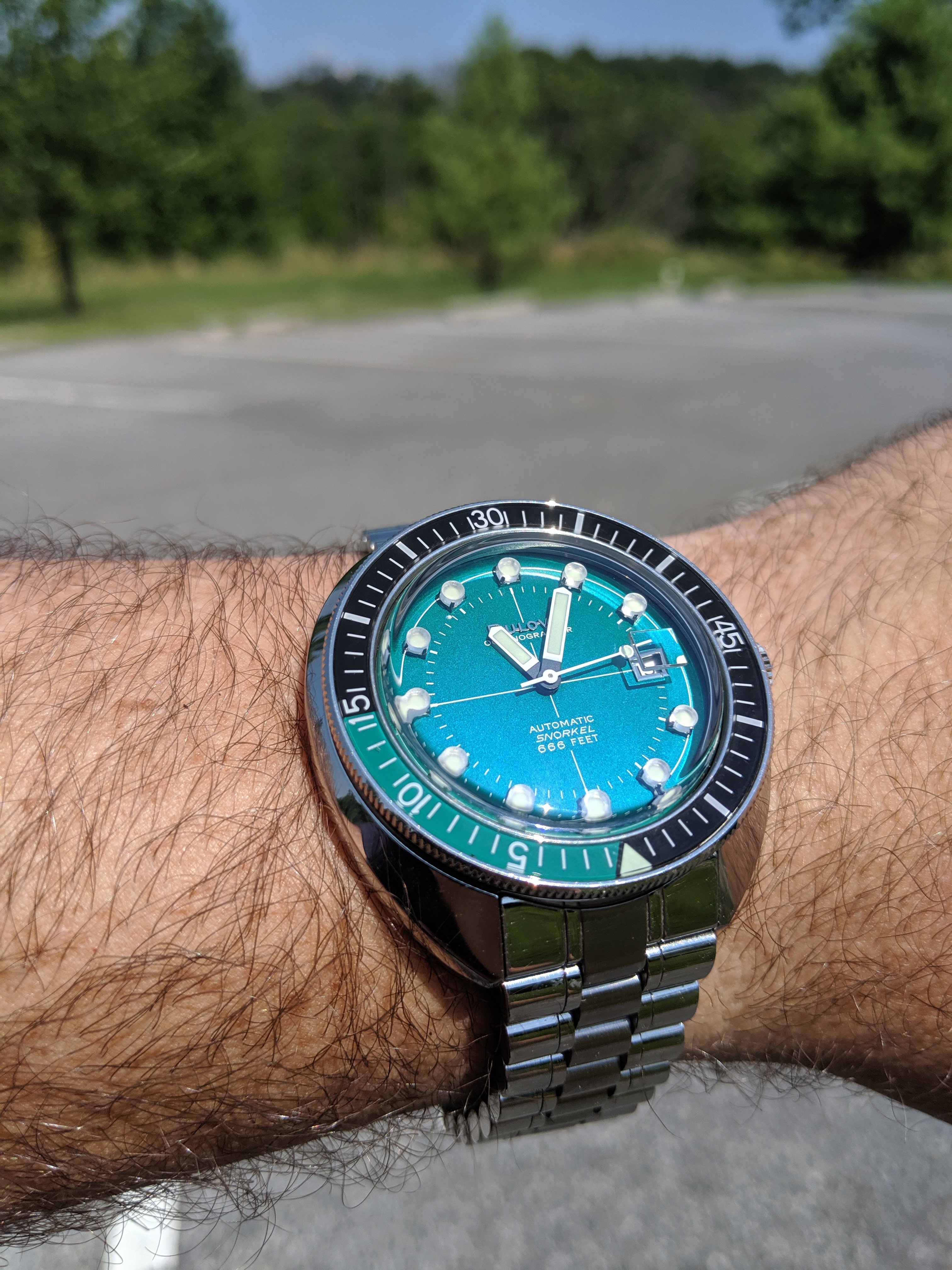

This is the only watch I've ever bought new. Got it just so I don't have to worry about whether the seals are going to fail.
Now that’s a watch with which you can Snorkel!
Nice! Just remember that water resistance is not a permanent feature, so it will require maintenance at some point...
And I don't have to get bent out of shape when my toddler buries it in the sand. Which happens all the dang time 😵‍💫.
Oh for sure! I think it's only got a 2-year warranty, being a relatively cheap reissue of the original.
