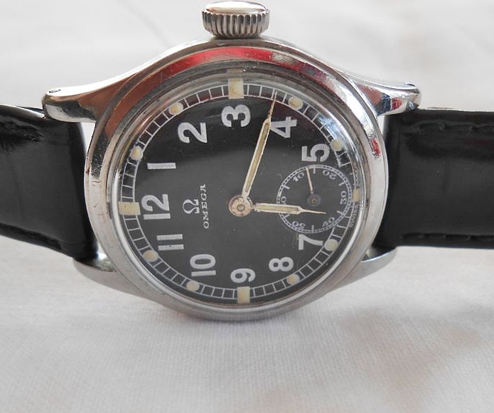

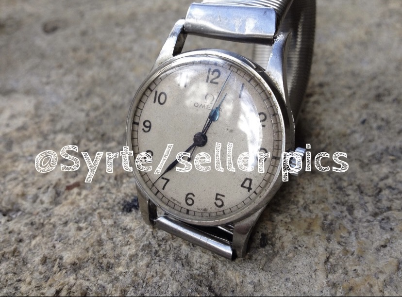

Hi guys,
can you please leave some comments on this watch. crown original? dial ? Should the radium look like this?
The diameter is 32 mm.
( I have not contacted the seller)
Merci!
2,270
15,727

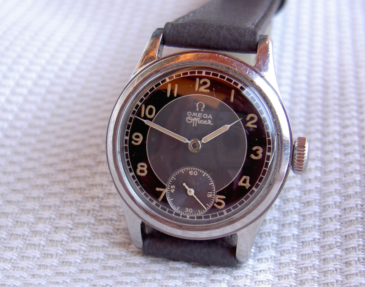

Looks like a Omega officer case which was issued to the Swedish military.
Dial repainted and crown wrong, and they are rather 30.5/31mm

Yeah, crown was suspicious (but nice ;-) )
How did you identify the redial so quickly? The dark black colour (is it always matte?) ? The print? The lume-dots?

Because no omega officer dial looks like that

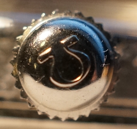

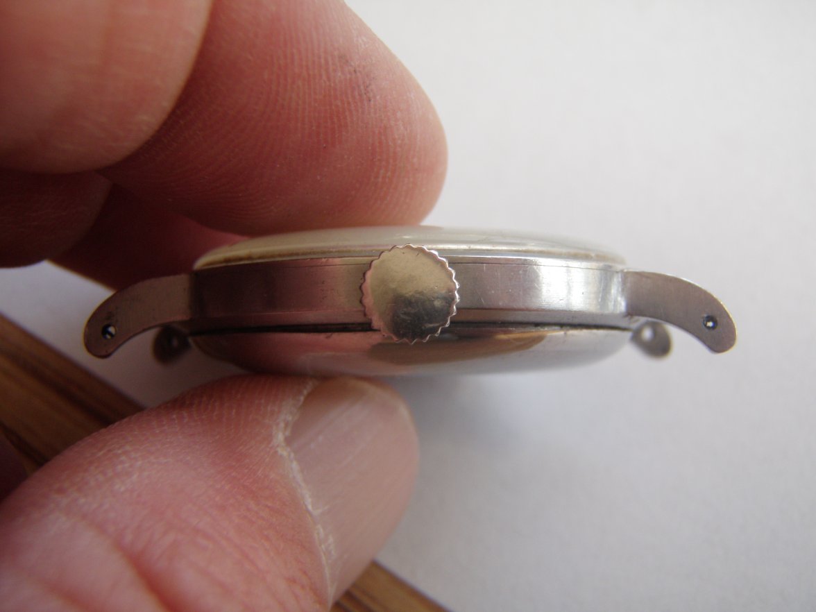

Omega did not have signed crowns during this era
The early 1940s? You sure about that? Might be the case for this model but I'm not convinced that's the case across the board.
2,270
15,727
Yes my understanding is that all Omegas in the early 40s did not have signed crowns, they started to use signed crowns mid to late 40s.
Centenary and Seamasters that both was introduced 1948 (?) did have signed crown but earlier models than those I'm not sure.
In the case of Omega Officer and Suverän, I'm 100% sure the did not have signed crowns at least 😀

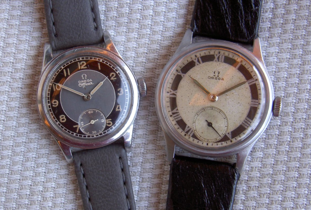

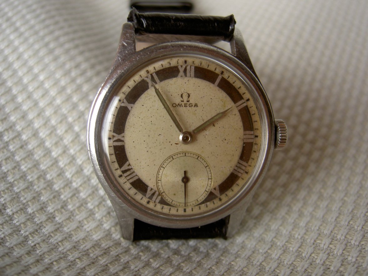

At least one reference had a signed crown.

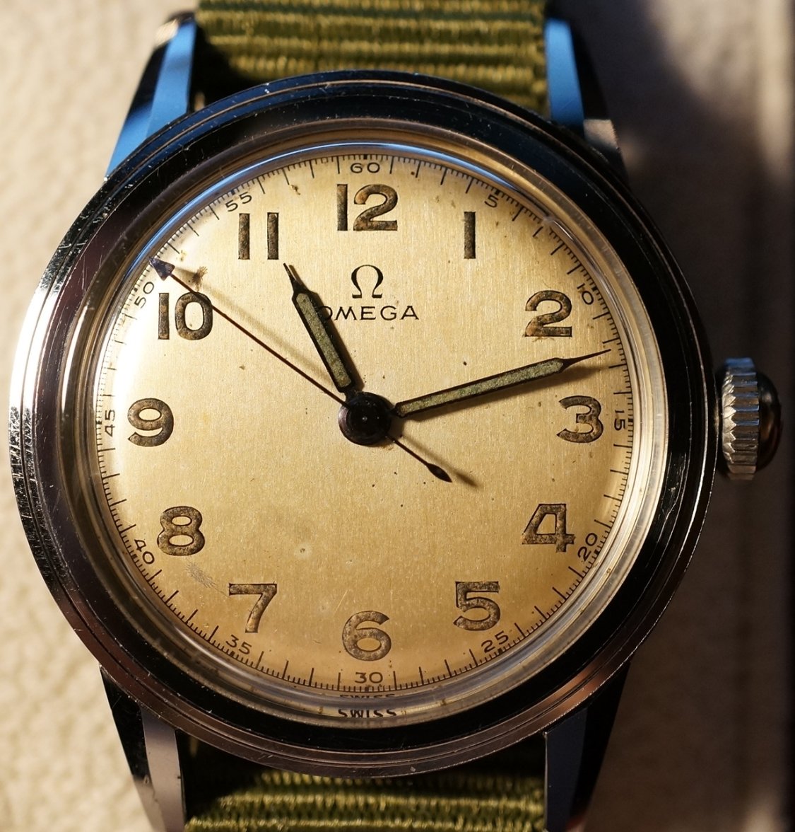

Mine from 1939-40
R-17.8 SC early run with nickel finish 9.7M serial

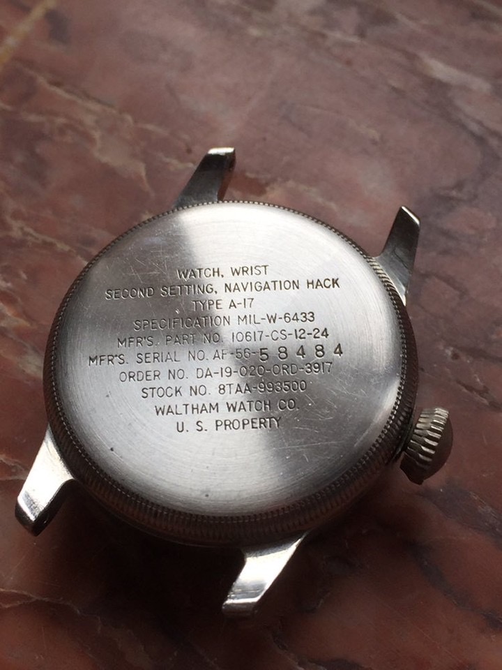

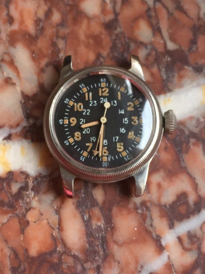

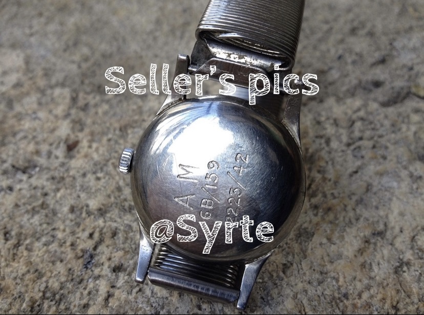

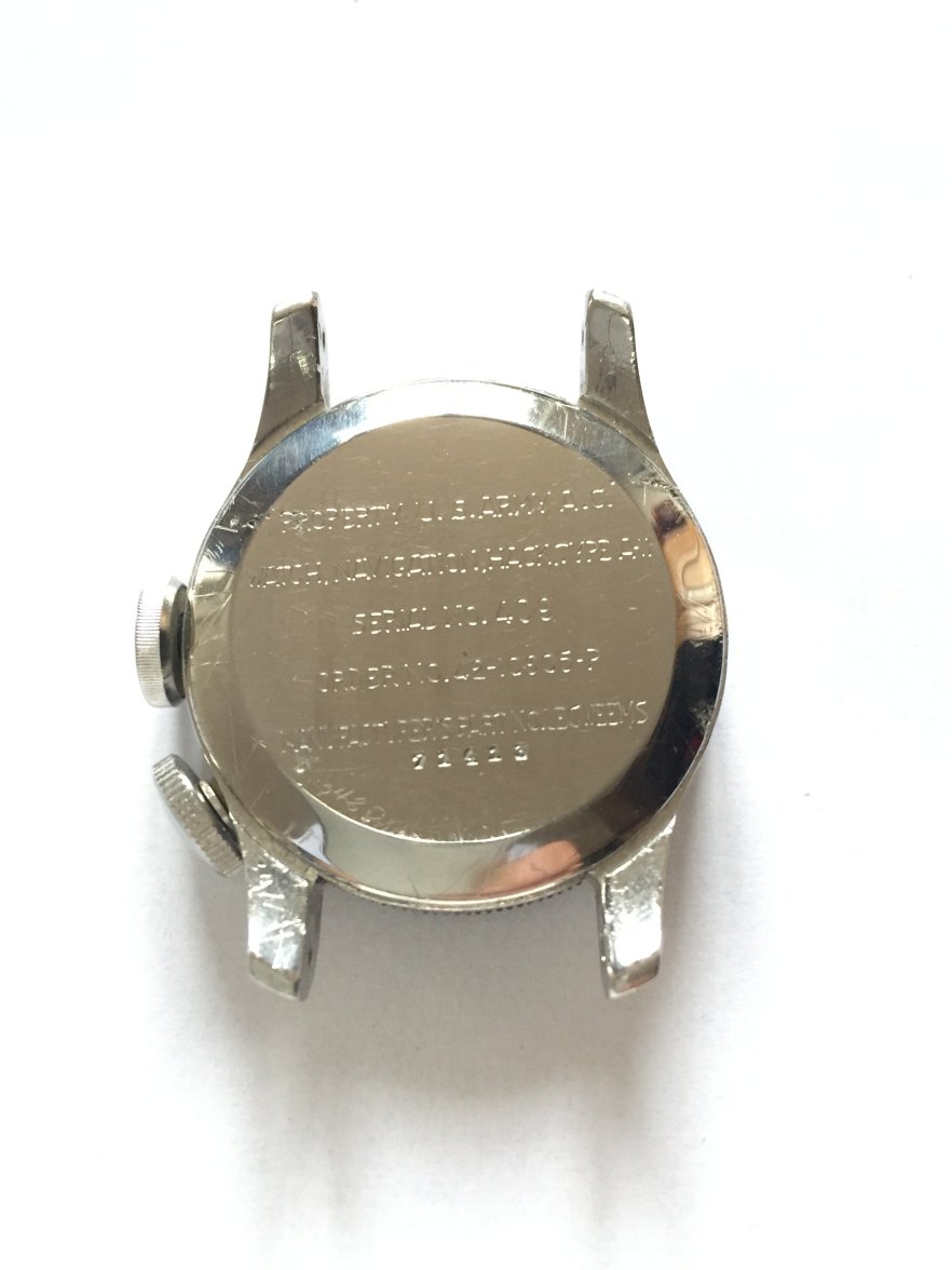

An issued watch is a watch that’s not sold, but that the government attributes to certain members of its armed forces for purposes of fulfilling their missions.
In the modern era and starting in the late 1930s, issued watches have case back markings which are known and recorded, and from which one can identify the country it belongs to, which branch of the military has issued it, and issue serial numbers which may or may not indicate the year. Also it may include certain specifications or contract numbers.

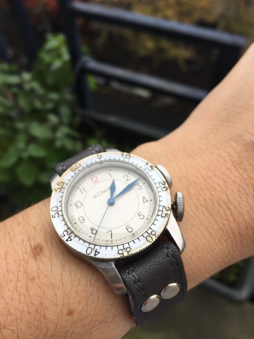

The watches below - all mine or were— are examples of various issue marks, some more detailed than others.
-The top watch is a US air force specification A17 from 1956-
-the second watch is a British Air Ministry (ie Royal Air force) watch from 1942, therefore marked “AM” 6B/159 (which was the chronometer contract specifications for those pilot watches), with the 1942 serial number.
The last one is a Le Coultre Weems A11 from 1940
Which is the US Army Air Corps contract specification for pilot watches. At one point the US Army Air Corps becomes the US Air Force and the markings change, also the A11 specs evolve and provide for a black dial which is why the D-day pilot watches are black.
For more on all that, you will find tons of info on MWR (the Military Watch Ressource forum) - but in short, the above is not issued or military.

Going back to the OP watch, it is a real Omega but a faked military watch.
the dial has been refinished as an imitation of the dial design on two famous models of ***British*** Omega military watches, one is the Omega WWW from WW2 (army), the other is the Omega 53, which is a central seconds pilot watch from 1953 made for the RAF.
Google those and you will see.

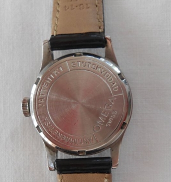

A rough translation from Swedish
“In the service of the crown"
Officer & Suverän
Officer model
Although Sweden declared itself neutral, during the Second World War the Army wanted to ensure that its officers could measure time effectively and therefore ordered a large number of customized watches that Omega called Officers. The case back was engraved in Swedish with Antimagnetic-Water resistant-Shockproof.
A civilian variant of these watches was called Suveran and sold to the public directly by the Swedish state. Anyone who wanted to support his government in a period of profound crisis could therefore do so by buying a Suveran and showing off their patriotism on their wrist. An initiative, but much more expensive, similar to that of colored rubber bracelets which, in the early years of this century, were connected to forms of charity.”.
