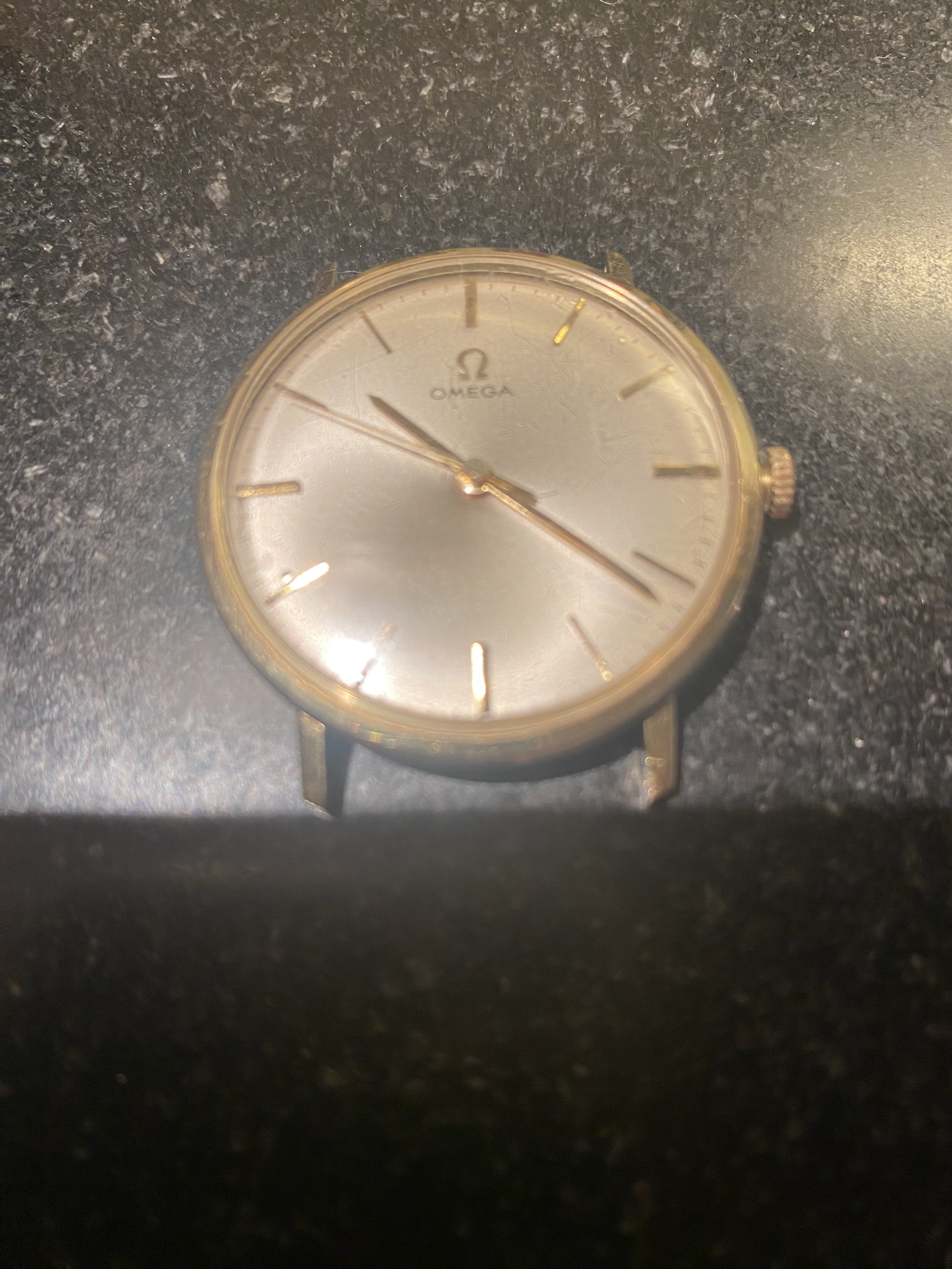

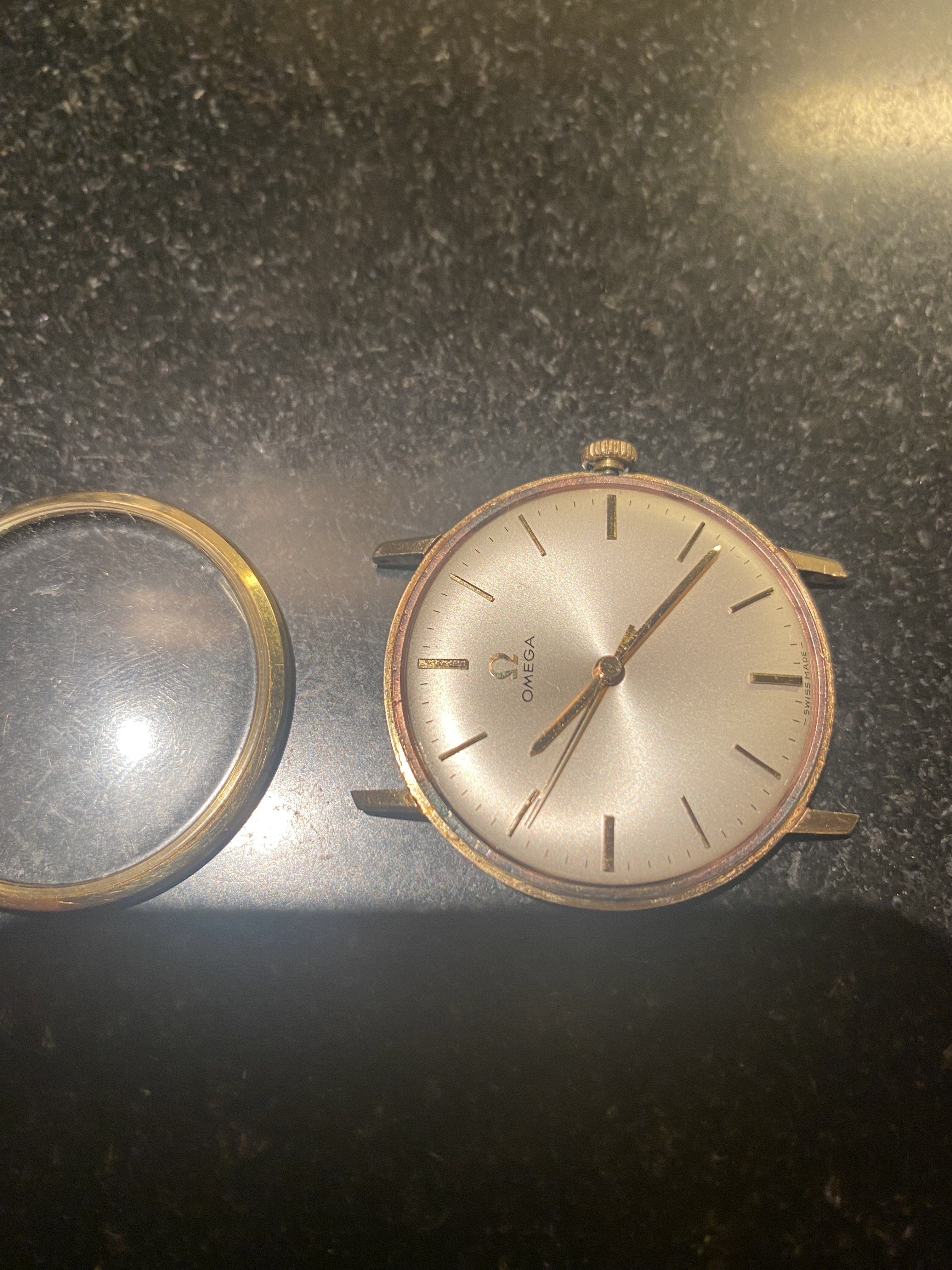

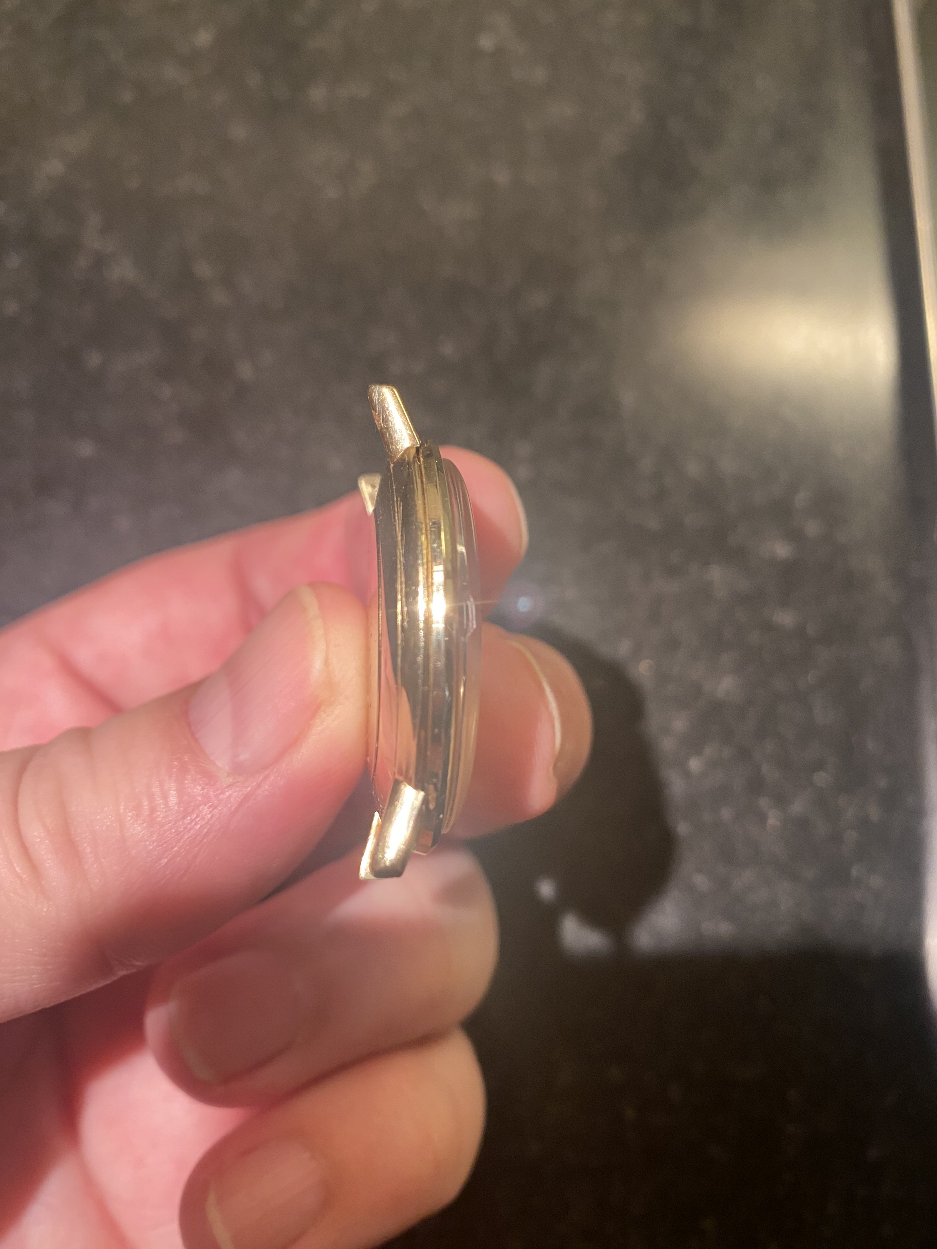

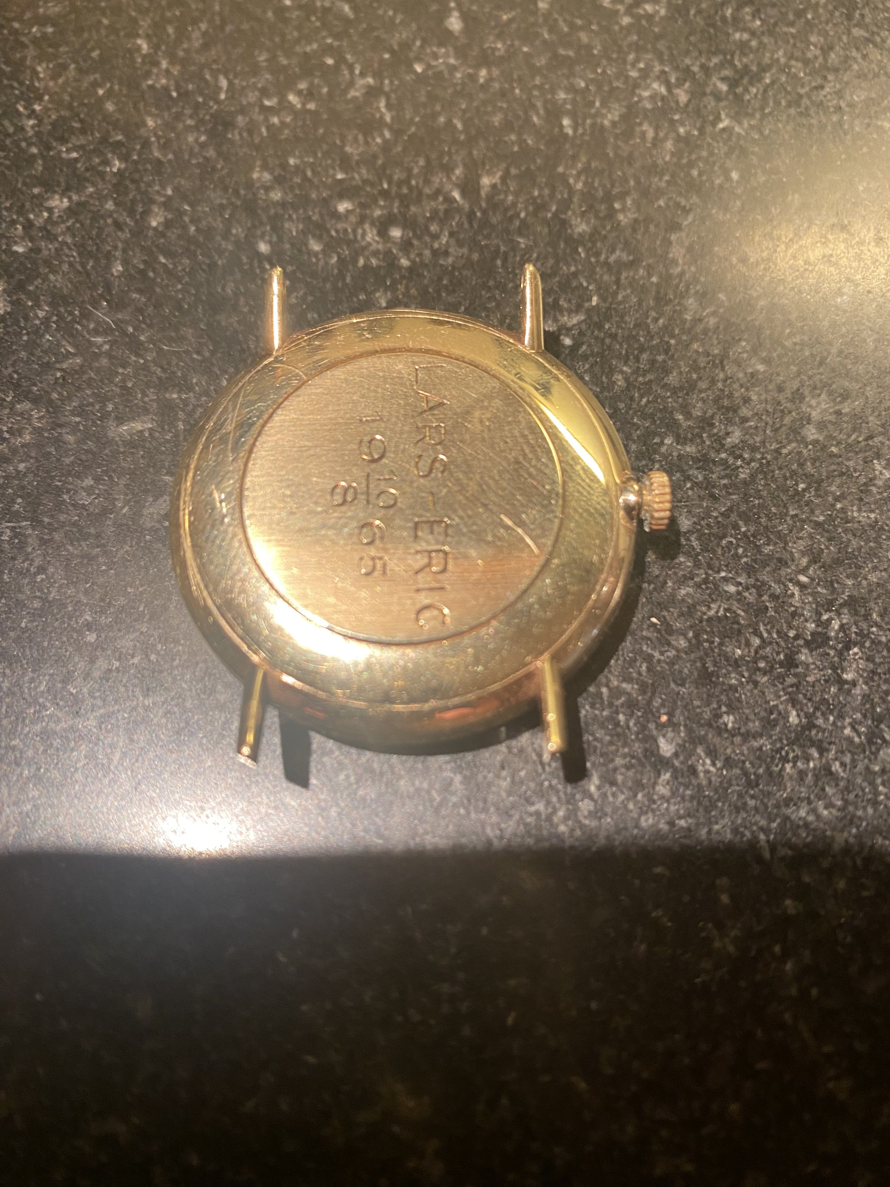

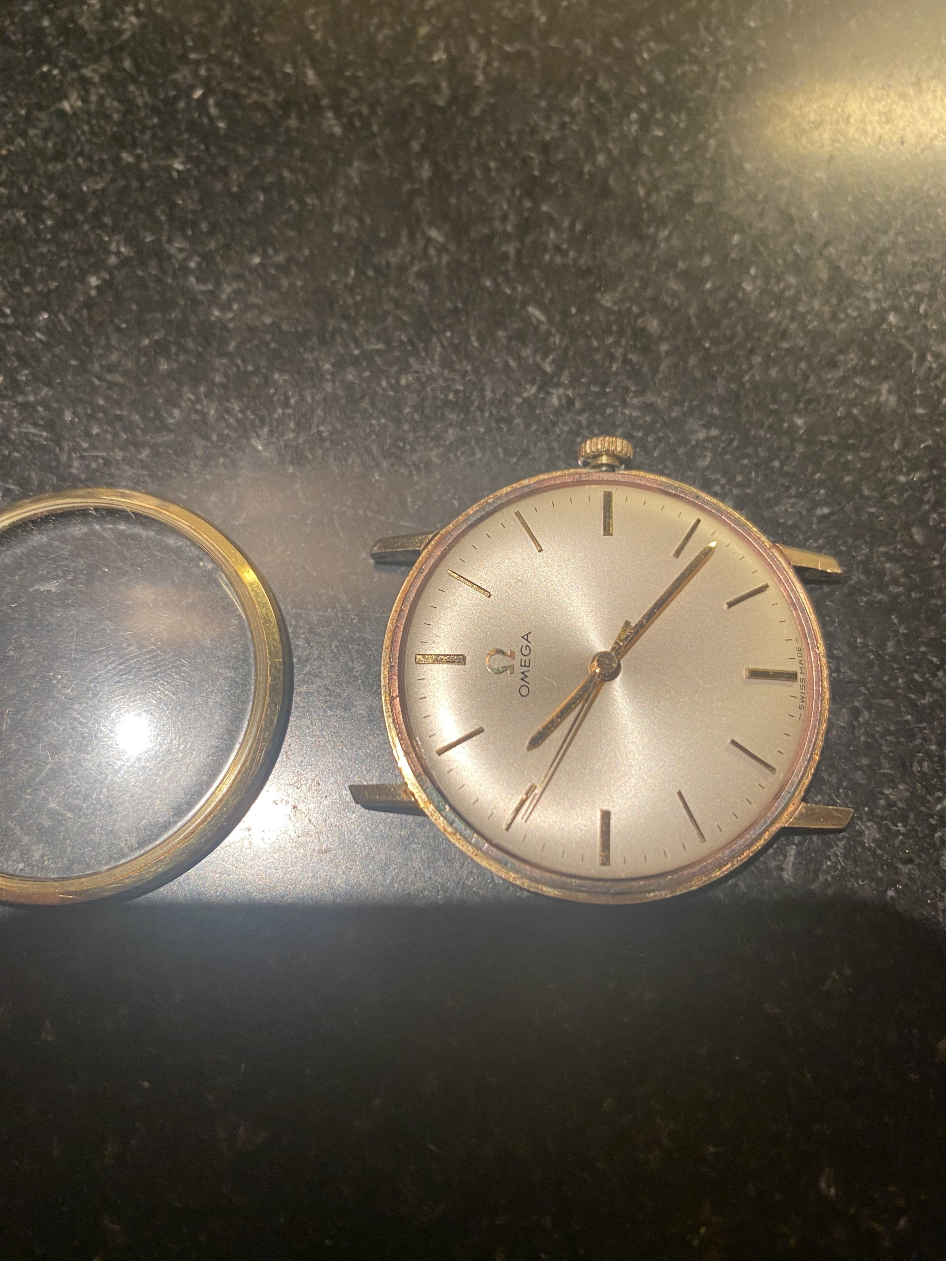

Have an old vintage Omega watch. It’s a thin dress watch in, I think, 18k.
I can’t find any visible notches so I have a hard time understanding how to open it up. It runs poorly and just want to get an idea of the shape of the movement and also get to know a little bit more about it since it has been passed on to me by my grandfather.

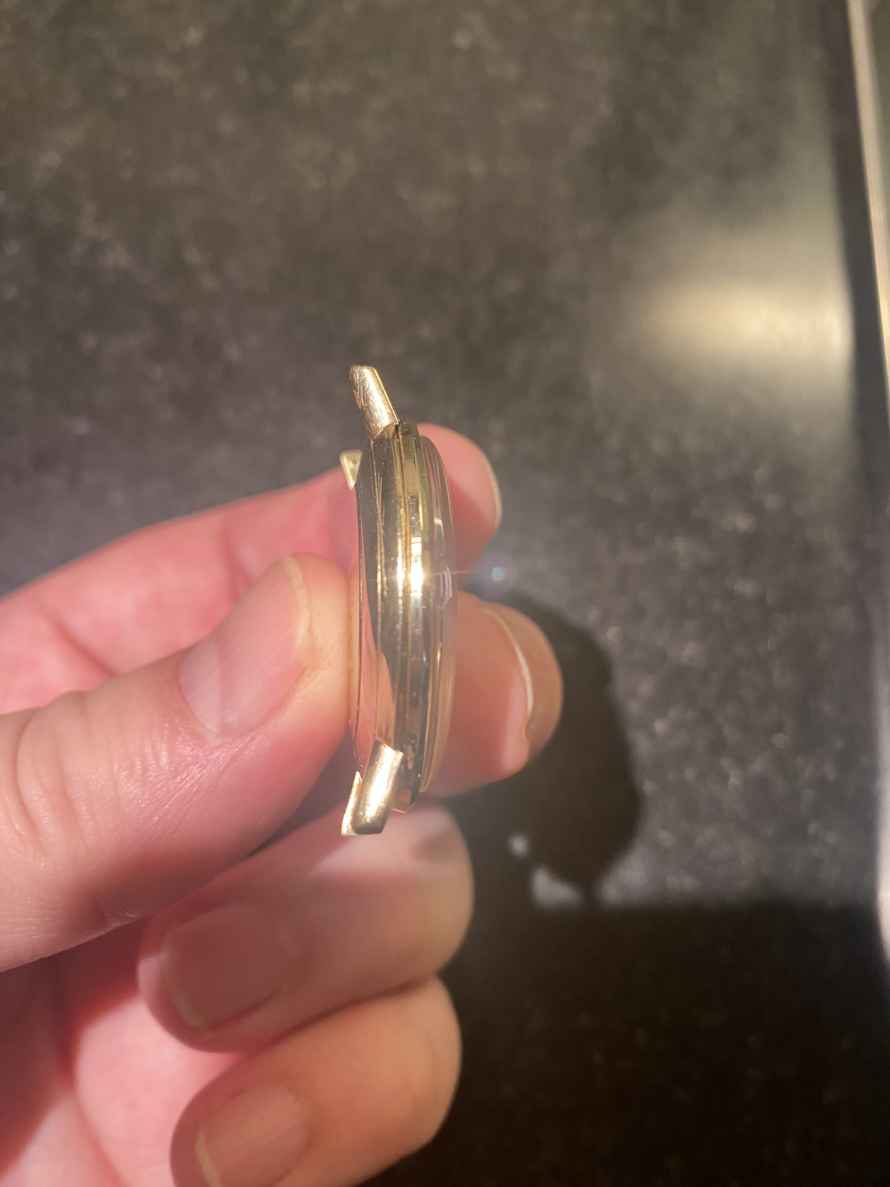

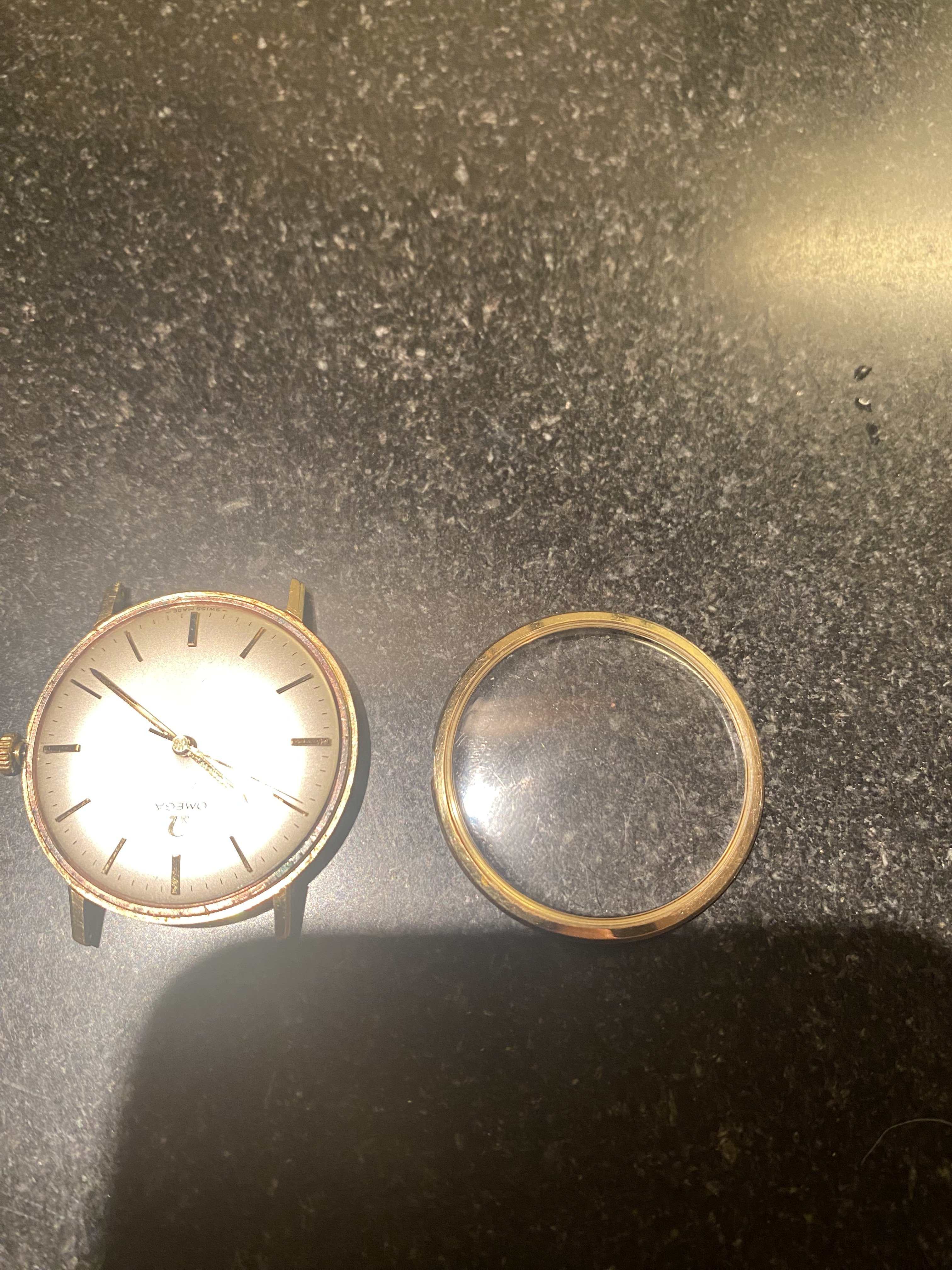

After some trial and error I finally managed to open the front with a thin razor blade in the only thing that sort of looked as a thin thin line on the side of the case. What I got lose is the the crystal and a thin frame/ring in gold.
The stem/crown is now the only thing, I guess, that holds the movement firmly in place in the case back. So I guess the next step is to some how open the back and then be able to remove the stem/crown by losening a screw or push down a small button.
I just don’t see anywhere to put a razor blade to start to try opening the case. Any advice very much appreciated.
I attach some photos, please let me know if you need any additional photos that might help us

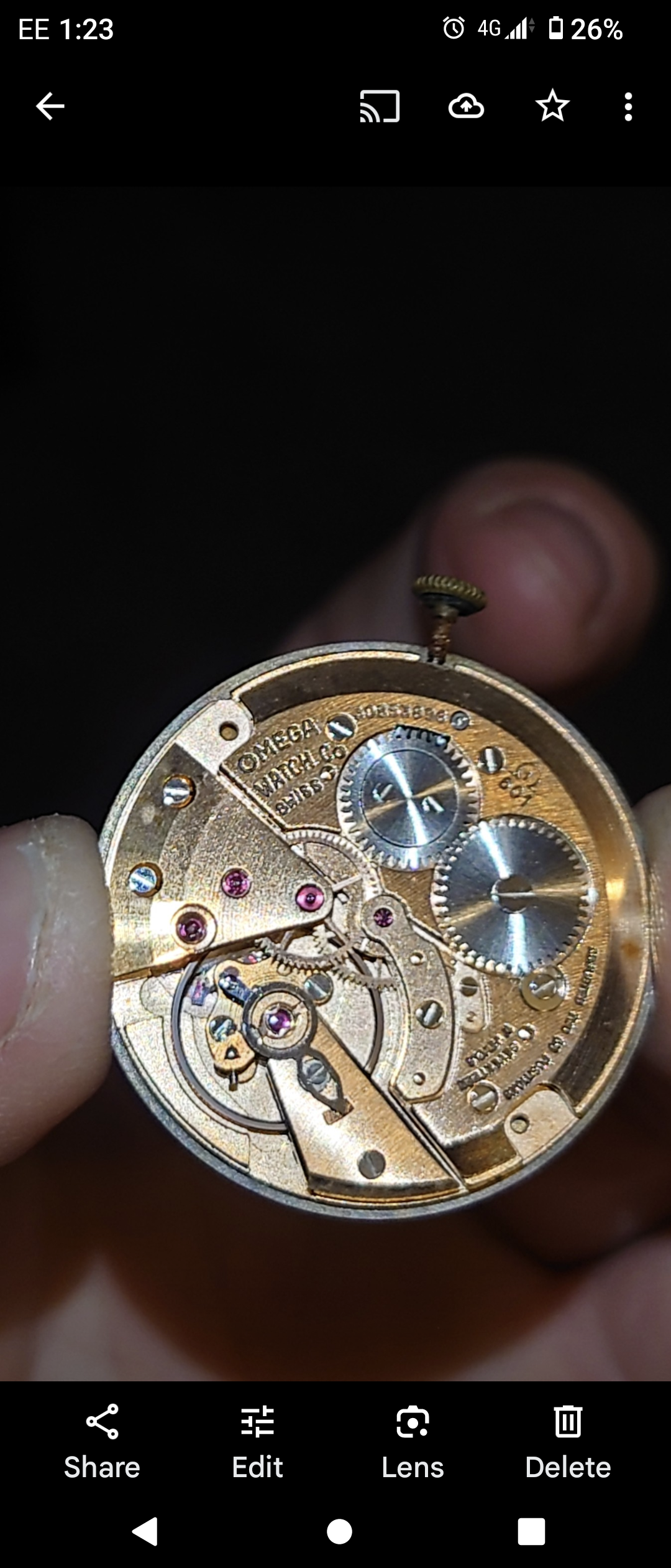

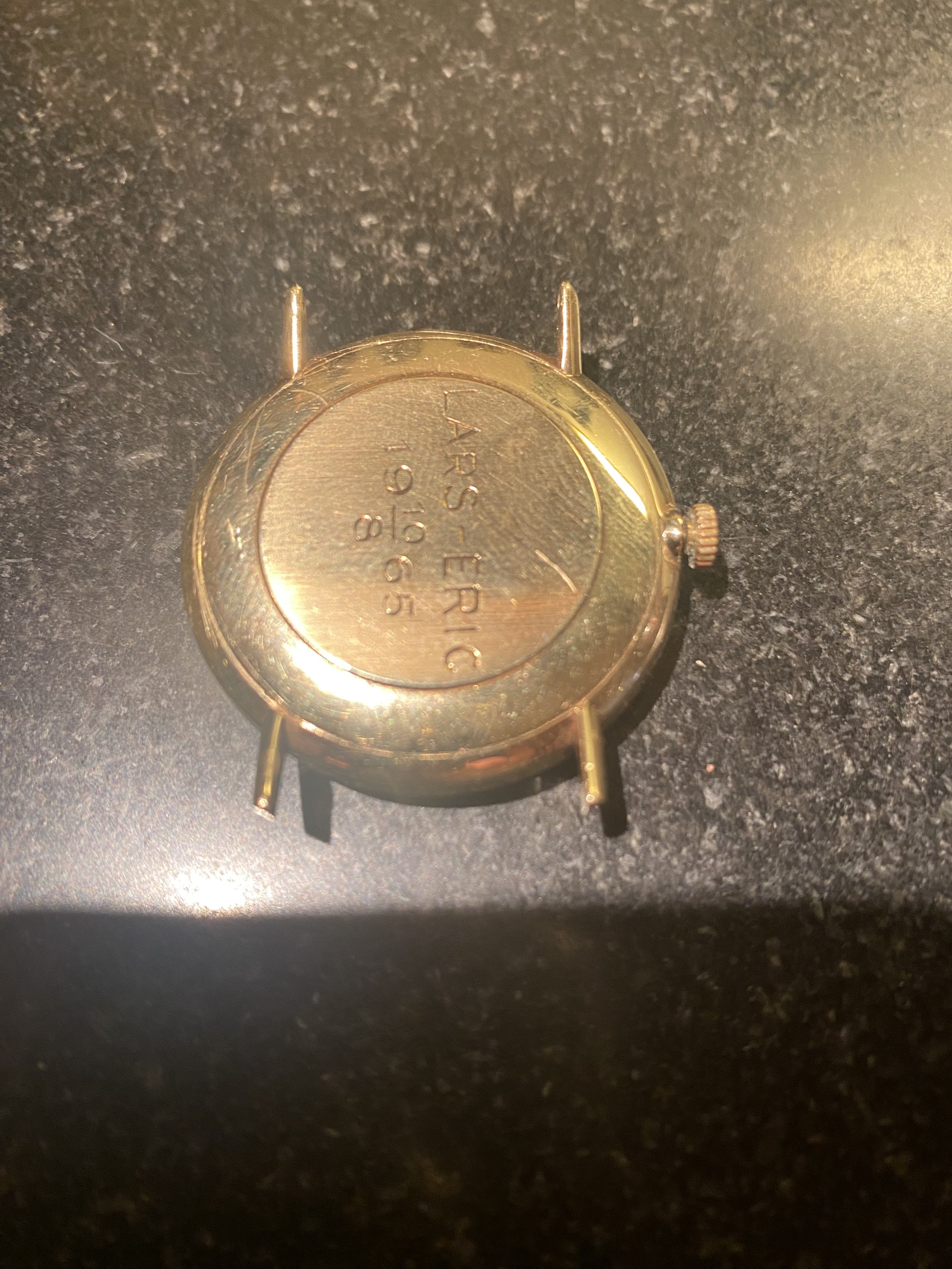

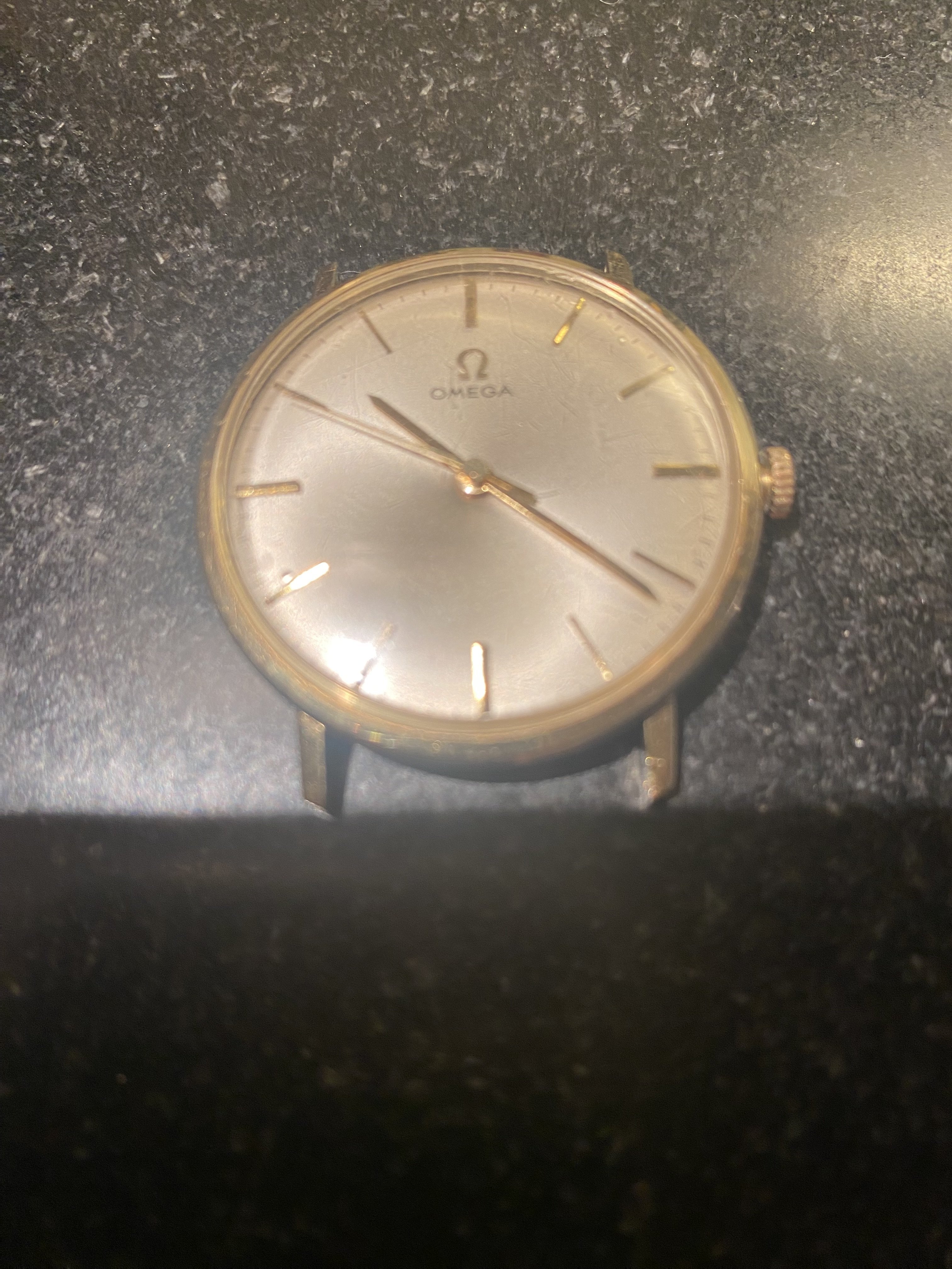

Thanks, the crystal is out. It came with the gold ring (picture 4).

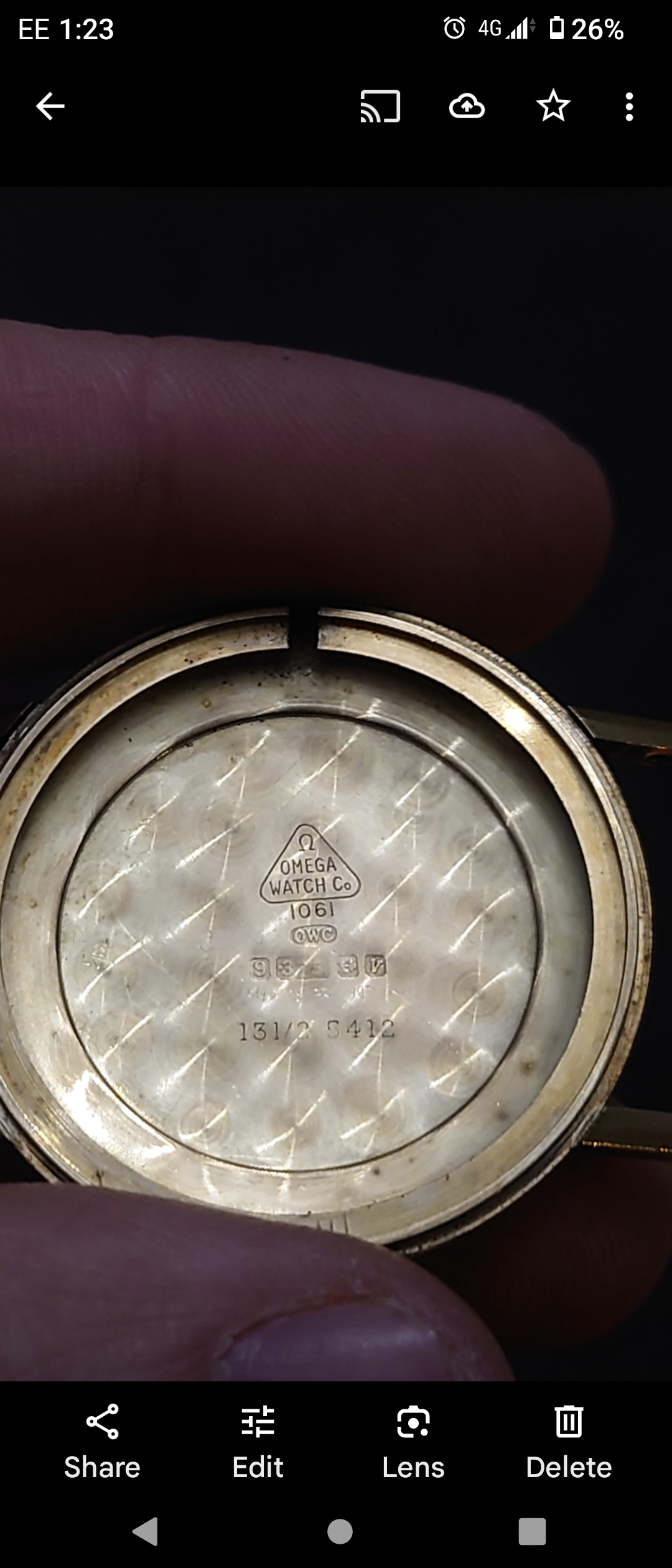

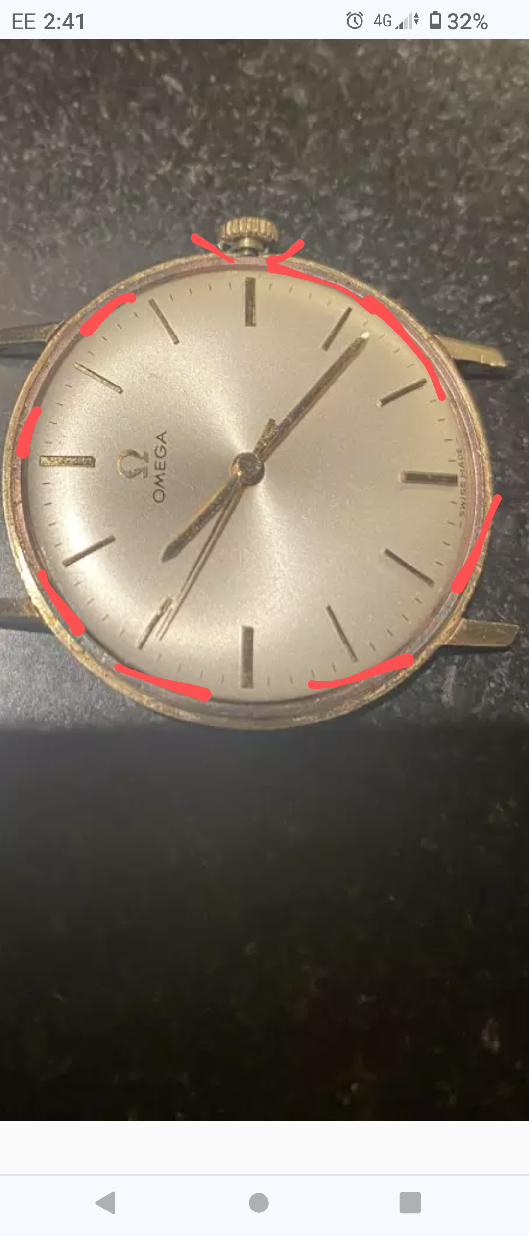

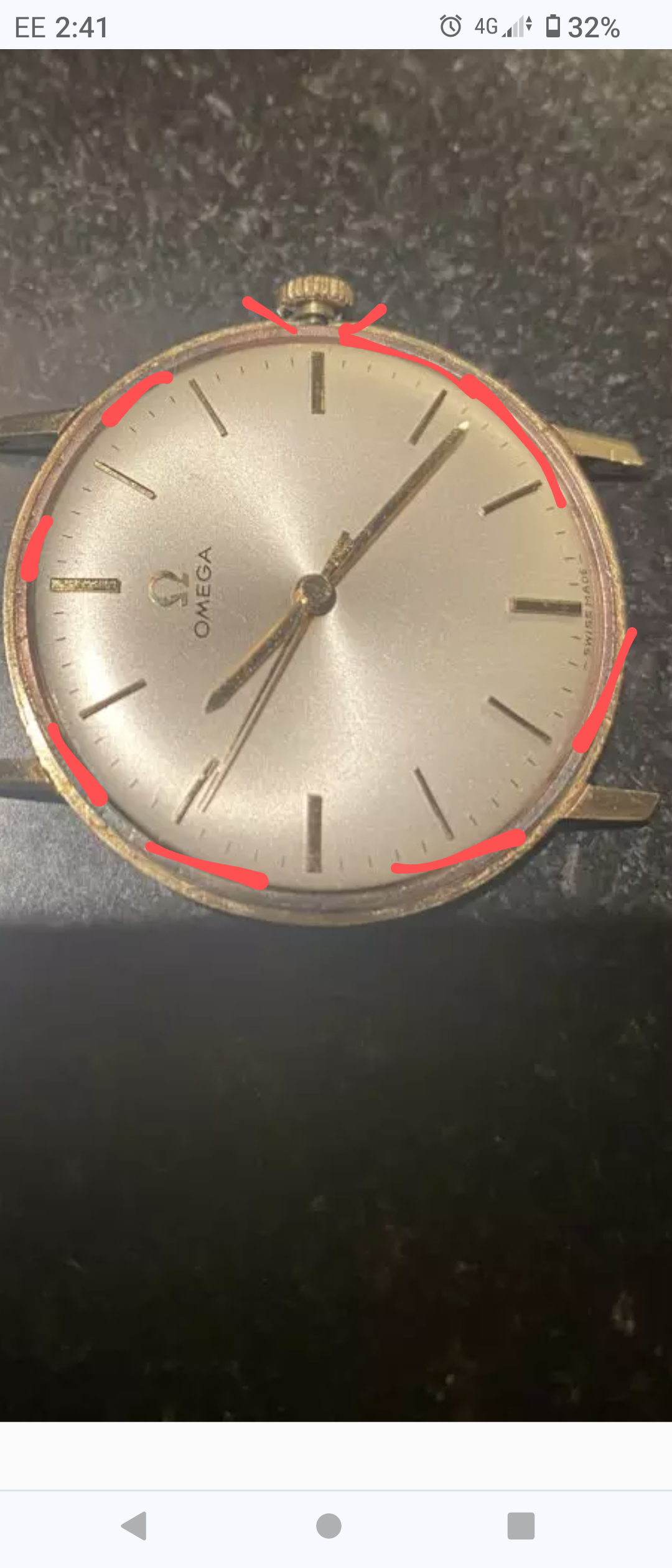

Found another picture. Can it be that the rose/bronzy “ring” between the case in gold and the dial is part of the movement and I should try to work my way around between the rose/bronzy and gold part?

In your thread heading, you identify your watch as ‘1940 - 1960s'. The fact is that pretty much anyone on OF would have guessed this is a 1960s watch. A further clue is that the engraved sentiment appears to be '10 August 1965’.
Anyway it’s a nice looking watch, probably gold, which is undoubtedly worth a few hundred dollars and well worth treating sensibly.

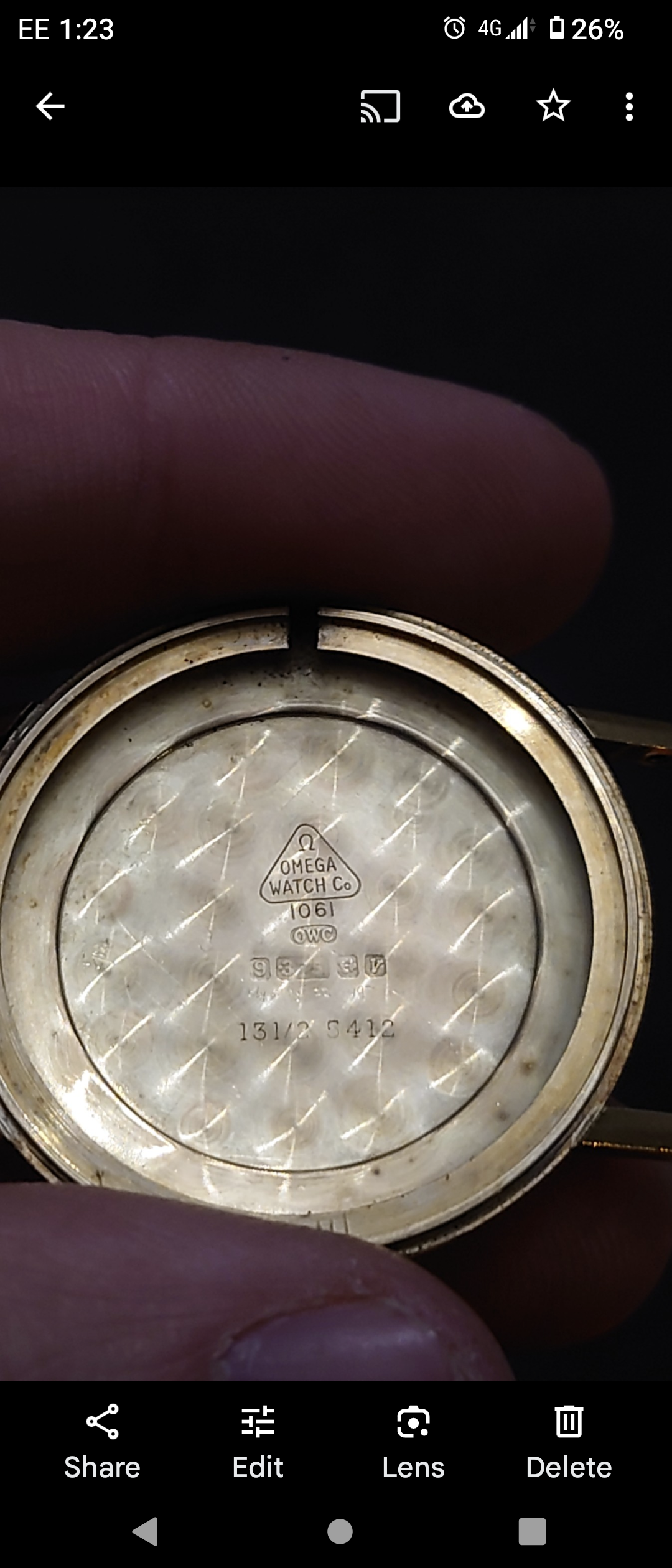

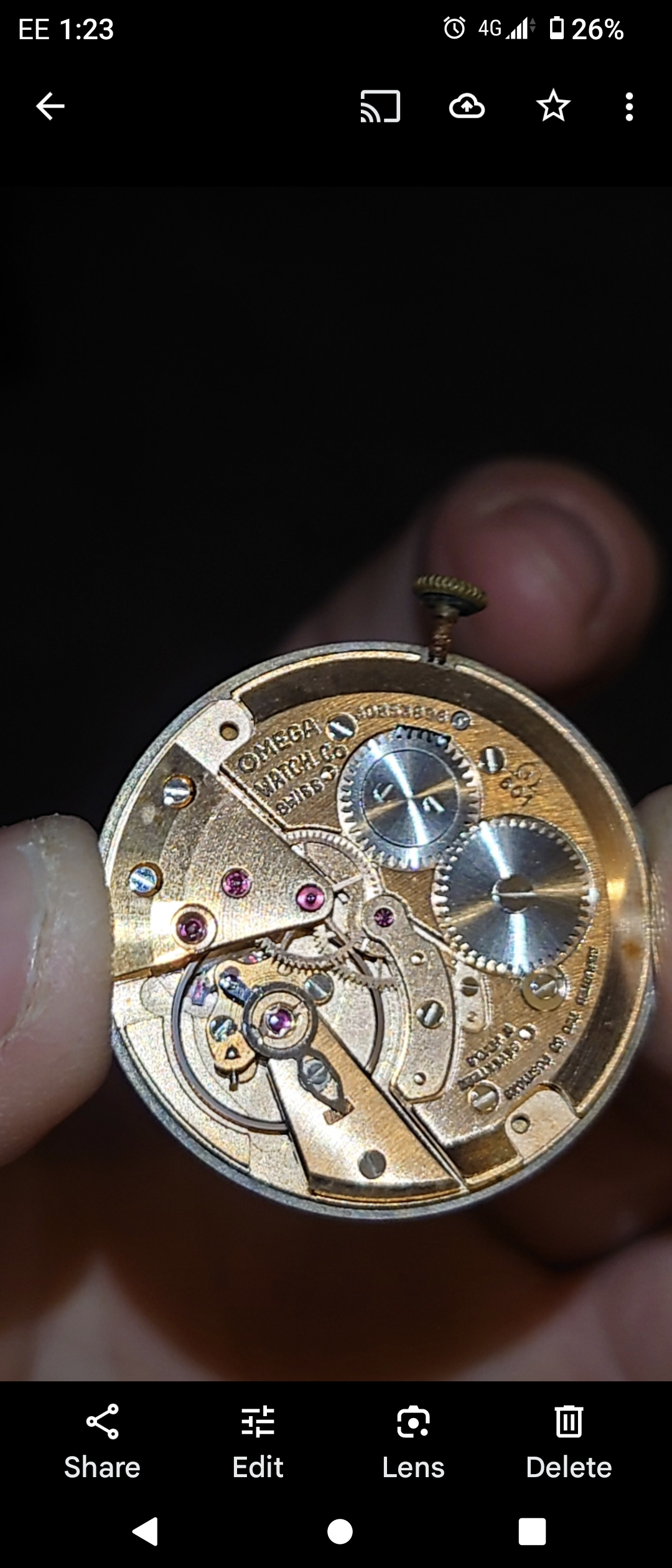

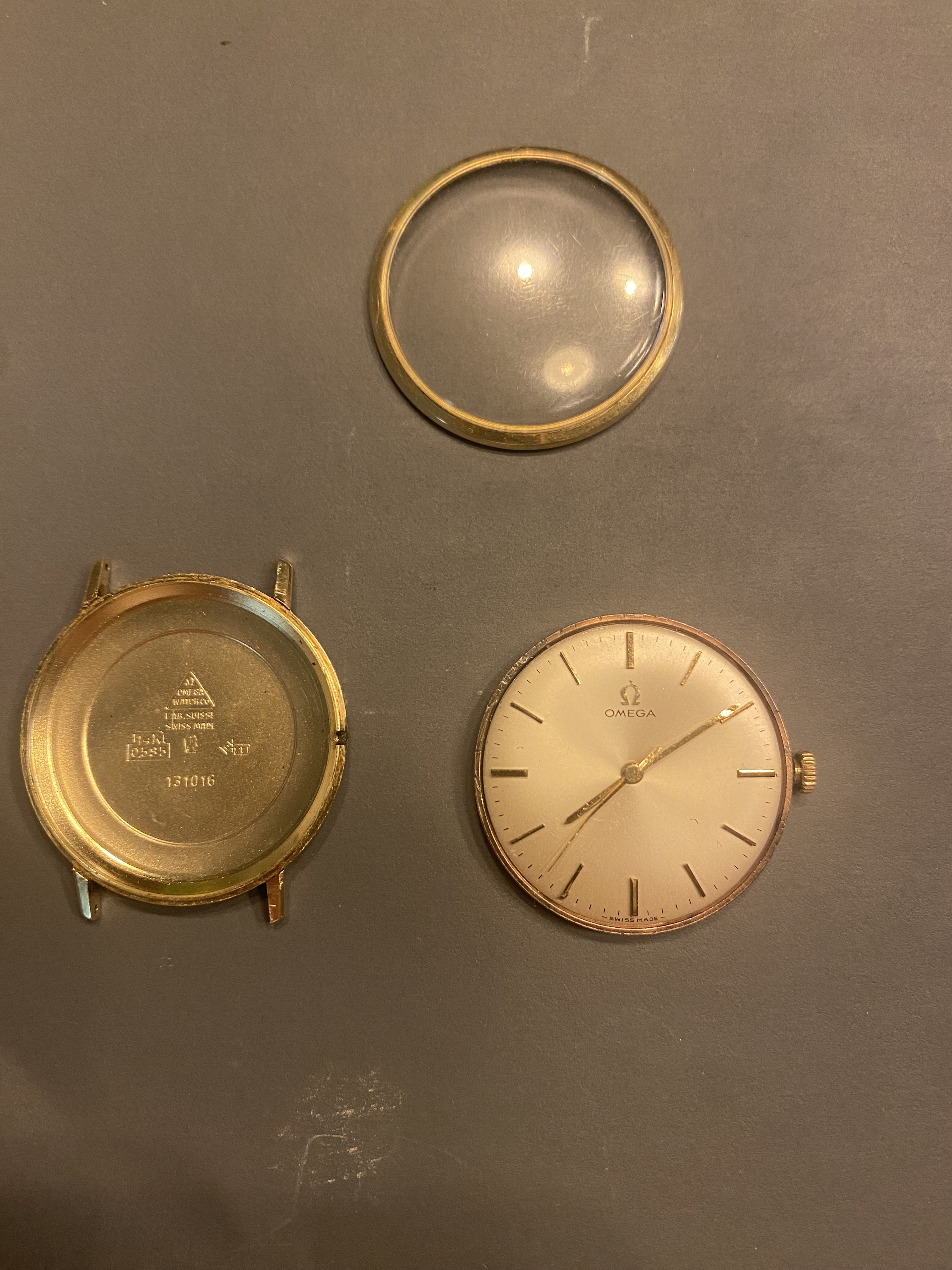

I don't believe it's a split stem I don't think you have to remove it I think it'll be a 601 cal as you can see if you look carefully the case on the back is separate it's got like a spacer around the outside here's a photo of mine out of the case so you can see yours mine

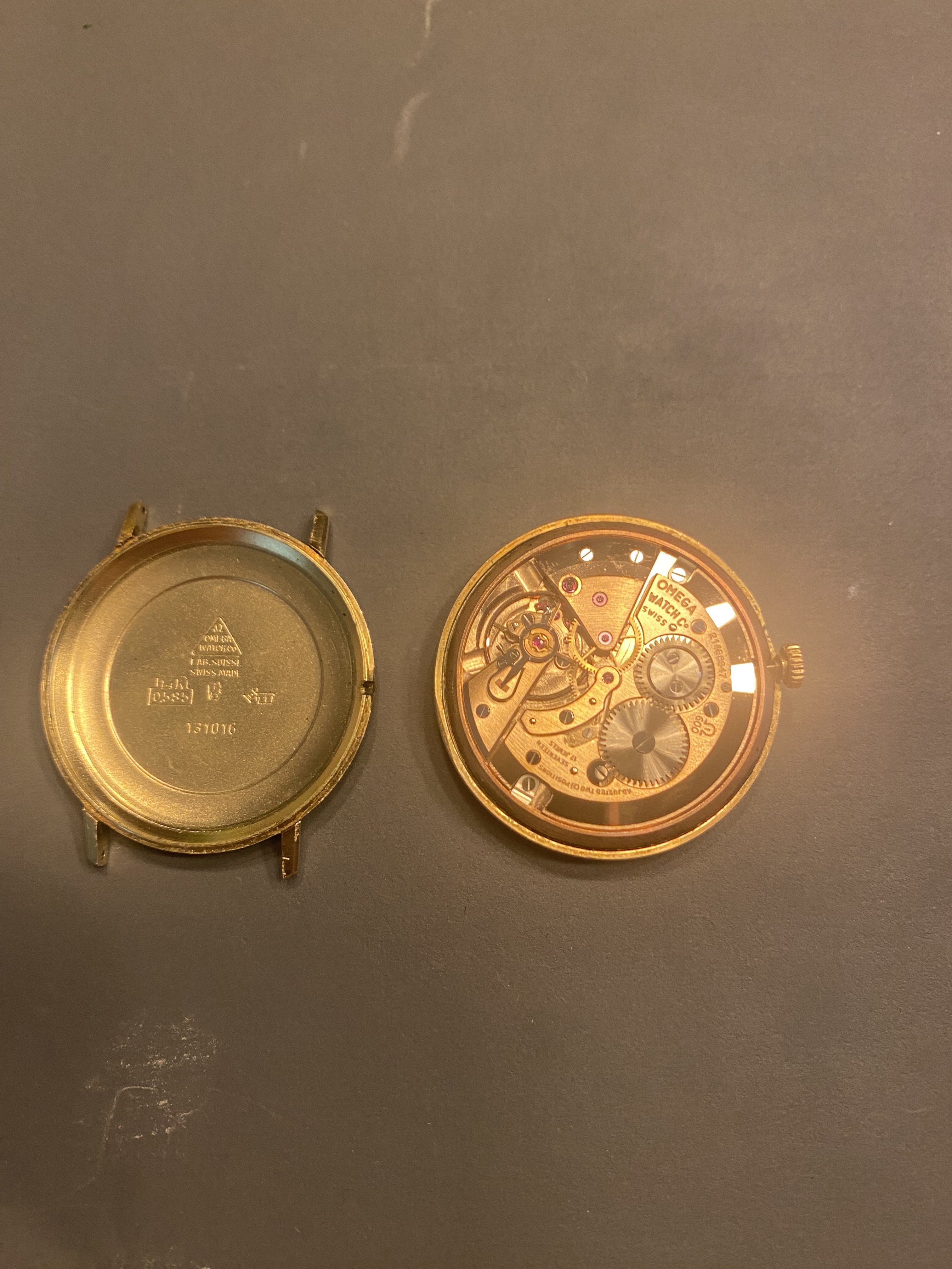

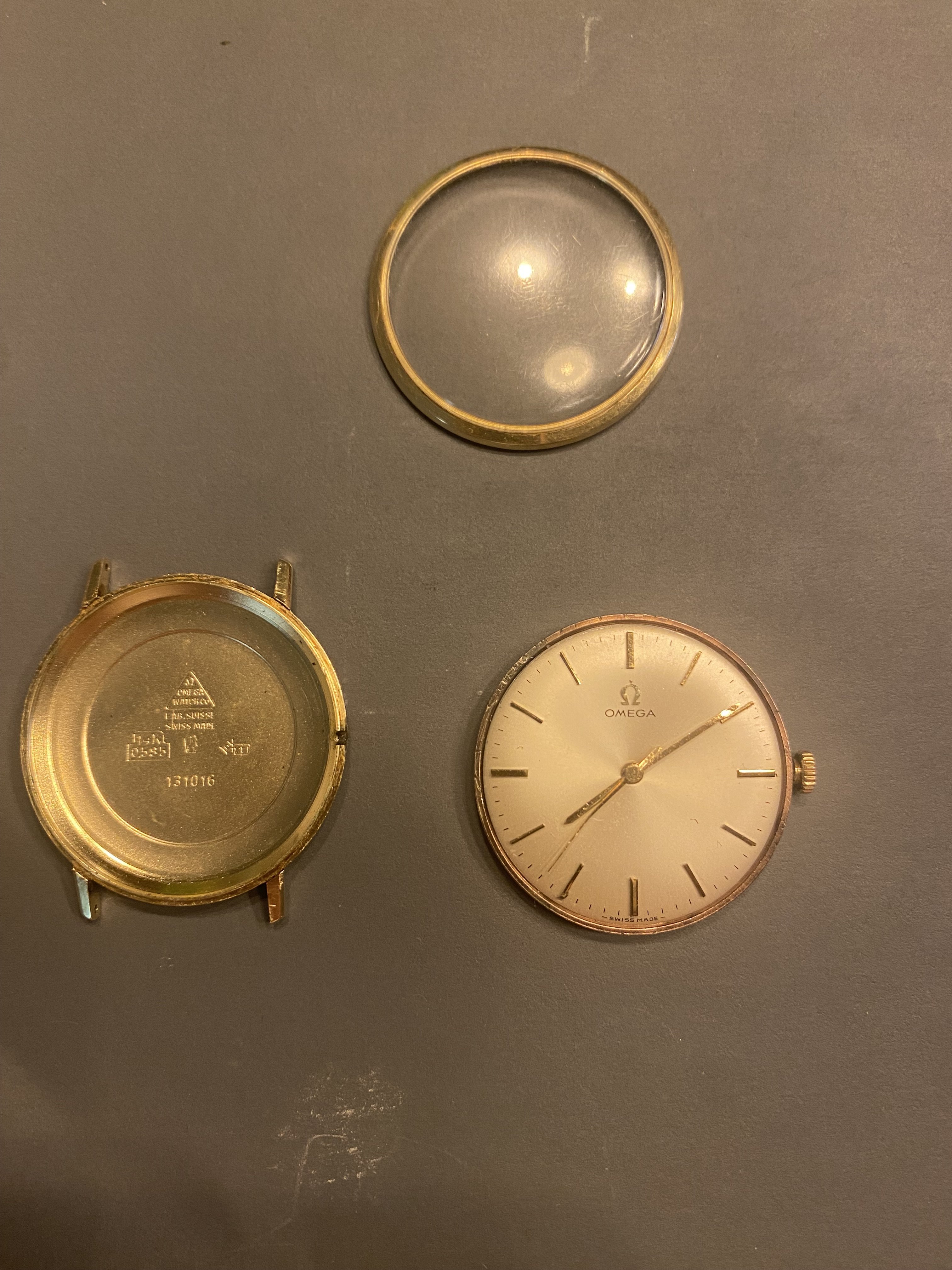

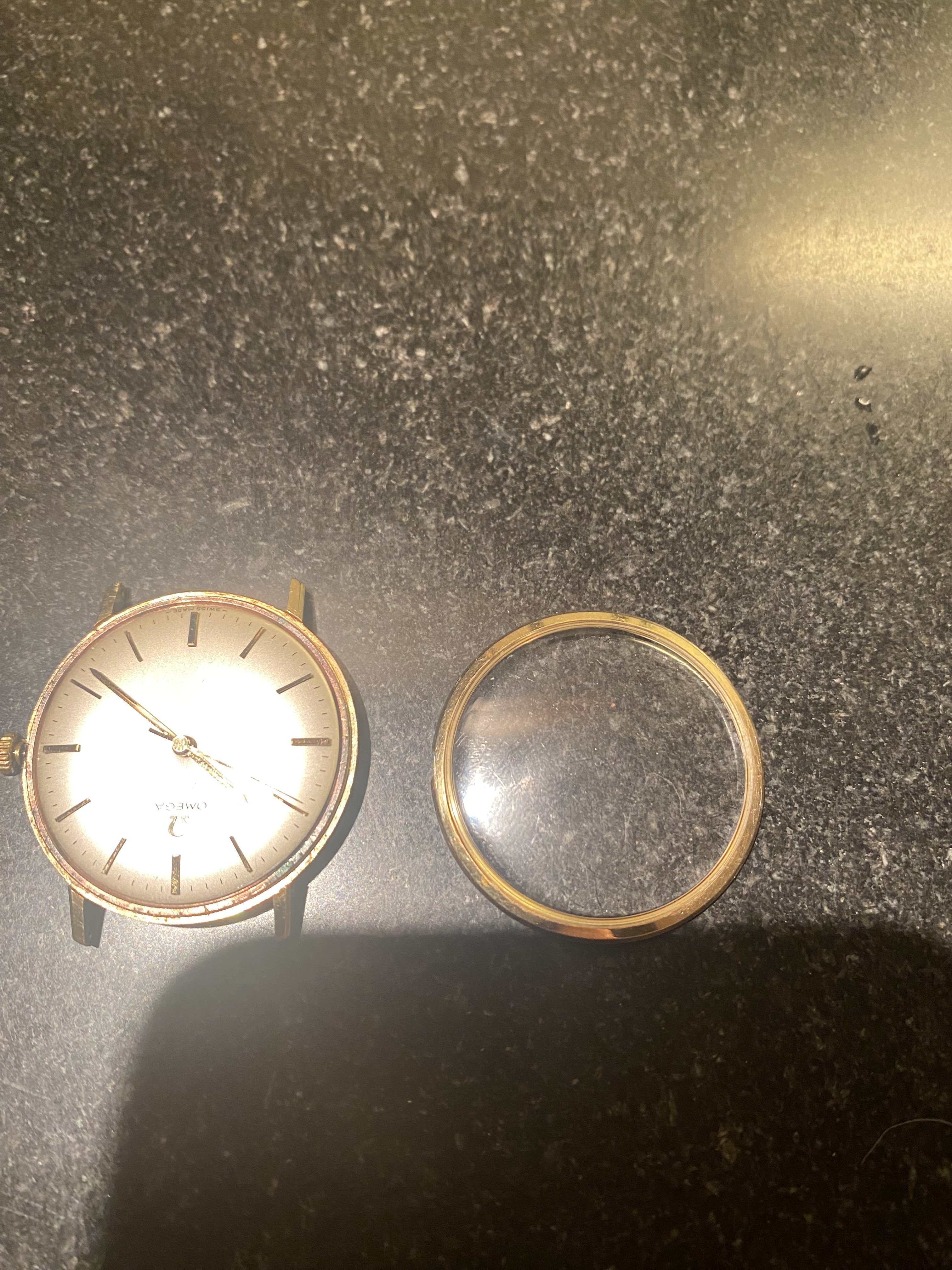

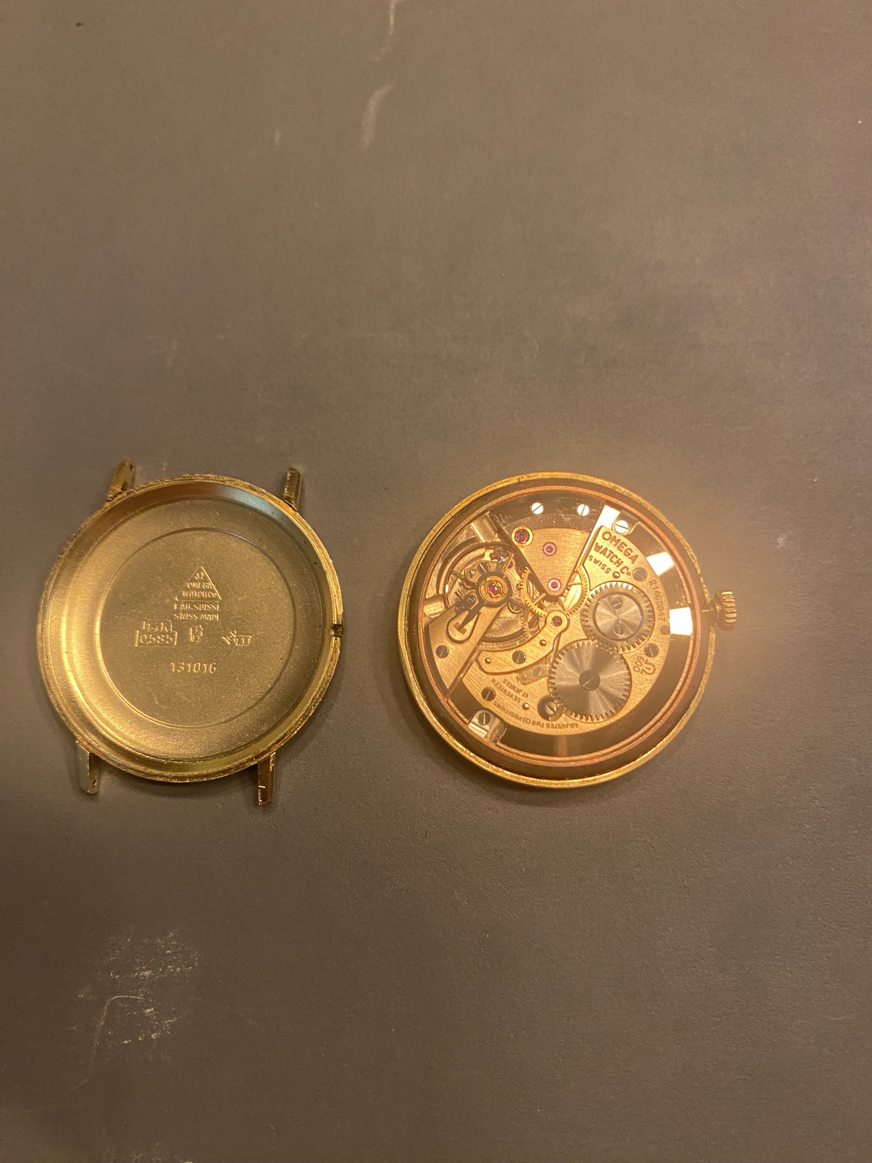

Thank you very much, after some fine and lengthy work with a razor blade it finally came out . please see pictures attatched.

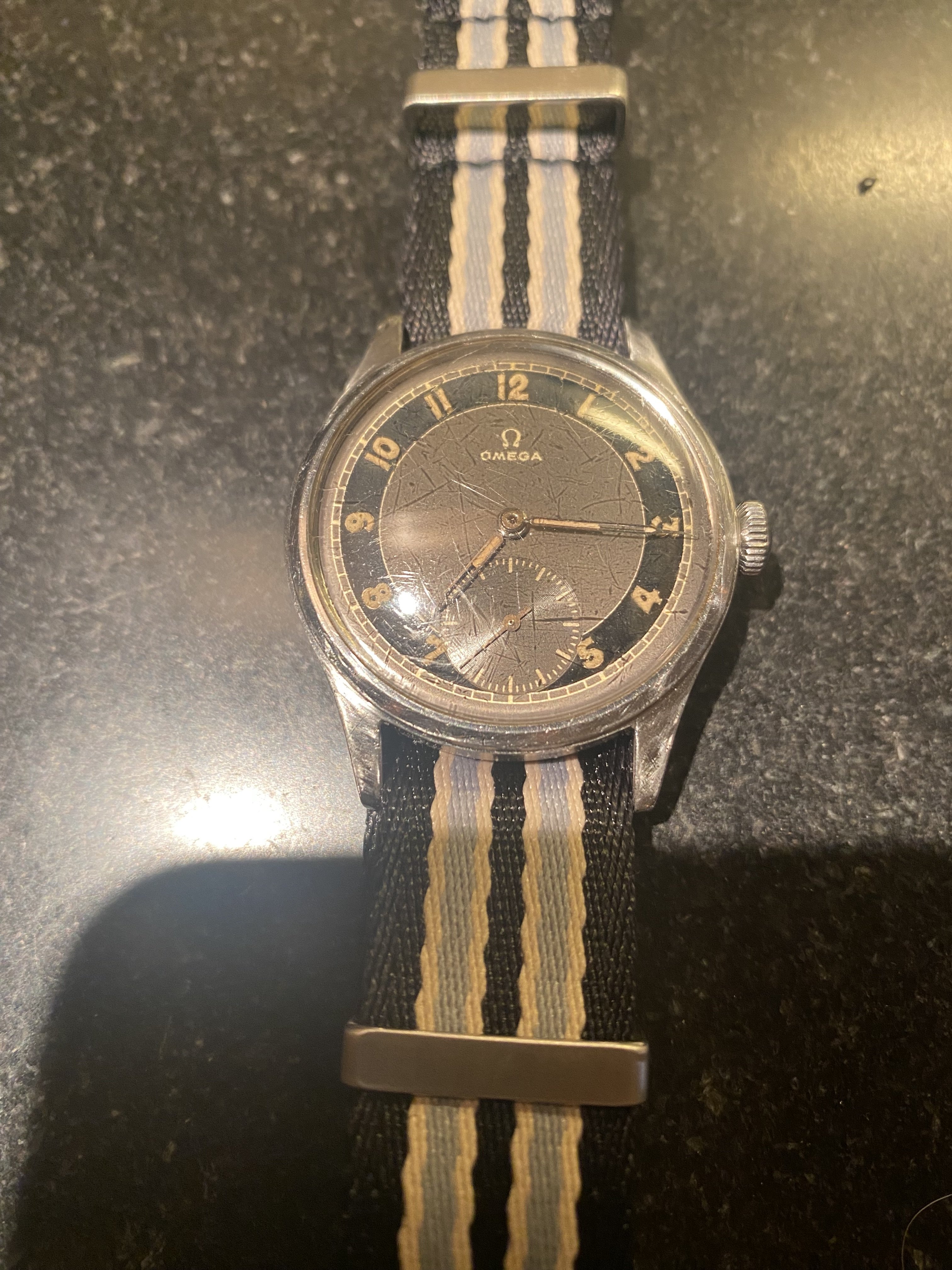

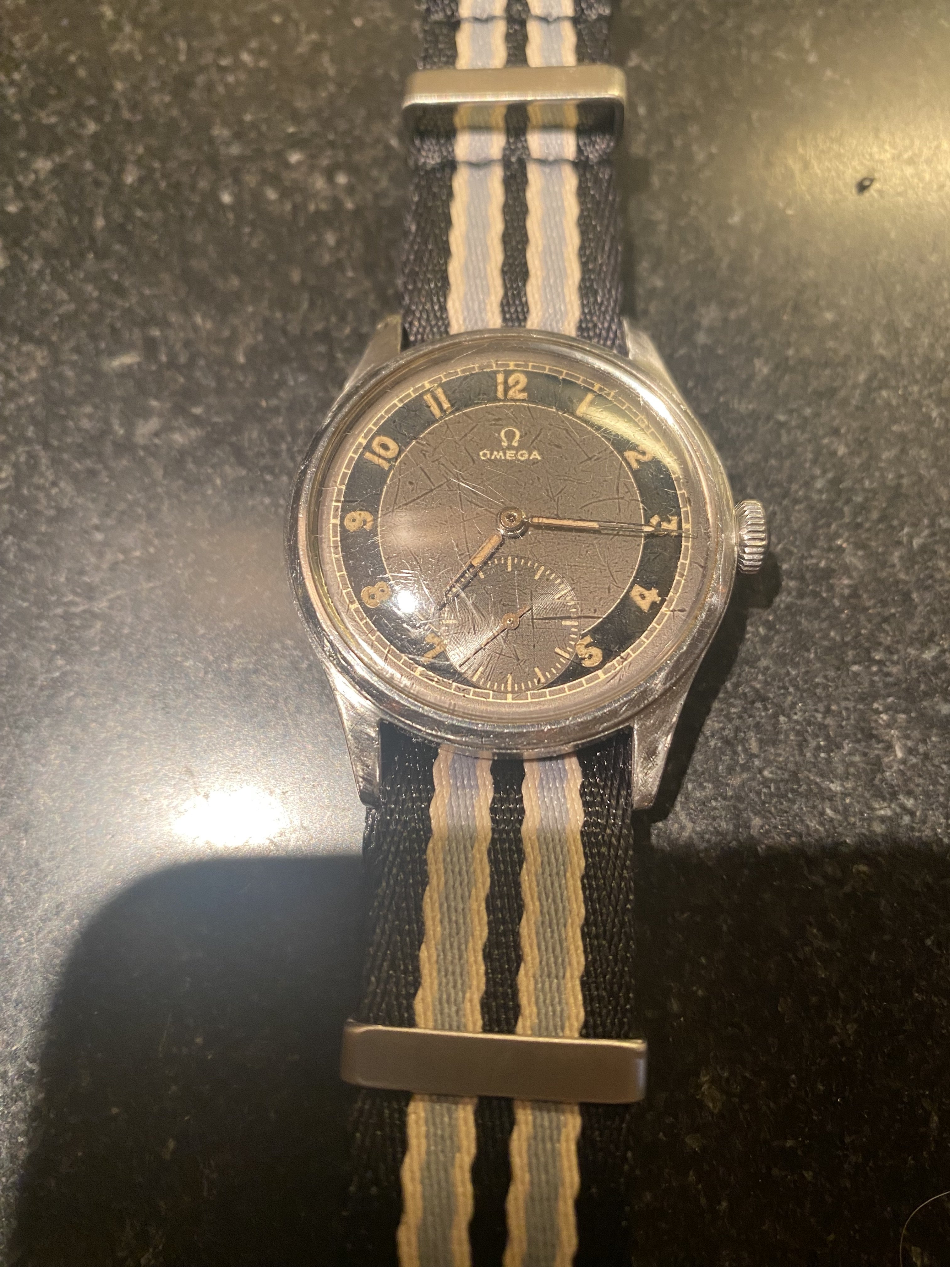

Since this is my first time here I also post a picture of my daily beater to introduce myself.
I think it even outshines my two more high end watches (a JLC and an ALS), it's an Omega Suverän from 1947 with the 30T2 PC movement. Wear it on a “bond” nato copy strap.

Ohhh close 600 cal not 601. You're welcome Just be careful putting it back in, I would pull out the crown like you are setting the time it'll give you a little bit of play to put it back.
