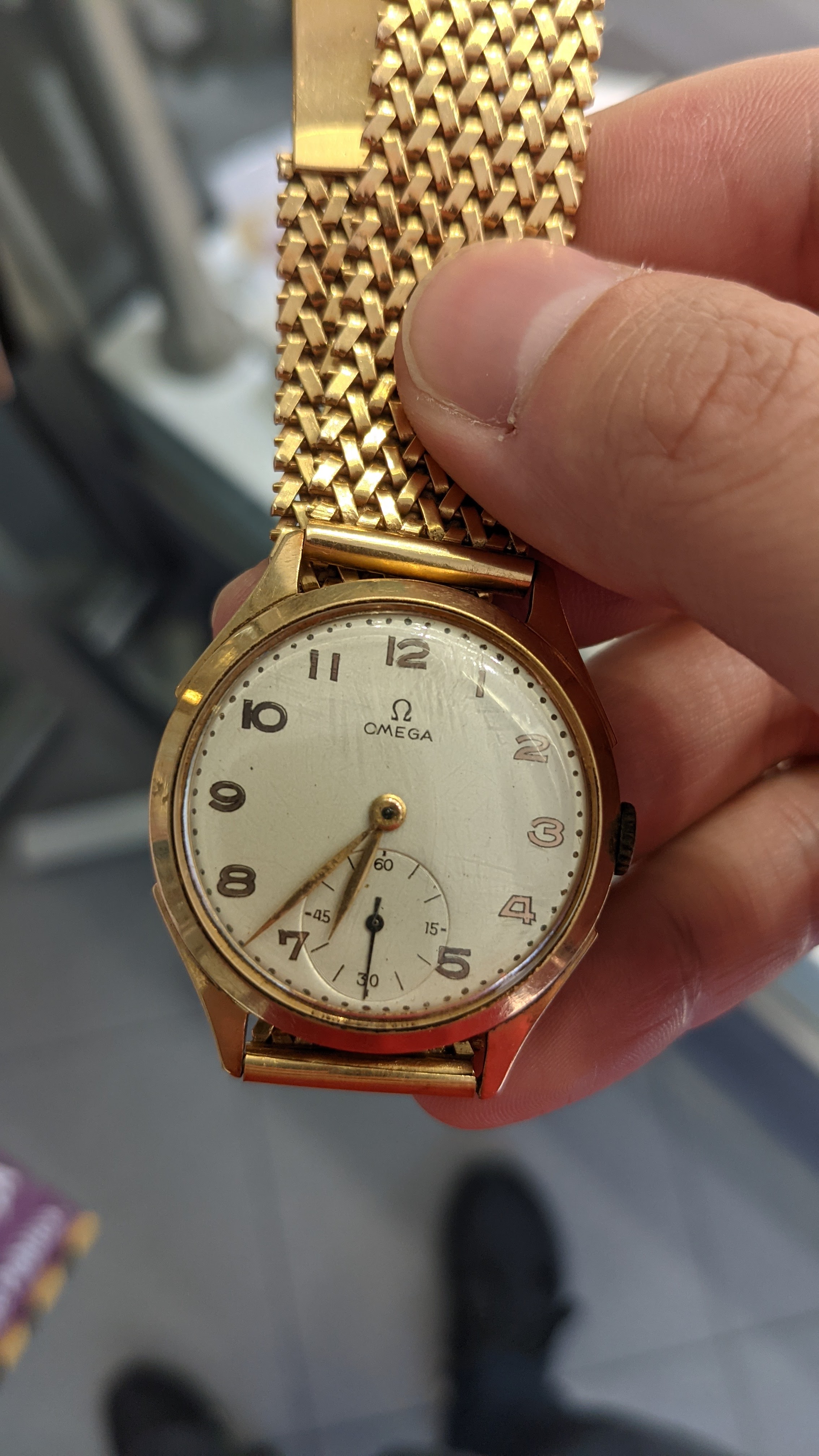

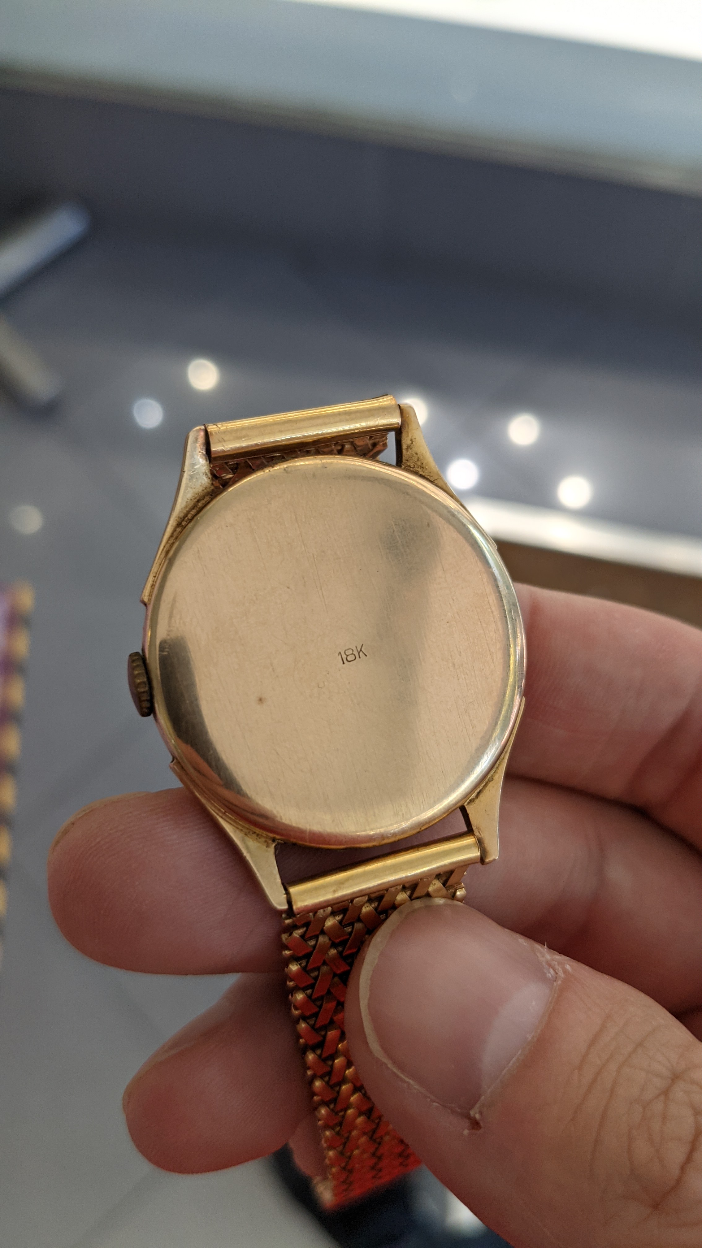

Hi everyone, watch lover here. Just been given this beauty that belonged to my grandfather and came across this forum whilst researching the watch and trying to figure out what model this is. Whilst I'm Portuguese and we always lived here, my Mum told me that the watch is likely to have been acquired in Brazil during one of his stays over there.
I thought I had pretty good searching skills but couldn't find a similar watch on the entire web. The closest I got in my research is the "Omega cal. 30t2", but it's just similar, not the same as this one has got all the numerals. The watch says it's 18k gold, and I can confirm the mesh is also made of gold as I took it to the local jeweller to get it cleaned but got told it would take at least a month. I was also told I would have to cut the mesh (my wrist is slim) if I wanted to get it to fit (or purchase a leather strap, which I declined). I intend to wear it as it is after it's ready.
I was inspecting it and I was surprised to notice it started to work! The watch has probably not worked for over 30 years. I've wounded it up and it worked straight away. Surprisingly, after 24H the time on the watch was still accurate. But sadly I also notice that it stops with some rather light movement, and when you gently tap the back or front it restarts.
The dial and the hands need cleaning, the crystal is scratched, and the crown looks a little bit rusty (perhaps it's not the original?
I know I probably have to get it serviced and I've got a lot of questions, as you can imagine, and wanted to ask if anyone had tips or leads, please.
A) As anyone got any leads or clues about what model this is? Does it look legit? I'm baffled I couldn't find it online.
B) Where would you get it serviced? At an Omega official store or to my local watch/jewellery store to be sent to a specialist?
C) Would you replace the crystal or would you leave it as it is?
D) I don't seem to be able to adjust the strap? Any idea how?
Any other tips and comments on this? Much appreciated in advance. Can't wait to wear it with pride knowing it was worn with passion and pride.
Many thanks in advance!

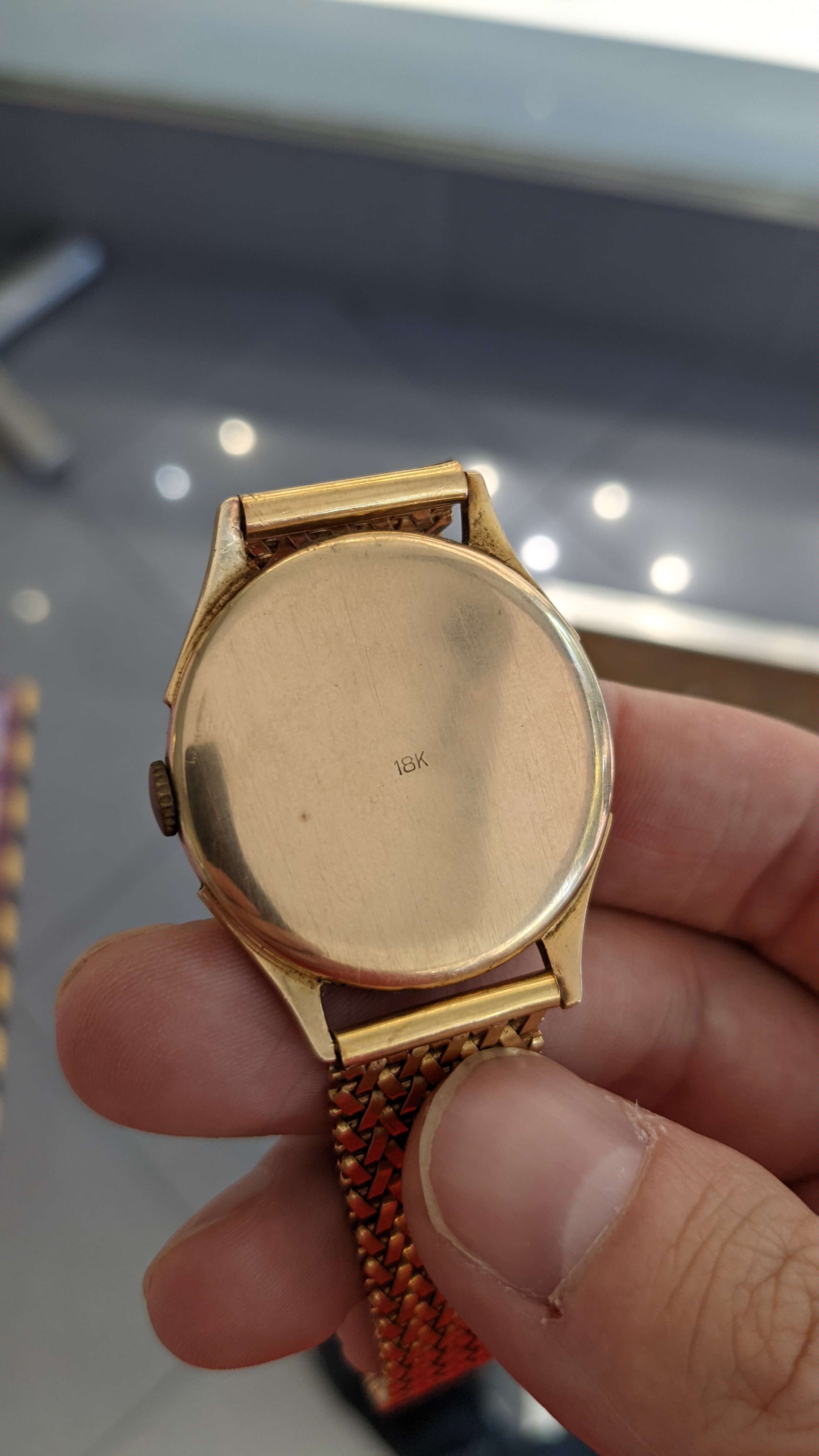

We will need a pic of the inside of the case back 馃榾
And of the movement while you're at it. 馃憤

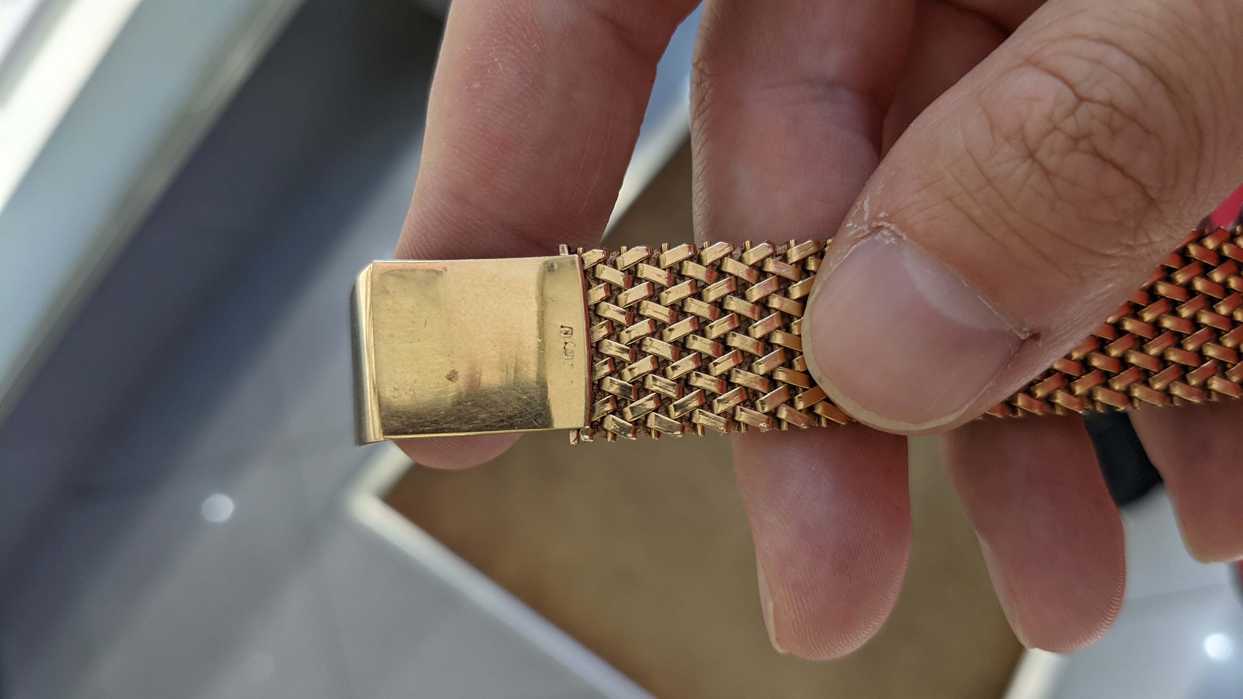

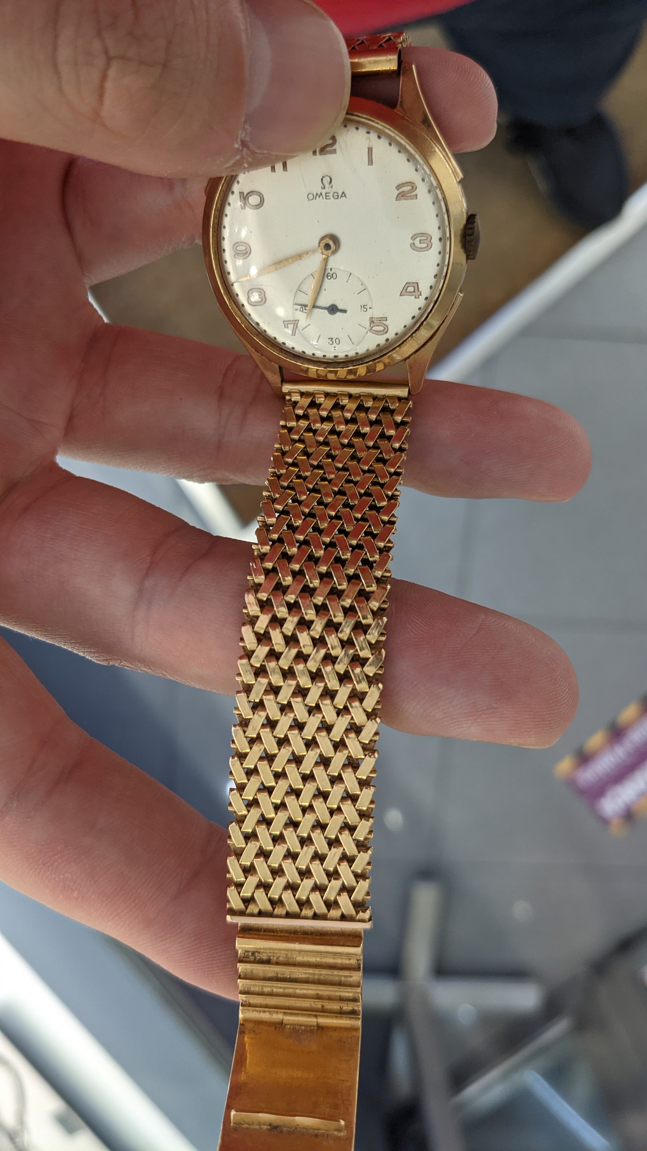

You didn't mention if the bracelet is too large or too small, but it's not adjustable. If it's too large, a jeweler should be able to cut it to the correct size for you, and re-install the clasp. The bracelet can't be adjusted any larger, but you could buy a clasp extender if the bracelet is too small. The bracelet is not made by Omega.

Thanks both. The bracelet is too large. I'll take it to a jeweller to open the case and will also record the movement without it the case, if possible.
Here's what it looks like from the front:
Thanks again.

Hi Andre, welcome to OF.
The reason why you cannot find a similar watch is that the case is not a Swiss made case, but instead a locally produced case - Brazil would be a good guess, knowing your story. These exist outside of Omega references and I don't think you will find anything on the inside of the caseback, as these do not have reference numbers, unlike some other locally produced case, ie. the English ones.
The dial has been repainted at some point which is very common, especially with watches from warm, humid climates.

This is fascinating, thanks for your reply. How did you come to the conclusion it's been repainted? on a closer inspection, I did see that some of the fill of the numbers do not reach the stroke. Would it have been hand painted? It would also make sense that the crown doesn't seem original either, right?
I'll try to get it open tomorrow before I fly back to London and try to see if there's any info on the inside and record a video of the movement.
How would your repair/service if it would be yours?
I think I will take @Dan S suggestion and get the bracelet cut once the watch has been "fixed".

After you see a couple thousand, it gets easier.
That made me laugh!
Another tell is the number 5 impedes on the subdial, which is not typically the case.
1,432
1,580
To answer some of your other questions
Do not send it to Omega - they will replace the "nice bits" and return it as a brand new watch. I can understand why they would do this but the charm will be gone.
Find an independent watchmaker, I could recommend a couple in the UK but no idea in Portugal
Leave the dial as is (my opinion). You could probably get it repainted again (and in all likelihood a better job too). But this is what your grandfather looked upon.
And best not to keep running it as you may do further damage to the movement.

Thanks for your advice. Will do. I'm based in London, so any tips welcome, please.
That's a great point, it just needs cleaning, for now.
I'm really curious to get it open and check the movement to confirm it's an original as being repainted and not finding anything like it is raising some doubts. After @ConElPueblo mentioning it could have been made in Brazil, I did a search in Portuguese and found a strikingly similar watch (attached here), but still nothing like like mine, sadly. Perhaps whoever got it painted used some more creativity?

I was looking at this earlier today and thought "Am I the only one who thinks this dial is original?"
Did movements get exported complete with dials and hands? Or were dials and hands also locally produced (as the cases were)?
Yes Omega have done this back in the day to prevent import taxes for complete solid gold watches one of the reasons why in US 14k Omegas are common but not in Swiss.
It be like this 馃榿
In all seriousnes, as stated elsewhere there are a number of tells; subdial design, bleeding of numbers into the subdial, missing "Swiss made" at 6 o'clock and the slightly awkward Omega logo.
I should add that I am not 100% sure of the country of origin of the case other than it not being Swiss. You will need to find a country where the hallmark was a simple "18K" stamp on the caseback.
Crowns are wear and tear items and it has most likely been replaced at some point, yes.
I would definitely find a good, independent watchmaker and then be prepared to wait for a bit for him to source one or two parts that may be difficult to find. The movement in an Omega like this is an extremely rugged and well-known manual wind movement, litterally the text book example in some watchmaking handbooks of how a watch movement is put together. Any half-decent watchmaker should be able to service it and a competent one should be able to make it run very well. I don't see what is gained by letting Omega work on it.
I -think- that this depended on what the legislation in the importing country was. Not all countries had the expertise to produce dials or dial furniture, but I believe that France for instance had.[/QUOTE]

Firstly, thanks to everyone who's given their input and insight on this thread. I really appreciate it.
I didn't manage to get it open but I'm coming back to London today and will try to get this done this weekend at some point. I'll share the pics and video as soon as I manage to do so.
@ConElPueblo @shaun hk Can you recommend any trustworthy places in London, please? I can be patient, just so excited to get it serviced and on my wrist!
According to Mum, the last time he was in Brasil was late 60s/early 70s, and there's a chance the watch might have been purchased directly to someone rather than at a shop.
6
Update: I've been to 6 watch stores (including Ernest Jones, Omega and Watches of Switzerland) and none removed cases. The gentleman at the Omega shop told me to visit SOMLO at the Burlington Arcade in London, which is what I will do when I get a chance. If anyone has got other suggestions please let me know. Thanks.
