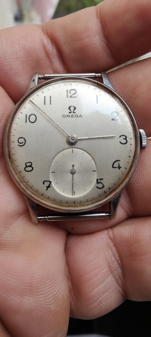

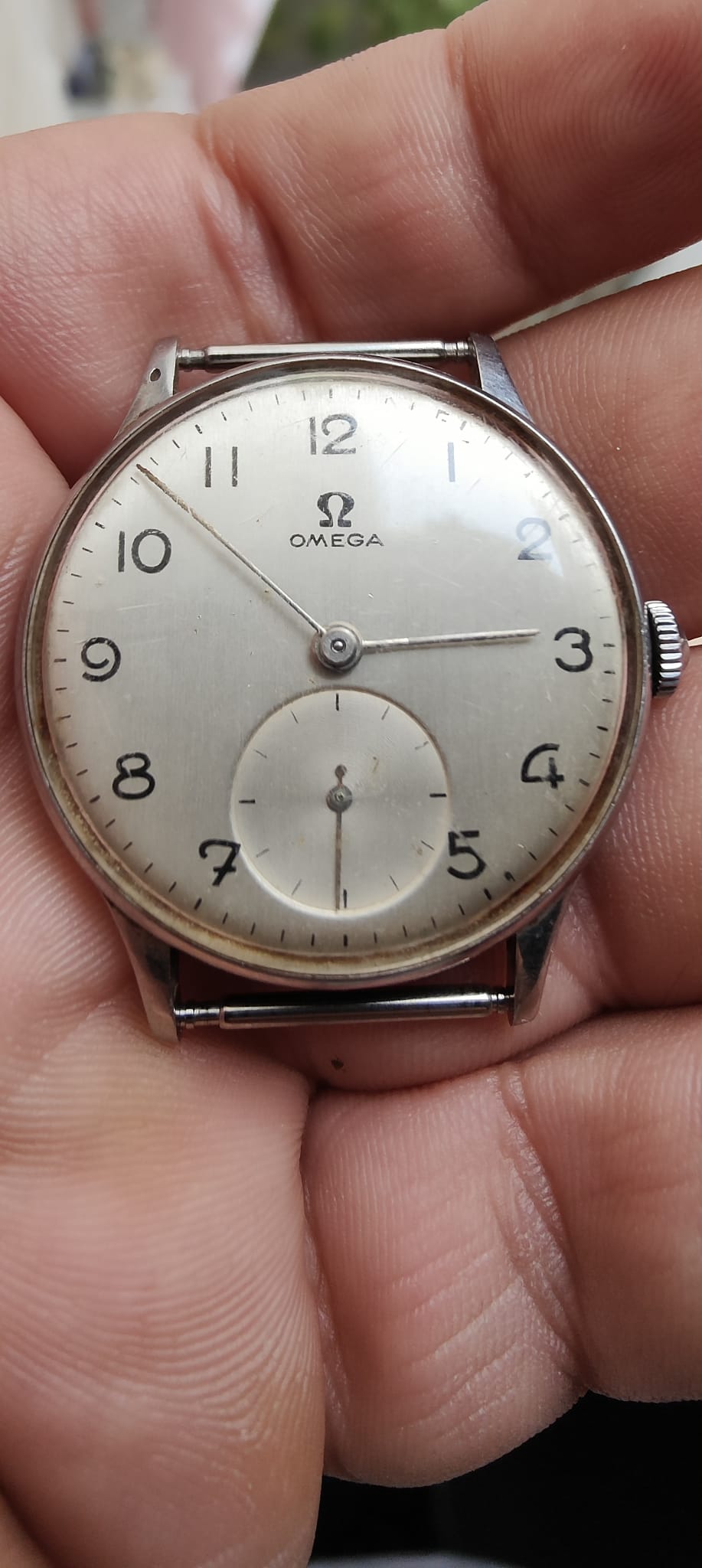

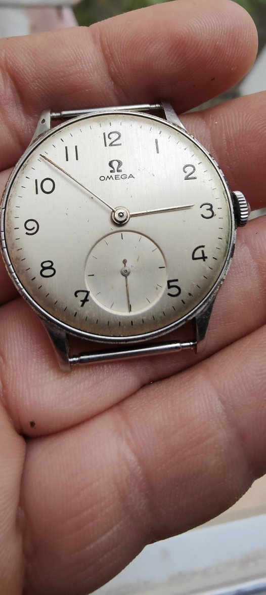

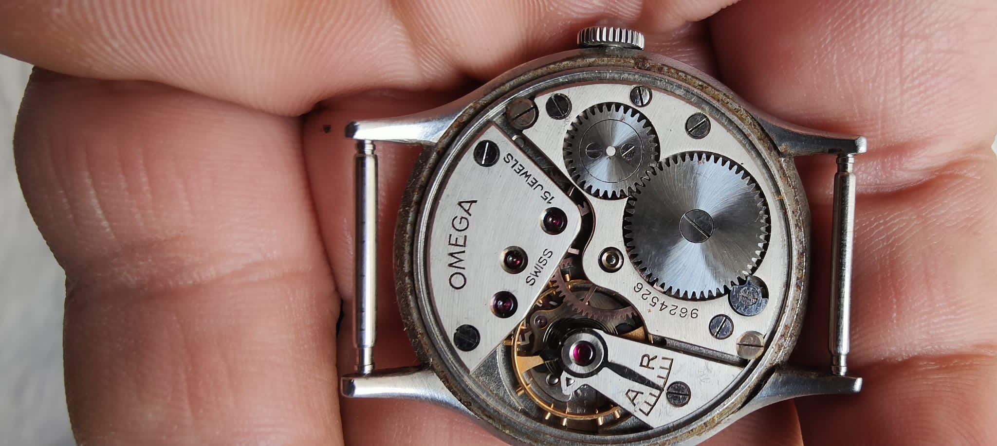

a friend is offering an omega, case and crown seems original, I have doubts about hands and dial, can you please anyone advice
thanks a lot

questions are not about the price of the watch, are about if it's 100% genuine as it's my main concern. Omega logo is quite fat, I am doing research , thanks

honestly I don't know that's why I ask here as I know there are several experts. I do ask when I don't find info online :O(

I'm not familiar with this specific model but font and logo don't look right plus subdial is flat while it should have concentric circles. Also there is no swiss made at 6. Case looks like its imported in Portugal, a little stamp on a upper left lug is a sign of that. Hope it helps.

I haven’t any doubt about that dial, repainted.
No idea about the hands, but is it important given the dial’s condition ?
thanks a lot. Swiss made at 6 ... I have my doubts if it was normal to have such print as I saw many without . Case I agree with you, logs and font also

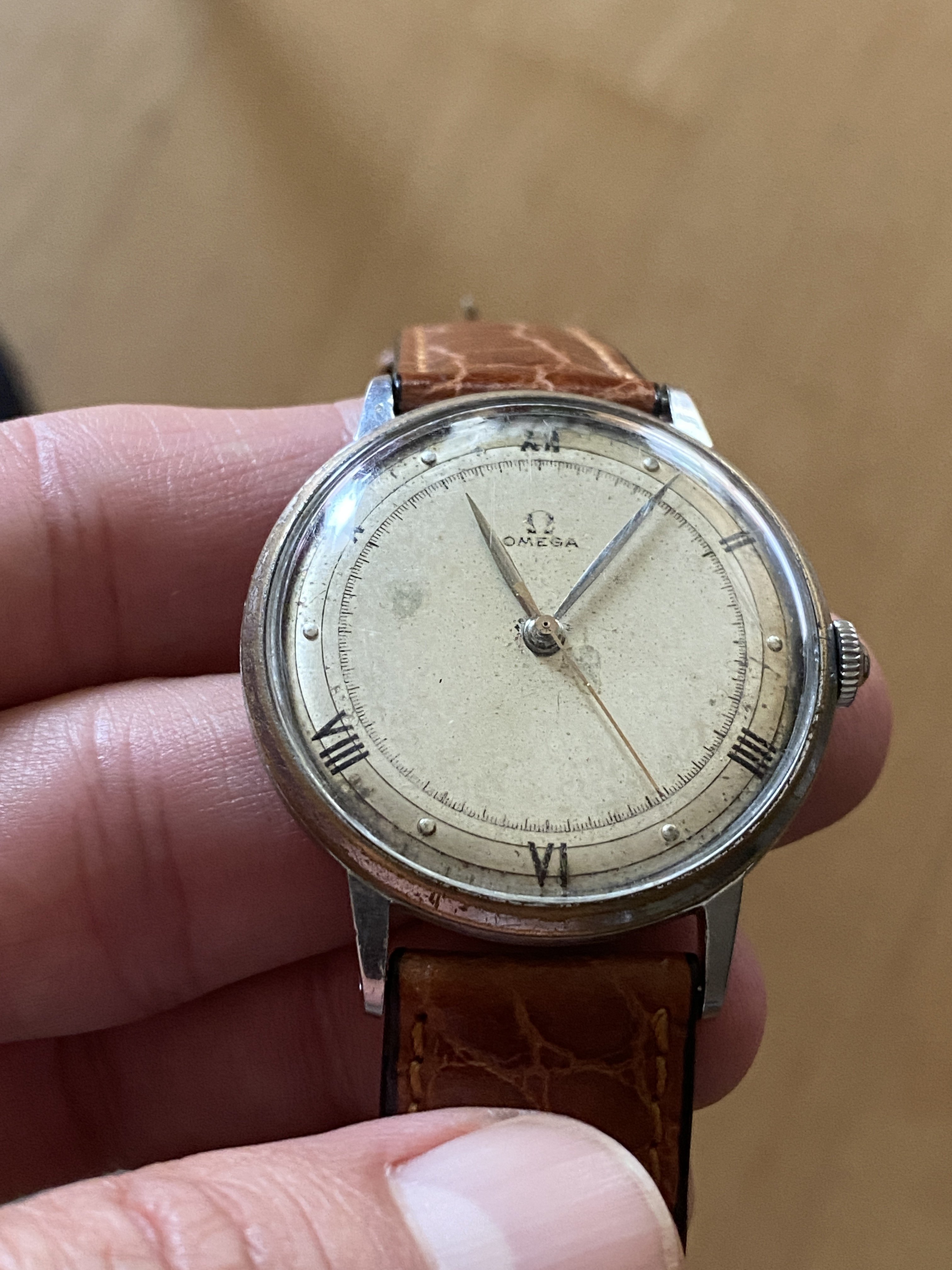

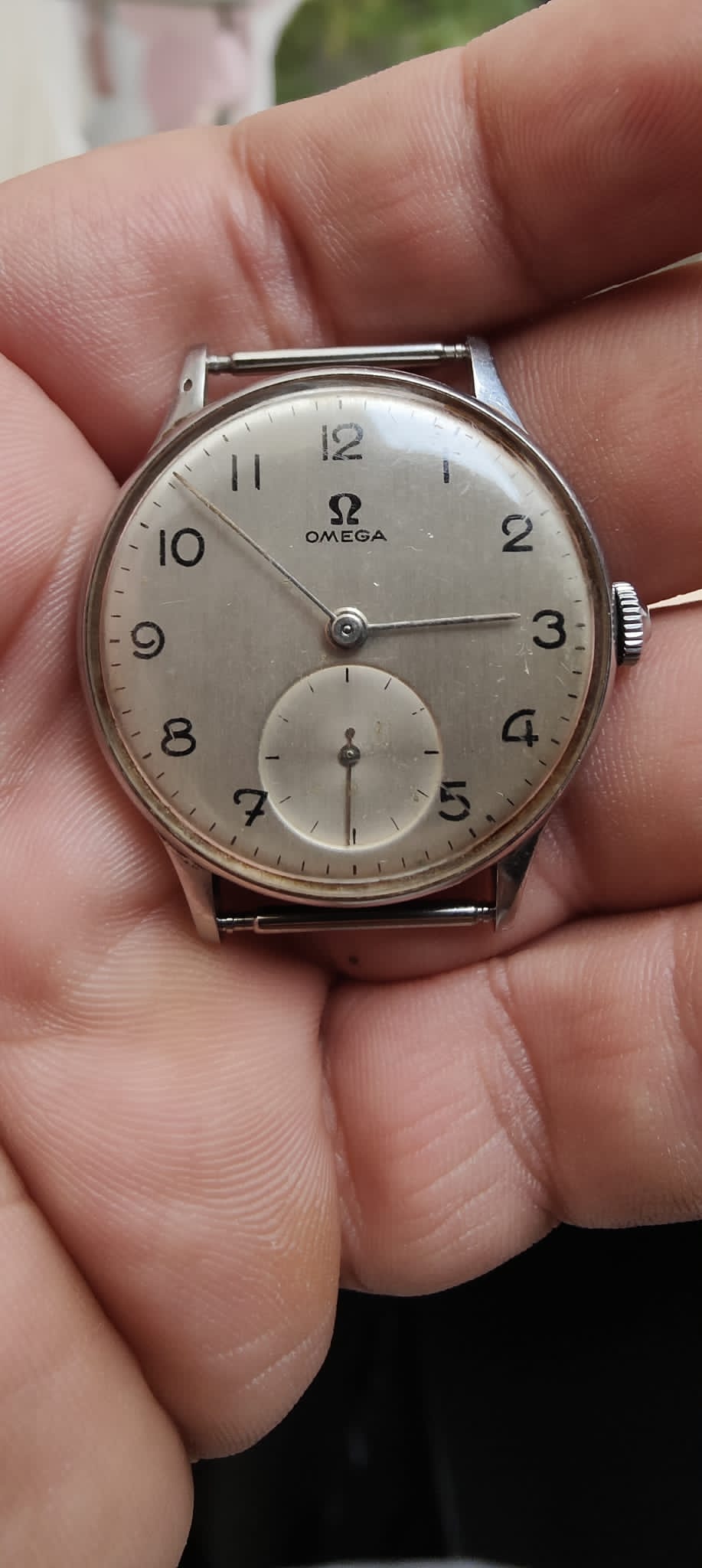

well if it's redial then no issues about the hands, my interest in this case will be to buy the case only as I don't want a repainted dial. I have this watch that I think will fit in that case, mine is a franken and the case is not original (only body of the case, bezel and case back not original)

That particular logo style was only introduced in around 1953 on watches with much later (12-13mil) serial numbers.

Dial is repainted
hands are OK for early 30 T2
case and crown are OK

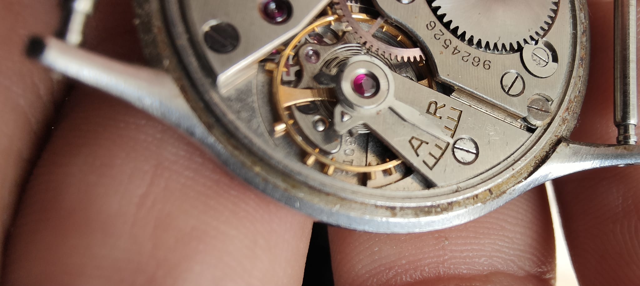

But: the balance is wrong - there should be a cut bimetal balance...
Thanks for your input

Dial is repainted
Thanks again, do you think that the case will suit my actual watch ( the I showed on the previous picture , I don’t have measurements of the dial) thanks
