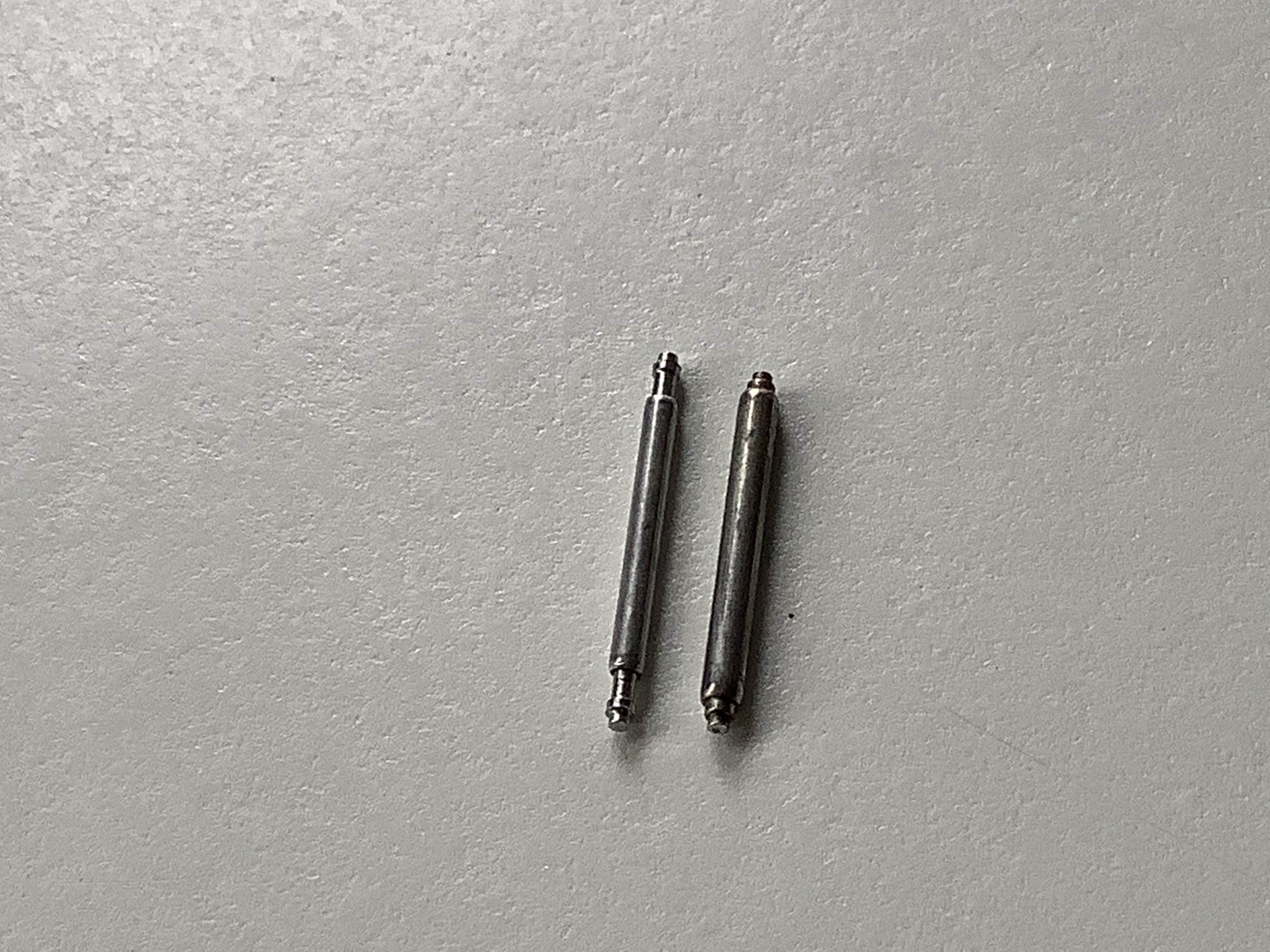

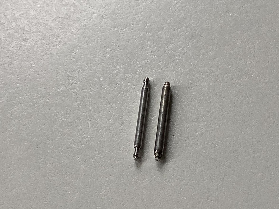

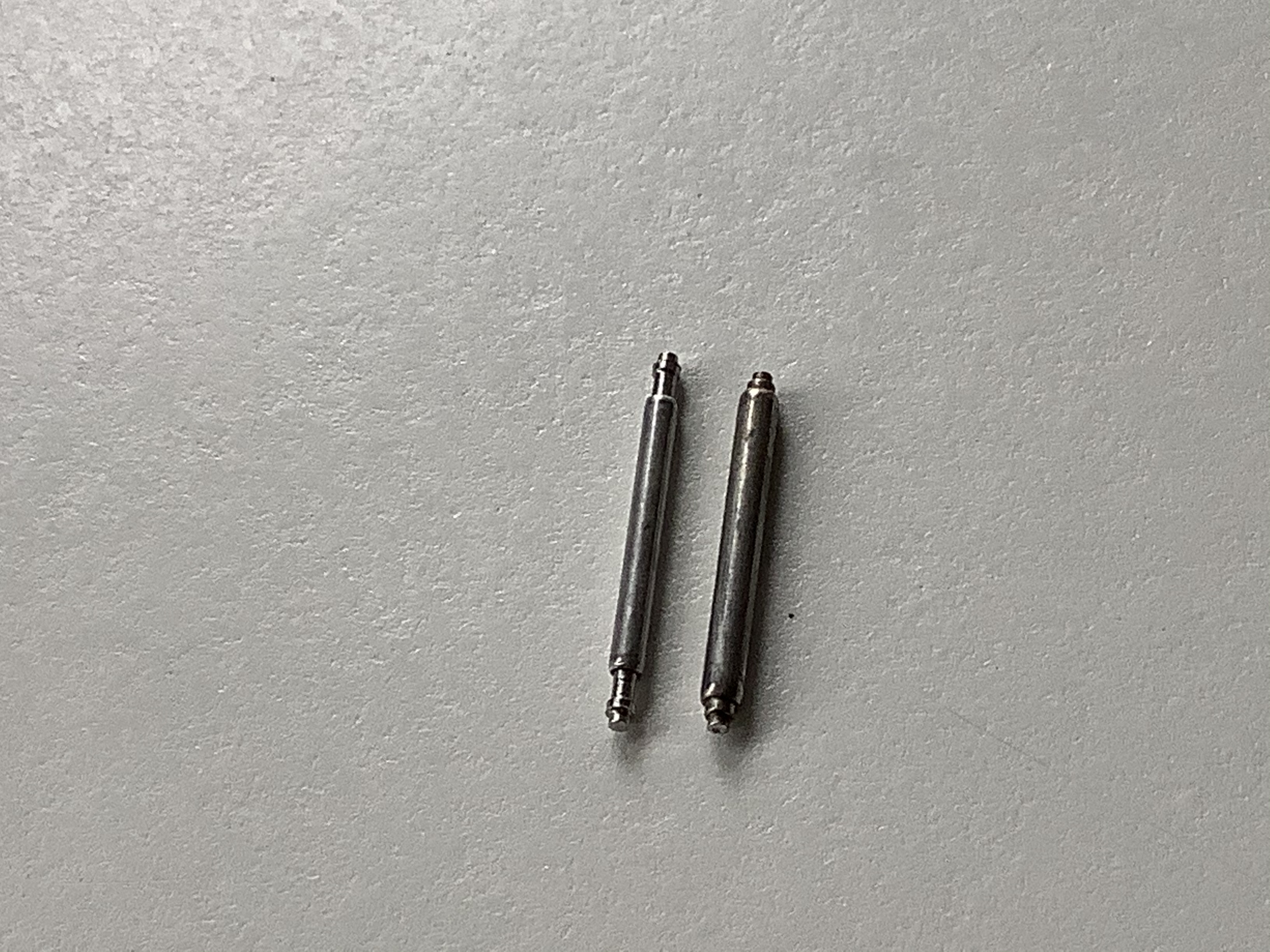

This is a bracelet clasp bar, and the difference is that the original ones, at least for the flat-links, had very little travel with the tips, which you can see in the photo on the right. The other bar, which fits fine and is aftermarket, needs a much greater compression to get under the clasp. That’s the one on the left.
Why does this matter to me? If you’ve ever replaced or moved the position of the after market bar, because of the greater spring tension, it can easily launch right into your eye. This does not happen with the original. Whether it was designed the way purposely, I can’t say. But I know it’s difficult to tell which one is in the clasp until you depress the tip and release it.
I’m in health care, and I deal with physical disabilities all day long. In the future, I don’t want some unsuspecting, neophyte hobbyist getting a penetrating eye injury.
