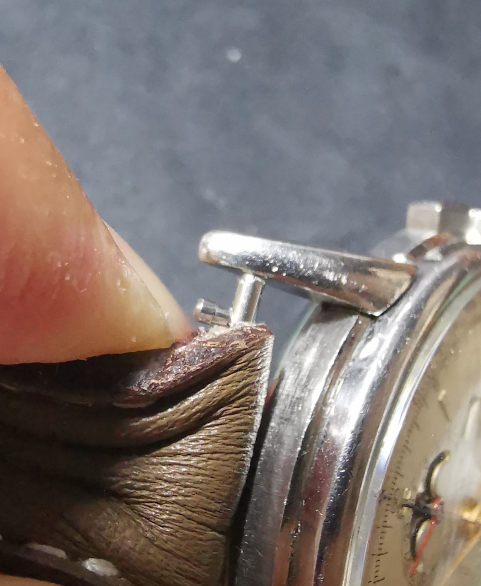

Maybe a pic of what we are working with here?
Thanks all for the inputs!
Here's the 'problem'
I tried the dental floss but to no avail. It seems there isn't even enough room for the dental floss to get in between the lug and the springbar.
The springbar isn't that old and the lever actually retracts back fully but seems the underlying pin doesn't seem to move/move enough to come out.
Might have to give the razor a try but it seems like a real squeeze.

@ikanbilisclub ... I’d lubricate the slot with a penetrating oil where the lever travels and where the pin meets the watch case. To me this is another indictment of quick release bars. I don’t trust them. I fear however that since it is new, your strap is a goner. You may have to cut it off to get the pos out.
4,491
10,959
We were all imagining some level of corrosion would be present. That pin sleeve looks to be tight against the lug. Is there any gap present if you pull on the pin? Since you have good access to the lever, try slipping a popsicle stick into the gap and pull back / down on it.
edit: the floss trick might work on this one only wrap it around the lever and pull down 😀
16,305
45,024
You have enough room in that pic to get a wire cutter in there and snip that spring bar off. Just do it closest to the leather part as you can (the hollow tube) and wear safety glasses or look away when you do it

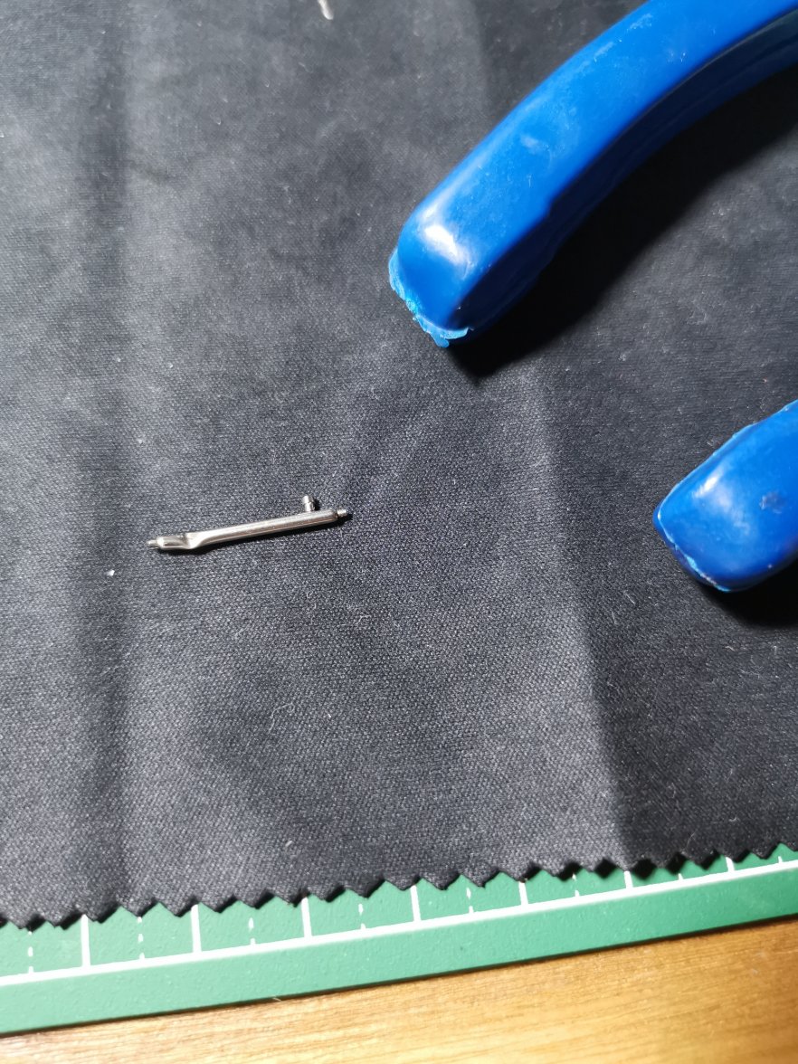

Thanks all!
Ok I just went with radical and pulled wire cutters out from my tool box.
Funny enough the lever does work quite well and retracts the pin fully. 😕
Was hoping this would be truly a last resort and got really tired of wearing out my fingers compressing the lever and nudging.
Everyone is alive and watch + strap is unscathed. Its a happy ending for this one.
Really appreciate everyone's advice!
Yeah, looks like quick release may also mean painful release sigh
