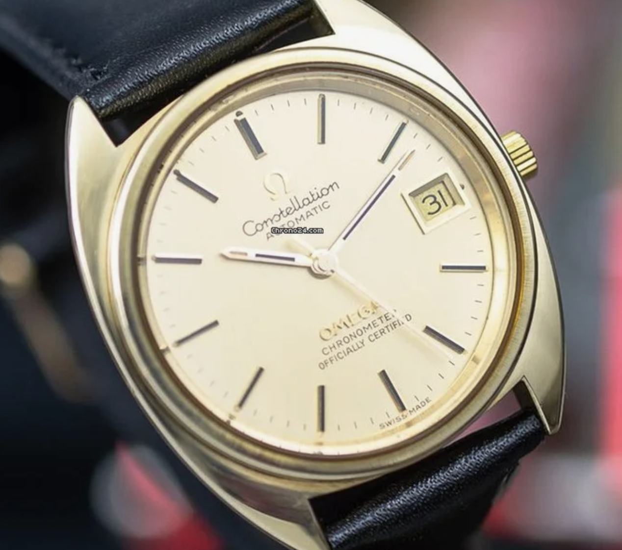

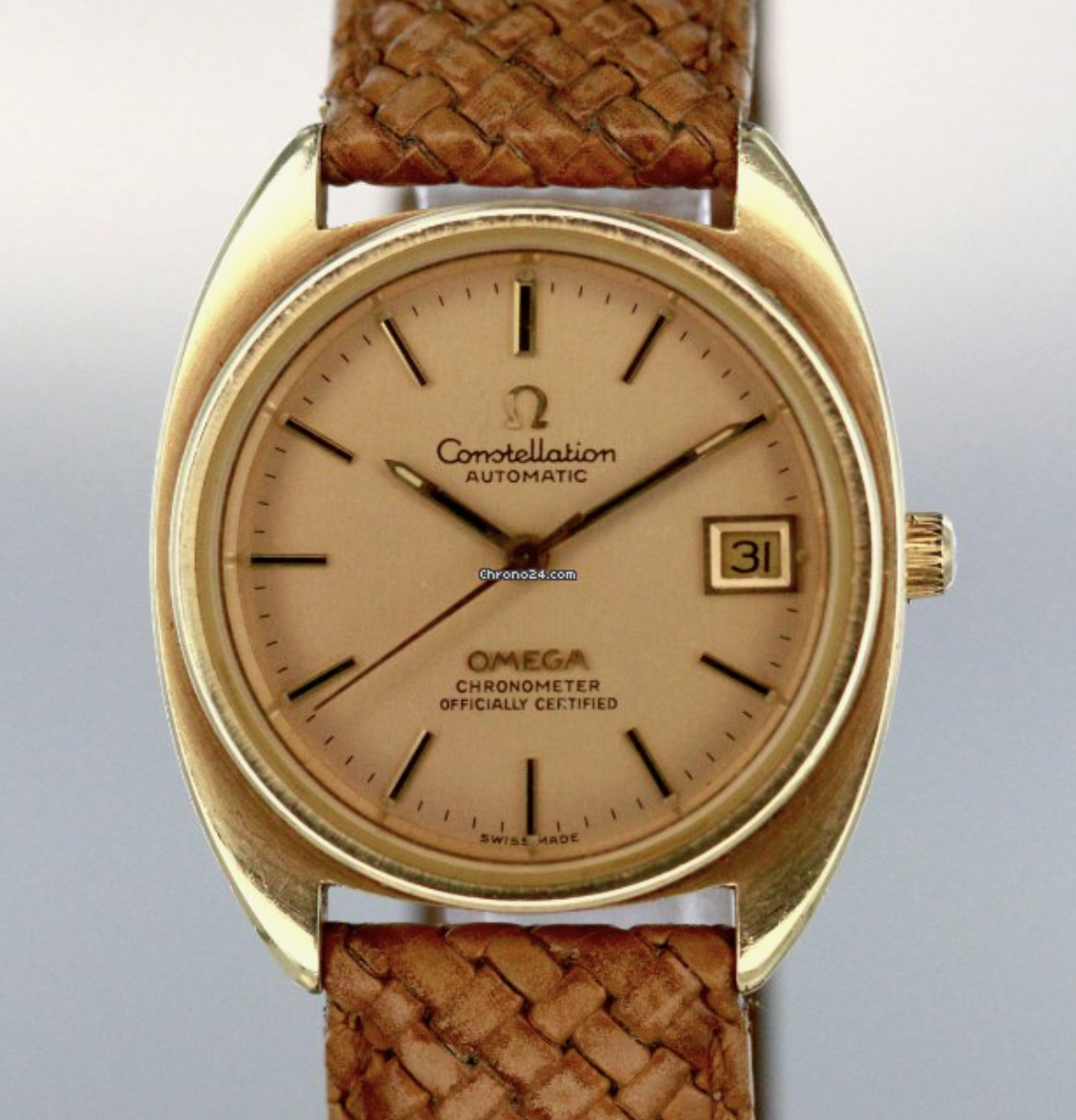

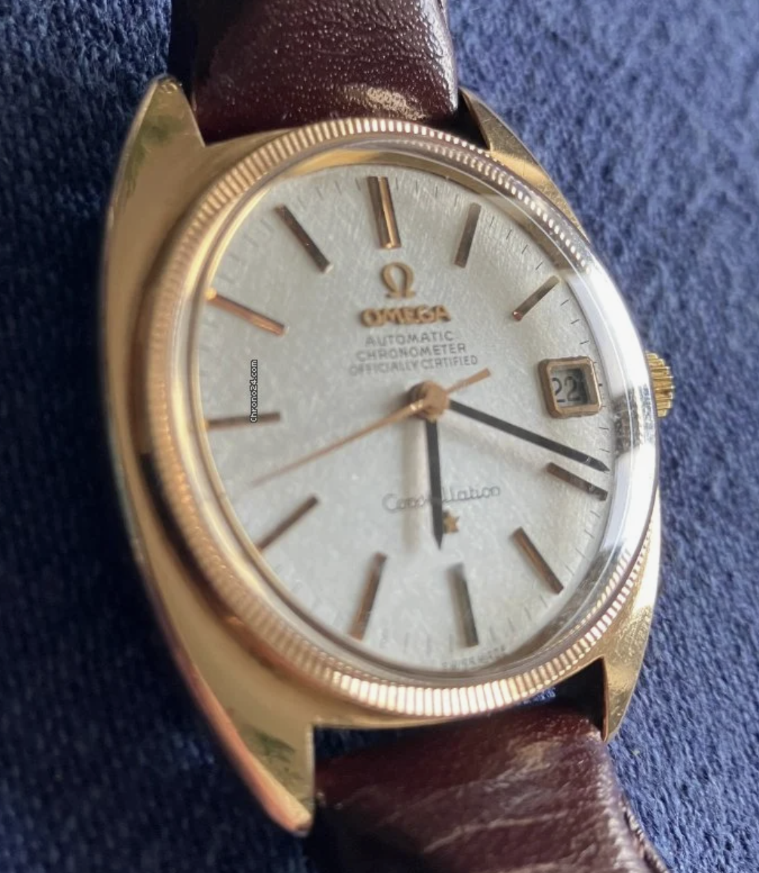

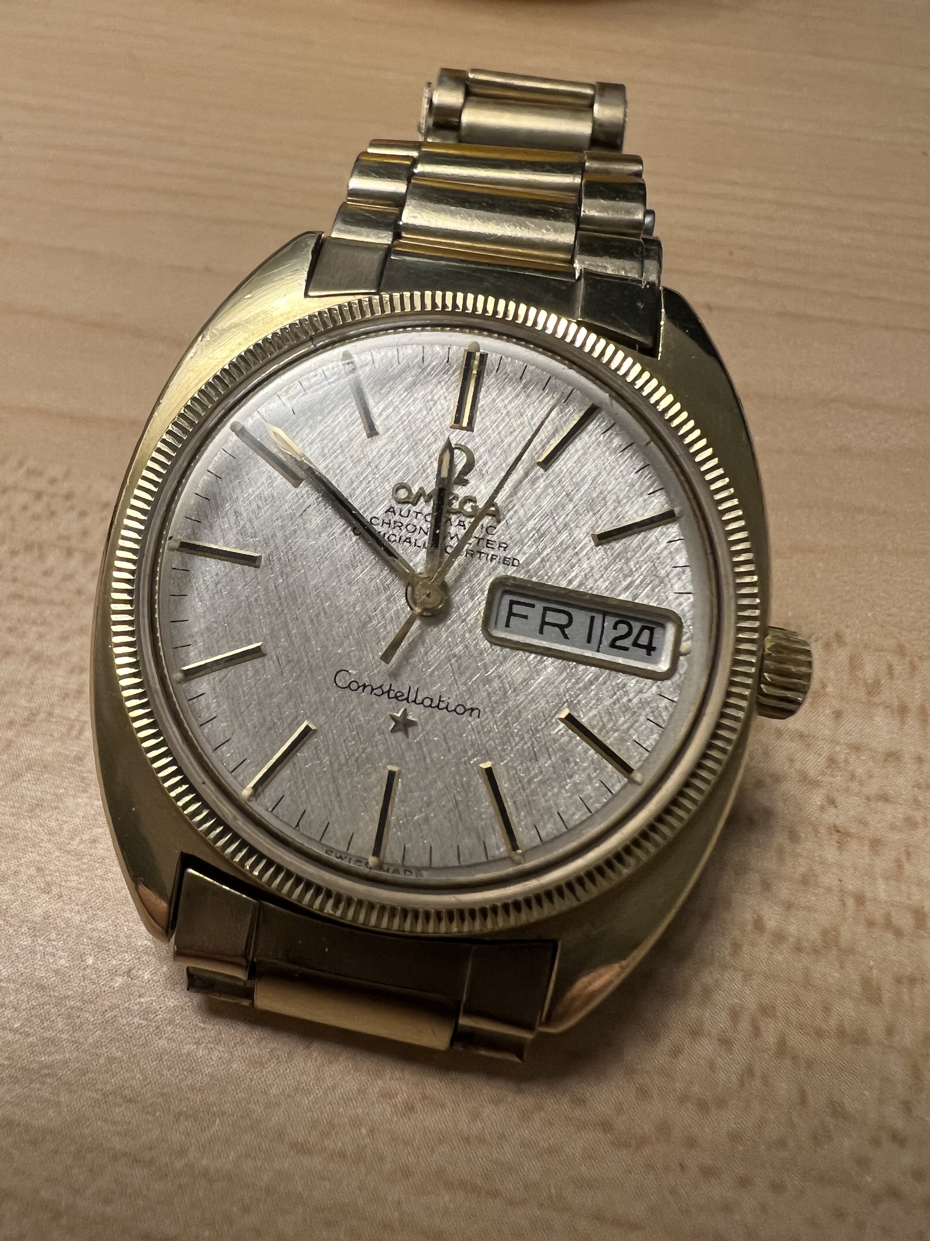

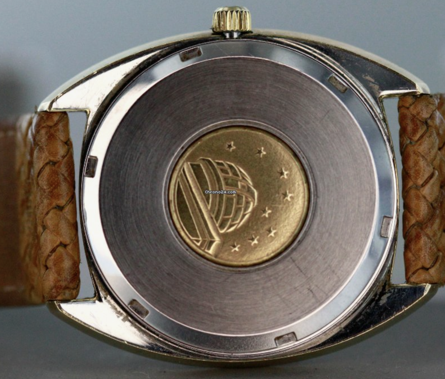

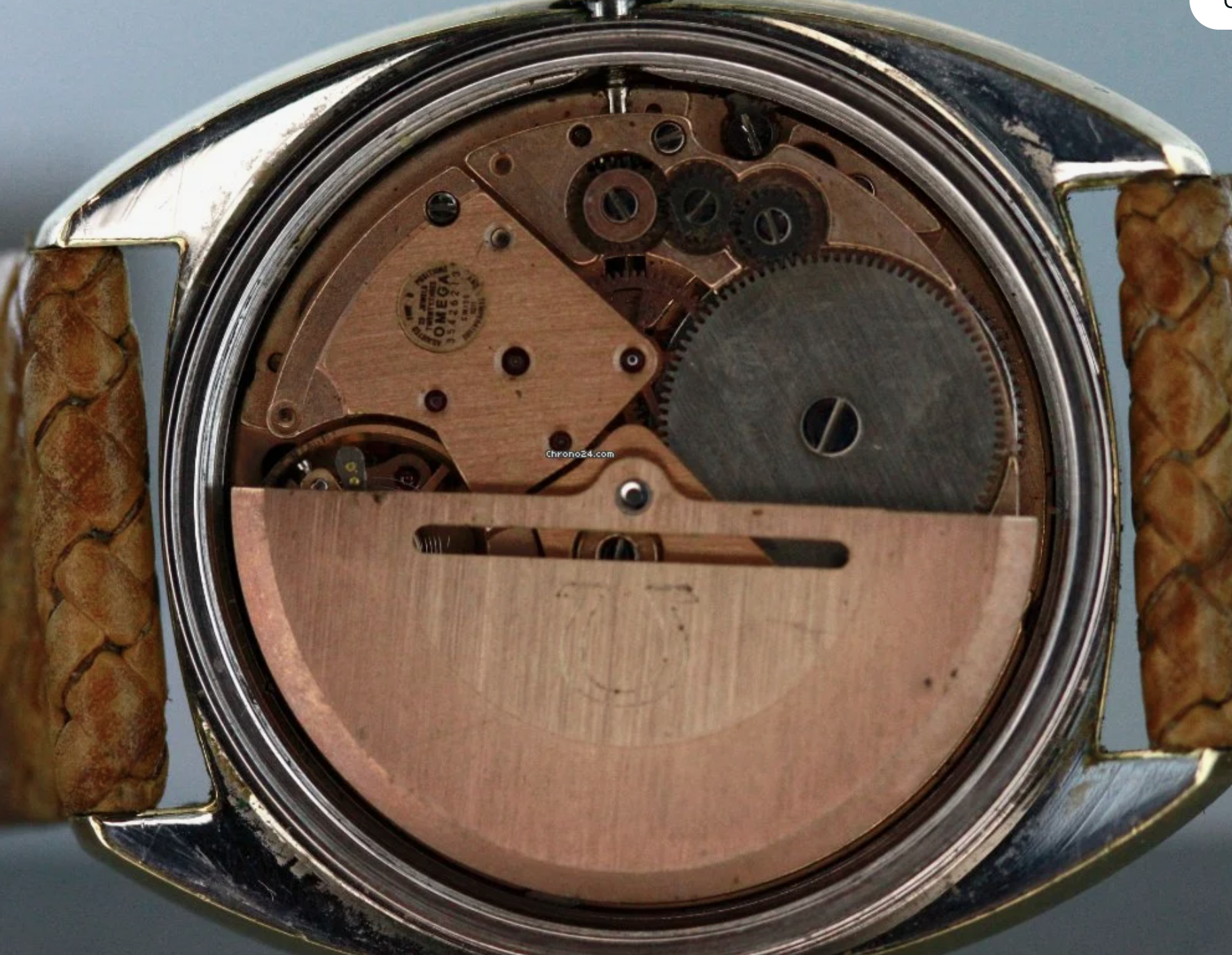

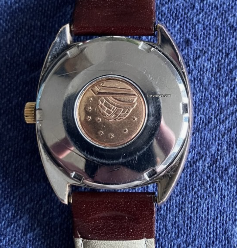

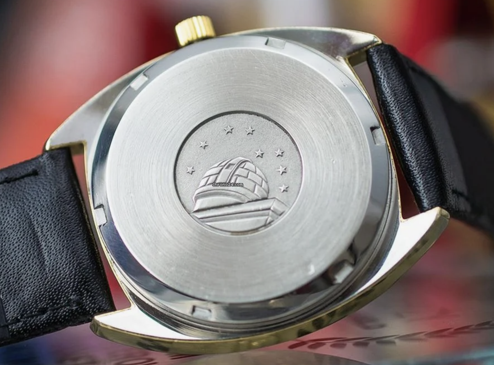

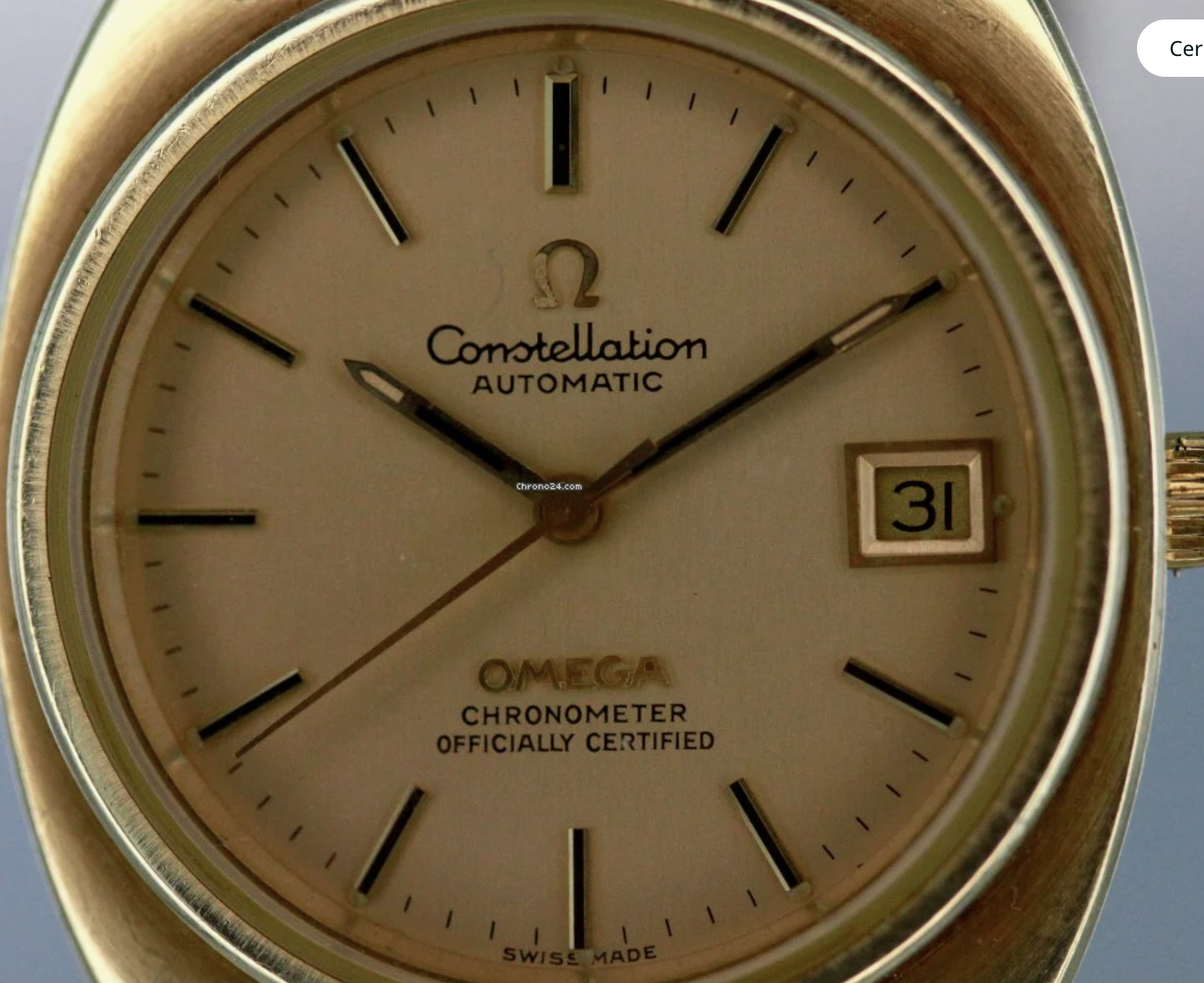

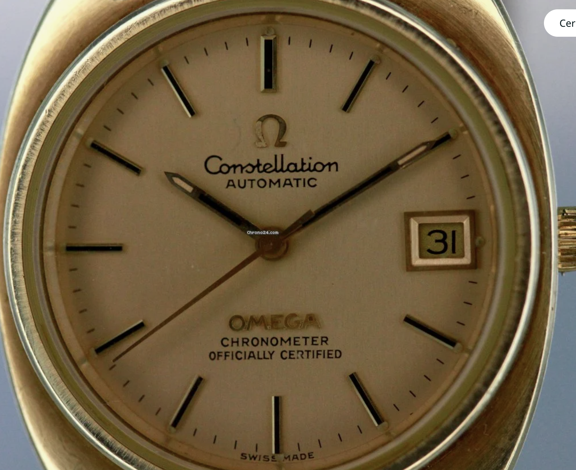

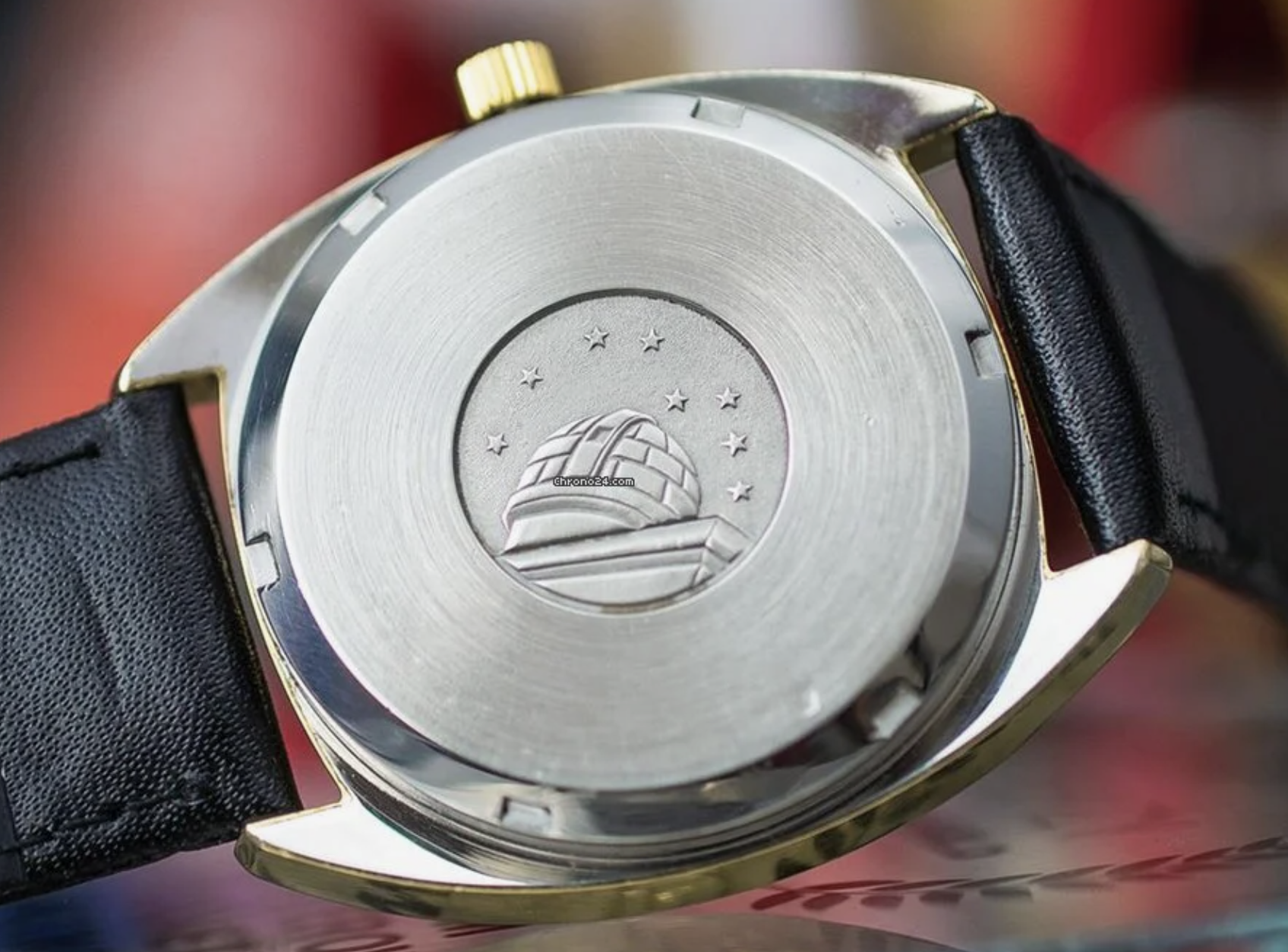

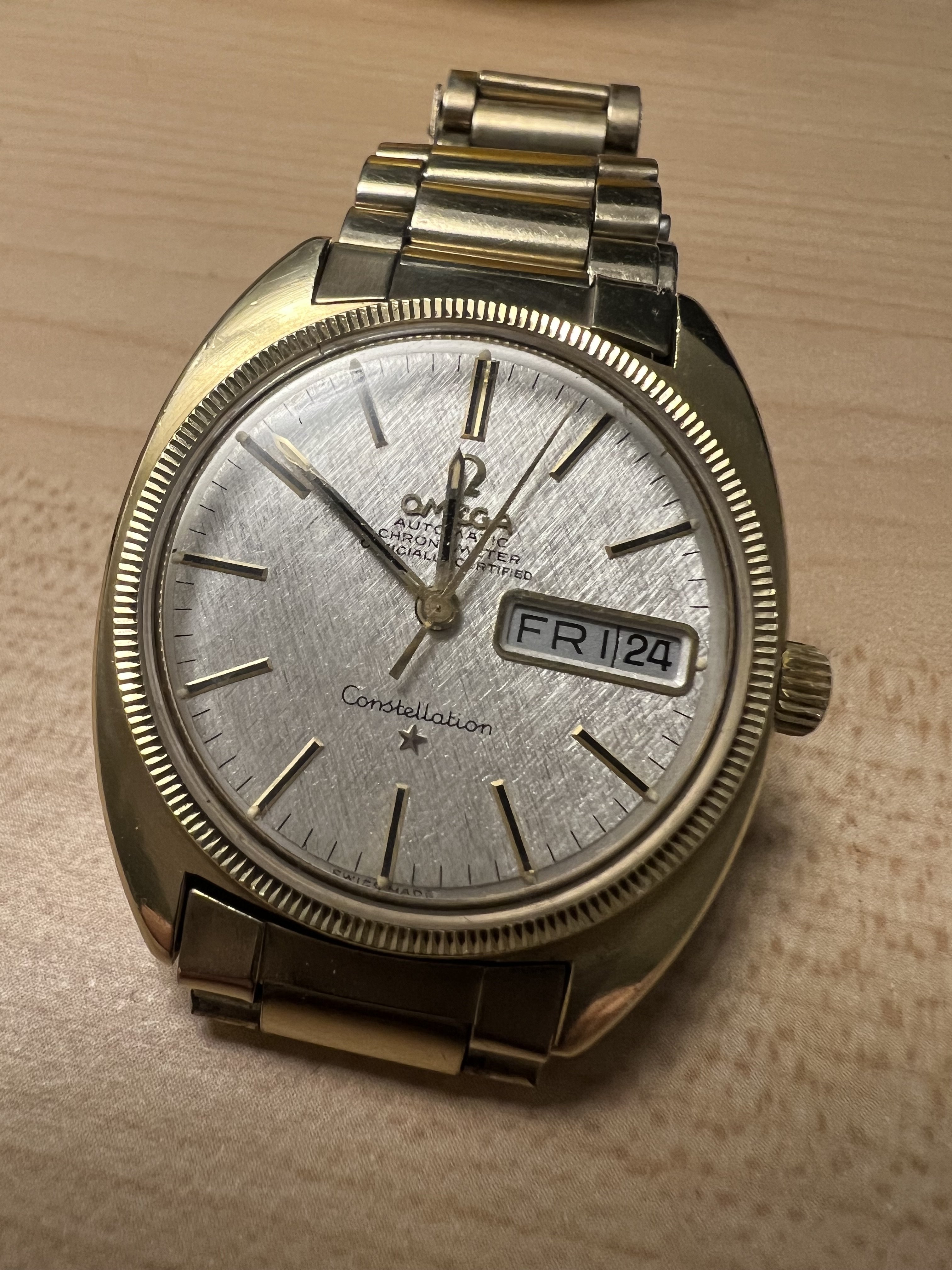

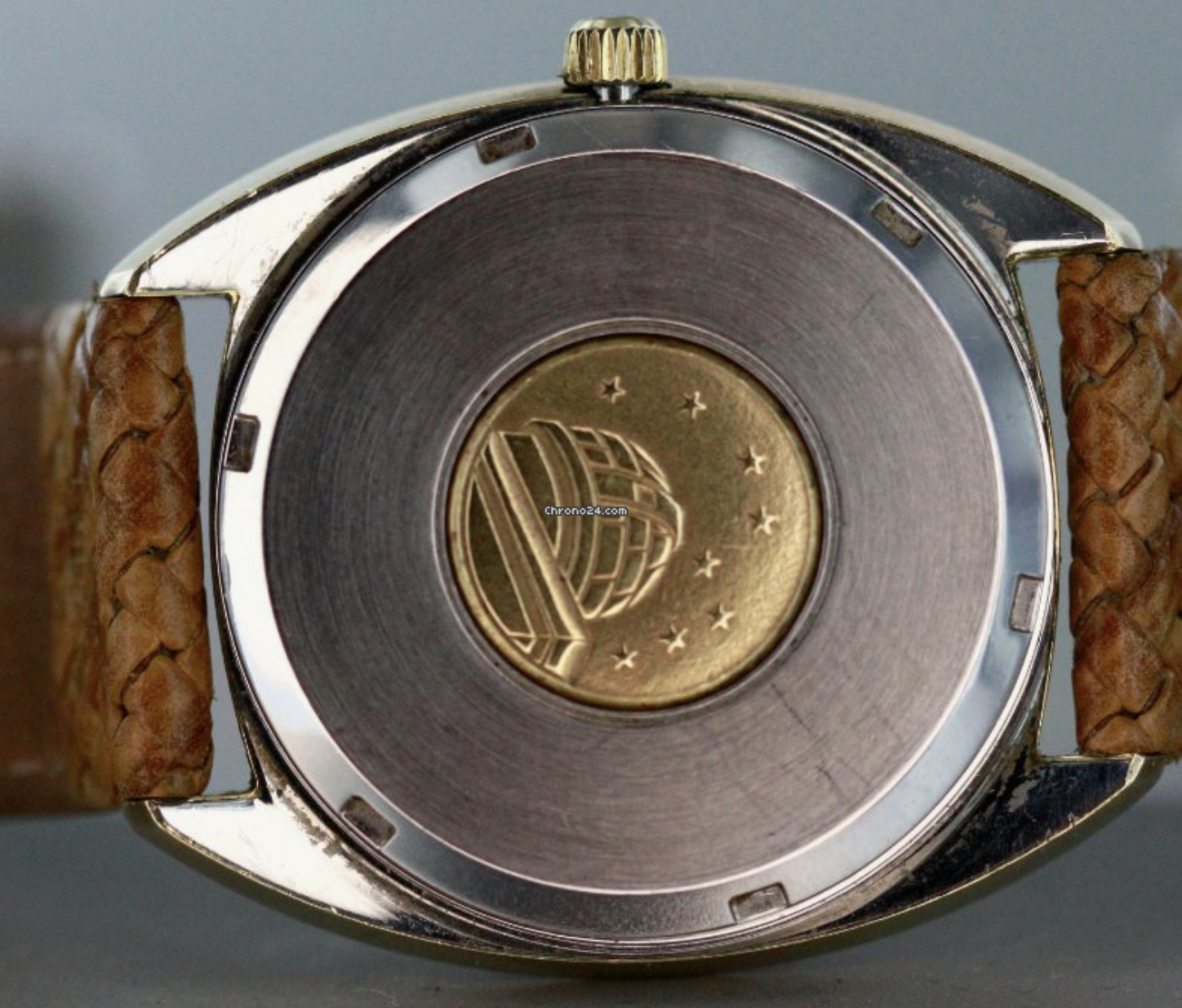

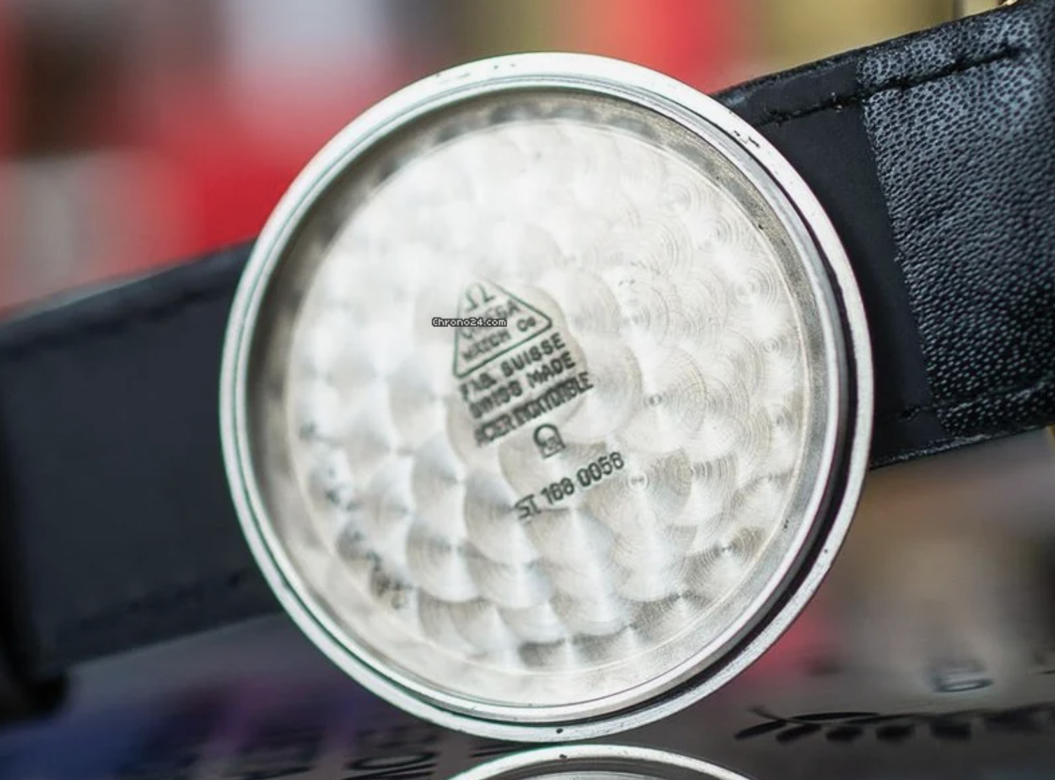

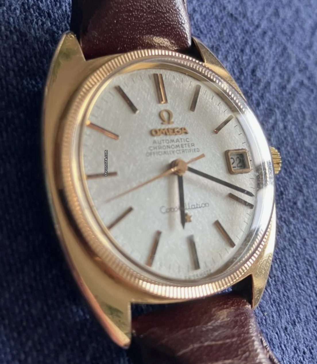

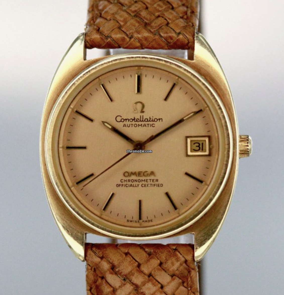

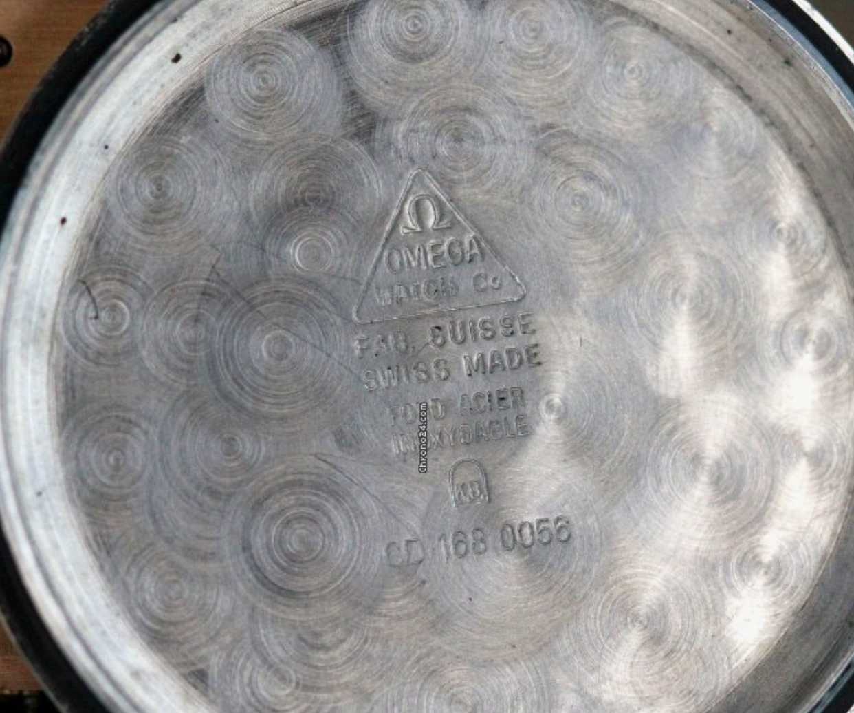

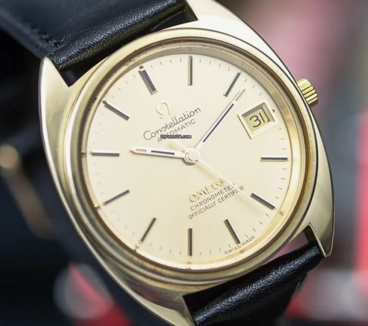

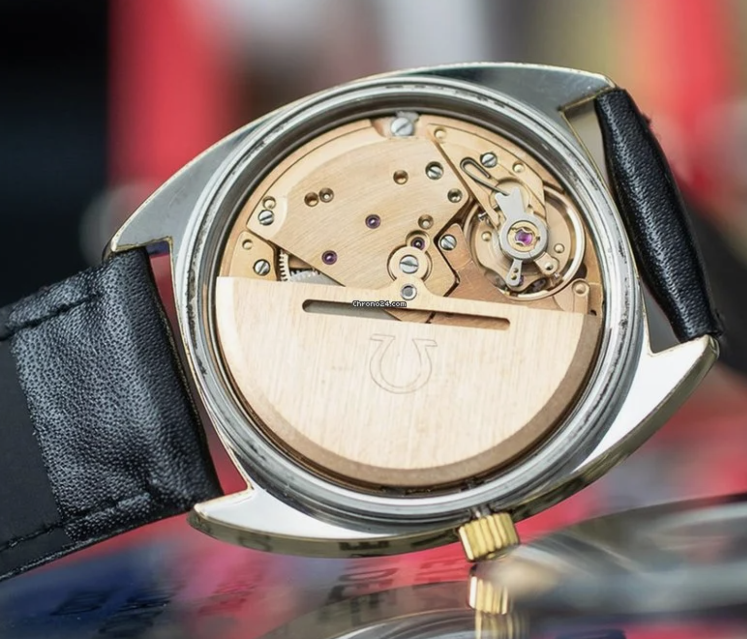

Hello all,
I have took a look to all the info you shared with me about "how to fish" and I think I have overcame the first newbie mistakes (checking for the "swiss made" at the bottom of the dial, paying attention to extreme polishing through the gold cap, etc). Therefore I am coming with few options from c24 I would like to discuss with you.
Option 1: Private seller. Asking price: 1400 €
Questions:

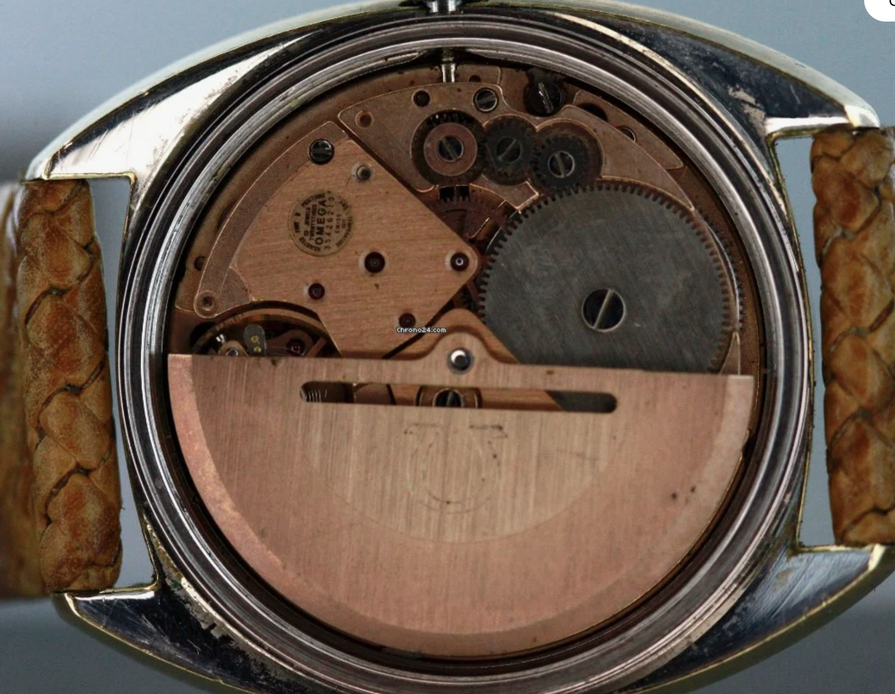

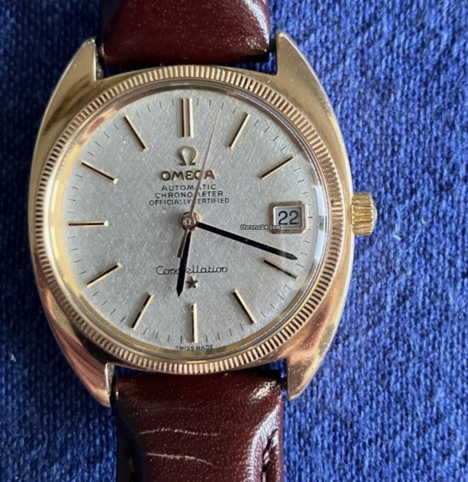

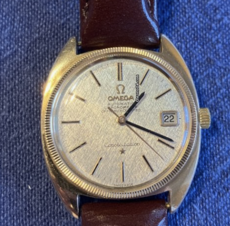

I haven't asked yet for photos of the inside. Regarding the watch I really like the color and the dial, but I am not sure if the hands are the originals one. Also, why there are some constellation with the little star under the word and some without any?

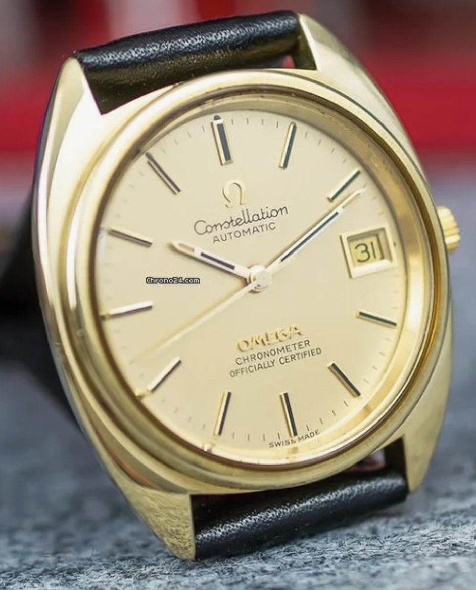

Option 2: Professional seller. Asking price: 1500 €
Option 3: Professional seller. Asking price: 1500 €
What do you think guys? I have dedicate time going "step by step" on these but I am sure I would be missing something. Also, I am not sure what is a "good price" for these pieces so I would love to hear your feedback.
Thank you!
Pd: I hope its ok that I created such a long post with so many photos, if not please let me know.

I also think that the prices you quote are very much on the high side for capped watches with worn/scratched cases.

The cases look soft, especially the first one. As already mentioned, prices on Chrono24 are inflated. You should be looking at about $600-$1000 USD for a C-case. Maybe a bit higher if it's in great condition and recently serviced. $600 being a very good deal at auction. The reason some have a star and some don't is you're comparing different references. Later C-cases have a different movement and they changed the dial text layout. Check out the post below that I made in the C-Case thread that breaks things down at a high level.
https://omegaforums.net/threads/the-c-cased-constellation-thread.72308/page-58#post-2128430
You should decide which reference you want and then hunt from there. In general, the earlier 500 series movements are more desirable. Once you decide which reference you're after, set up alerts on eBay and keep your eyes peeled and check here as you're doing before buying. There are tons of these in Japan so keep an eye out for Japanese sellers but be careful as lots of the Japanese sellers on eBay just re-list Closer0924's stuff at a higher price. That being said, check out Closer0924. A lot of his stuff has condition issues but if you're patient you could find a nice example.

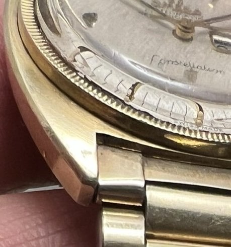

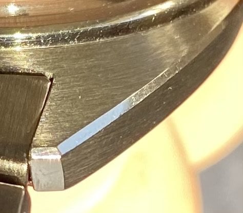

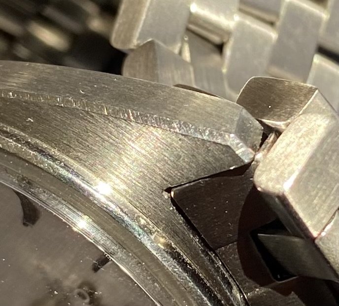

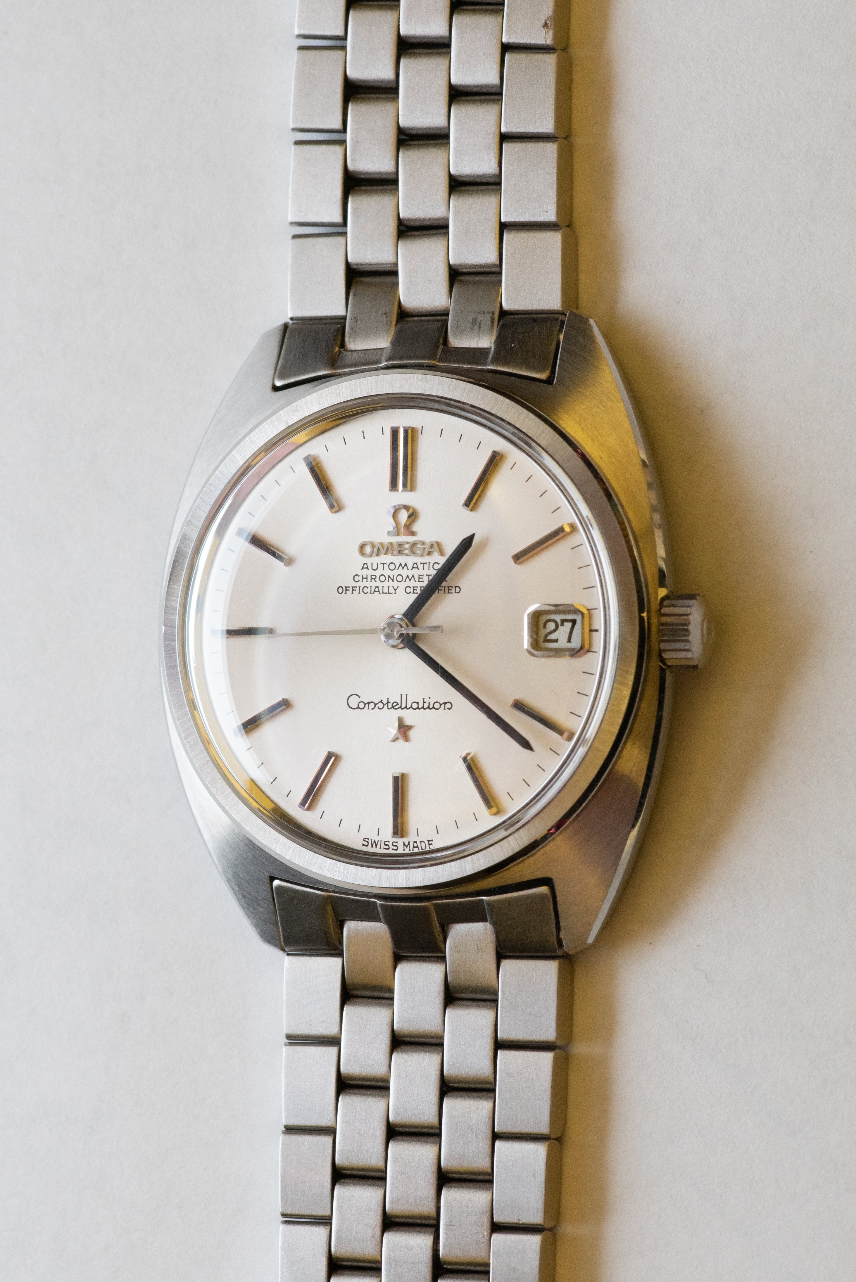

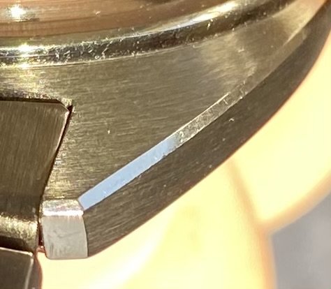

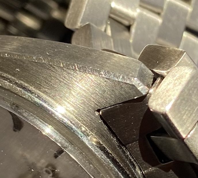

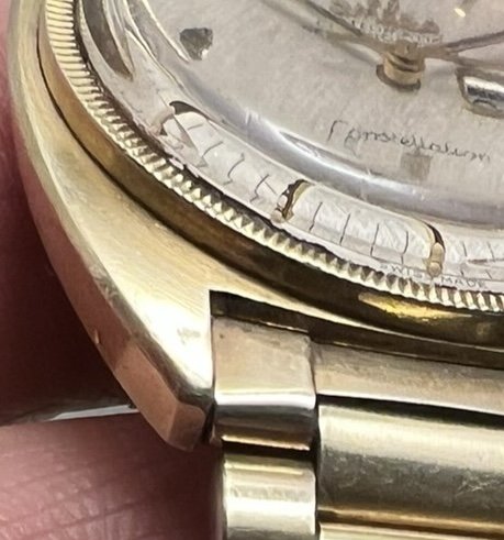

I’ve tried to get a couple pictures of what a “sharp” case looks like to give you an idea of what to look for. In general, a gold capped case will probably be a bit softer than steel but you should be able to see the sharp polished bevels on the side of the case and on the lugs. If the lugs are rounded off you know it’s been polished. Also, the top of the case should have a brushed finish. If it looks polished then you know what happened.
3,672
7,997

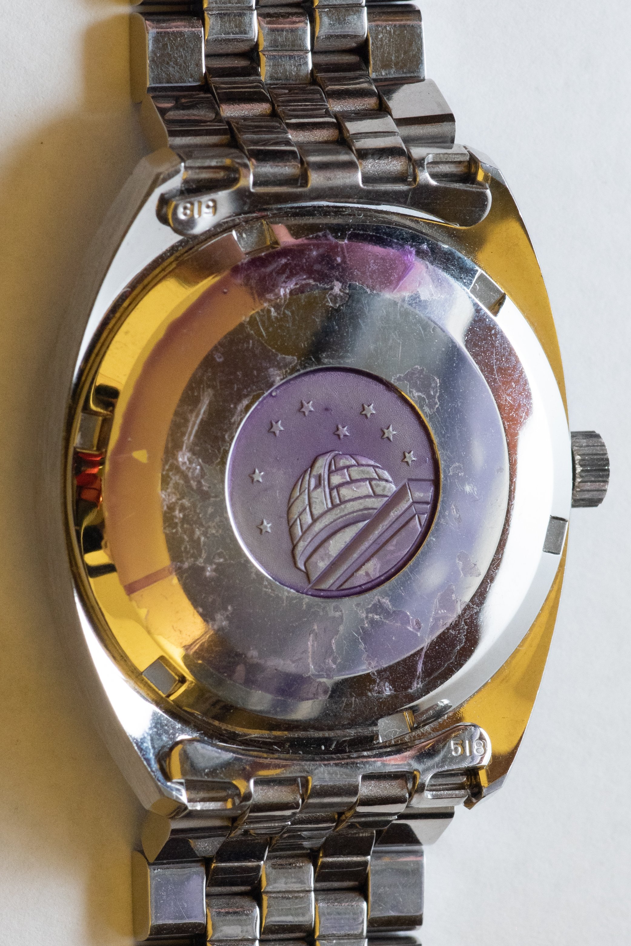

My gold cap not as sharp as @Aroxx SS above but not bad for gold cap still see edges and some circular brushing
edit - you need this view to see the edges many sellers with polished examples will only give straight dial views and it’s hard to tell on those alone
