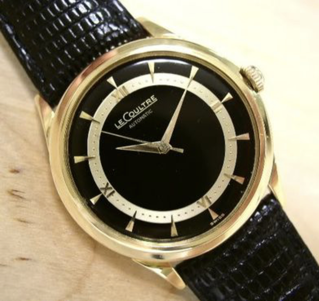

    Recently, I've become interested in finding a black/white, tuxedo dial Memovox. I just love the look because a tuxedo dial is so distinctive, and I'm drawn to the quirkiness/functionality of a Memovox. These are pics of the type I'm looking for.
    [​IMG]
    What a beauty! I love the tuxedo dial and the warmth of the white. It's almost like mother of pearl. I also like how striking the indices are, with the little circle markers. The lugs are nice and refined looking too. Very elegant.
    [​IMG]
    This one's great too. I love the speckled white center. It's like an ostrich egg. I also like the hands of this one more, which serve to make the dial a little more striking to me.
    Until I find one I love, I'm going to keep looking and would like to post the ones I find interesting and get everyone's thoughts. It seems like that is the best way to learn about a particular type of watch, especially from this forum which is full of really knowledgeable people.

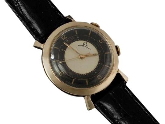

    This is one that I found pretty interesting.
    https://www.ebay.com/itm/SERVICED-J...ANICAL-ALARM-WRISTWATCH-WITH-BOX/293090050909Purchases made through these links may earn this site a commission from the eBay Partner Network
    I like the stick indices more than I like the dagger ones, but this one seems interesting. I wish it were more "black and white," and I wish it had the small minute markers, which add depth to the dial.
    What do you guys think of this one in terms of quality, the type, etc? Are there things I should be on the look out for when getting a vintage Memovox? I've gone through the forum and read the posts about them (and the Hodinkee article), but any advice and insights are greatly appreciated. Thanks!

  2. Dan S Jul 24, 2019
    18,588
    42,858
    That last one is absolutely horrible, a franken-watch with mis-matched hands and dial furniture (I don't think the hands are from a Memovox), a terribly repainted outer dial, a repainted (or fake) inner dial, and an over-polished case. Garbage.
    The first one is also pretty bad, over-polished with various replacement parts.

  3. gatorcpa ΩF InvestiGator Staff Member Jul 24, 2019
    12,168
    15,624
    I’ve seen these in all black and all white. Not sure that these watches ever came with that “tuxedo” configuration.
    It is very easy to replace the center disk. This is why I can never understand the huge premiums for the parking meter and other specialty Memovox dials.
    It is almost impossible to know which combinations were factory correct. This is especially true for the US market LeCoultre pieces, as many references were never cataloged.

  6. ConElPueblo Jul 25, 2019
    9,587
    26,961
    It's a redial, but other than that it is ok. The hands should have lume on the tips and are common on early memovoxes.

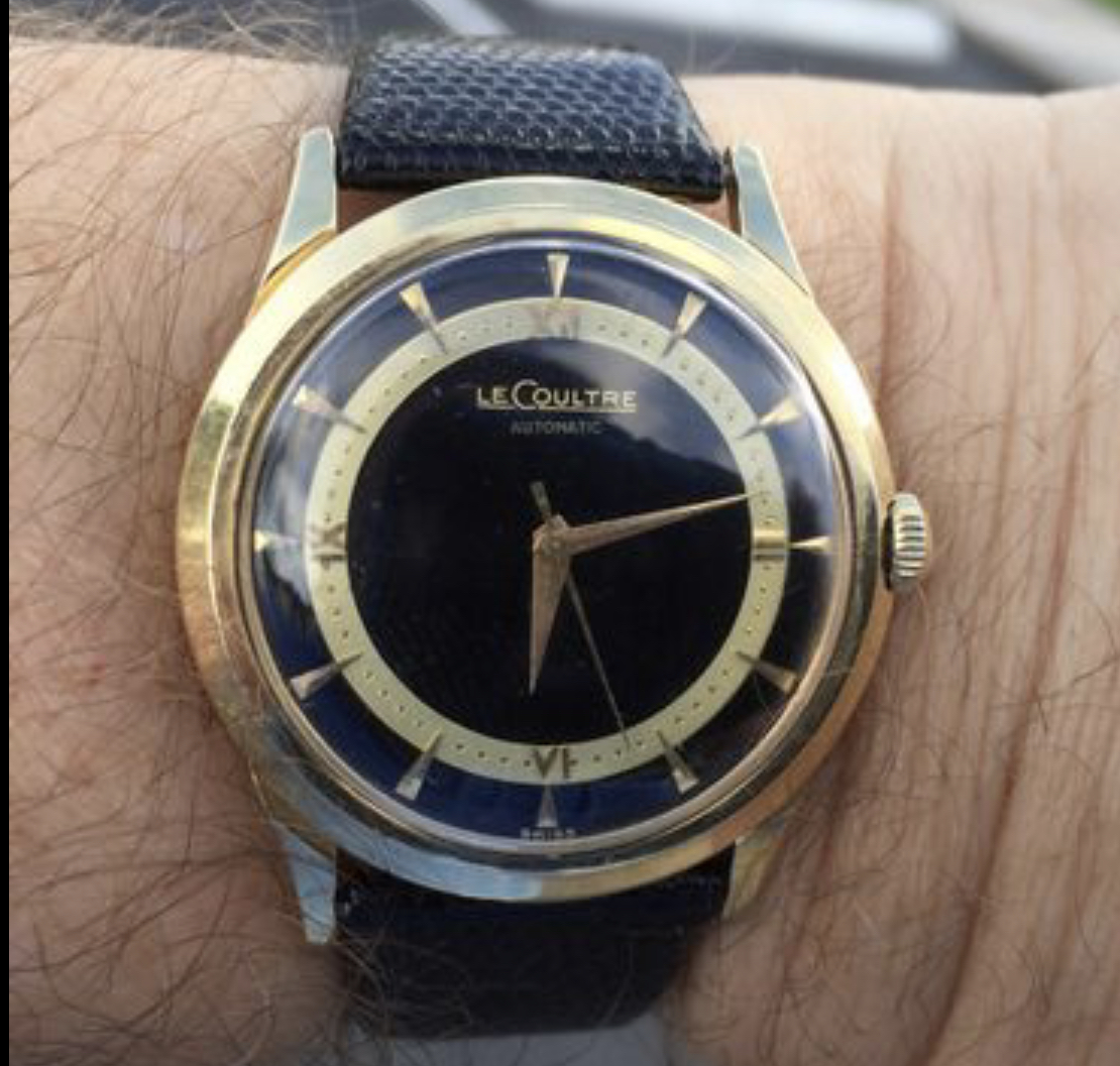

  16. gatorcpa ΩF InvestiGator Staff Member Aug 13, 2019
    12,168
    15,624
    There are bullseye LeCoultre’s also.
    77E523B2-7230-4754-B9E4-EE45D1E3FB2E.jpeg 7EA81213-26F7-489B-BFDD-4AE211CCA932.jpeg
    This one is unusual in that it has an 18K gold US made case. It took me 10 years to find the one on the bottom after seeing the one on top.

  18. gatorcpa ΩF InvestiGator Staff Member Aug 13, 2019
    12,168
    15,624
    Not much of a story. Saw two other examples in 10 years. One at a ridiculously high buy-it-now that I passed on and the other one you see above.
    I made the seller an offer to end that second auction early and they turned me down. Ended up winning auction for little more than half my offer (and less than melt value).
