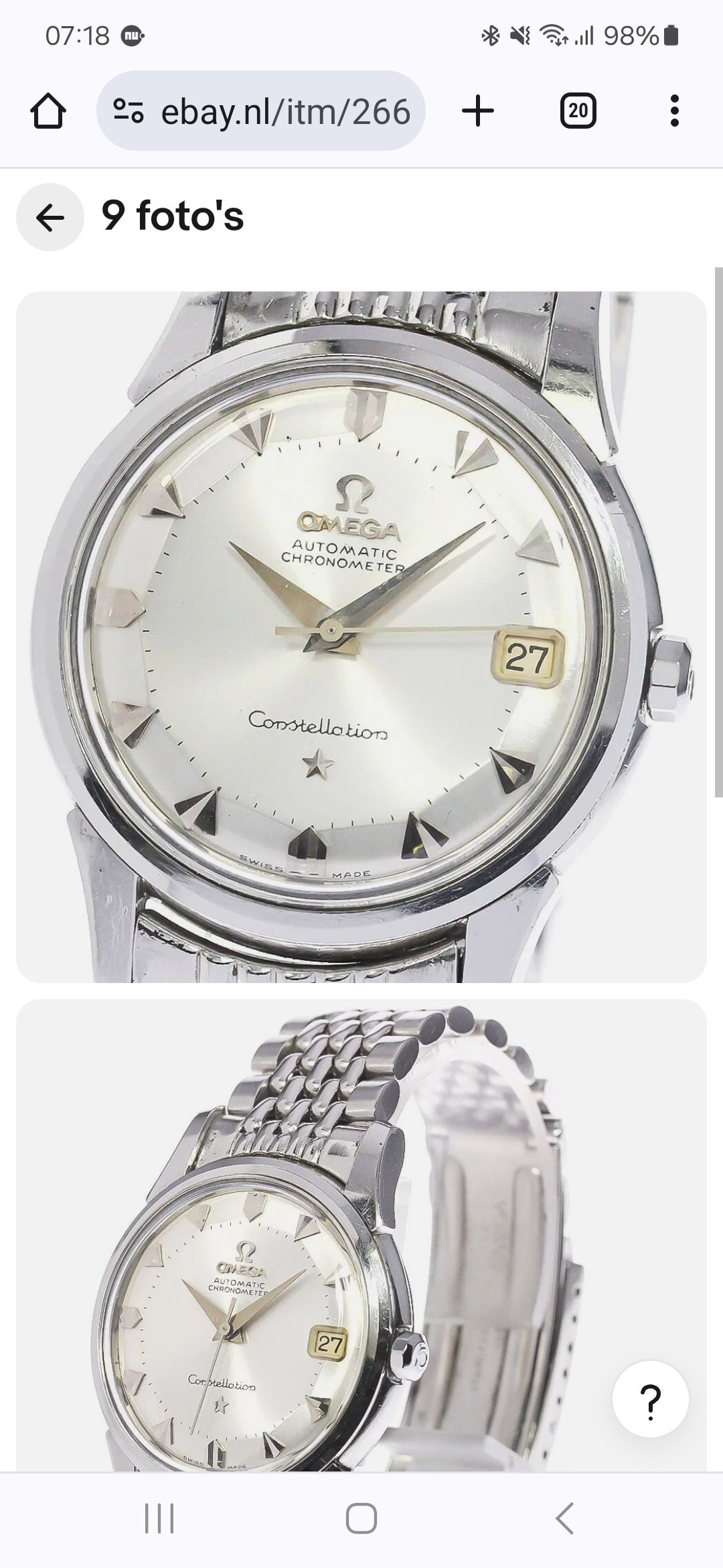

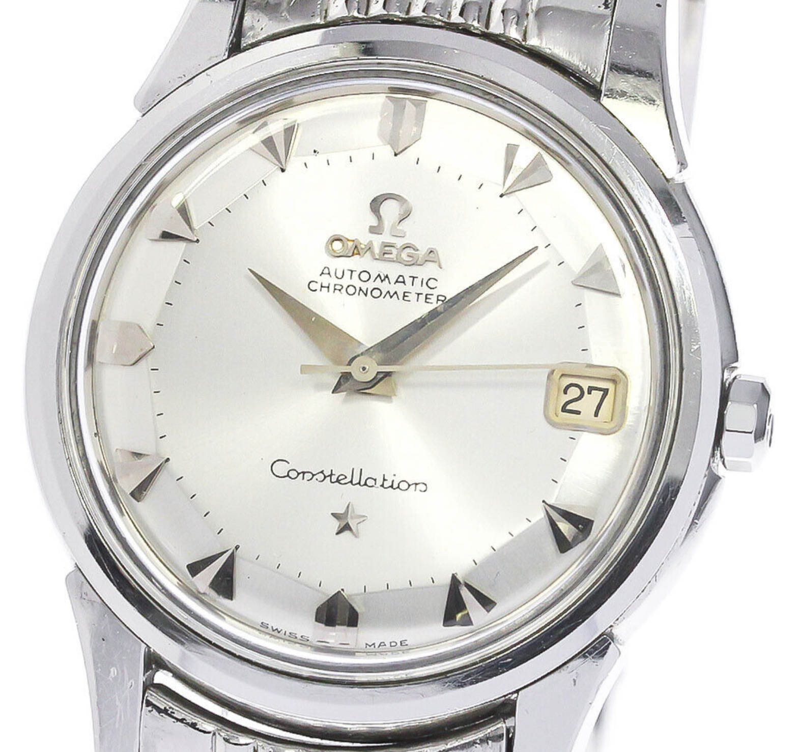

The one from closer.... dont you think there's something wrong with it? I think it's a refinished dial.

I’d be surprised to find a very well established seller like closer selling a watch with a refinished dial. At the very least, I would expect it to be disclosed in the listing. The hour and second hands look like generics to me and the bracelet circumference is quite small. OP's second watch has visible spotting on the dial and that would be a pass for me.

Well, closer has sold a lot of refinished dials in the past without disclosure. Anyway, I discussed this watch in PM a couple of weeks ago with @Peemacgee and we both were'nt confident the dial is original. Just a warning to the OP.

Agree the first dial looks suspect. Look at the alignment of the hour markers and minute markers along with the quality and consistency of the text.
Closer have some great watches at reasonable prices but due to the volume that passes through their hands they often don’t identify anything but the most obvious redials.

Something that always makes me pause is the color difference - pretty apparent here between the dial and the date wheel. Suggests something has been touched or replaced. But beyond this, this actually bothers me aesthetically.

As @Shabbaz says, there are possible problems with the first watch you post that shouldn't appear on a Constellation - these things will become much clearer and easier to spot once you've viewed a few Constellations.
The minute haches are too close to the edge on this era of pie-pan and are an irregular distance from the edge
I think the arrowheads intrude too far into the inner field
The fonts should be serifed and look to be plain on this watch (although closer's pics are always over exposed and so can mislead sometimes)

larger pics of closer's watch
