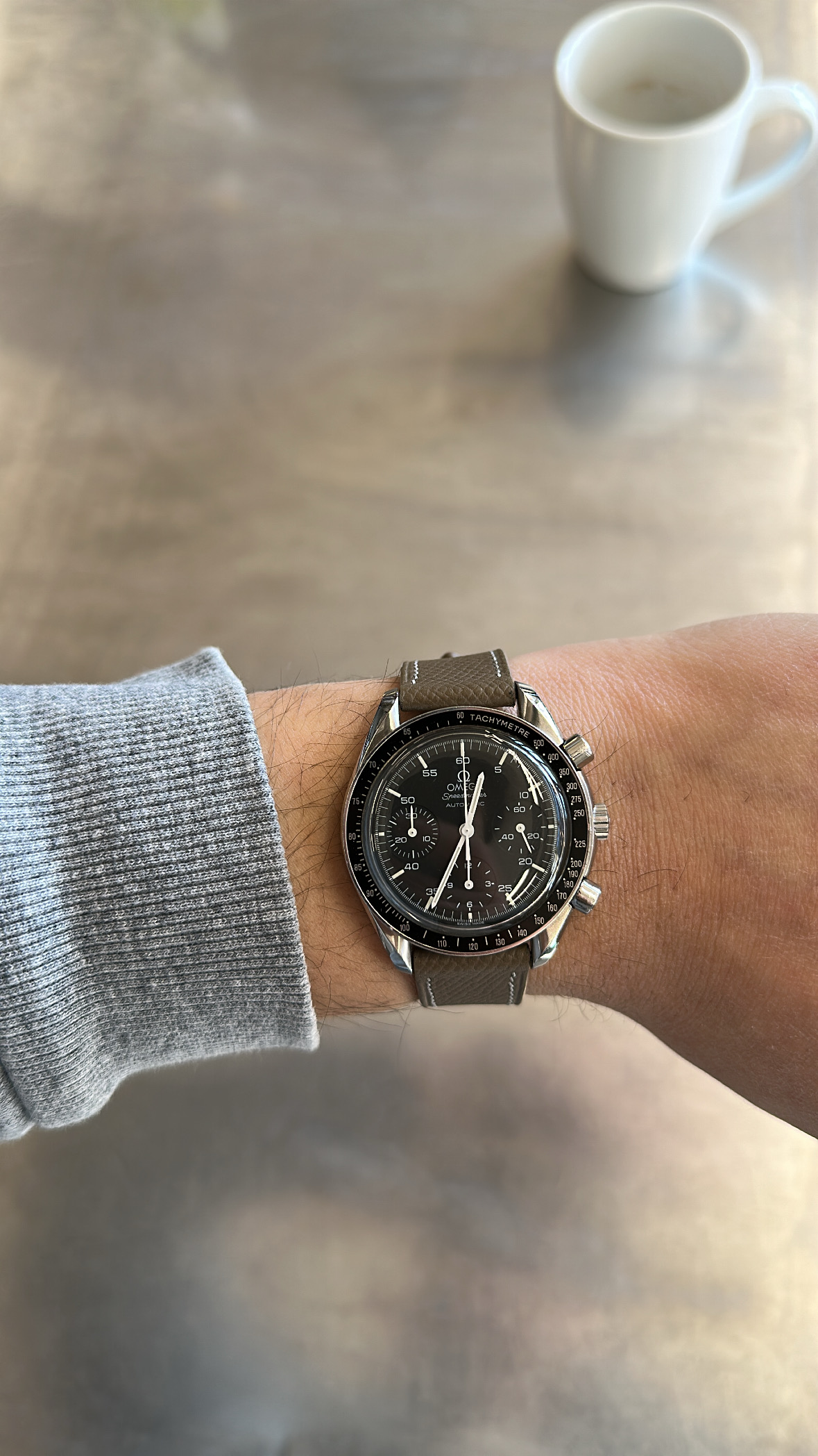

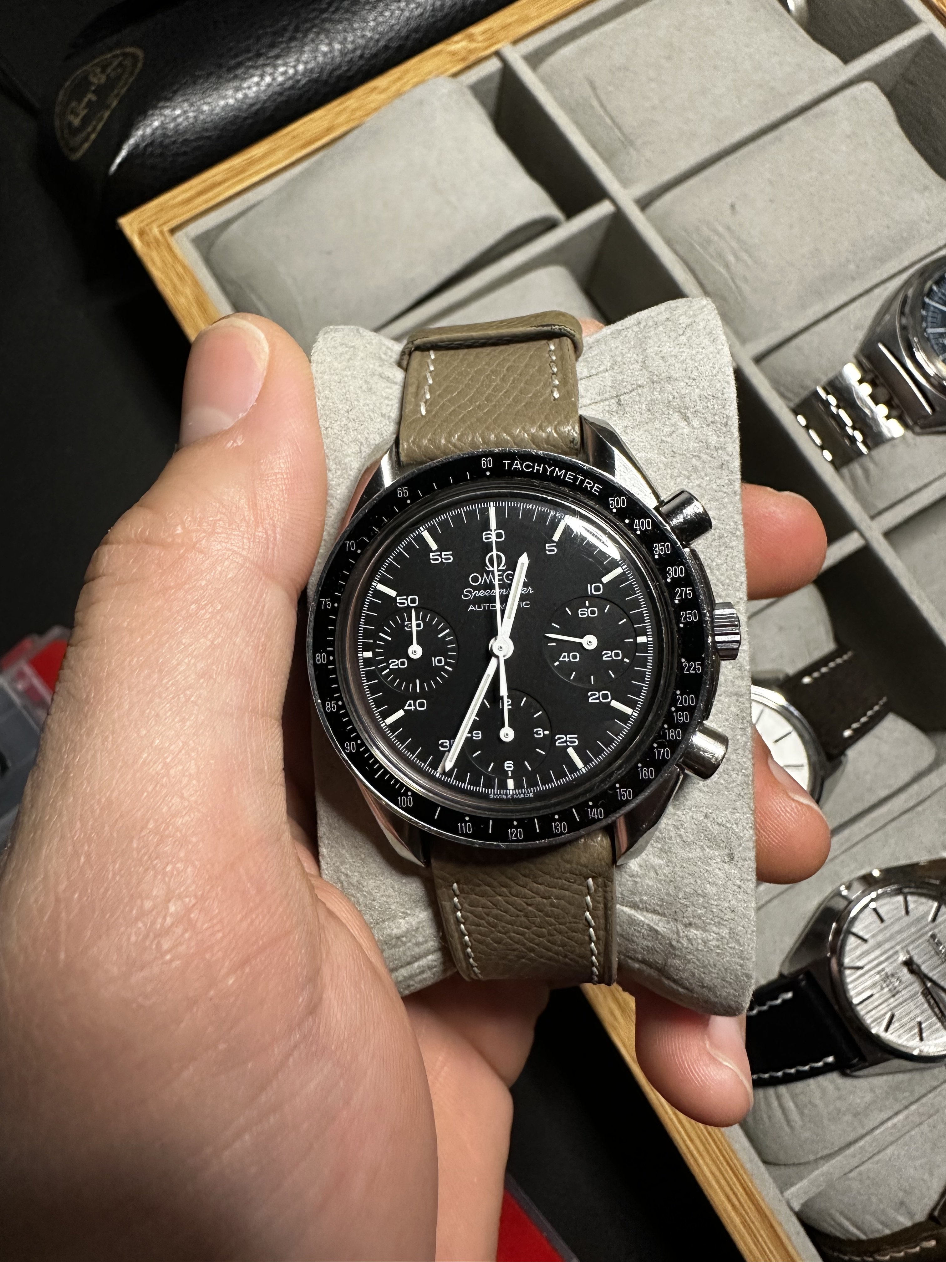

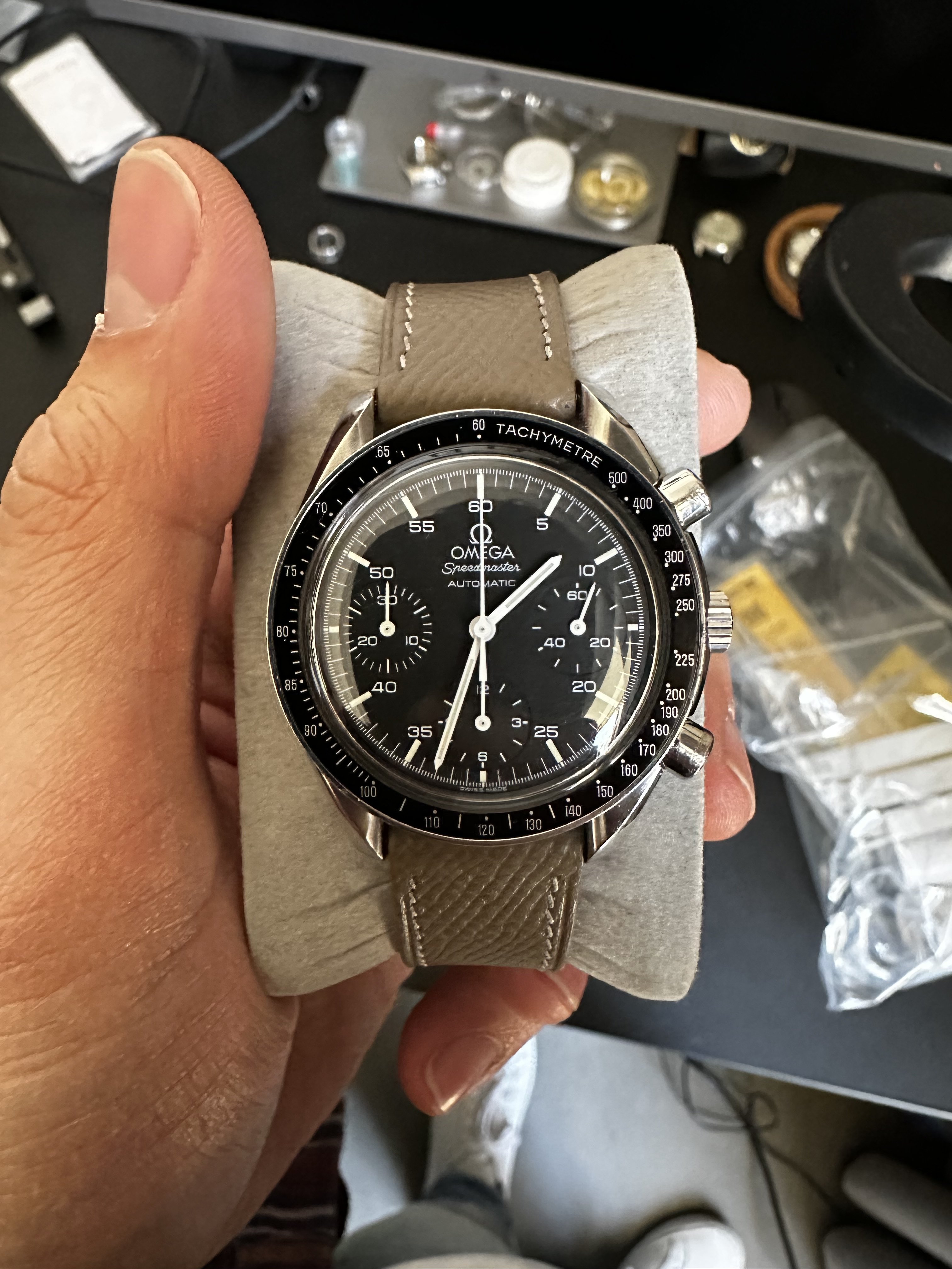

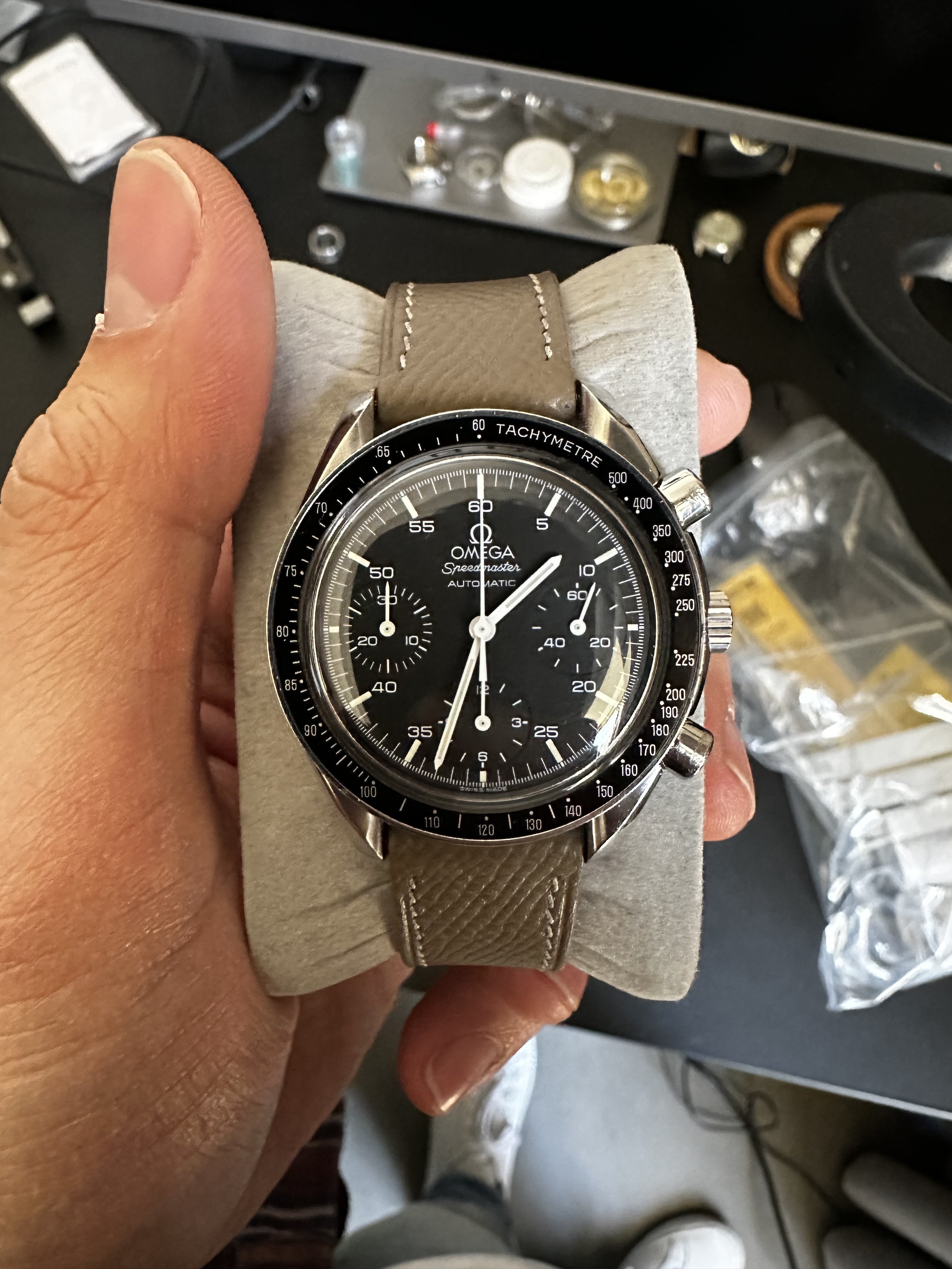

Good day Omega forum! My speedmaster reduced (3510.50) keeps stopping at the same spot. I have found my speed master reduced stopped at these positions, the watch is still running as the sub seconds still move but the hour and minute hand stay at the same time. When I reset the hands it works fine and will stop again either at 12:35 or 1:32. It doesn’t look like the hands touch. Any ideas on what could case this?

To understand how a Speedmaster Professional (not the reduced) should operate is easier to diagnose, if and when it performs erratically. The problem with your Speedmaster reduced is more likely with the Dubois, Duprez chronograph module rather than the base calibre. Not too many on the message board really understand the Dubois, Duprez module. Unfortunately. Anybody?

All hands are driven by the module, so it's definitely in the module. Not sure that guessing the specific problem is going to help much - it needs to be sent in for service anyway...
