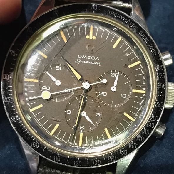

The hand looks pretty dope actually 馃榾 A double lollipop thing 馃檮
Well I have not seen an hour hand like that.
I thought lollipops were on later 2998's but that's not based on solid evidence, just observation and hearsay. Not that I care! (It's a lollipop)

Wait, so is the cell phone photo from when he found the watch "in the wild?" If so, that's truly a once-in-a-lifetime find. Can't believe he's selling it!
1,396
14,935
My friend found the person that had it and I'm pretty sure he didn't really know what he had until they met. There and then the photo was taken or something like that. I've known about this watch for some months but couldnt post anything about it until it was officially up for auction.
I don't have the full story here but somewhere along the way I think the advice he got was to put it up for sale at an auction.

That is a hand that I have not seen before. Doesnt mean it is not correct, I just have not seen it before.
More on 2998 hands here, and in links in that page, for real 2998 anoraks.
http://speedmaster101.com/blog/further-2998-hand-observations/
Also have a look at the minute hand lume, nearest the outer edge, does it seem closer to one edge than the other, ie off centre? (at the end of the hand not the centre post)

Interesting that the watch has the larger hour hand more normally seen on a 2915-3, a lollipop more normally seen on a 2998-2 and 3 and a naiad crown which may or may not be original. Very interesting!
It's like a smorgasbord of desirable parts!

Lets look at the as found photo:
The first thing that strikes me is that this is potentially an amazing rare watch:
Triangle lume hands
Correct small indices dial
Lollipop hand
BASE1000 bezel.
What I do not like from this photo is the shape of the hour hand and its lume, the colour of the lollipop and the colour of the subdial hands. There appears to be a mark on the dial at 2 o'clock and this could be the crystal - but we need to clarify. If its on the dial then you can cut the value in half.

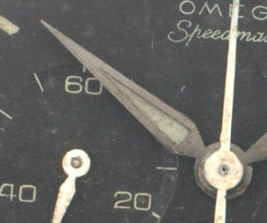

Lets look closer at the hand from the as found photo:
I have not been able to find a comparable hand to this on a 2998. Could it be a 2915-3 hand?

So I examined the two side by side.
Is it the same hand? After too much time looking at it I think it is. The edges of the metal are not showing in the as found photo, but if you look carefully they are wider than first observed, and so while at first I thought the lume was too big for the hand, now I do not think that there is anything wrong.
I am willing to accept the as found photo was not under ideal conditions and so may be inaccurate due to lighting or something. The hand above is acceptable.

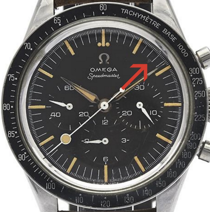

So again lets reproduce the auction photo:
It looks so much better here.
Lume looks good, the lollipop looks a better colour and even the subdial hands look more in keeping.
Without the as found shot, I think this is a good watch.
Subject of course to checking the dial is clean.
All of this is only my opinion, there are others who know more, I only observe, and collate from previously observed watches.
To sumarize, if this hits more than $60,000, then it is setting new highs. Which it may well do.
EDIT: If i had to make a guess and a prediction, this watch will sell for $40,000 - $60,000 to a dealer.
