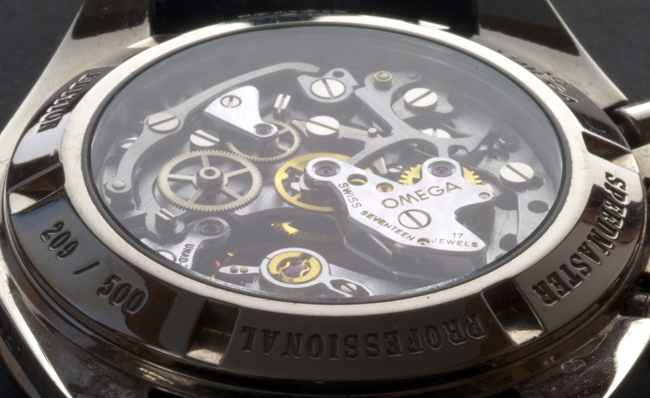

Here's an c864. It's a chronometer version of the c861

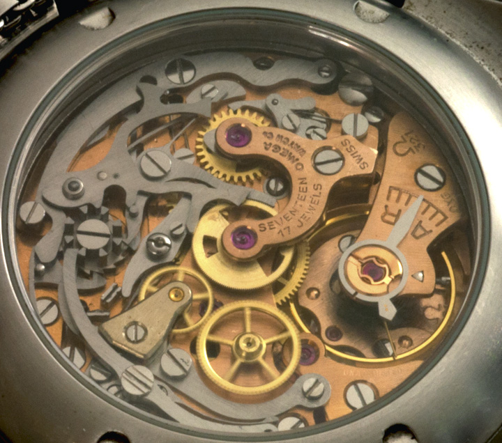

Here's some shots of the c321:
