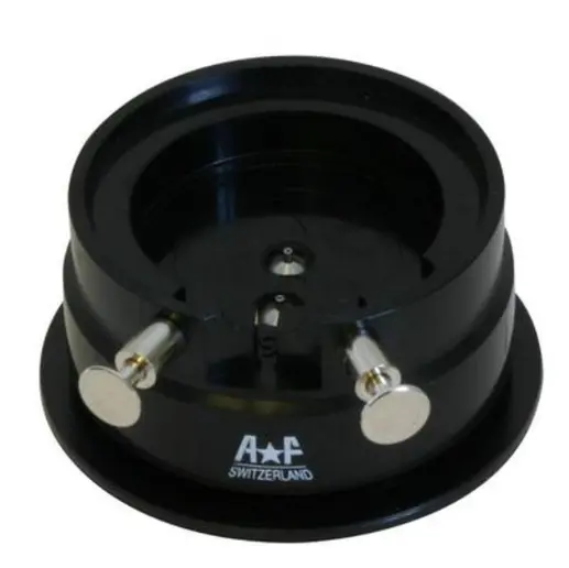

Thank you for the response! i'm looking for a movement vice/holder for working on the movement.
One in question is something like this with support pins:

Curious if jewel support is even a thing that is used in modern servicing of the 321? I have not seen too many modern Omega movement holders for the 321 in photos or video, but that is from my very limited view on the net.
