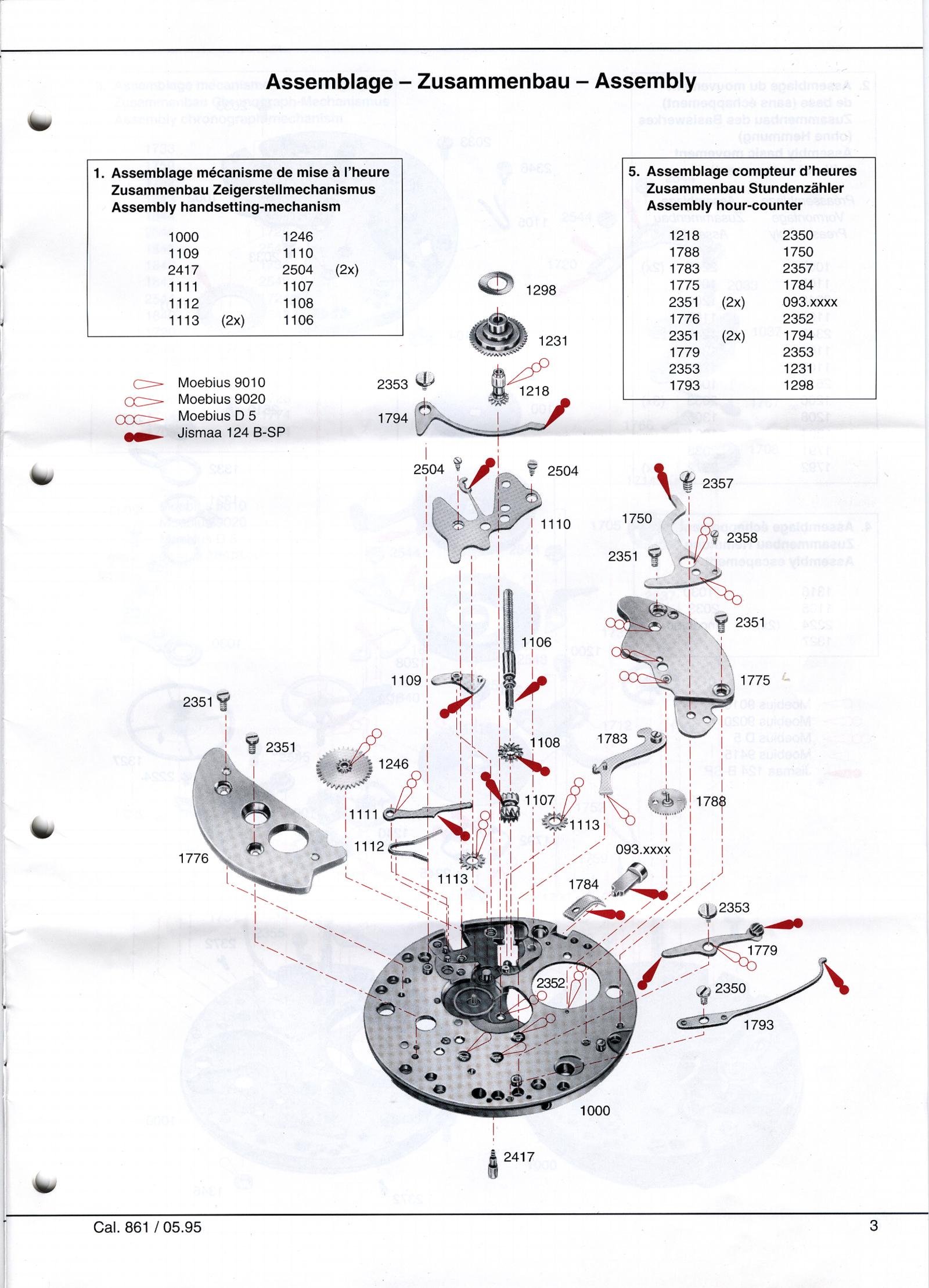

Does the start/stop button work ok? There is a common fault with the 861 movement where the operating lever for hour hammer can get worn/broken preventing it being reset. It was one of the parts I had to replace on a Mk2 Speedy I serviced recently. The bit marked 1784 here.

Archer, I bow to your greater experience, but am I not right in thinking that the part 1784, against which the lower pusher acts, is the bit that starts the entire reset action off? With the hour hammer also operating the rest of the mechanism, or have I got my understanding of the mechanics the the 861 arse about face? Obviously, if it is only the minute counter that is not resetting, this would be irrelevant but I read it as the entire chrono is not resetting?

No. The part that starts the reset is 093.xxx, the pusher stem for zero action. The very first thing that resets is the hammer on the back side of the movement, which resets both the chronograph seconds recording hand, and the minute recording hand. The pusher stem for zero action moves the stem bolt for hammer (1759) off to one side, allowing the hammer to drop. Here's a video demonstrating this:
You can do this with any 321, 861, 1861, 3861. The reset of the chronograph seconds and minutes is separate from the hour recorder, so as you can see I reset those and the hour recorder had not yet reset. That only happens when you press the pusher deeper to cause the operating lever to push the hammer down on the hour recording wheel.
So if the chronograph minutes and second are not resetting, it has nothing to do with the hour hammer operating lever, because that only comes into play after those have already been reset. Of course the hour hammer operating lever should be replaced if it has a hole in it - that's one of the upgrades Omega considers mandatory. But in tis case if it was actually broken, then the reset wouldn't likely work for the hour recorder at all, but the OP states that it does work sometimes.
