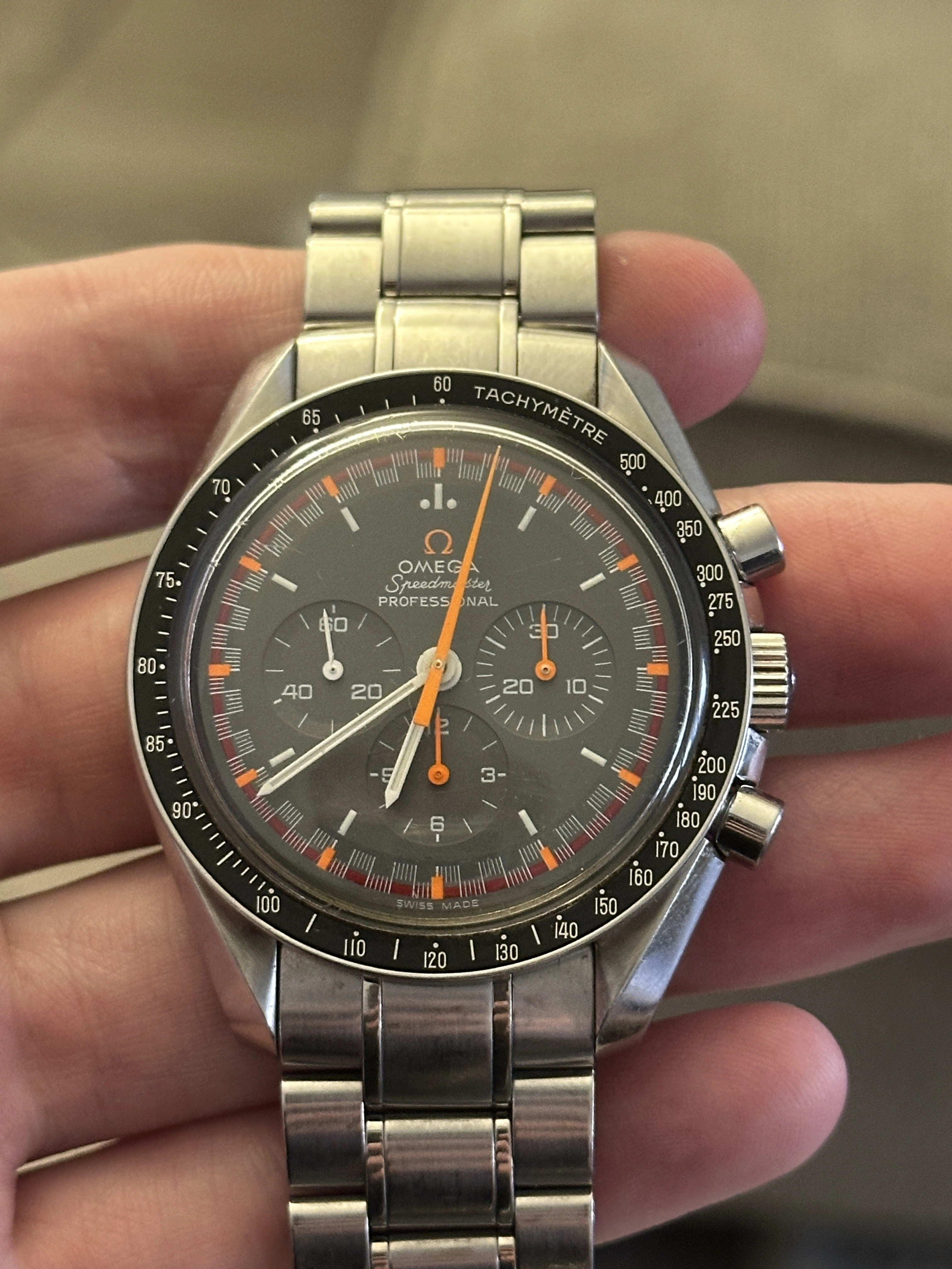

Does anyone know how to align this? Is there a way to do it?
When I hit the reset button this is where it ends up.
3,672
7,989
Needs to be fixed at service no tricks to fix on your own that I know
6,483
31,913
Long press top pusher, double press bottom pusher whilst doing the hokey pokey.::rimshot::
J/k, take it to watchmaker is my advice.
2,463
11,870
Yeah, unfortunately it's broke.
Quartz are easy to do, these need a watchmaker.
241
252
When I use the chrono and reset it, it will jump ever so slightly to an even worse position.
24,833
55,244
If it's not always resetting to the same location, it may require more than a simple adjustment.
15,995
48,110
If you’ve had it serviced in the past, this might be a warranty adjustment. Worth a thought.
241
252
I haven't had it serviced. It may be time.
241
252
I think something is worn out. Most likely.
30,251
78,093
If the position it stops at is changing each time you reset, the first thing that comes to mind is that the hand is not tight on the post. If it's due for a service anyway, having that done is a good idea, and this issue would be resolved during the service. The tube of the hand can be tightened...
241
252
That may be the issue. I am sending it in today. We shall see what they say.
