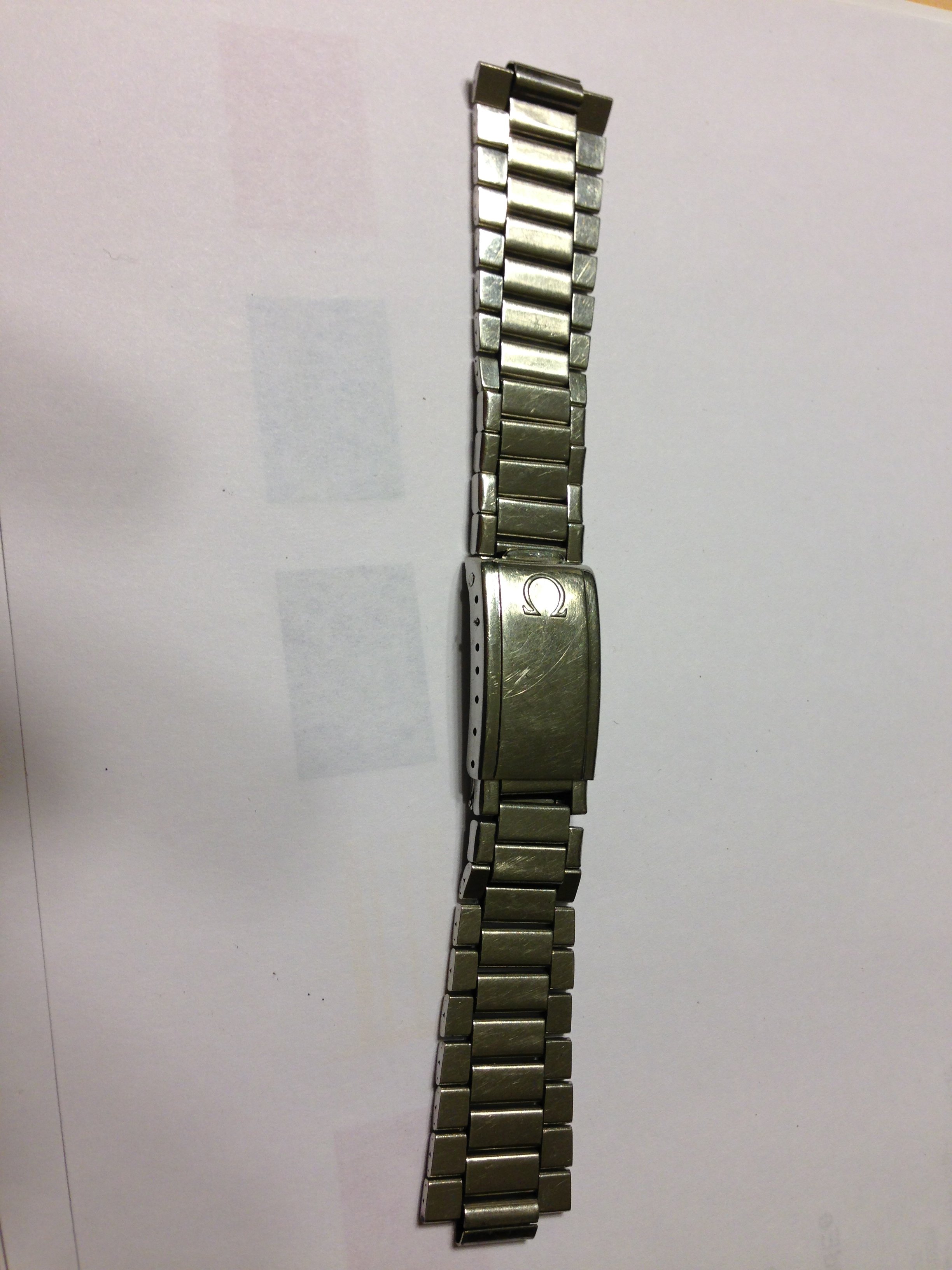

    Is there a way to repair the 1039 bracelet where some of the links have lost their "springiness"?

    You can fix the bracelet. There has been a thread on here about this.
    The member (apologies, I cant remember who it was) sourced a similar material to the original springs - I think it was something to do with the materials used to make musical instrument string, but I might be imagining that. A bit of time with the search feature should point you in the right direction.

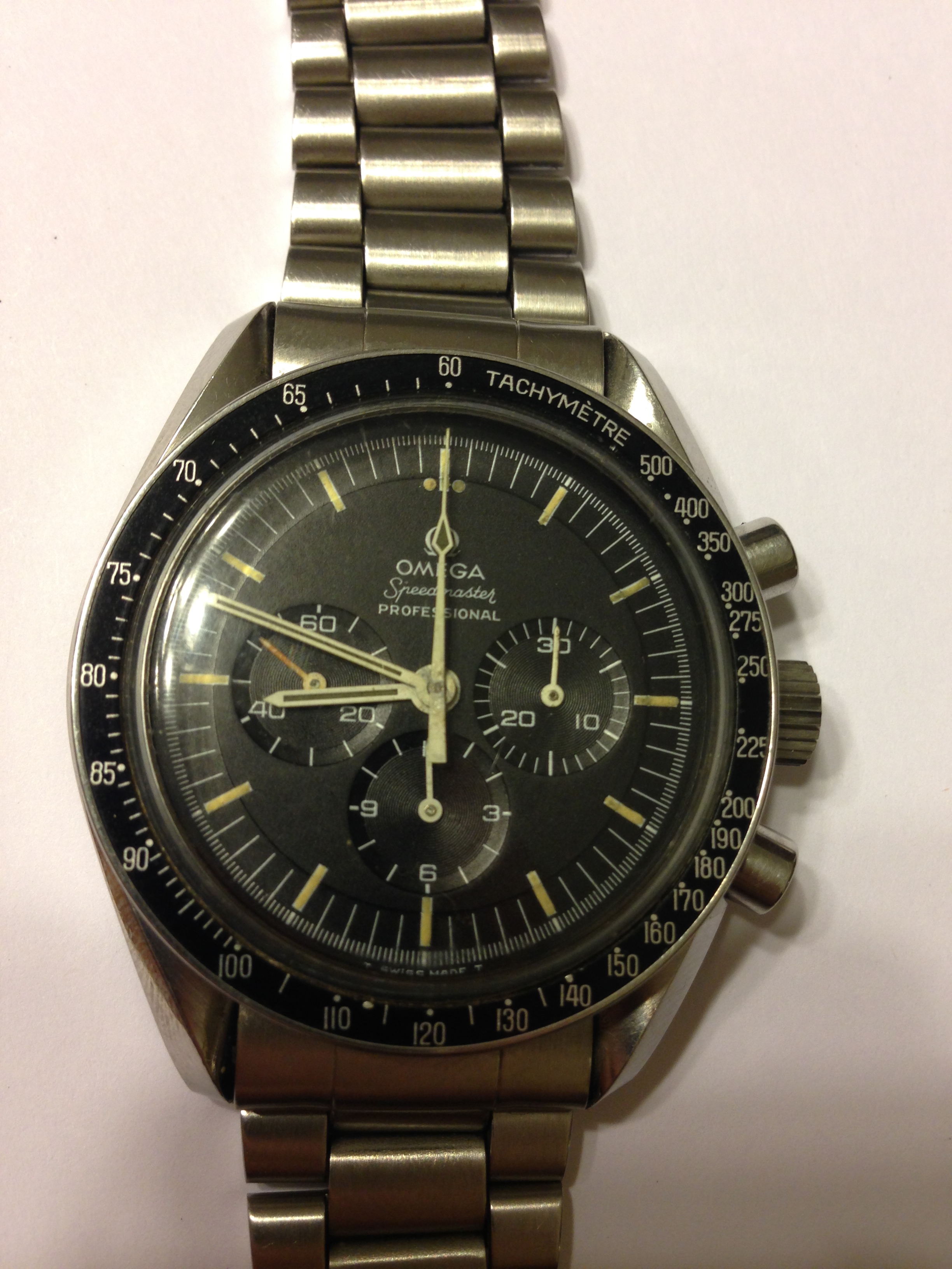

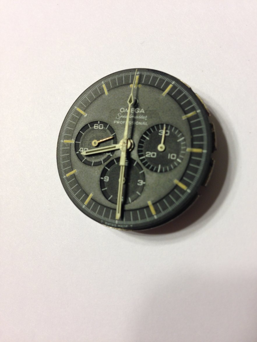

    I am thinking about getting this watch serviced, as opposed to selling it outright. I need help deciding how far to take it. I will have the internal problem fixed and the proper crown put on, I guess my question has more to do with the hands and dial. I have added two photos of the face. Another member commented on "staining" around the Speedmaster text. I have owned this for 15yrs and had never noticed it until he mentioned it. It is nigh undetectable in person, but there is some extremely light discoloration. He also thought there was a water stain on rust on the sub-second dial. The discoloration seen in there in the photo is just a reflection from the lighting. I think it is just the lumen is gone on the hand.
    Anyway, should I have all of the hands replaced? Some of them? Can they just be "re-lumed"? What about the hour markers? I want to replace as few parts as possible, as I am on team "keep it original".
    Thanks in advance,
    Ulysses

    Keep it original.
