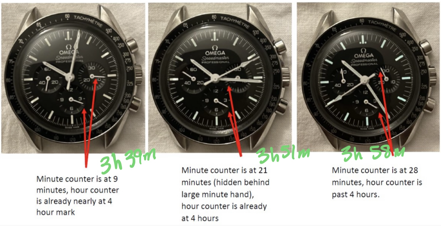

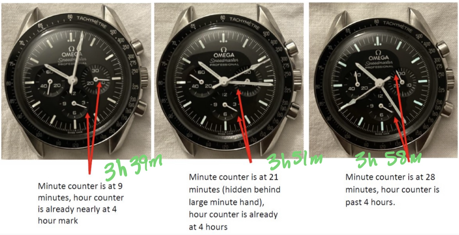

Firstly, the hour subdial on the chrono function of the watch is misaligned and is too fast by around 10 minutes. I have seen the description from Archer on why this may happen so I tried to let it go, but mine seems like it's off by quite a bit. I have tried the trick of holding the reset button and slowly releasing, but this does not fix the misalignment. Pictures below:
Additionally, my chrono second hand is activating the minute subdial about 0.8s to 1.0s too fast, which I have also seen as a problem before in the forums. When it is reset it is slightly off to the left, so maybe this is contributing too. Pictures of the issue below again:

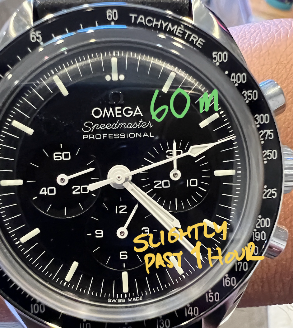

I have a 3861 and I just performed the same chrono test for 4 hours. Here are my findings:
For the first half hour, the hour subdial was pretty accurate. After 30 minutes, that's when the hand on the subdial started advancing a little faster.

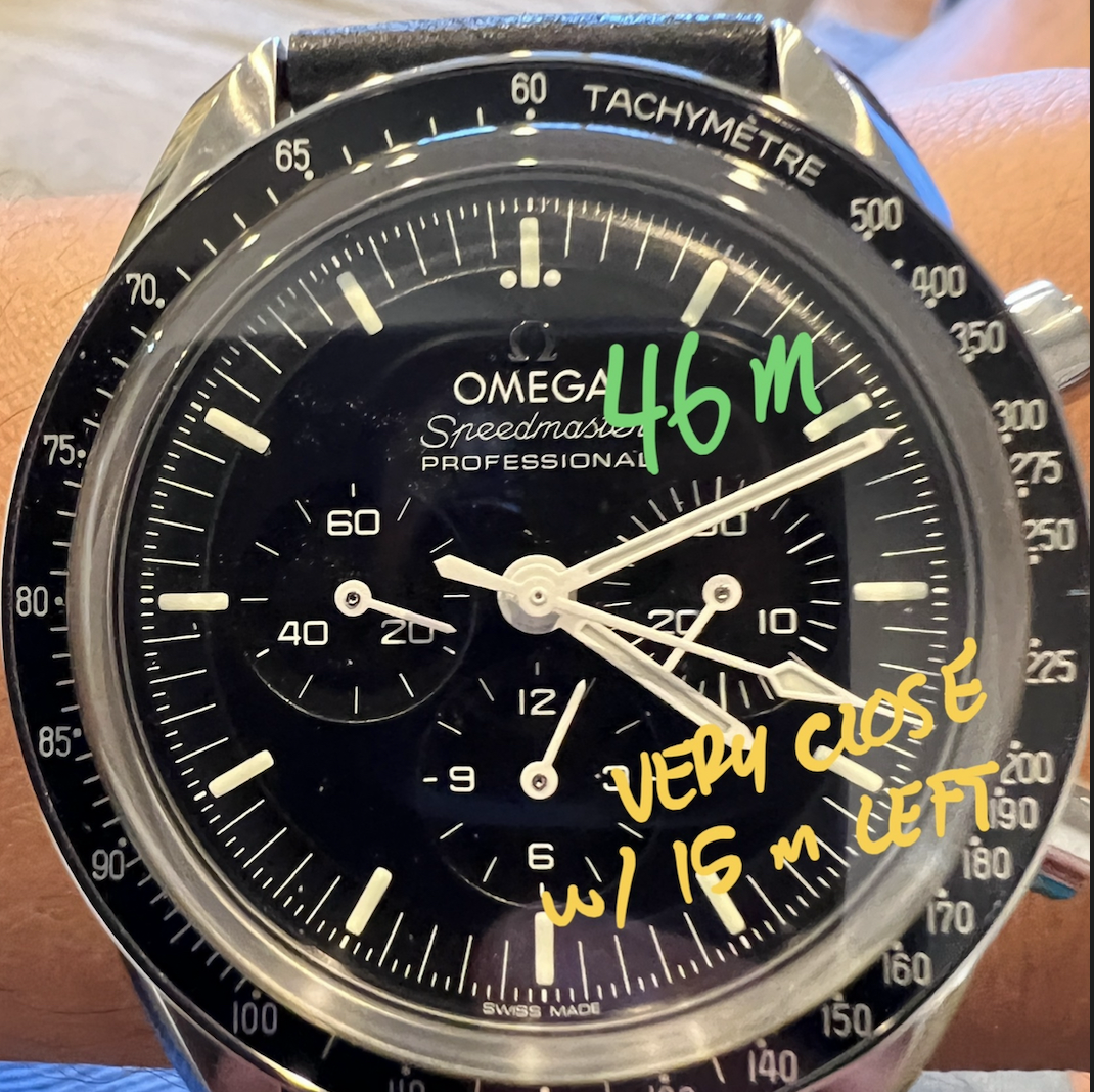

Min Subdial @ 46min
Hour Subdial @ very close to the 1 hour mark with 15 min left.

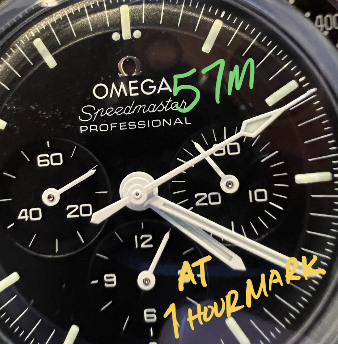

Min Subdial @ 57min
Hour Subdial @ Hand is at the 1 hour mark

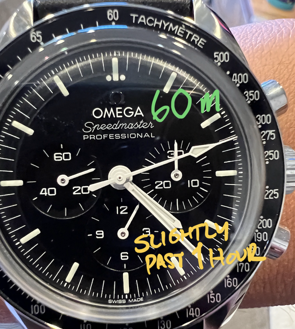

Min Subdial @ 60 min
Hour Subdial @ very slightly past 1 hour marker

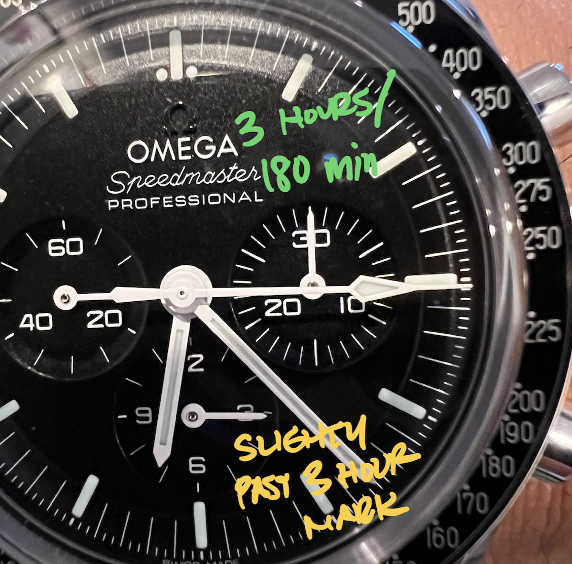

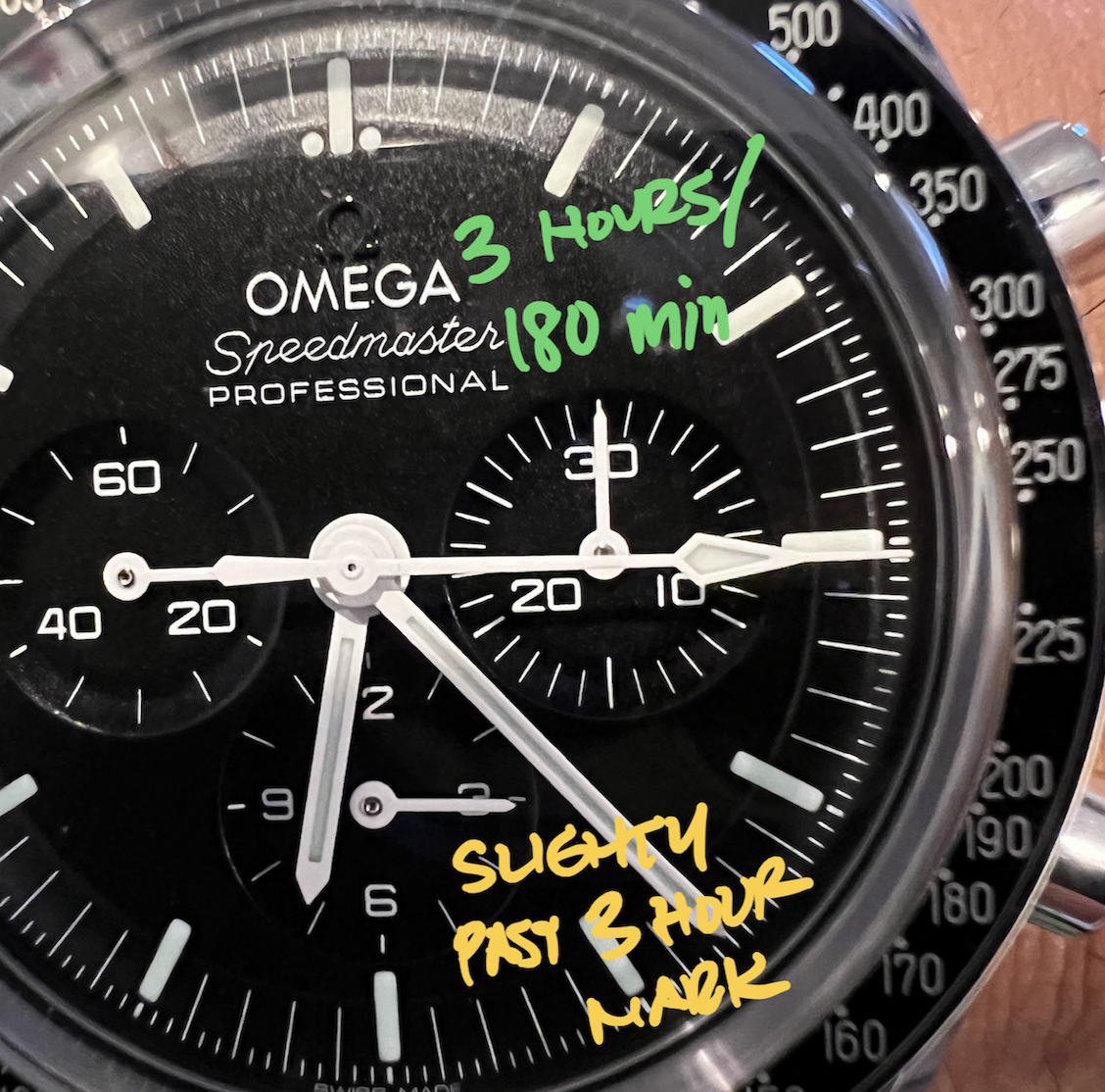

I repeated this for 4 hours and the hands were accurate to their location from the first hour. This is the picture at hour 3. The picture angle and lens distortion makes the hour hand look a little more severe but it was very close to the 3 hour marker.
Conclusion: The hour subdial is slightly off when it approached the hour marker. I had a friend do the same test on his 3861 as well with identical results so it seems to be common in multiple 3861.
Not sure if anyone can report the same movement behavior with the 1861. All in all, while slightly inaccurate, I can still easily tell whether it's the 1st 30 min or the 2nd 30 min. I don't think it's worth the trouble of sending it in for warranty. I'll probably get it serviced a little earlier and get it addressed then.
With that said, I think your hour subdial is the same as mine and I think you may have misread your minute subdial. You believe that it was the 1st 30 min when in actuality, it was the 2nd 30 min. In green is the corrected timing. Instead of 9 minutes, it's really 39 minutes and so on and so forth. If so, this would match with my movement.
Hope that helps!

It’s supposed to measure time well enough for folks who need that information. If it does not do that, it’s defective. You just dropped serious cash on a defective watch, it’s not vintage so demand that the factory repair it.

The examples shown here do measure elapsed time well enough, there is no confusion as to what the elapsed time is when the chronograph is run. Yes, there is a slight misalignment of the hands, but this will be the case in most chronographs. Owners can certainly send them in for readjustment but just accept they will never be perfect, especially when used repeatedly.
Min Subdial @ 46min
Min Subdial @ 57min
Hope that helps!
Min Subdial @ 46min
Min Subdial @ 57min
Hope that helps!
Hey bitterspeak thanks for running these tests, I really appreciate it! I hope this data will also help future 3861 owners who google the issue. It looks like your watch has the same behavior, albeit a little bit less pronounced than my watch. I also let my chrono run for 8 hours and observed that the offset was the same for all but 1 hour, strangely during the 6th hour of running the hour subdial was perfectly aligned at the 60 minute mark, who knows why or how it corrected itself...
As for your observations at the end of the post, you are correct that these times are all in the second 30 minutes of timing, I was aware of this but didn't label it correctly in my initial post. Either way, I will have to make a decision about how much this bums me out. I am leaning towards just biting the bullet and sending it in for warranty repair, it's just going to bother me every time I look at it and it just simply shouldn't be this way.
