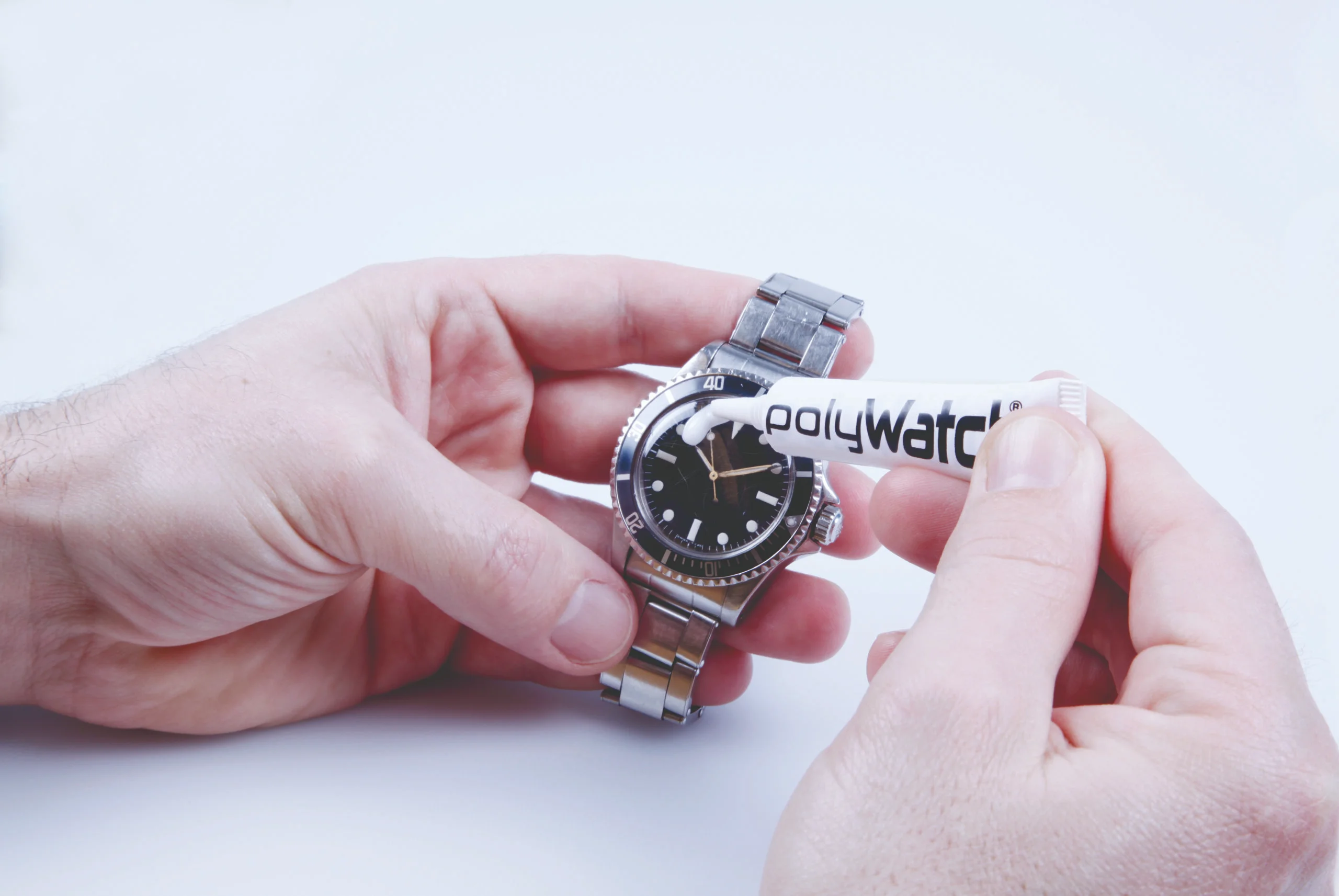

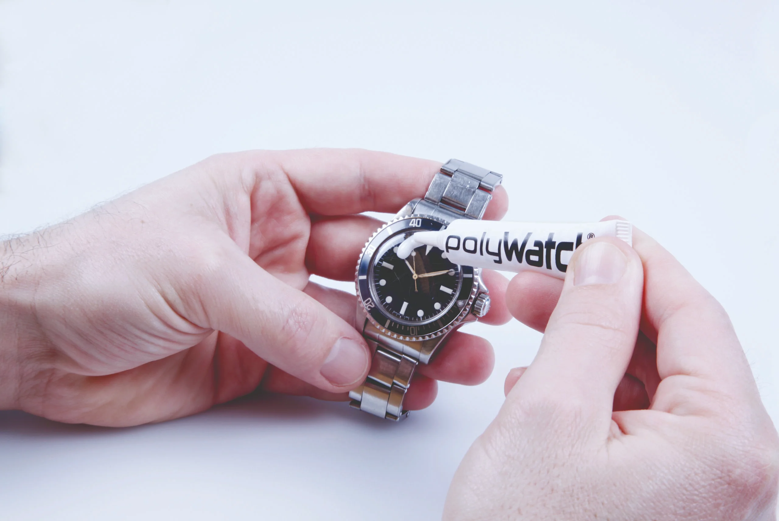

Polywatch is your friend, that said cluttered and grimey work benches has no place in a professional setting. Let them buy you the polywatch, you are going to need it with that soft plastic crystal.
