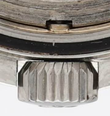

Good morning!
Another important thing - if you will send the watch to Omega, please ask them (in writing) to not change the crown!!
The one you have is the correct one (A1, 24 tooth),

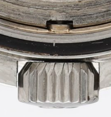

Good morning!
and they might want to replace yours to a service crown..

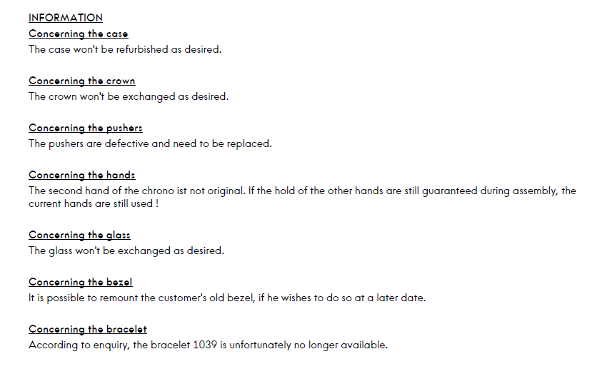

Thanks for the input hansaboy, I just now read your other thread about the various crowns and it was very informative!
I am inclined to let Omega go through with the service as they have been really good in their communications around the watch (a whole different story than what many others have had experience with it seems).

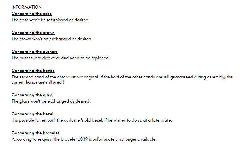

Thought I'd share the initial response from Omega Switzerland.
* After this I have got confirmation that they will leave the bezel untouched as well, as they suggested to change the bezel and ship me the original one back with the watch.
* The chrono second hand is unoriginal and they are going to replace this. And they are also trying to keep the others intact.
* Pushers will be replaced, anything I need to worry about regarding new parts here? Does service parts look the same as the original ones for 145.012?

Don’t think omega would accept this as I believe one of the requirements is to get the watch waterproof again. And this is up to OP if desired or not. However, it is important to make sure to get the crown back after service.
edit: just saw the response from Omega, my bad. Nice that they are now listening more to the owner.

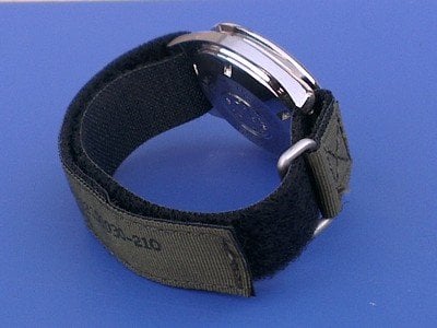

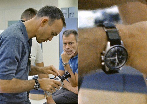

Does anyone know whether the omega velcro which michael collins is seen wearing here is available at all? Was it sold commercially?

See the thread above, Omega factory has actually confirmed they will not touch the crown

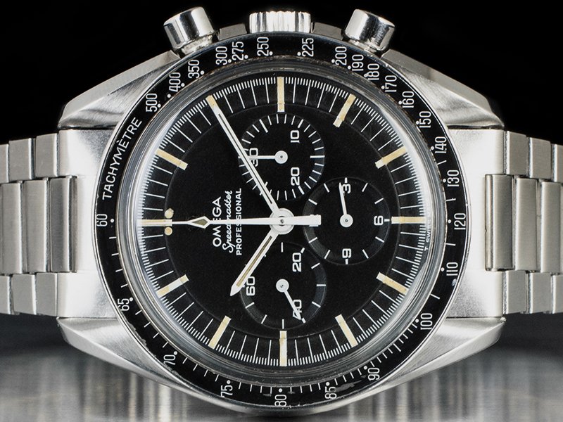

I have seen a couple of Omega serviced Speedmasters and they have ended up with white lume. Is this what you desire for the watch?
No.. Do you have any references/images? Are you talking about all the markings on the dial or only on hands?
