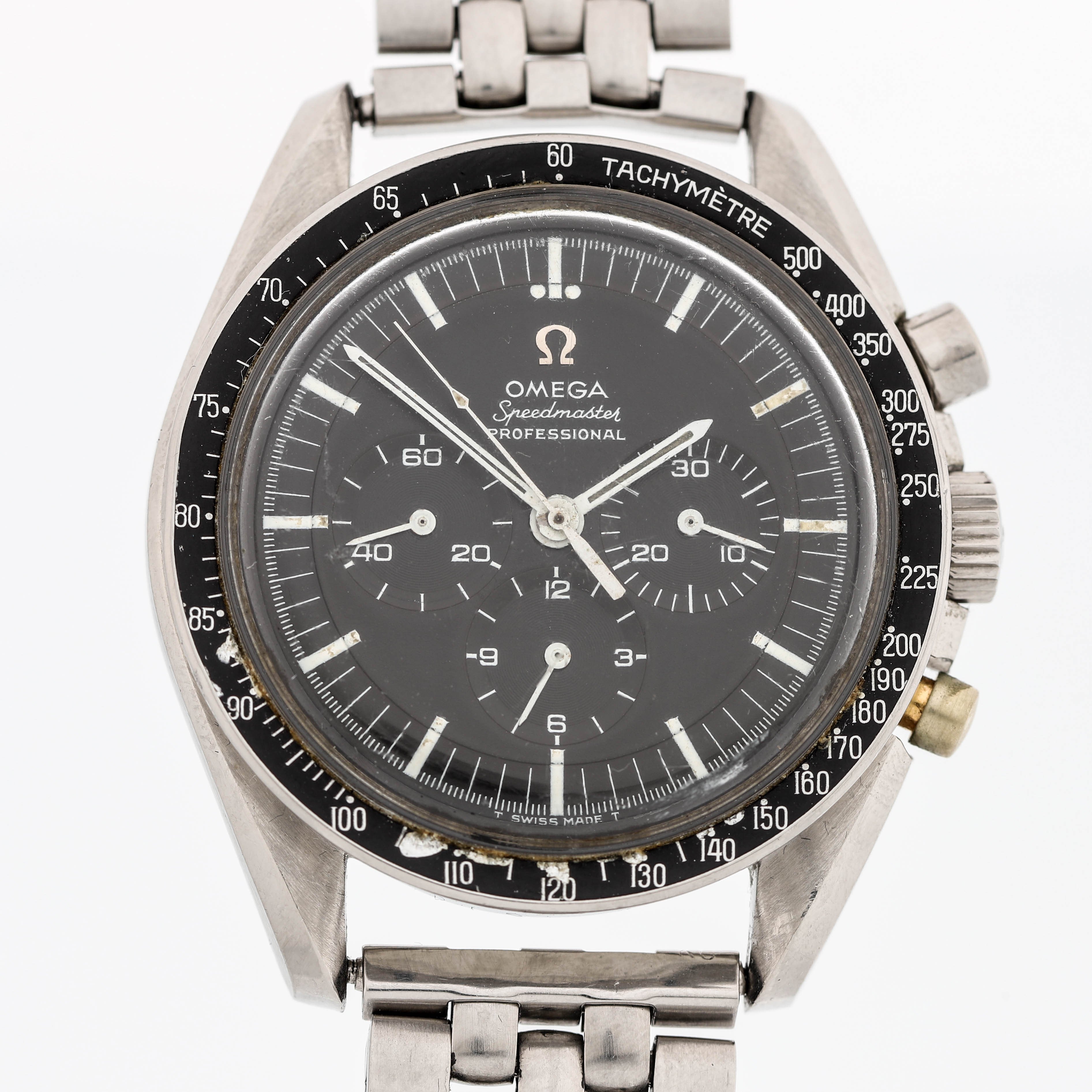

A few months ago I got hold of a 145.012 (-68), a bit worn, but still I had been looking for this for a while now so I took the chance on it. It is currently with Omega factory for sevicing and they have suggested some replacements.
I am looking for advice and opinions on the replacements suggested by Omega;
1. They want to replace the bezel, and I have confirmation that they will ship the old one as well if they do. I have also asked if they can keep the original on and ship a new one to me to have a spare. What would you do?
2. I have asked to not polish glass and case (they accepted this).
3. Pusher is being replaced (one if obviously an unoriginal part as can be seen from picture).
4. The bracelet I got with the watch is an unoriginal one and I asked Omega for the 1039 bracelet which they said they don´t have. But they offered me the 1171/633, which I think is the most correct one to have even if I would want an original one from -68. Any thoughts?
Any input or thoughts would be greatly appreciated, I don´t want to end up paying Omega 2000+€ and regret it later.
Thank you!
13,553
23,497
1. Do not replace the bezel. Yours is original but not in fine condition so it’s perfect for wearing. Zero benefit of replacing the bezel or buying a service ‘spare’.
2. Agree, do not polish the case. I would definitely polish the bezel.
3. Pusher needs to be replaced. If doing one, I’d do two.
4. I wouldn’t get a service 1171/633. I’d use a strap for now and either source an original 1039, or a new Forstner/US flat link. If you like the 1171 I’d get a vintage one

Try to find correct Chrono hand too!... Omega can do that I suppose.
Well spotted, forgot to mention it. Omega are switching out the seconds hand of chrono as well.

The 1067 and 1035 aren’t correct for a 145012. They are very similar but they’re for 18-19mm lugs. Yours is 20mm and needs 1039 or 1116 to be period correct.

Although technically not one of the "period correct" bracelets for this reference, you could also consider an Omega 1175 flat link bracelet with 640 end links. This is a very nice solidly constructed bracelet and they generally sell for a third to half of what you will pay for a 1039/516 and, in my opinion, they are of better quality. Here's mine on my 1969 Speedmaster Straight Writing.
