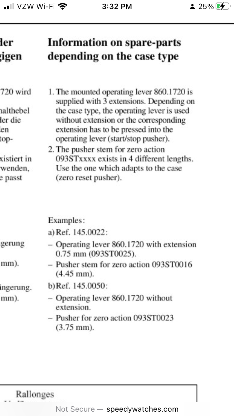

Does anyone know the size or part number of the pusher stem for a Speedmaster 145.0022 service case with an 861 movement?
Thank you for any help you can provide.

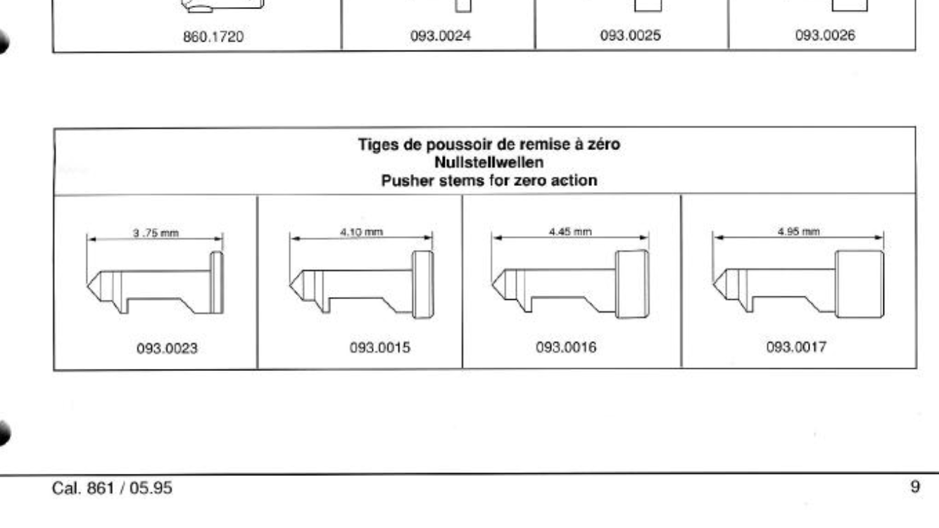

I have added the only info I have below. I think it might be 093.0015 but not sure.

He is referring to something similar to what's on page 10 of this: https://www.watchdoctor.biz/wp-content/uploads/2018/04/1861.pdf
OP - Based on the example on page 10, wouldn't it be 093ST0016 that you need for 145.0022? Please note that I'm just basing this off of my understanding of the technical document.

Thanks for the help. Another sign the -16 is the correct size is that size is 2-3 times pricier, on the open market, than the other sizes…
