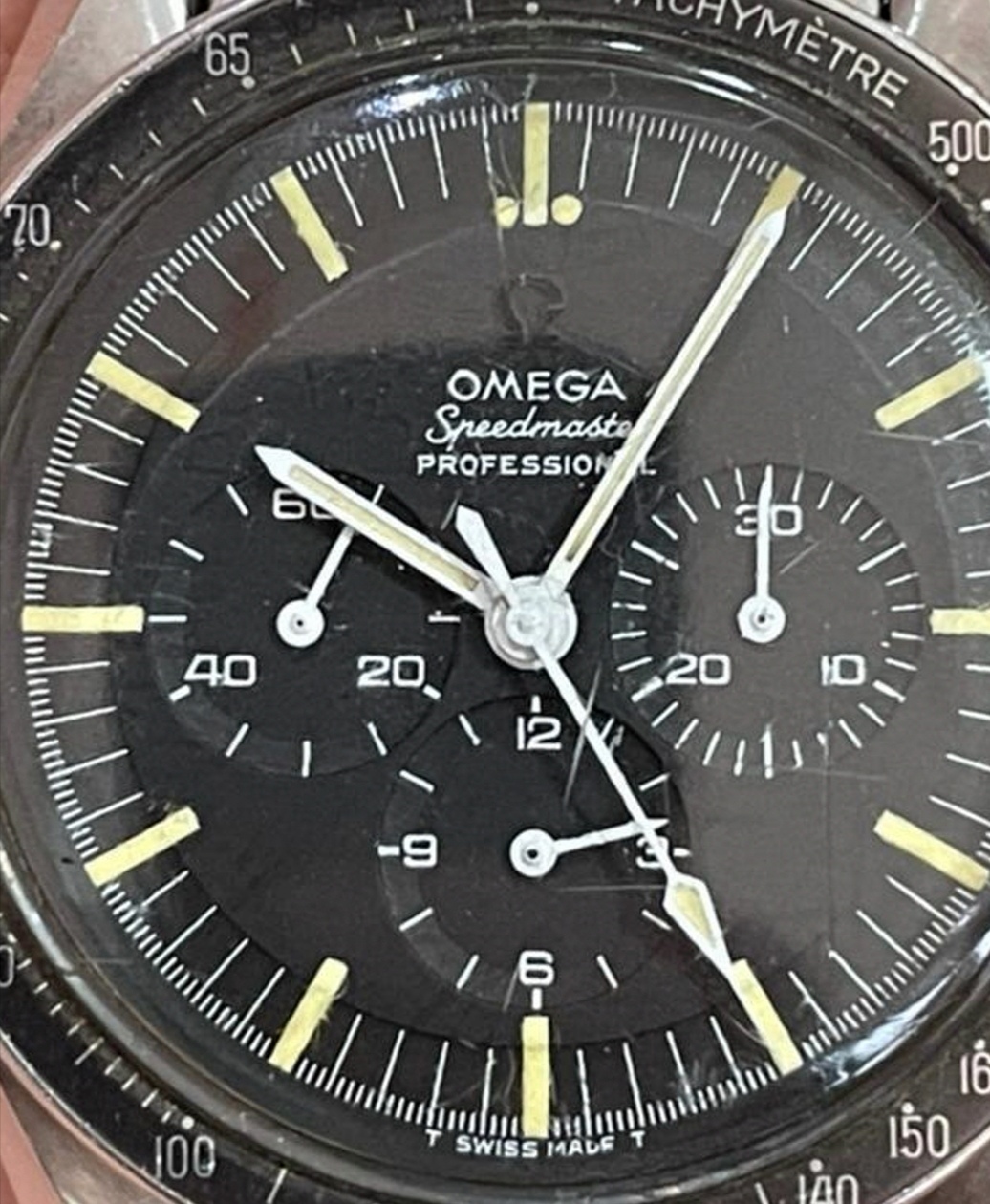

Hello guys,
I was offered a nice Speedy 105.012-66 with 2400xxxx serial.
Could that be possible or isn't it a bit low for a -66?
I guess there's also no way to find out with an EoA?
Maybe someone can help me
Thank you!
S.

More likely a 105.012-65 movement number.

According to the Speedmaster 101 description, the 105.012-66 serial starts with 2453 xxxx.
https://speedmaster101.com/105-012/

MoonWatchOnly says the same thing: -66 start at 24.013xxxx...

Well, it's a -66 caseback
I've seen the Speedmaster101 serial table, but the watch I've been offered doesn't seem altered.
I don't think of a changed caseback too.
Found one thread where another 2400xxxx watch with 66 caseback is mentioned.

@Patrik83 I will post a pic...
Don't think the caseback has been changed.

Ilovemyspeedmaster dates it at June 66
This is the watch
As a ref 105.012-65 I assume.
24,836
55,255
Pity! Looks nice but doesn't seem legit
