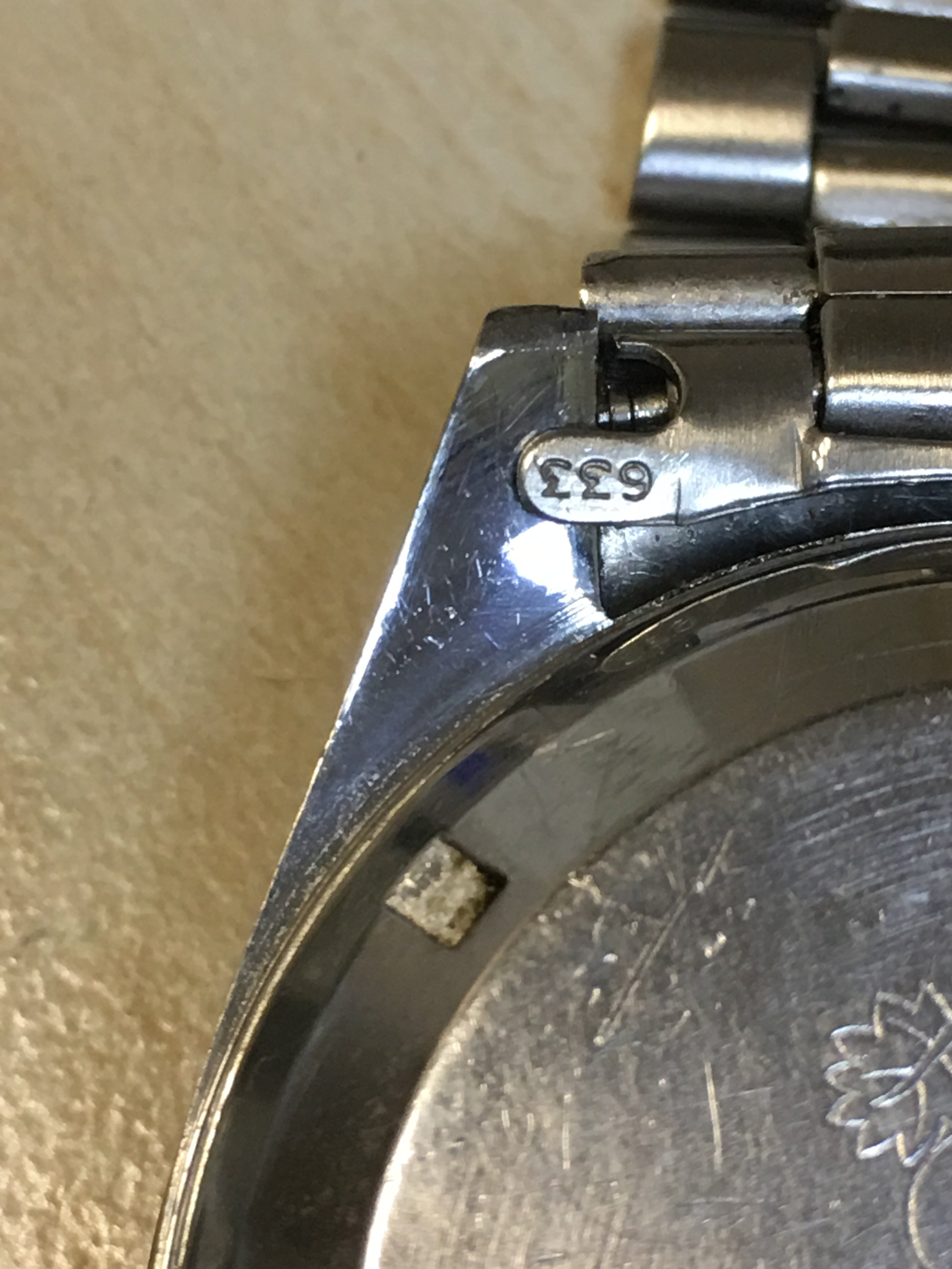

Michael e may of course have a point. M'bob also. However, I was told my resent purchase had problems due to the fact my case surround was probably from a '64 with no facets and indeed may be madly 'filed'?. The movement is a 24m number and most likely a 65?

Yes, withdrawn?, my case surround and 63 case back. What's going on? Are bothe of our speediest Frankenstein or was there a bunch of random parts at the factory at the time?. Why would so many people make Frankenstein using seamingly scarcer case backs?.

Just to recap, I'm seeing many examples out there with '63 case backs, described as '63 watches with serial movements of '64 and on. Most, I am told probably couldn't be '63's as they shouldn't have 'T's unless asymmetrical (ie. added by singer) to the dial. As with mine.

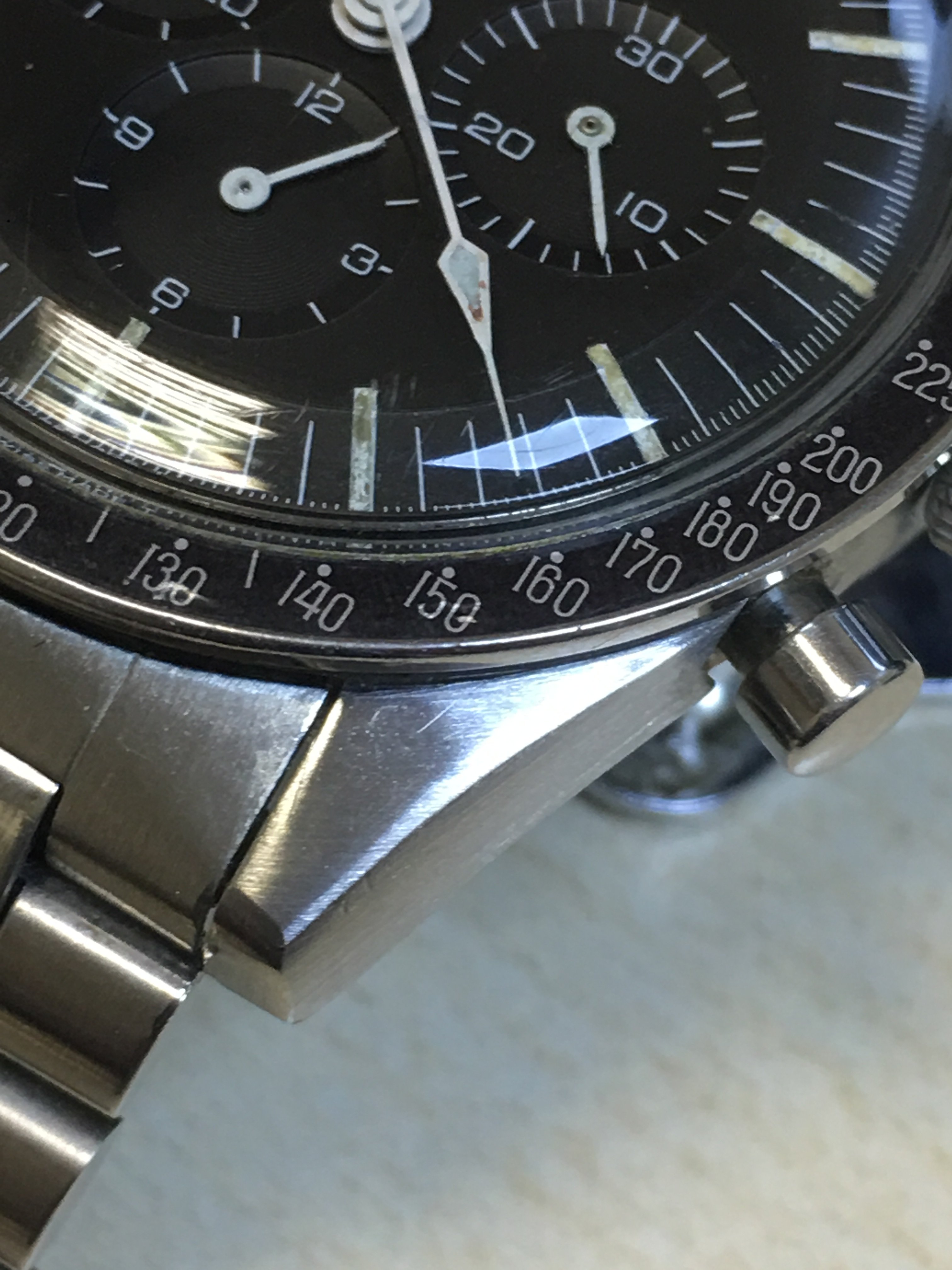

My recent piece seems now to be more in line with a '64 (case surround) as described in this 'thread', not a badly filed down example. The lustre on the rear of the lugs doesn't looked touched although someone has overdone the 'lug tips'.
Is there a possibility that the factory used up leftover components sometime after '65, making some of these strange 'frankens' somewhat more legitimate?. example. '63 case back, now known '64 case surround and a movement (24m) straight out of stock.
It just seems uncanny that the 'franken' builders out there all seem to have spare '63 case backs instead of (up until now) using a know doubt more common 103.003-65 case back to make a 'correct' watch?.
Just a thought!
