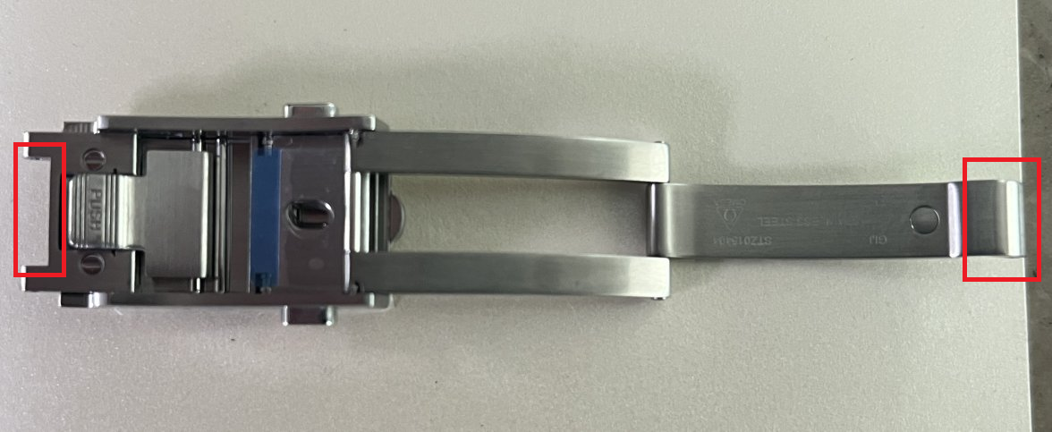

Just a question to any 321 owners here. I dont personally own the 321 Ed White but have a FOIS on the OEM 321 Ed White bracelet.
The newer Speedmaster 57 models seem to have an upgraded quick adjustable clasp on their flat link bracelet.
Wondering if anyone knows if this clasp will fit on the 321 Ed White bracelet or not.
omega-speedmaster-57-7-jpg.17835681
omega-speedmaster-57-6-jpg.17835682

The 57 bracelet is 20mm, but i cant find any information about how much it tapers down to the clasp.
I found a for sale post selling the 57 clasp which has some detailed photos:
https://omegaforums.net/threads/ome...et-clasp-with-pushbutton-117stz015504.174987/
I guess what we need to know is if the width of the brushed center link on the 57 bracelet is the same as the 321 Ed White, which is 15mm. And also the width of the part on the opposite side:
