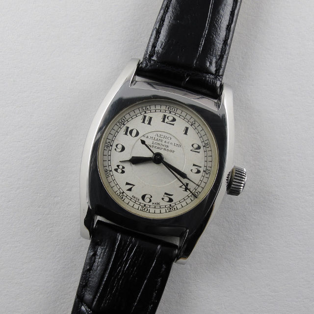

Ref the Double Dials, here is another Helvetia advert from 1939 with them referred to as Double Dials (Double-cadran) though they are not actually pictured. Note also by then the waterproof watch on the right of the ad has evolved , from the one pictured in the 1934 catalogue, into the later version of the case as per the right hand watch in my photo of the different cases together above.

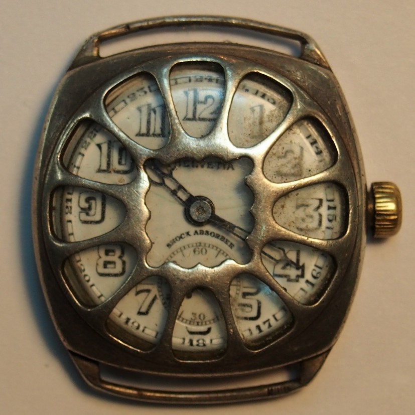

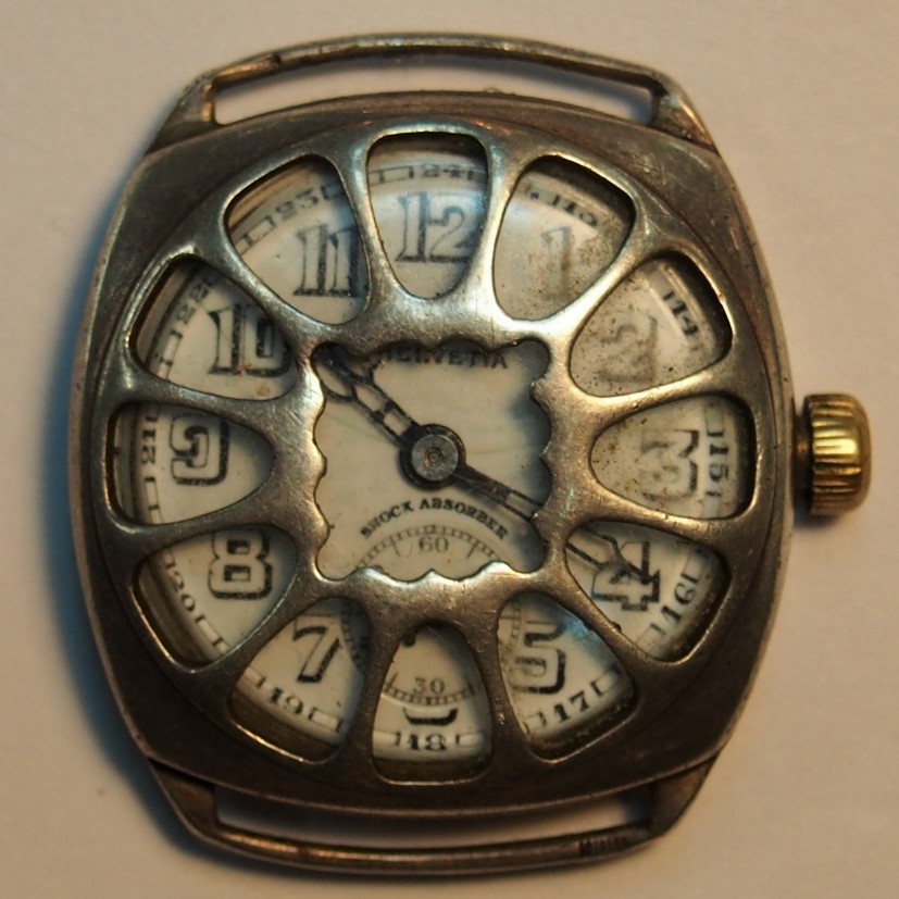

For interest I've found a couple of watches of the type shown as a 'Protected watch'.
First is branded 'The Fenchurch Lever' this seems to be an Australian brand but the watch is made by Helvetia as shown by the movement, serial number etc. Date is 1927/28. Have a look here for details about these watches: https://omegaforums.net/threads/depollier-fhf-and-helvetia-was-movement-id-help.91999/
The other couple are earlier trench watches using the same guard but earlier Helvetia movements and trench watch style cases.
Notice how the one in the catalogue has the middle removed, the edges of the hole follow the design in the ones with intact centres..
Thanks. Carl.

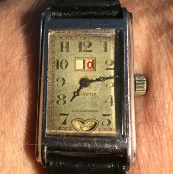

@Bill Sohne @CVivash - I am intrigued by the Helvetia calendar watch with a date window, circa 1934, in a tank model no less!
I always thought the date-window calendar (with internal date disks) didn't develop until the 1950s. I can't even think of any tanks that had date windows (not counting jump-hour models). Any insight into the movement on this watch?
Hello. Yes, this is the Helvetia 75A rectangular movement adapted with date disks.
Solvil/Ditis, Mimo/Girard Perregaux and of course Helvetia produced 'Big Date' watches using this movement in the 1930s.
Here is my page about them: https://www.helvetiahistory.co.uk/helvetia-large-date-watches

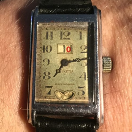

I have just found out today that the Angora Watch Co also used the Helvetia 75A in a 'large date' watch. And I've found a pic of the date disks.
If you look you will see the seconds counter is the same odd style as the helvetia watch.
I've been looking for a picture of the dial side of this movement for a while.
Thanks. Carl.

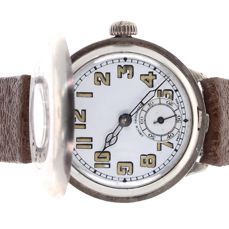

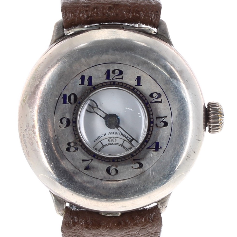

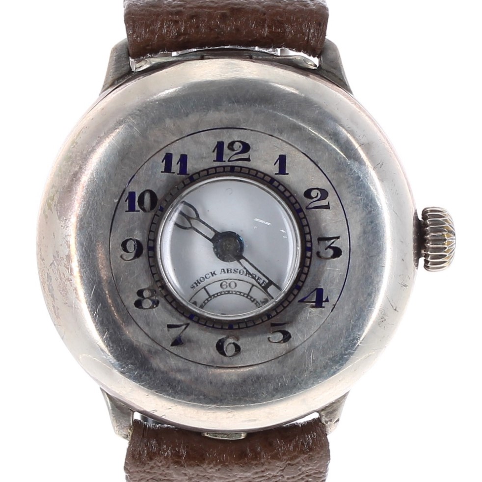

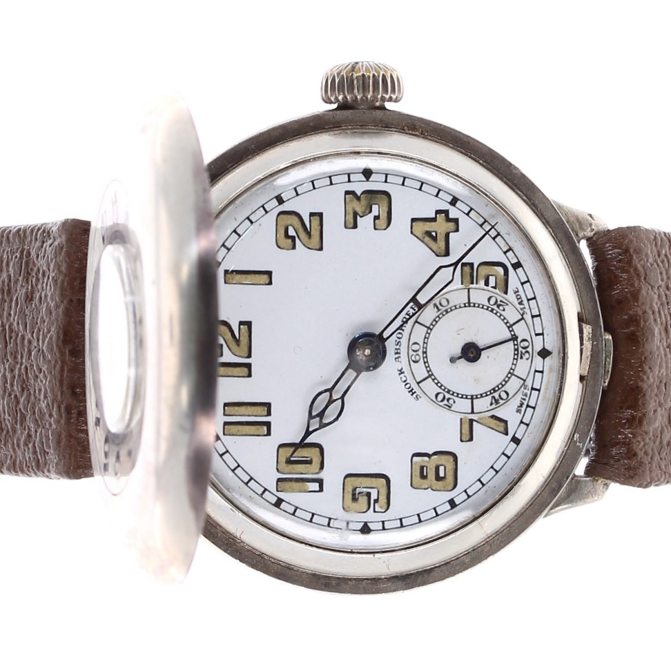

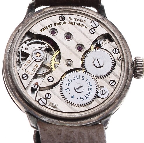

While I am here I'll update with another couple of actual examples of watches from the catalogue I've found recently.
First a nice example of the demi-hunter. Exactly the same case this time and fitted with a Helvetia movement of the type they used in their trench watches.
And also the first example of the exact same large date watch as in the catalogue that I have seen. The others I've seen have a different sub seconds dial, not the jump hour type like here.

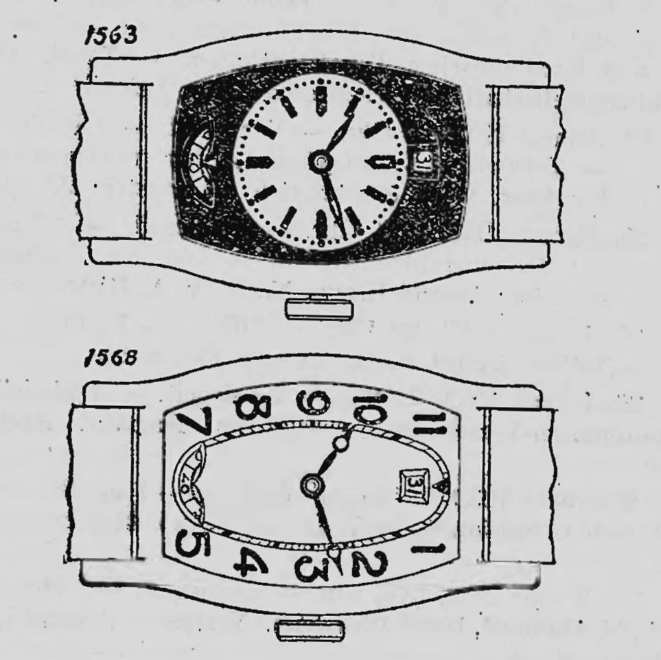

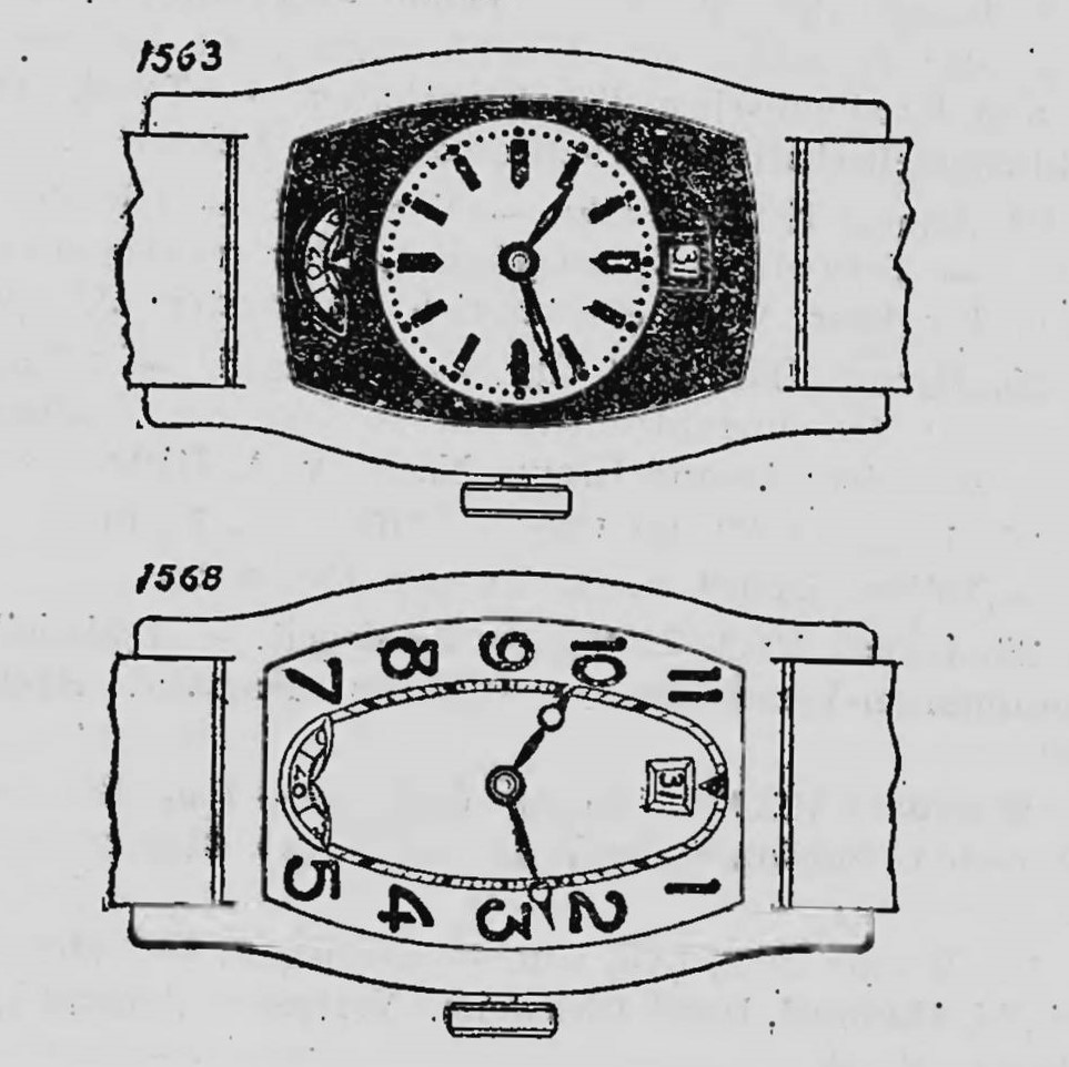

And for those interested in the technical aspects here is an entry in the Swiss design register from 1932 where they registered the design of a date watch with a window as 12 and jumping style seconds at 6 though this is a smaller date display than the two disk large date they eventually went with.
Thanks. Carl.

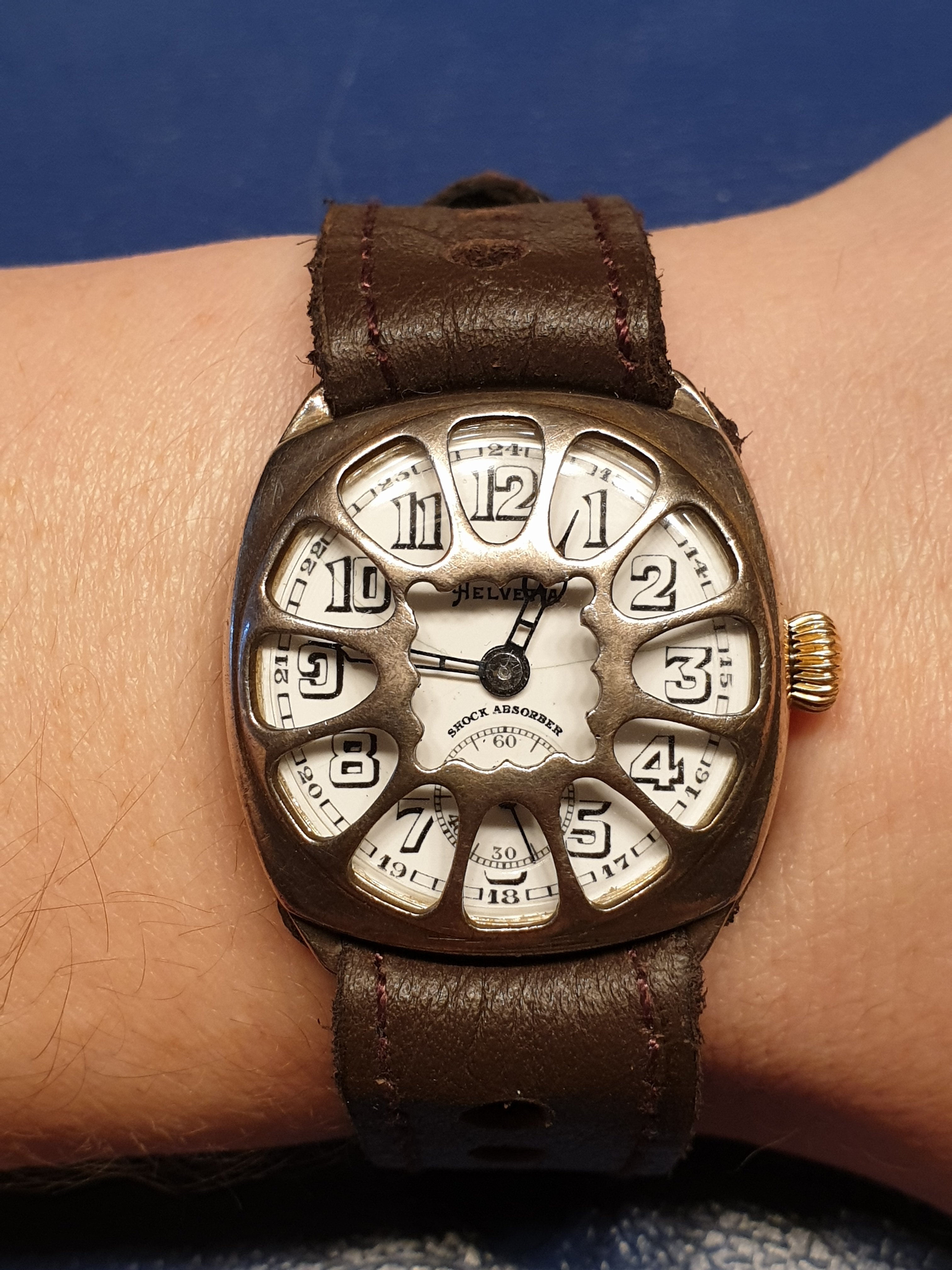

4
9

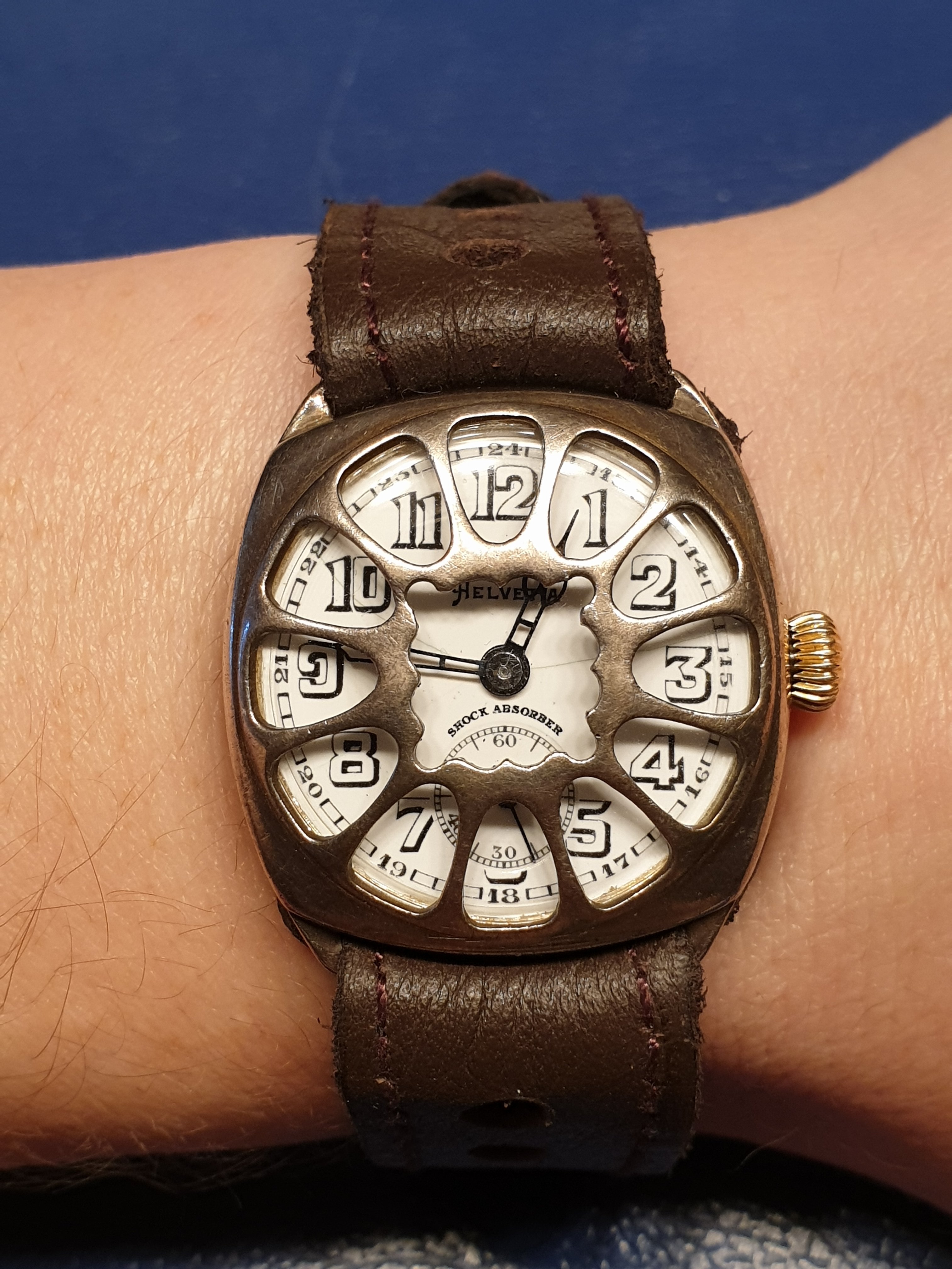

Hello @vkostr
Really good to see your watch again. Nice to see the Helvetia on the dial as these early Helvetia shock protected watches aren't usually marked.
Have you seen my page?: https://www.helvetiahistory.co.uk/1930s-sports-watches
I would be interested in some better pictures for my site if possible?
Many thanks.
Carl
Hi Carl,
well, I can do some additional pictures of my watch if it is what you need. Please tell me what exact pictures do you need?
Regards,
Vasily

Hi Carl,
Regards,
Vasily
Thanks Vasily. Actually just to use your picture in this thread wold be good as it is better than the one I currently have and the movement and inner case back pictures I have aren't too bad.
I think I found the current ones from the sale listing, can I ask where you got the watch from?
Thanks. Carl.
4
9
Thanks. Carl.
Sure, feel free to use my picture at your site. But take into account that winding head was changed because previous one (not sure if it was original) was very hard to use. I bought mine on Feb 2017 from used watches merchant guy, rather cheap but it required some investments as glass rim was absent and movement was pretty dirty.
Regards,
Vasily
