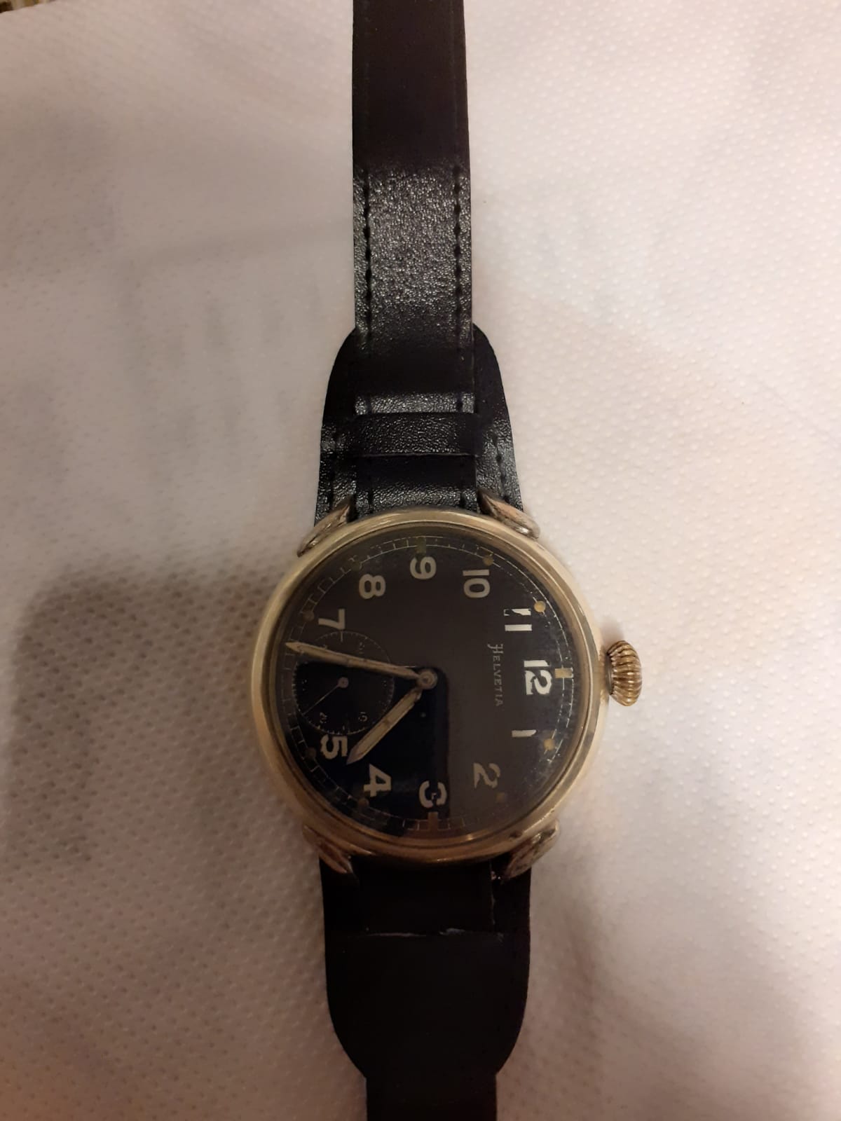

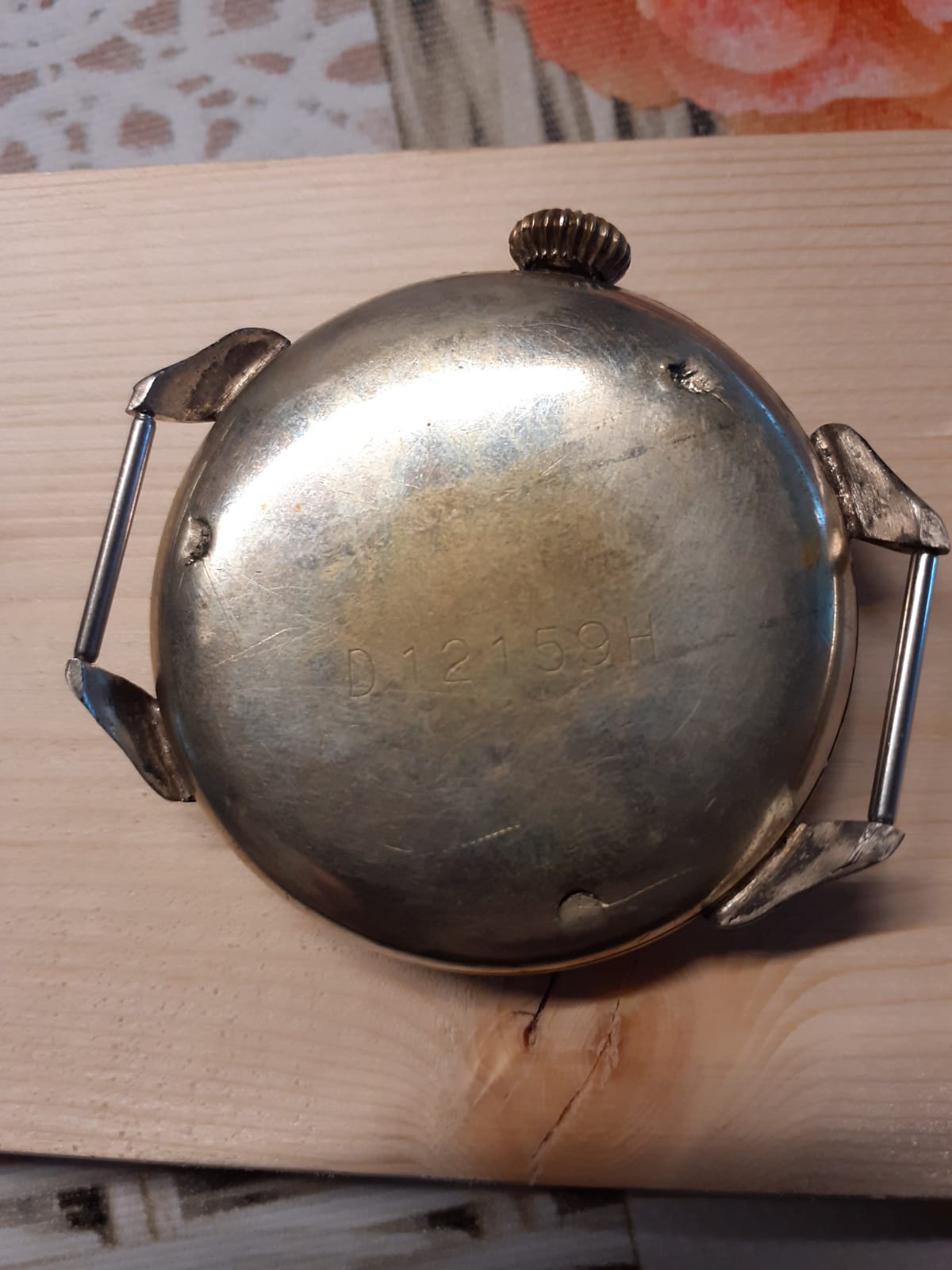

Hi to all.
I ask for your help in cataloging (and possibly giving an evaluation) this Helvetia found by a friend. Unfortunately I only own these photos. He informed me that the diameter is 42mm.
Thanks a lot to those who want to help me.

Hello, Max. The bund strap (surely not the original?) and the onion-shaped crown make me think this was a flieger watch of the 1930s/40s. It is also has the crown at 12 o'clock. Taking my information from the superb https://www.helvetiahistory.co.uk/movements, that would fit with this being a cal 51. Fortunately for you and all of us, the author of @Helvetia History is a member of this forum, and will be able to guide you.
4
9

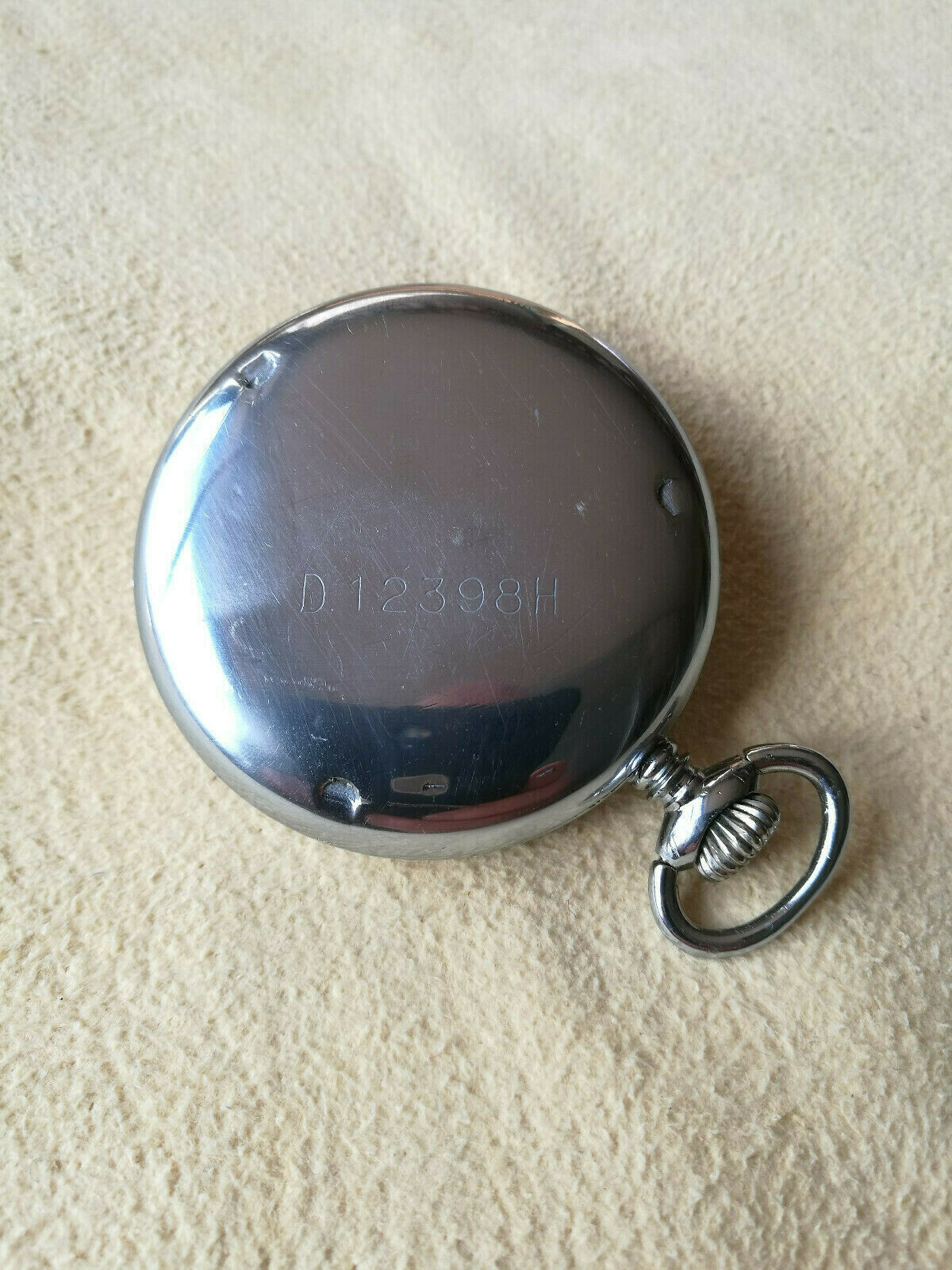

It is definitely not flieger watch - DH=Dienstuhr Heer - Military land-forces.
It is probably converted pocket watch - lugs look like added later and size is too big for wristwatch of the time.

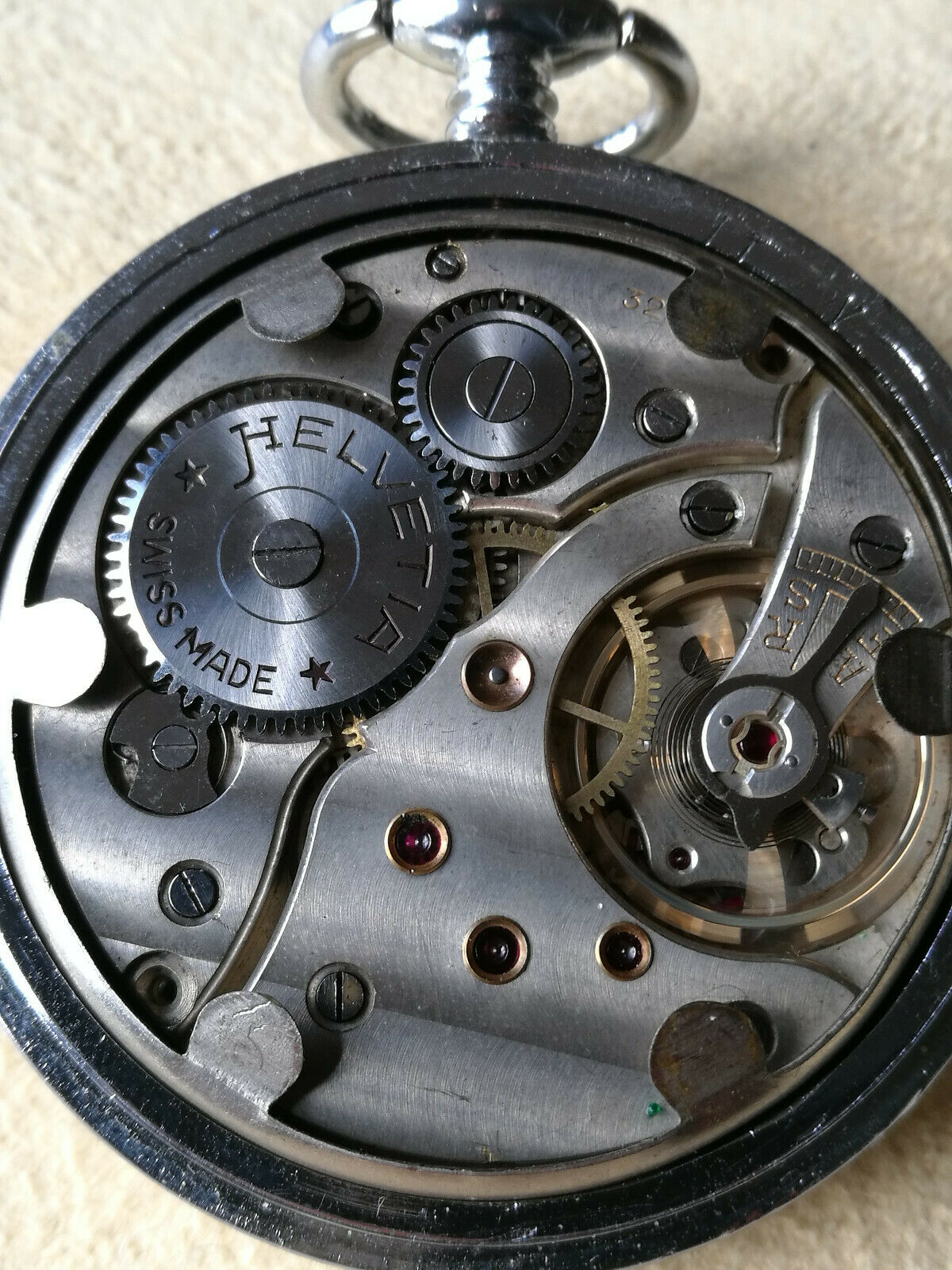

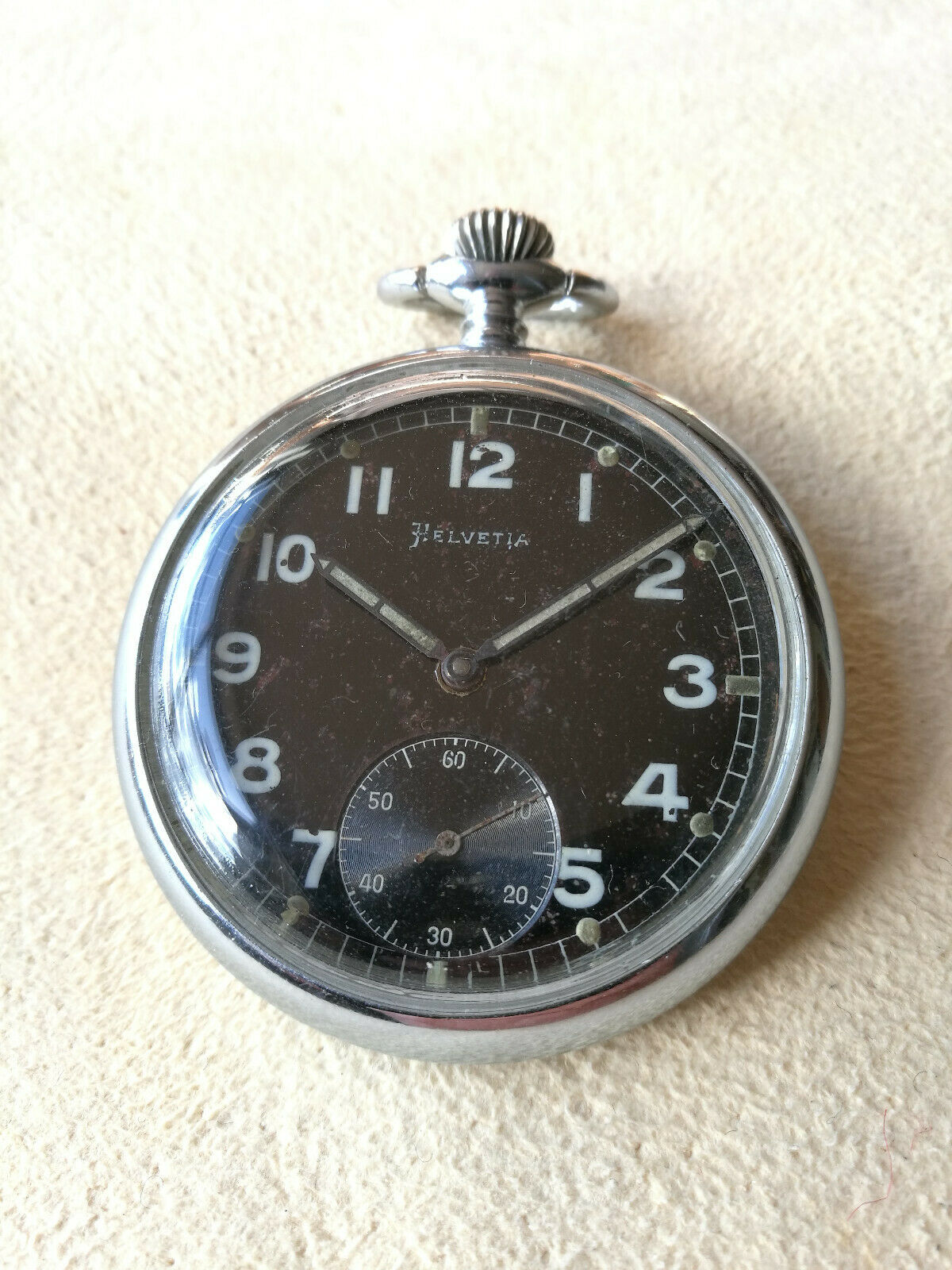

Hi to all.
Max

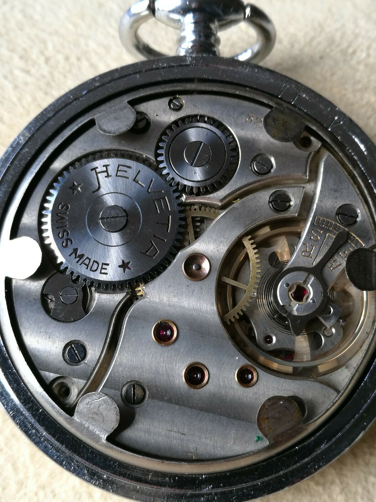

Hello Max.
This watch is a Helvetia German Military DH pocket watch that has been converted, recently by the look of it, into a wrist watch by soldering lugs to the sides of the case and shortening the stem.
Unfortunately as a collectors item this ruins the originality. It is a genuine wartime watch however but this is not the way it left the Helvetia factory in about 1943.
The calibre is the 32A and this movement was also used in the GS/TP pocket watches supplied by Helvetia to the British armed forces during the war.
Below are some pictures of how it originally would have looked.
Thanks. Carl.

3
Many thanks to everyone and especially to Helvetia for the valuable information.
I had guessed it was a pocket watch but I wasn't sure.
So the modification is not vintage but recent, right?
What could be an honest assessment for this watch? I wouldn't mind buying it but I think the demand is excessive.

Hi,
I think it was done recently.
A pocket watch like this would be worth about £200 or so depending on the condition but you will have to decide if the conversion makes it worth more or less than this. For me I wouldn't spend more than £40 but I wouldn't wear a watch like that so would be buying it for parts and to try to 'save' it.
Thanks.
Carl

thank you very much Helvetia. I think I'll leave it where it is. The price is much higher ...

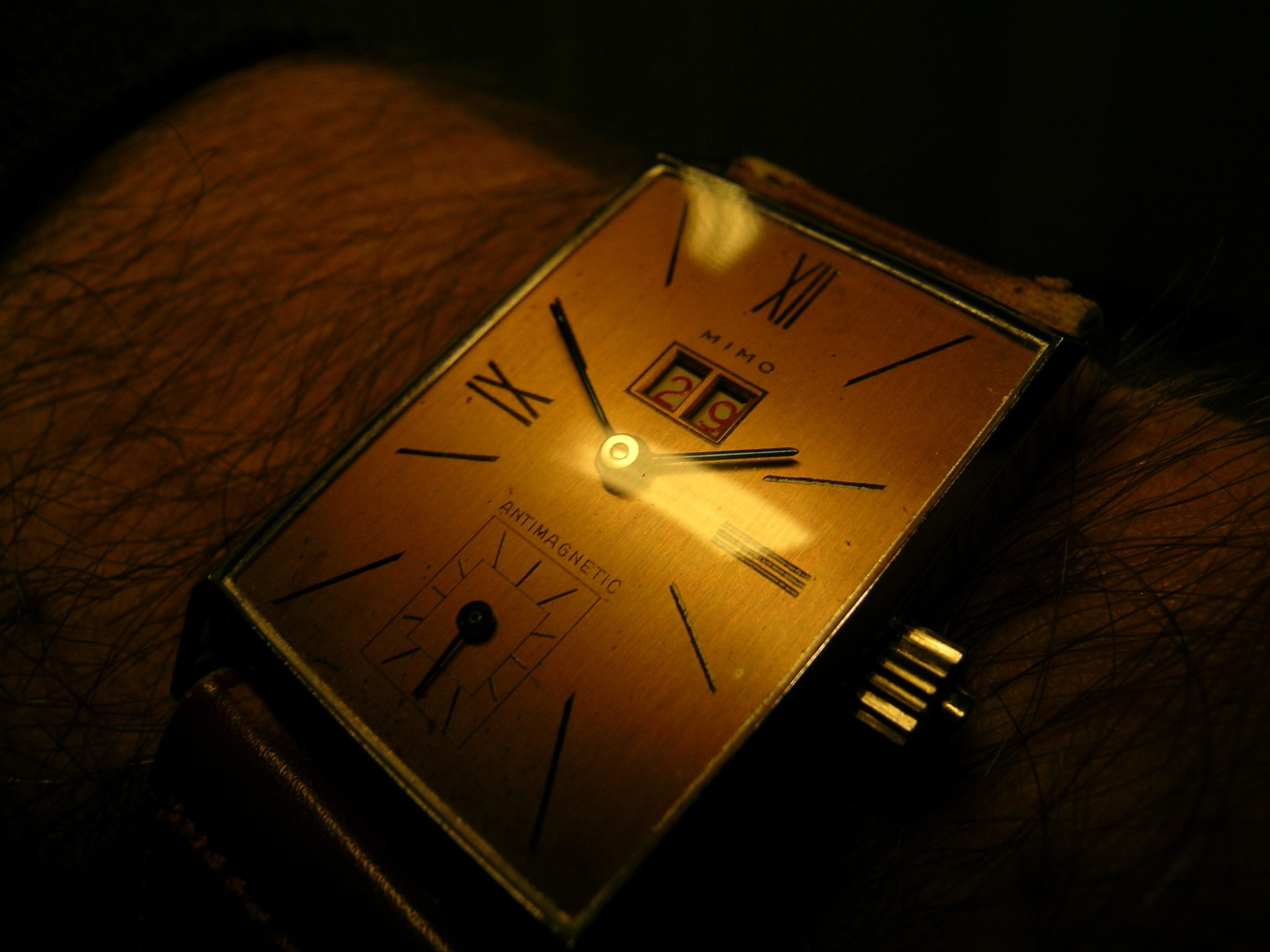

I have one almost NOS made by MIMO (Girard Perregaux).
Best rgds
Peter

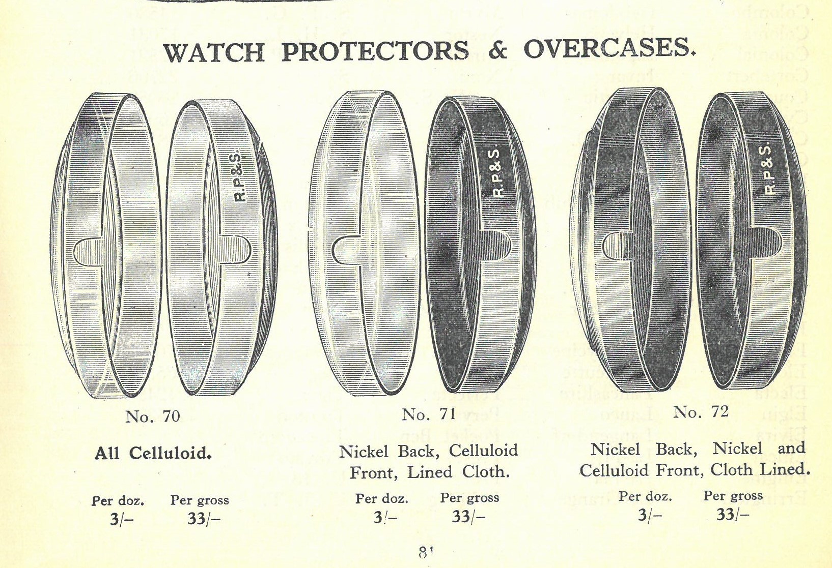

Hello all,
I've just acquired a watchmaker's and Jewellers catalogue from the same company, Robert Pringle and Sons, as the one above. This one from about 1924. Though it is mostly tools, lathes, files etc. there are a couple of interesting pages with straps and other bits and pieces so I thought I'd add them here.
Thanks. Carl.

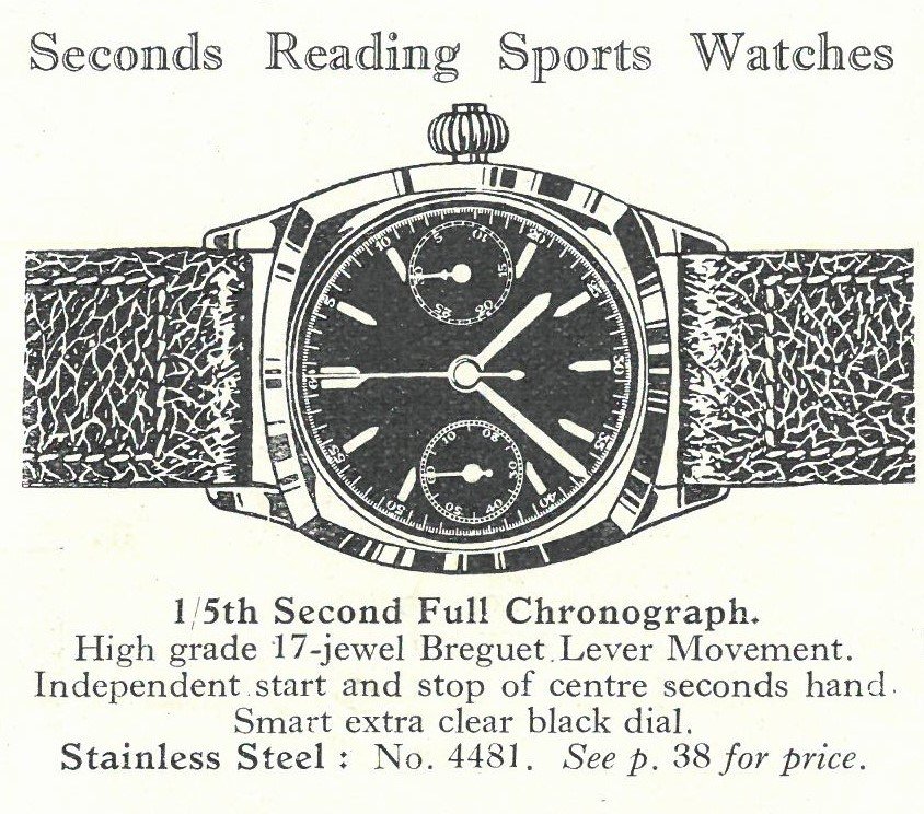

Hello all,
Another watch I acquired this month is illustrated in the 1931 edition of the Wilderness Catalogue. It is an interesting swing ring cased shock protected cushion case watch with a 1928 hallmark that matches the date of the Helvetia serial number.
I have been on the look out for one of these for a while since I saw the illustration below from the catalogue.

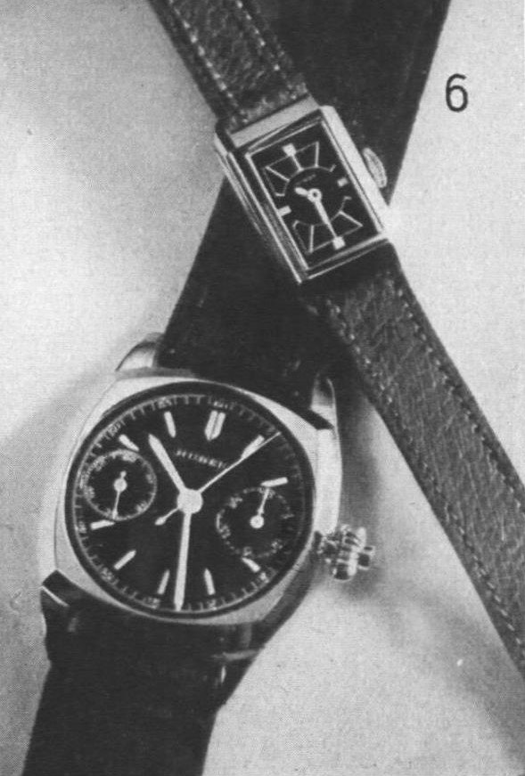

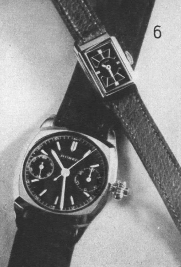

Hi all.
Time for another update to this thread!
I found the 1933 Huber advert below with some nice watches, including one of the cushion cased chronometers everyone was asking about at the beginning of the thread.
A lot of the watches in this ad may be by Helvetia as Huber were a reseller for a lot of Helvetias at this time.

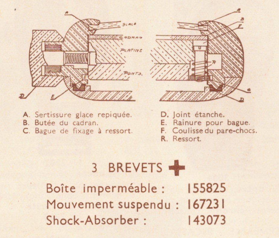

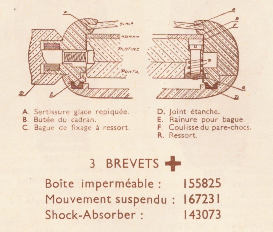

First here is a diagram showing all the water and shock proof qualities of the watches with the relevant patents:
Then this part where the ad mentions that the case back must be fitted by a watchmaker to make sure that the leather washer is fitted properly. This the first time I've seen it confirmed that the original washers were leather.
