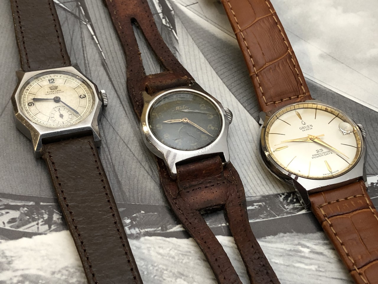

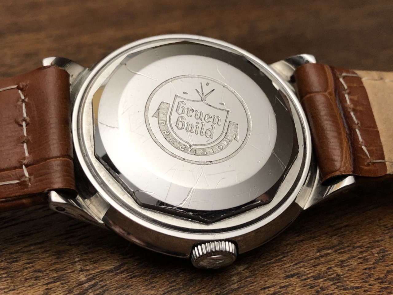

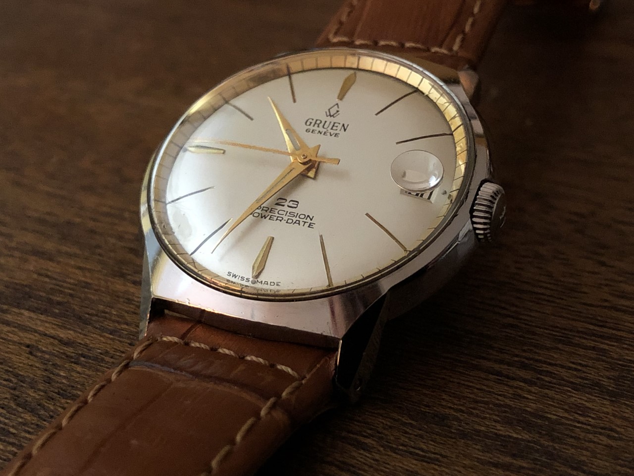

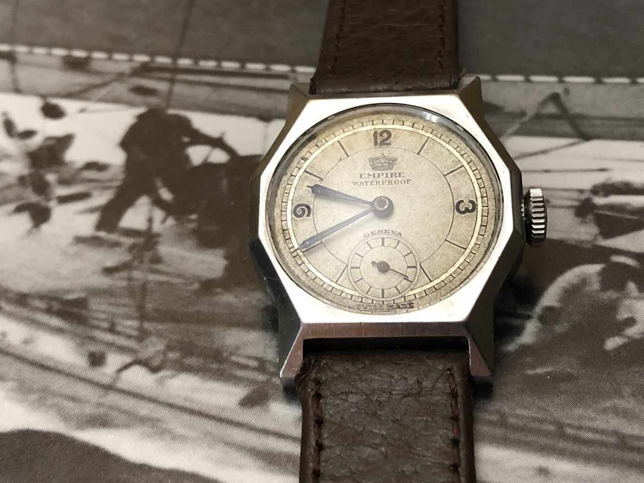

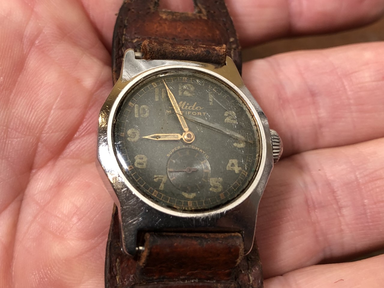

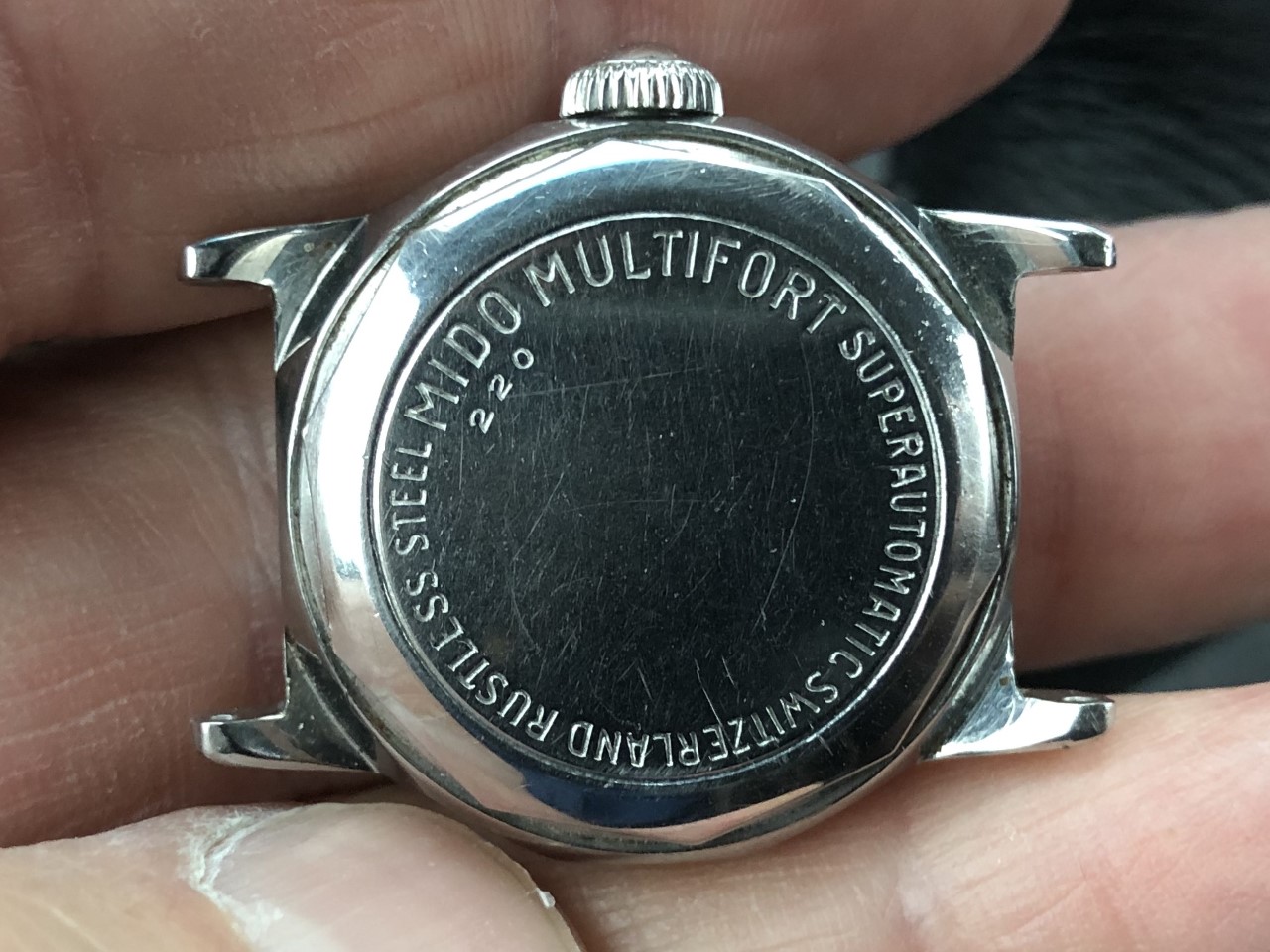

@CVivash you must have been reading my mind....I planned to start a thread on Taubert "waterproof" cases this morning. In the mid-1920s, Taubert et Fils purchased Borgel, an early pioneer in waterproof cases. In the early 1930s, Taubert introduced an octagonal stainless steel "waterproof" case having a decagonal screw down back and a specially treated cork winding stem seal. These cases were used by watch manufacturers like IWC, Longines, Vacheron & Constantin, and others. This design evolved over the years and was used by watch manufacturers such as Mido and Gruen through at least the early 1960s. Attached are photos of three of my watches showing the evolution of the Taubert "waterproof" case: an Empire from circa 1934; a Mido Multifort circa 1941; and, a Gruen 23 Precision Power-Date circa 1961.

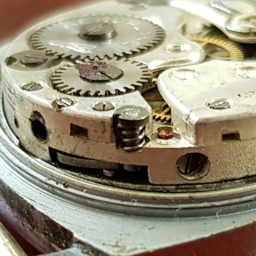

For those of you interested this is a picture of the spring mounting for the movement as illustrated at the top of the first page above.

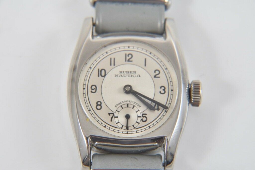

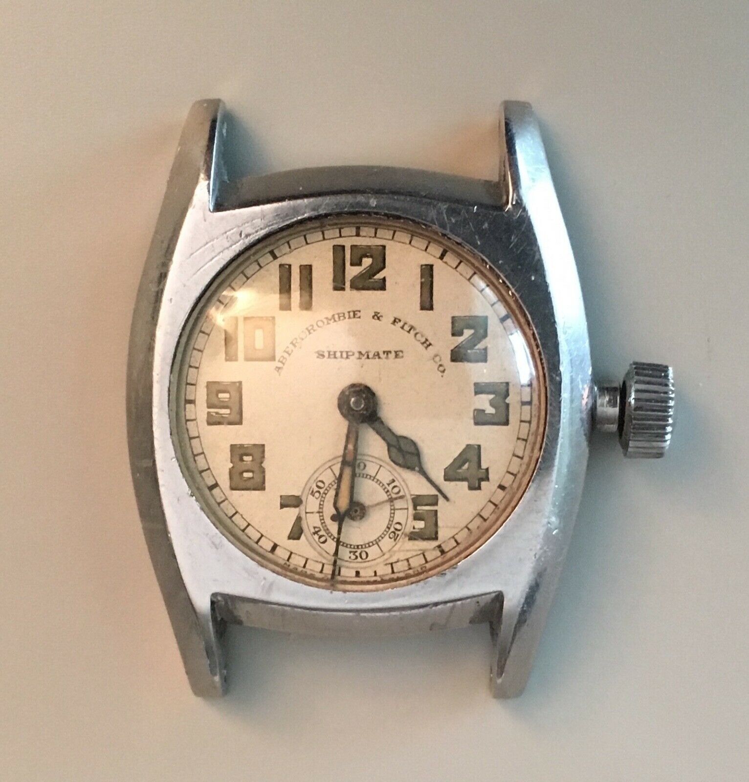

You think that is good have a look at these adverts from G & M Lane. These watches are the waterproof unbreakable watches at the top of the page but rebranded from Helvetia to Aero or Aeroplane. G & M Lane had a whole range of these adverts.
They were also rebranded and used by Huber in Germany as Nautica and by Abercrombie and Fitch as their Shipmate

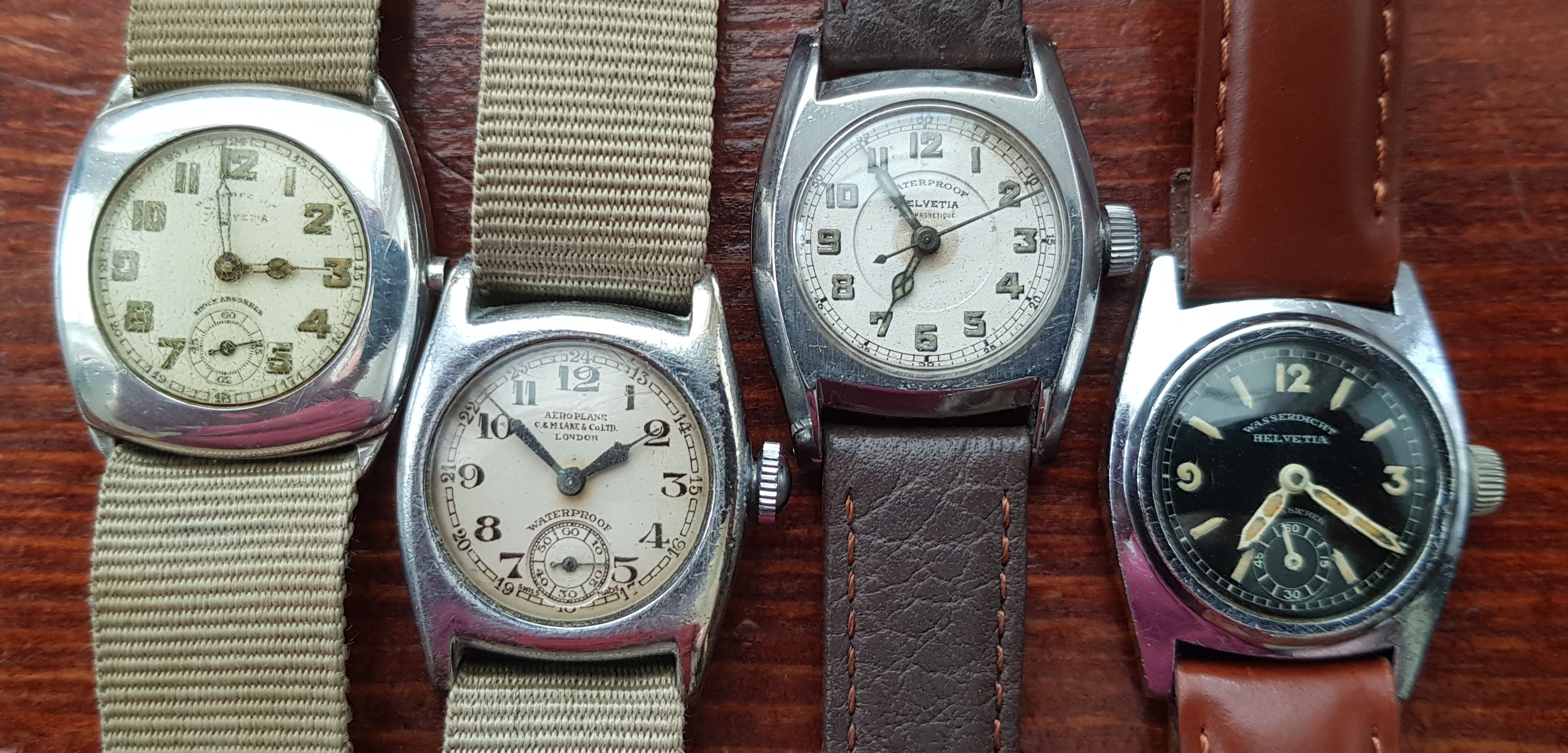

Nice, interesting cases!
Here is a photo with one of each type that I have (a couple I have more than one). Left to right 1929 to 1938 though the final type ran to the early 40s. They all had shock protection and after the first one they had a patent waterproof crystal fitting and the patent spring mounted movement as in the ad from the catalogue. The catalogue version is the third from left but with the type of dial from the right hand one.
More info here, but I need to update with a lot more info I've found since I created the page:
https://www.helvetiahistory.co.uk/1930s-sports-watches
