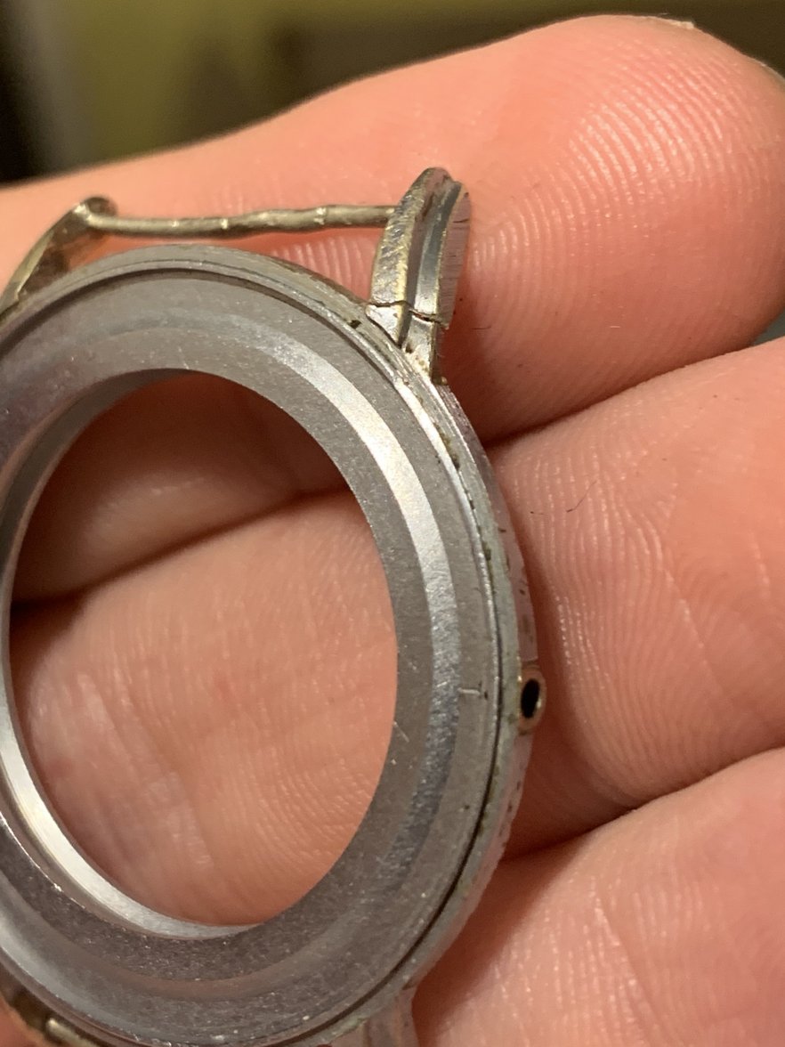

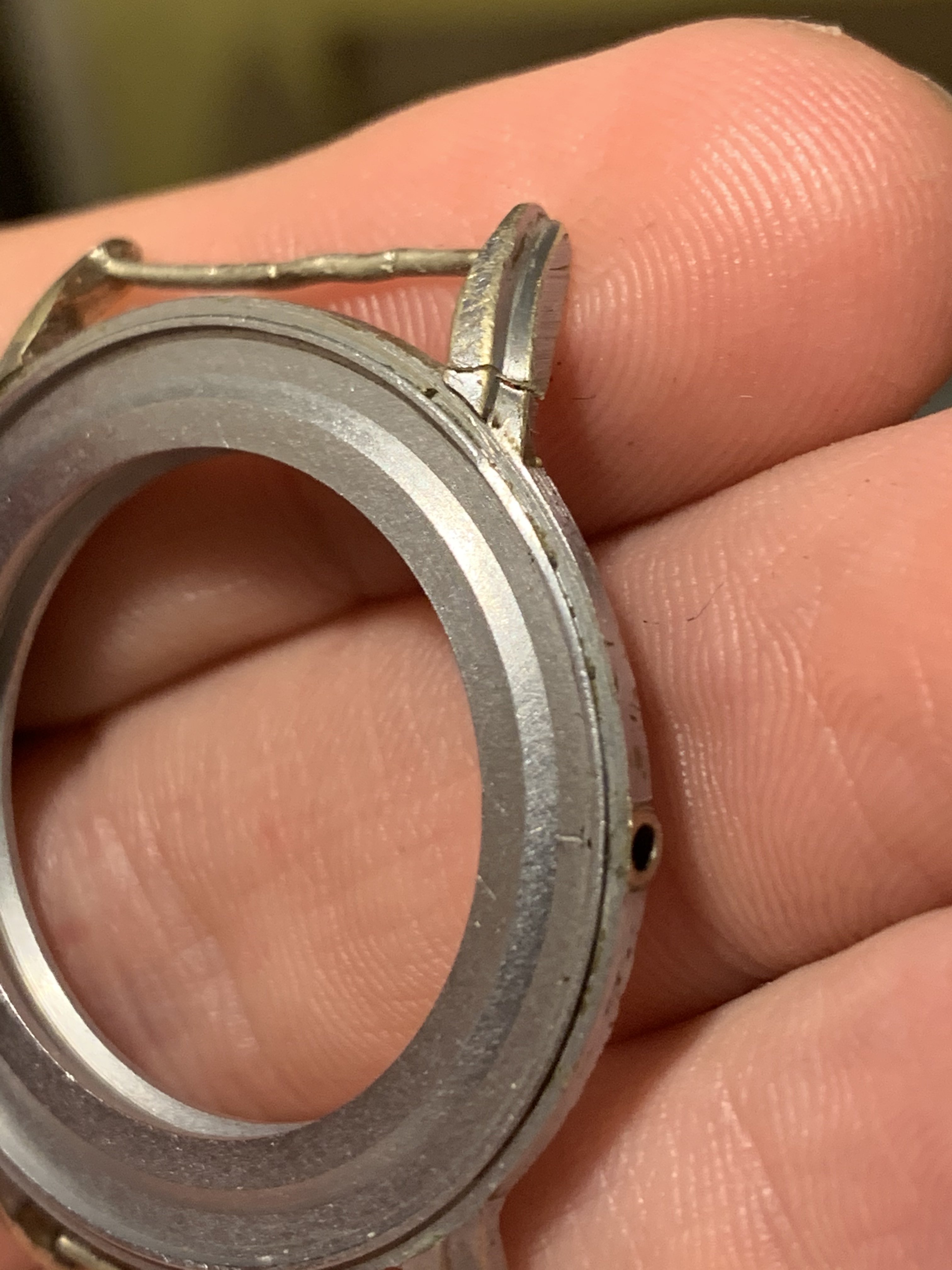

I recently picked up a very cheap Zenith (£80), the lugs were a real mess and after bending them into a useable position, one snapped. It is still attached as it's a fixed lug case from the 1940s. I had figured I'd probably be scraping it, and just keep the dial and movement, but having cleaned up the case and got to this stage, I think it would be better I try to do a repair myself to keep it all original.
I believe the case to be chrome plated, could anyone advise the type of solder I might use for a case of this type?
Fortunately as the fixed bar is holding it in place, I figured a quick solder would fill the 'crack' and do the job.

This is a welding job. If, by solder, you mean lead. That won’t do. I would use silver solder if I was doing the job. If you aren’t able to do this job yourself, it might be tough to find anyone capable of such a job that would work on a chrome plated case. The job is going to show, so you may want to chrome plate it when you’re done. In future, bear in mind that straightening bent lugs on a watch case is best done after annealing the case. Metal hardens when bent, and hardens even more when straightened, often resulting in problems like this. Annealing makes the metal more amenable to straightening bent lugs.

I was also going to suggest silver solder if you're familiar with using it. It has been a while, but I always used either an oxy-acetylene torch with a very fine tip, or even a hot plate.

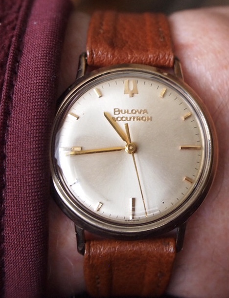

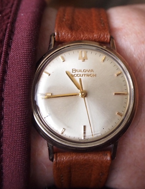

I have uploaded a picture of a model 214 Accutron that came to me in pieces. The case had both lugs on one side, bent, and one lug was cracked, but still attached. The case is a good quality gold filled material, and the plating was in good shape. Obviously, someone before me tried to straighten one bent lug, and quit when the lug cracked. I took the case to a goldsmith friend and asked him to gold solder the cracked lug. He declined, telling me he doesn’t work on gold filled stuff. So I brought it home, got out my acetylene torch, borax, denatured alcohol, charcoal block, and gold solder. Without trying to straighten the cracked lug, I gold soldered it. The process involves carefully heating the whole case ring to the melting temperature of the solder. It soldered beautifully. I cleaned up the case. Now, since the case became annealed in the soldering process, I straightened both the soldered lug, and the other bent one, and neither cracked. You virtually cannot tell the case had been repaired.
Nicely done. 👍
