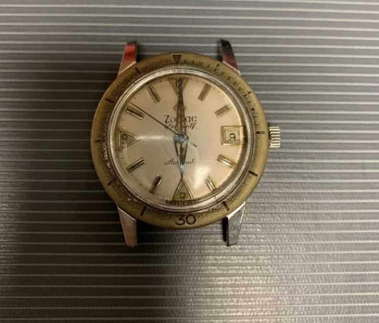

Greetings all,

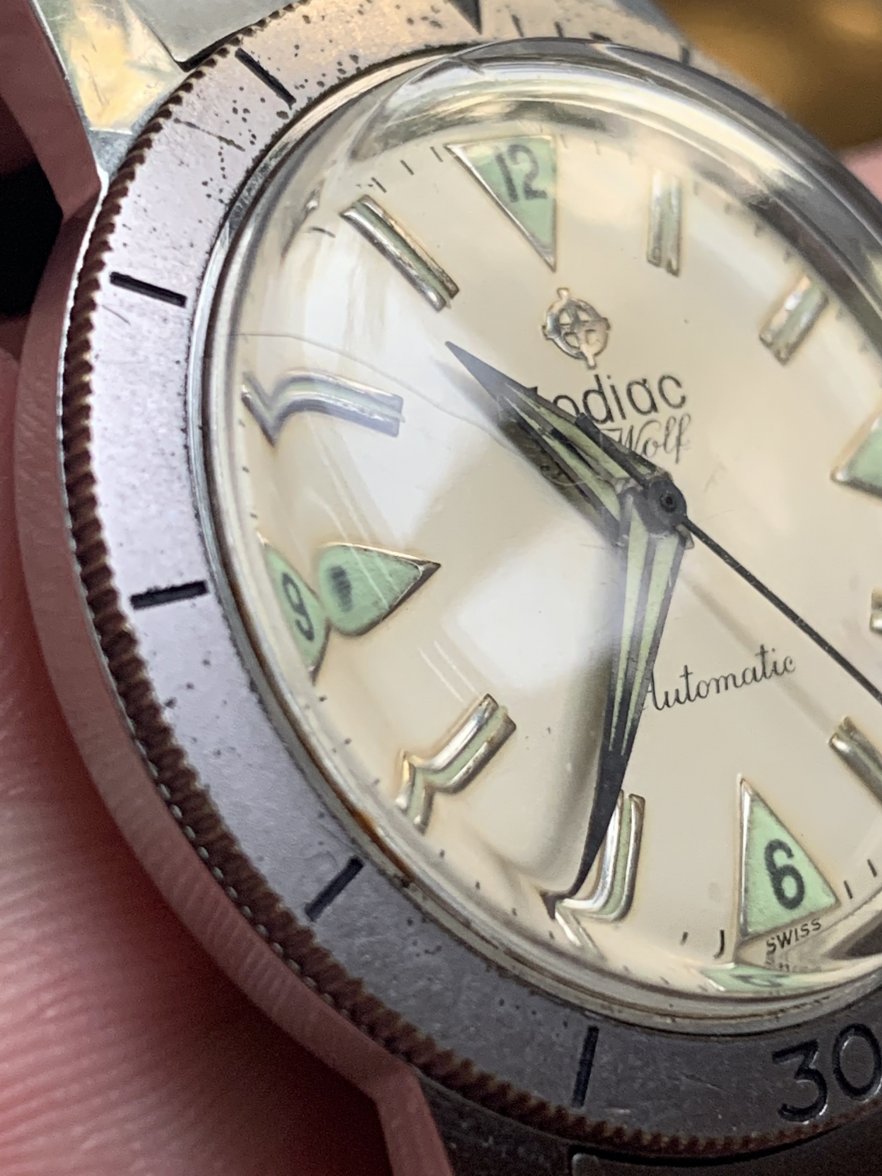

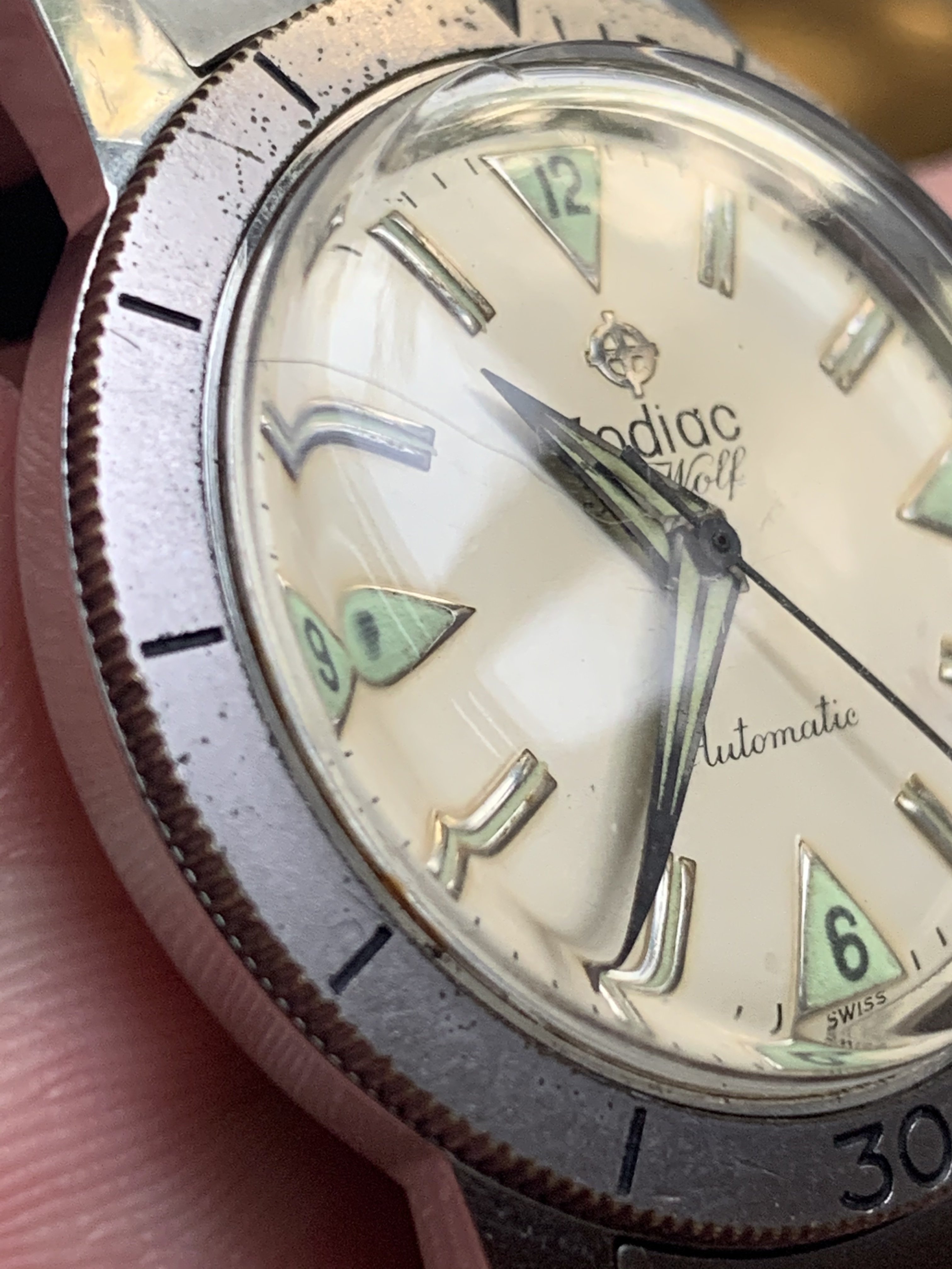

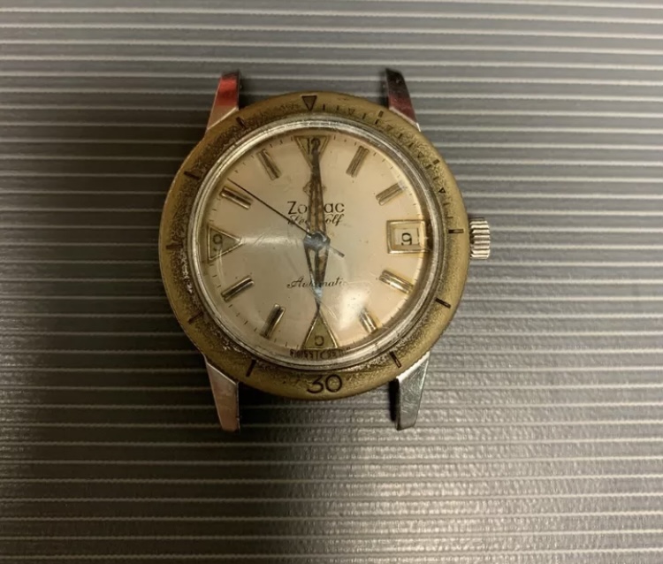

I am wondering if anyone has ceracoated a vintage bezel on which the chrome plating has worn through?
I got a nasty Seawolf as part of a lot buy, and it’s all there and actually running. I have a spare dial, hands can be relumed to match the dial- it’s just the bezel that’s the issue. Physically it’s not in bad shape as it still has deep stamping for the numerals and hash marks- plus the knurling is still fairly deep around the edges- it’s just the top chrome plated surface has worn away.
Replacements are NLA and when a parter comes up with the decent bezel, competition is fierce.
A friend of mine suggest ceracoating as a possibility since it’s done commonly with firearms. It’s incredibly thin so won’t glob up like powder coating.
Curious if anyone has done this.

I thought about that but don’t know who does chrome plating for a single small item like this (not a boxcar of hubcaps). And after plating, how would I achieve the matte texture that it came it?

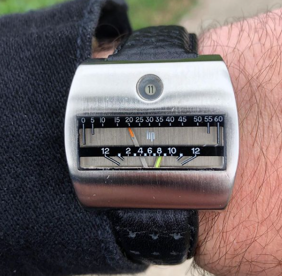

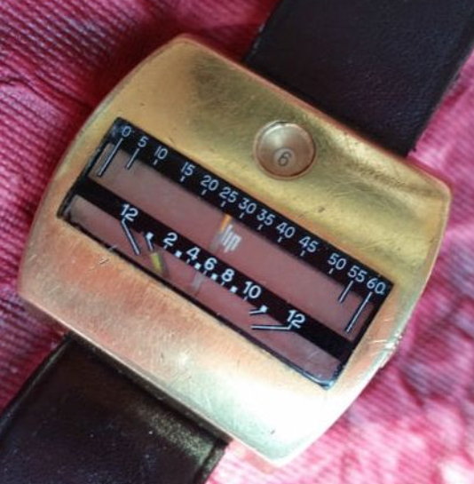

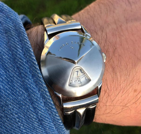

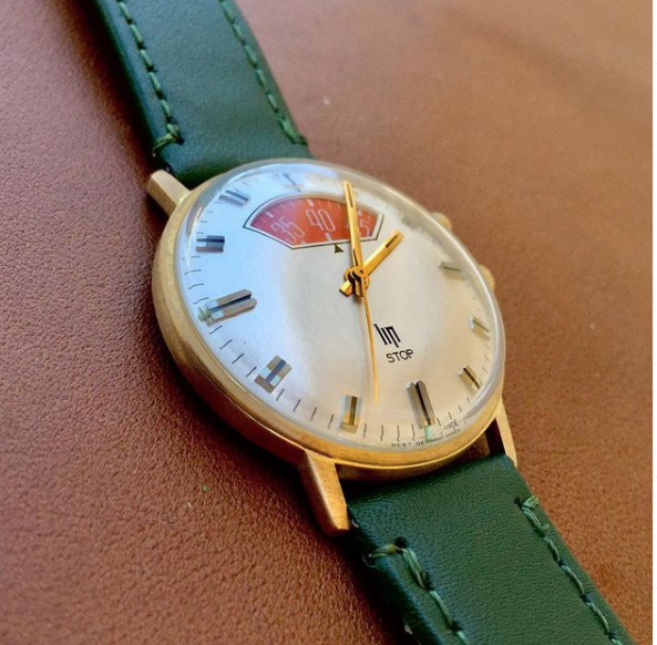

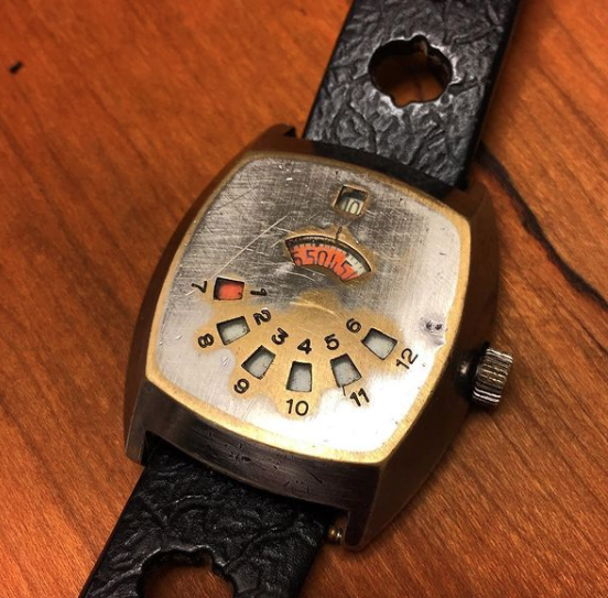

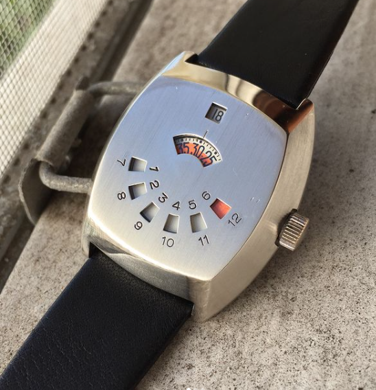

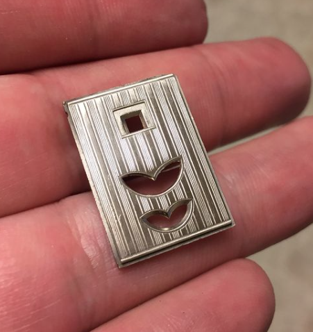

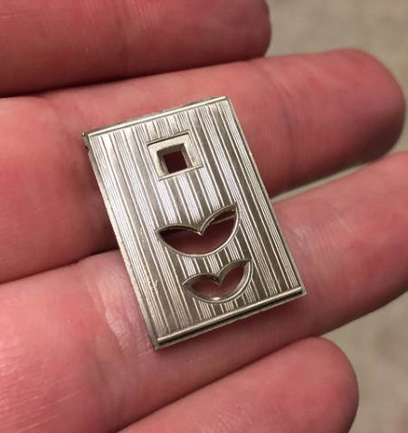

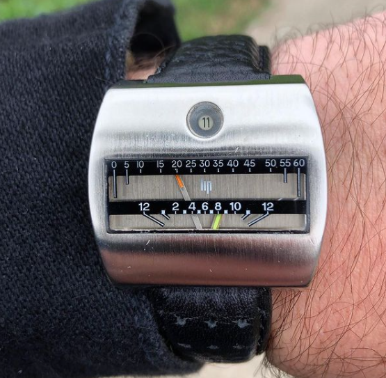

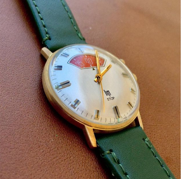

Home nickel plating might be your best option. I do it often for a lot of the poor quality stuff I get. It comes in handy SO often.
The finish quality depends on what the finish is under it. So that slightly matte silver would be very easy. It might not be as durable as hard chrome, but it will last you another decade or more with the less intense wear a lot of these vintage pieces get anymore.
Can also do hands, etc.
Edit - Yes if the is a previous chrome coating on the brass you'd need to remove the rest of it. But luckily for you, that's almost already done.

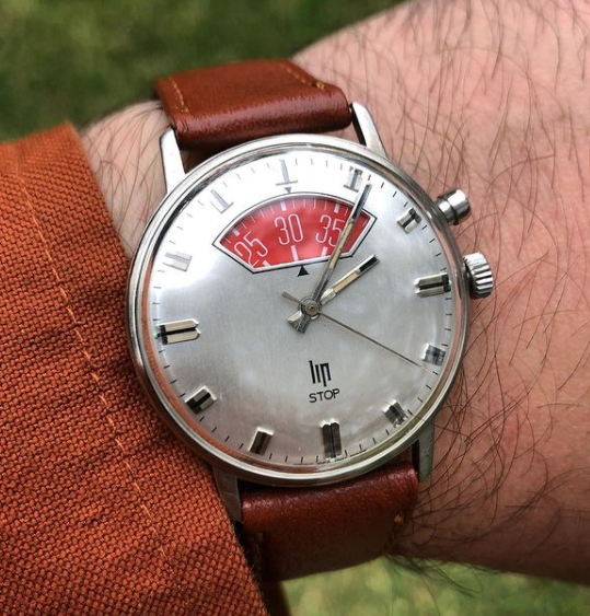

Examples of personal watches I've done:
And this one was gold plated underneath, had some fun with a brushed/polished combo. Shows how the nickel takes the base finish.

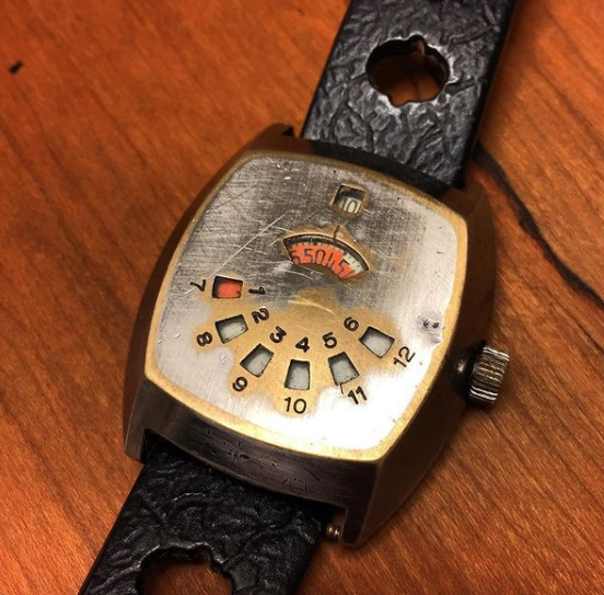

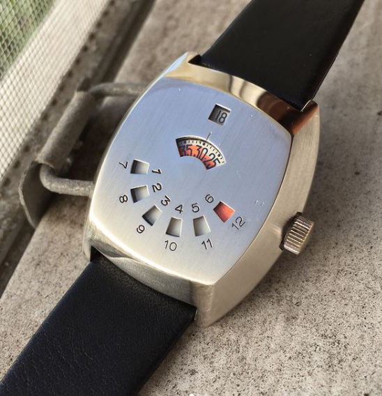

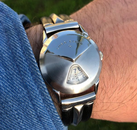

Really good results. I see now how you got the cover of your Helvetia jump hour looking so nice.
