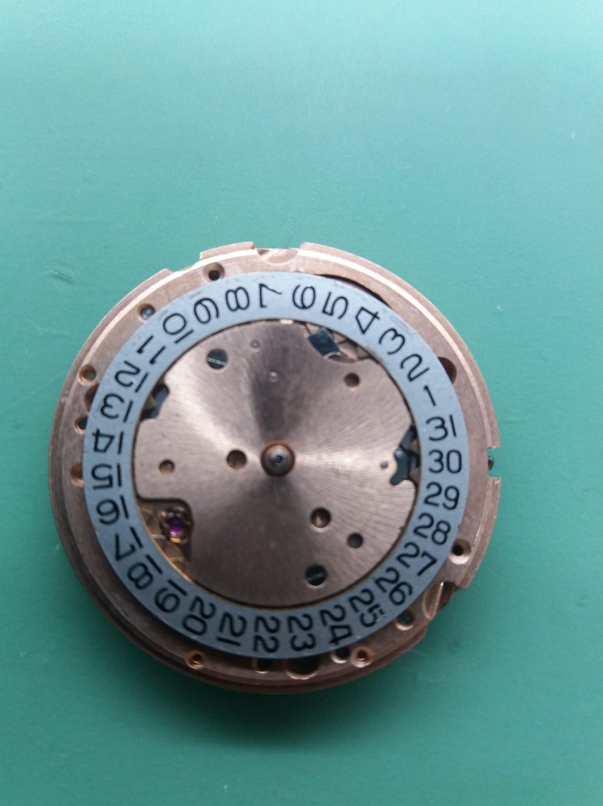

View attachment 893915 View attachment 893916
Hey friends,
I got a cosmic which was service by my watchmaker but he can’t fix the quick set date function.
He told me that he probably needs parts :
560 1500
563 1530
240.1105
613 1109
does anyone have these parts, or has anyone experienced the same problem ?
If you pull the crown now it does not do nothing, and it’s also hard to find the spot to adjust even the time since you can not here any click..

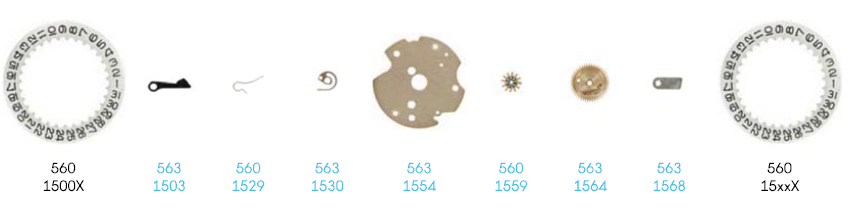

5601500 is the date indicator (ring) with the numbers on it - you can see this in your picture.
5631530 is the date corrector (and is probably missing or not engaged with 5631568 but, you can't see 5631530 in your picture as it is fitted on the underside of the date guard).
2401105 is the click spring so not related to the date function.
6131109 is the setting lever that, with 5631110, controls the actions when you pull the crown out.
As Al has just posted explaining this while I was writing I'll just say that if you can't feel the stops when pulling out the crown then I would suspect 6131109 or 5631110. I can see the latter in your picture and it appears intact. It seems that your watchmaker doesn't understand how the quick set works so, worth taking it to someone who does. Do you have a picture with the date guard 5631554 in place?
Good luck, Chris

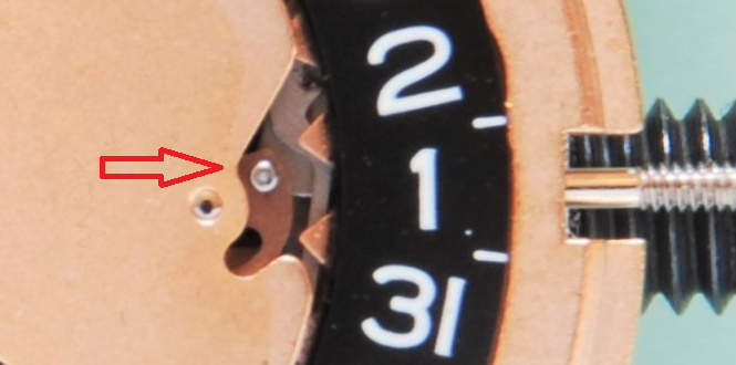

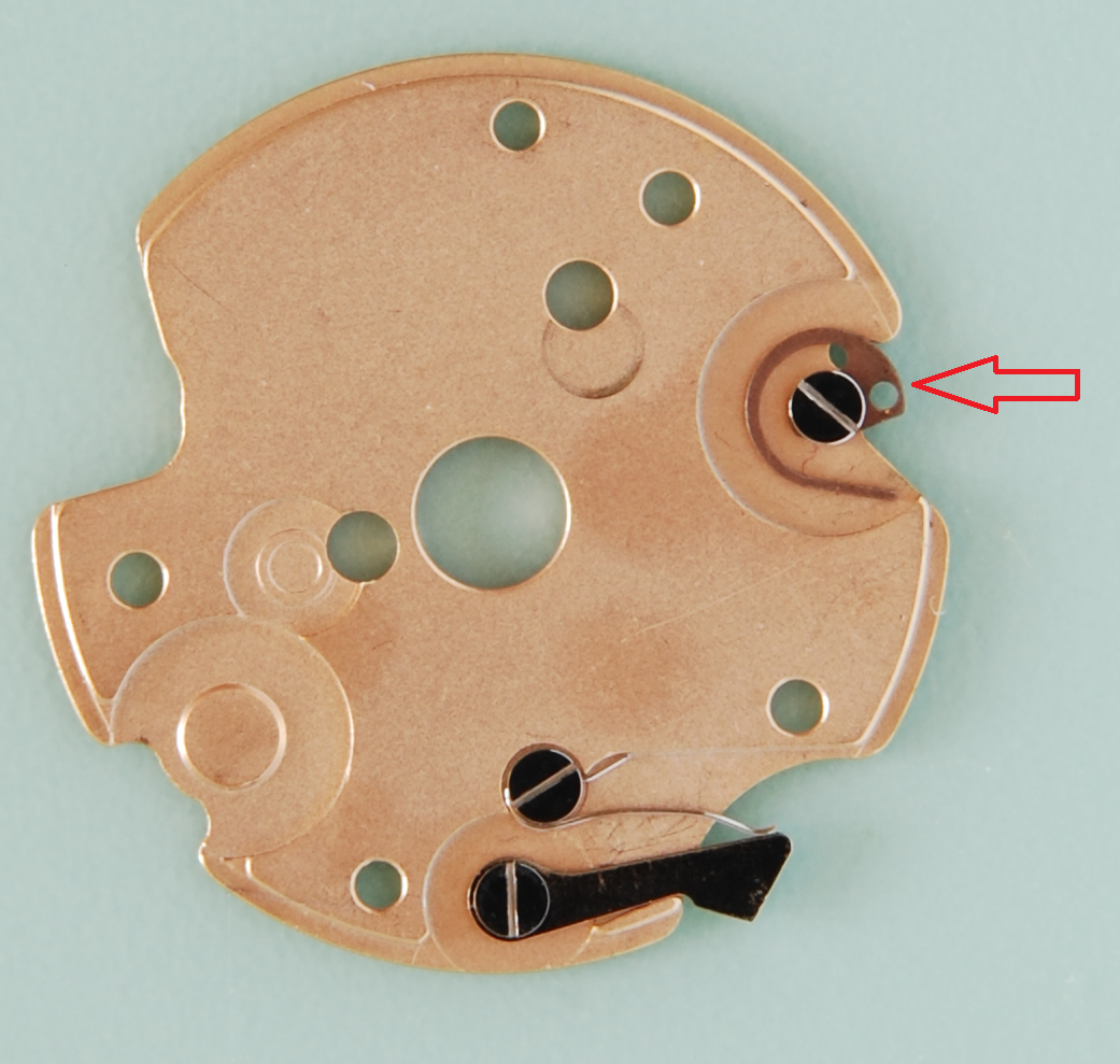

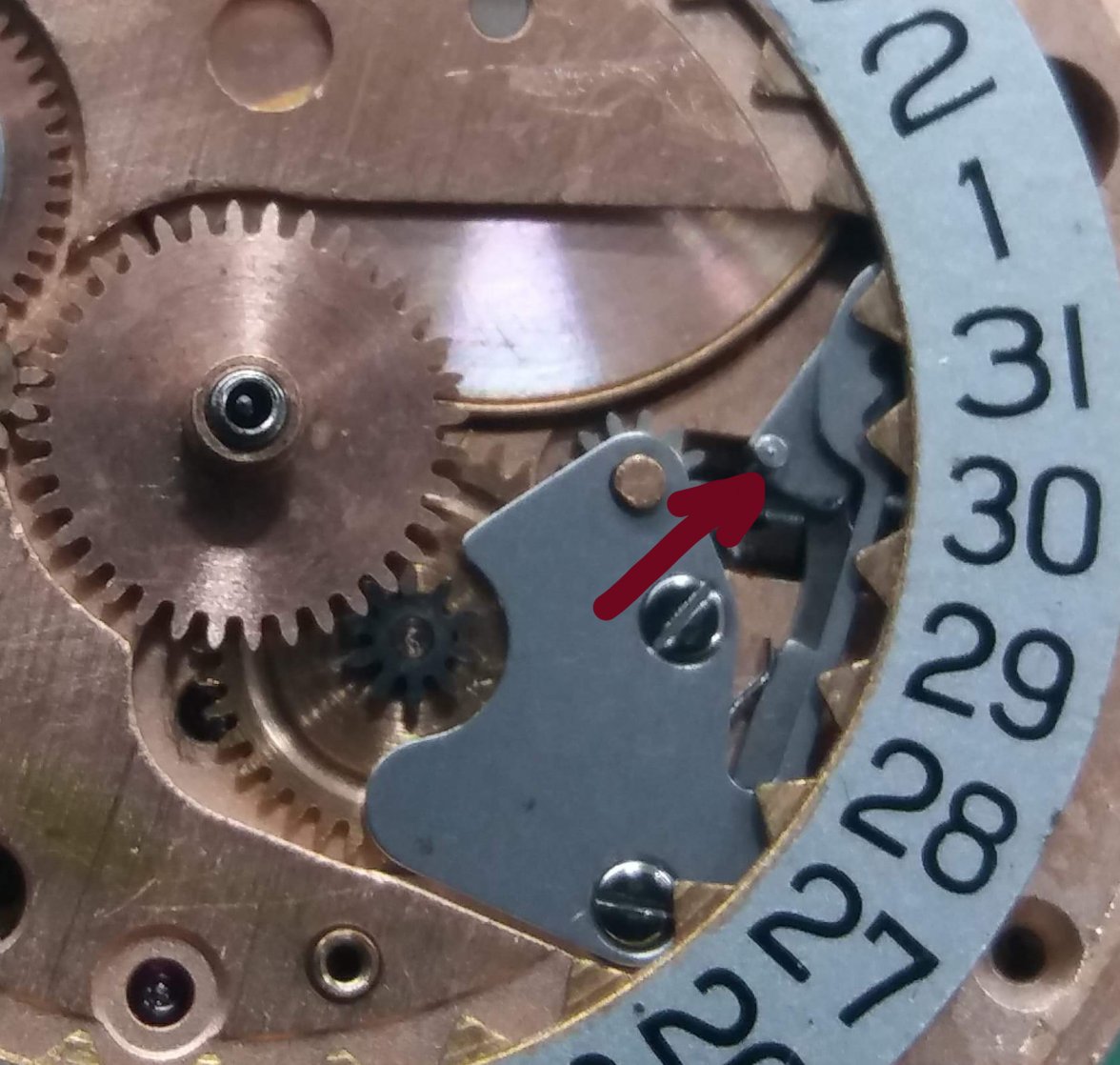

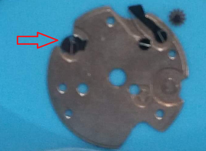

You have the old version of part 5631530 (can't remember if this is the same part number - probably not) but, it has not been engaged correctly... I can see it here (by the way, for me, these parts should have been stripped):
Here's a 5631530 one on the underside of the calendar guard.
And here, you can see it engaged with the pin on 5631568 - your one isn't
You need someone who understands this so, consider a different watchmaker. Still concerned that you can't feel the time setting stop as well.

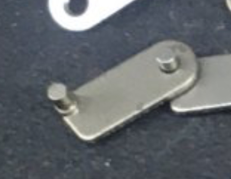

As far as I can see from these pictures, you have everything that you need but, the mechanism is not assembled correctly. When you pump between the 2nd and 3rd stops, part 5631568 moves and rotates 5631530 which moves the date on one tooth.
Ask your watchmaker to review the assembly when he puts the date guard on. This pin on 5631568:
Needs to be fitted in the hole of the steel piece here:
Then the semi quickset date will work. That's it.
I'm not sure why you can't feel the different crown stops but, it's probably the parts I mentioned above. Fix this first and see, as it may be that with these parts misaligned, the setting lever and spring are being squashed so the action is imprecise.
Good luck, Chris

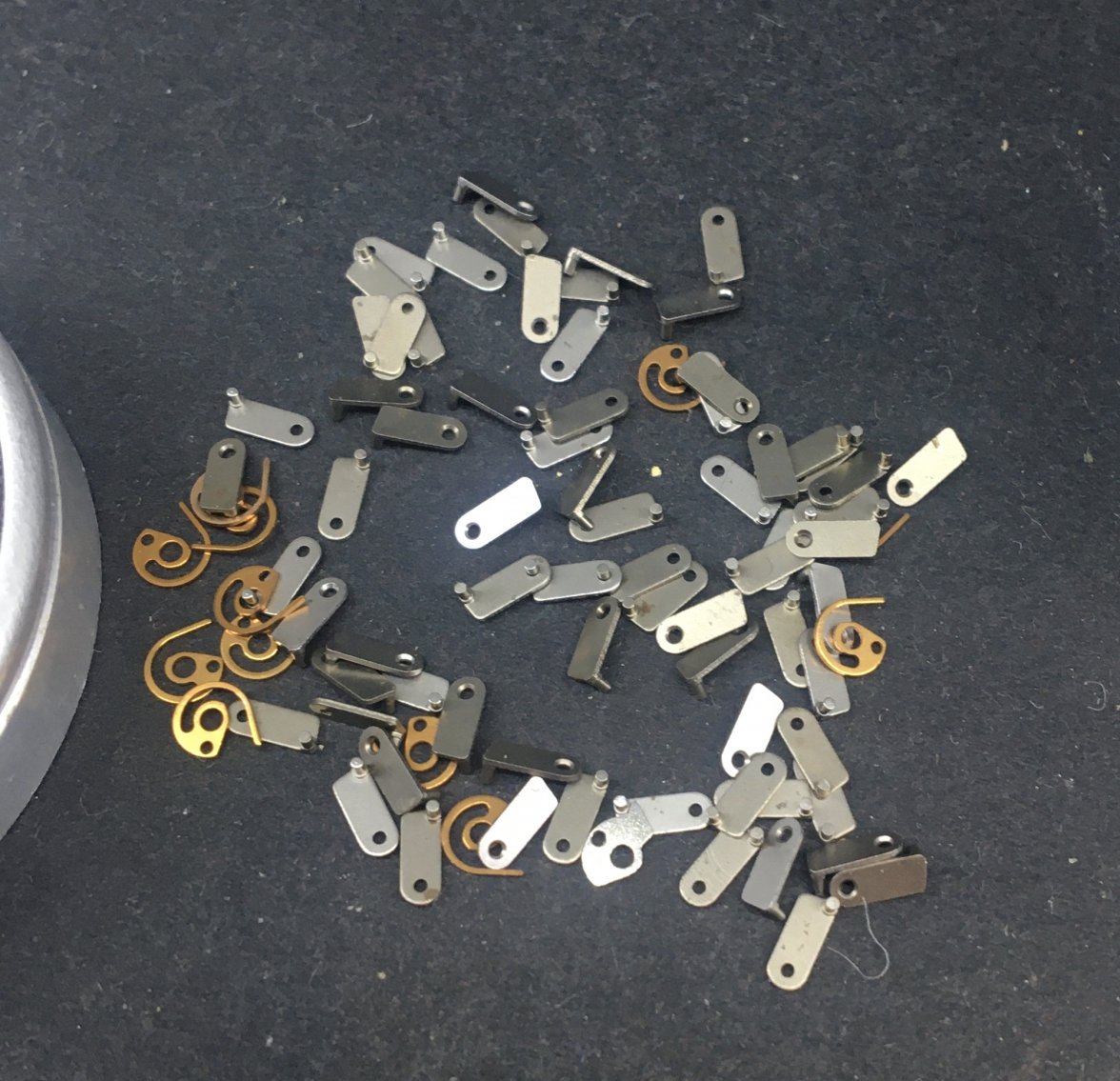

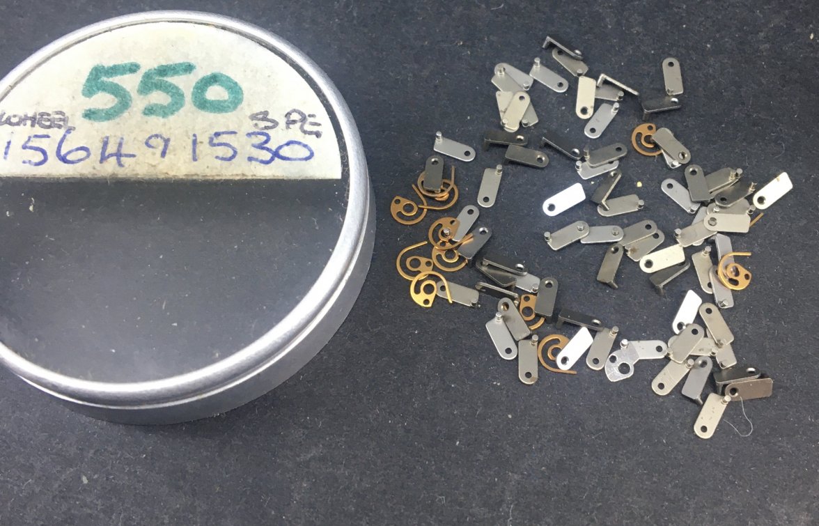

1,522
4,786
If you really struggle to find these let me know.
The old part is usually no good.
I have a few NOS left. Not sure on pricing either so if anyone knows That would help.

It looks like you have all the parts you need unless I am missing something.
The old 1530 is a weak point as Al says, I do not want to sell you something you do not need 👍

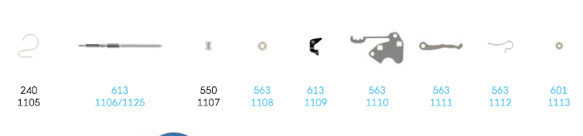

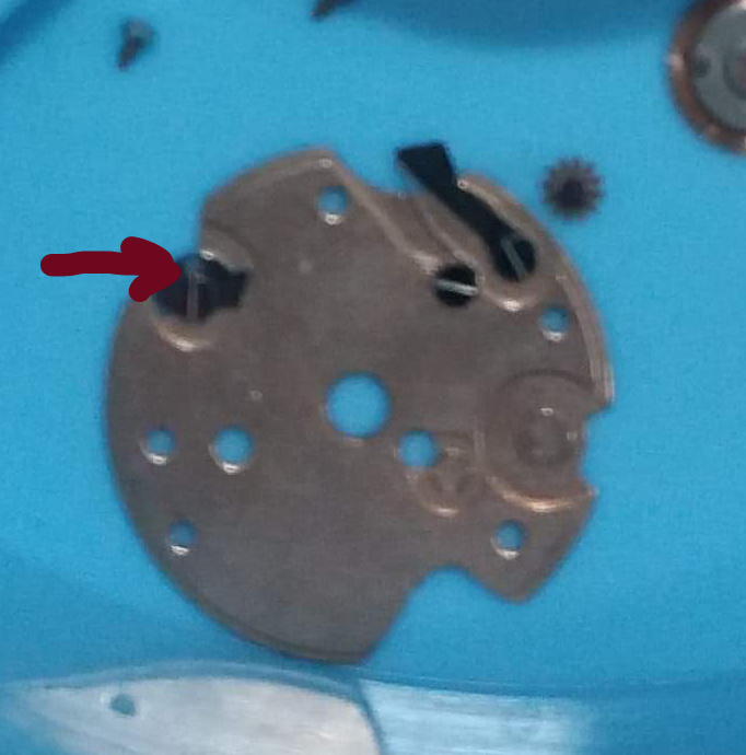

Michael, is it possible to buy this pusher (grey metal one) from you? I am looking for one since November and they are unavailable...
1,522
4,786
This one?
You an have one FOC if you pay the post.
