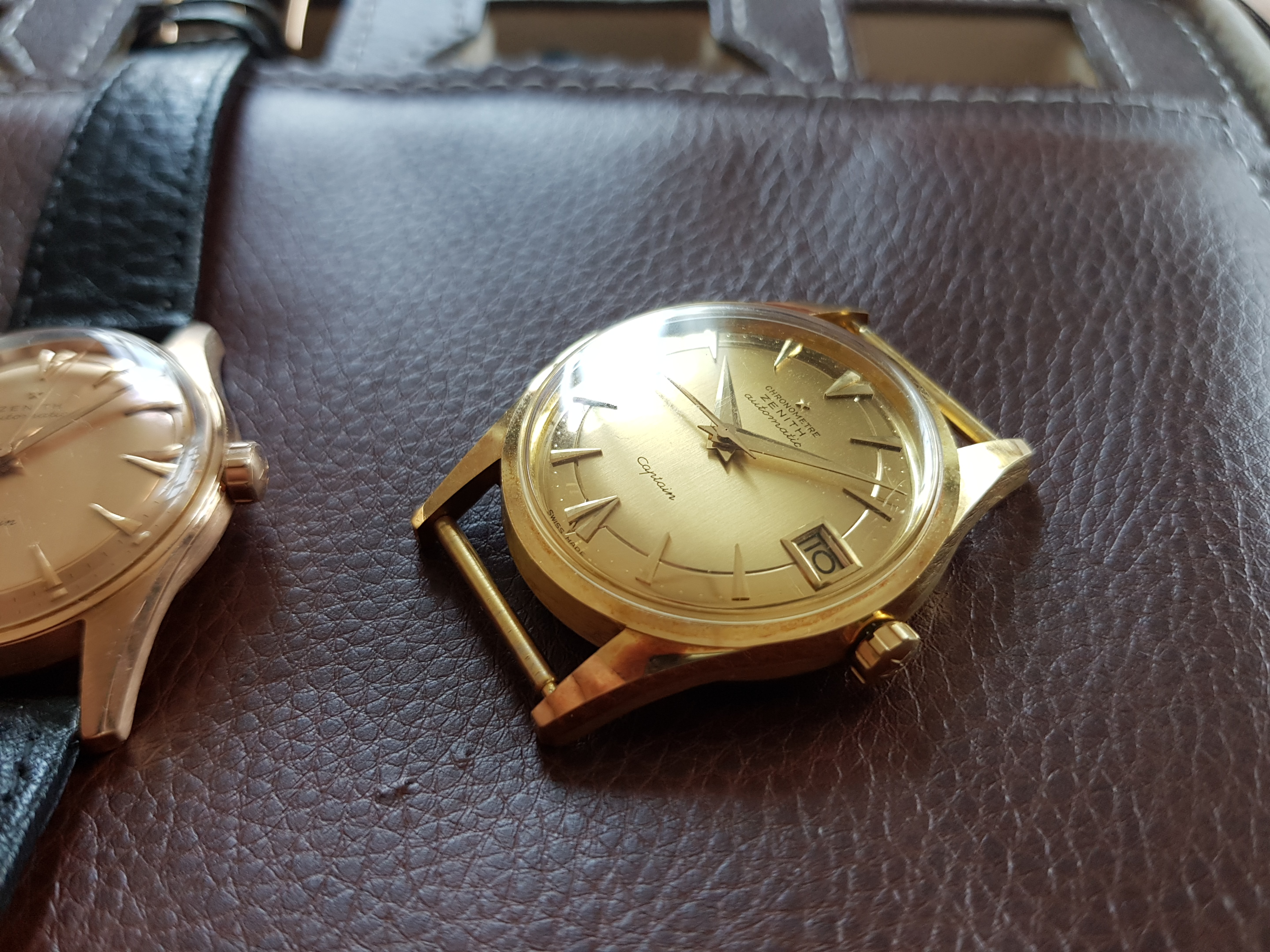

My new Zenith Cal. 71. 😁
Damn it that's really nice… Perhaps just get the compensation then? 🙄
🥰 Wouldn’t be sending that back 😉
I'd even say: send it back to me! It's gorgeous 👍

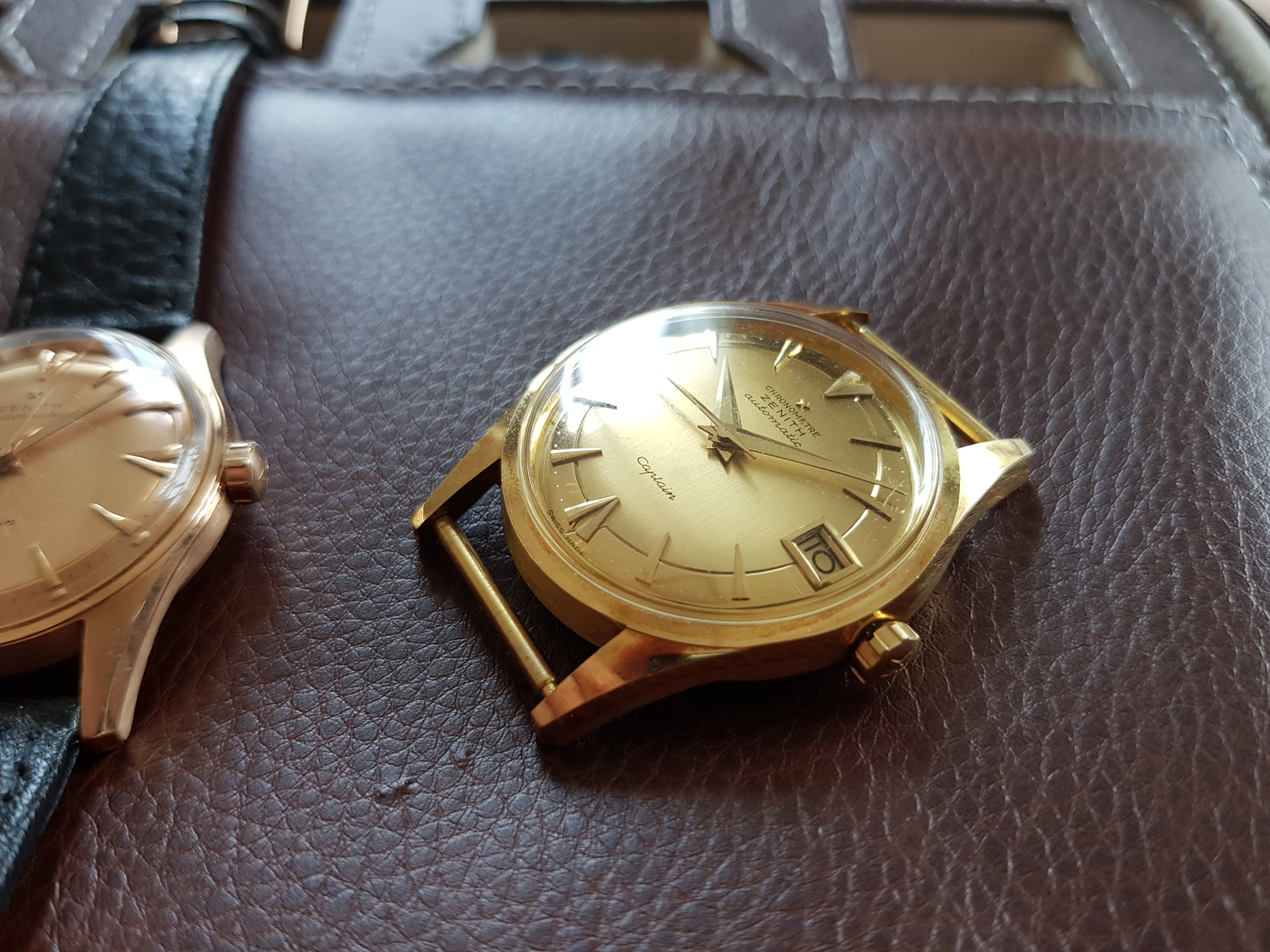

Just keep it👍 and get it sorted. Lovely watch!
