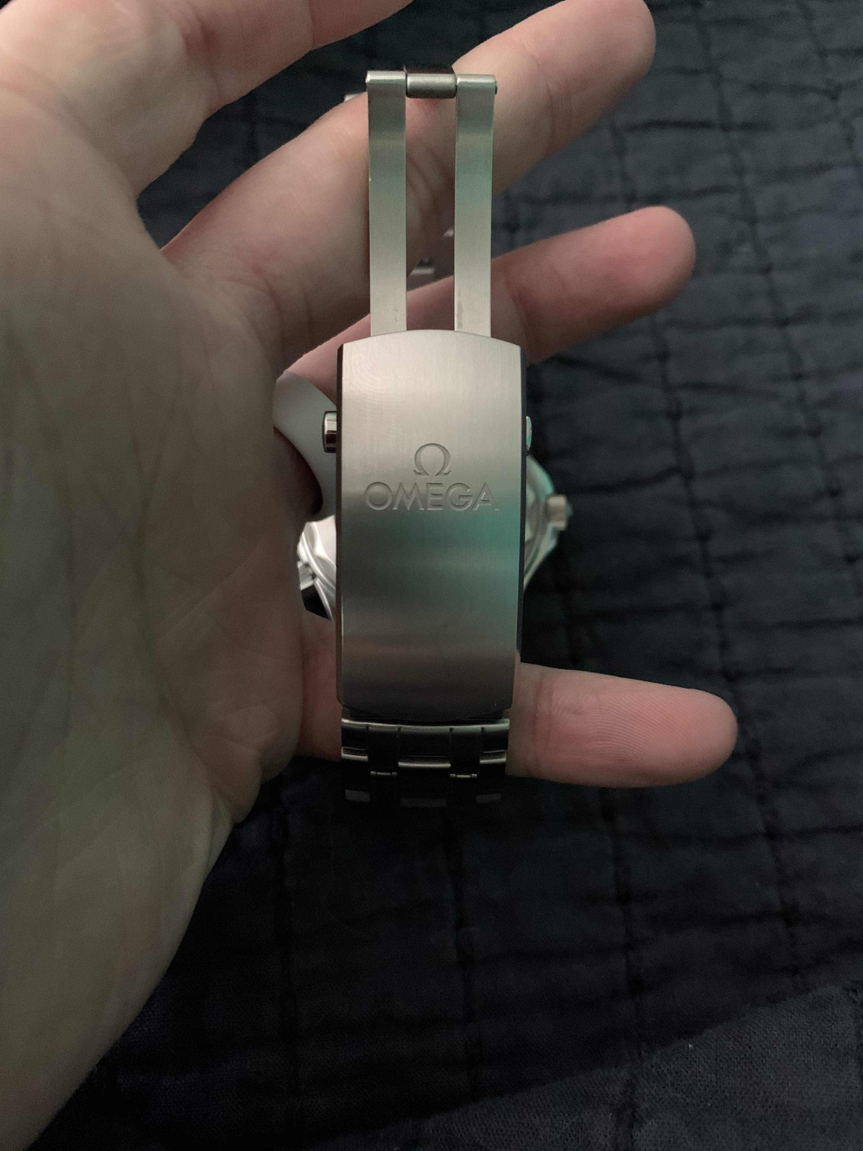

Hi all,
I've had my SMP 300 for about 3 months , bought new at an AD. Last week one of the buttons on the clasp got stuck in. I was able to get it to release by giving the inside of the clasp a little push, but it will get stuck again after a few pushes. I've been able to mostly mitigate the issue by pressing both buttons in at the same time; they don't seem to get stuck that way. I'm assuming Omega won't have any issue fixing this as the watch is 3 months old , and the AD I purchased from is out of state, but I would hate to send in my brand new watch for what could be weeks over a fault clasp.
Is this something that I would be able to resolve on my own? Any other fixes or things to try ?

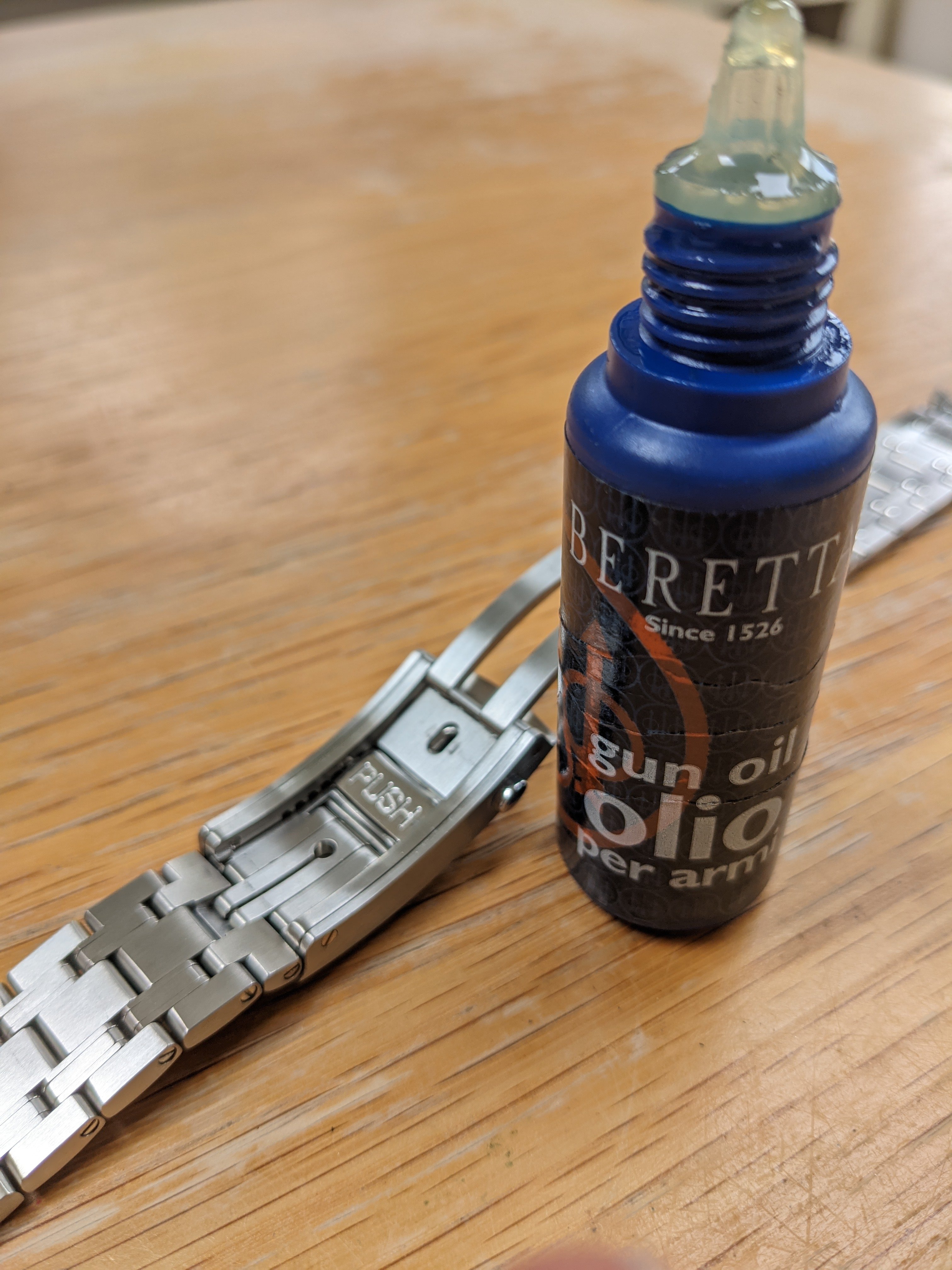

I had the same issue. And did the exact same thing. It worked for a while but it always stopped working soon after. I ended up putting a single drop of gun oil into the clasp hole and it fixed it permanently. All the work of taking it apart was meaningless for me.

I tried everything else and none of it worked for more than a few pushes. But for some reason the oil worked perfectly. I know it's not a long term solution if you dive or get it wet often, I'm sure the oil will eventually wash out but I don't swim so it worked great for me.

I mean it won’t really dry. It’ll wear off on its own over time. There are some gun oils that you can heat up and they’ll bond with the steel more permanently. But I didn’t want to heat up steel that is so thin in some spots.

I put one drop in and let it sit for a few mins. Then I wiped up any excess and that was it. As far as what it does…..I’m not really sure but it worked for me.
