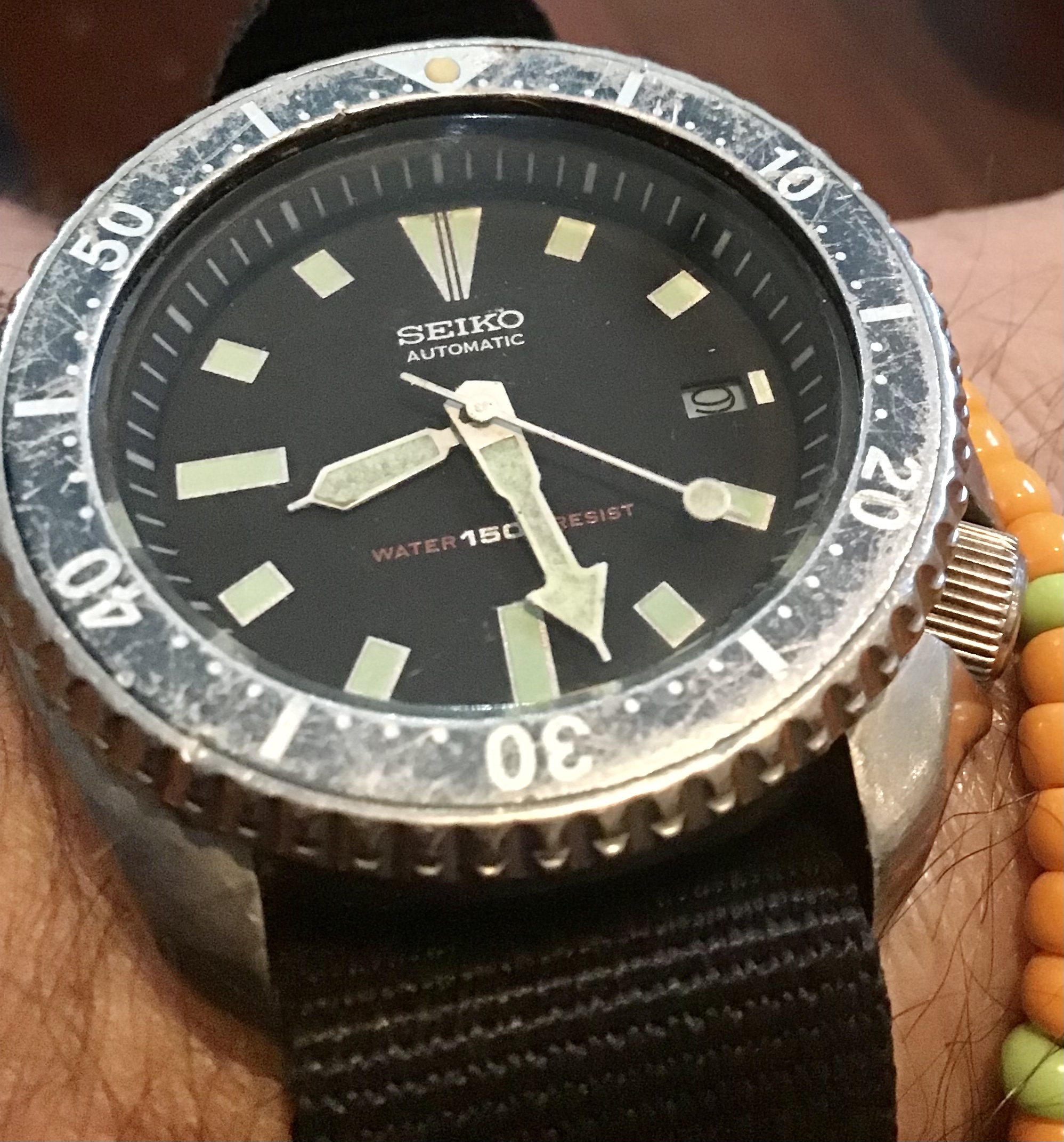

The scratch at 40 on the bezel really annoys me.
Off topic which model Seiko is this (bug bear of mine is day/ date) is this a mod or standard dial? Thanks
