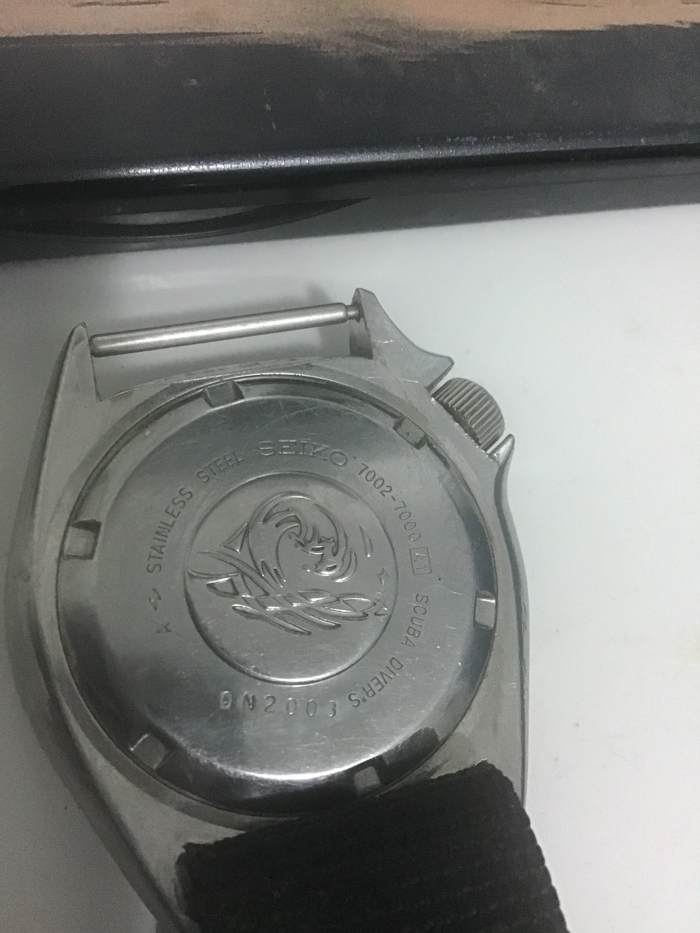

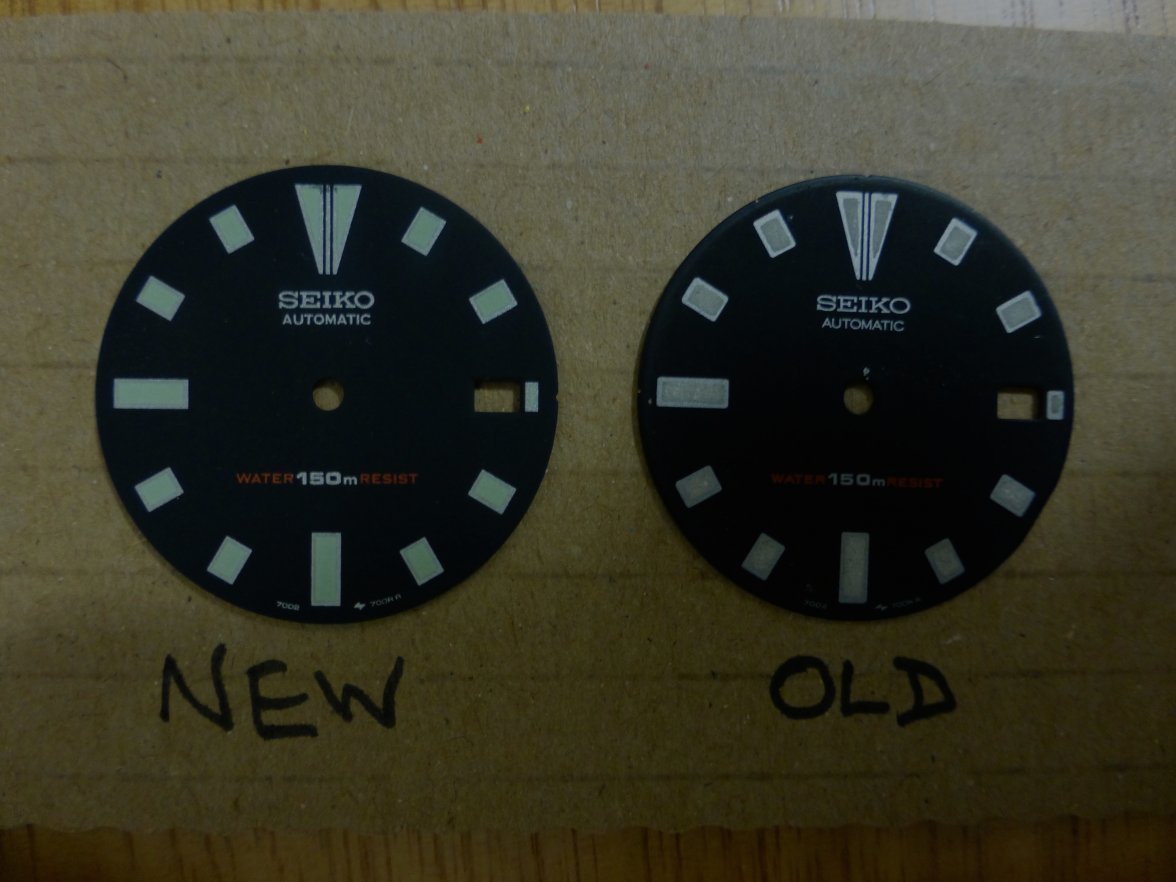

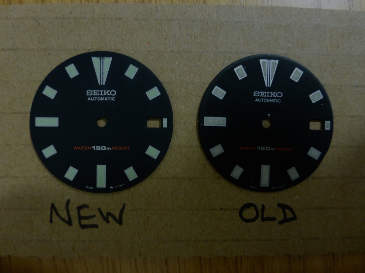

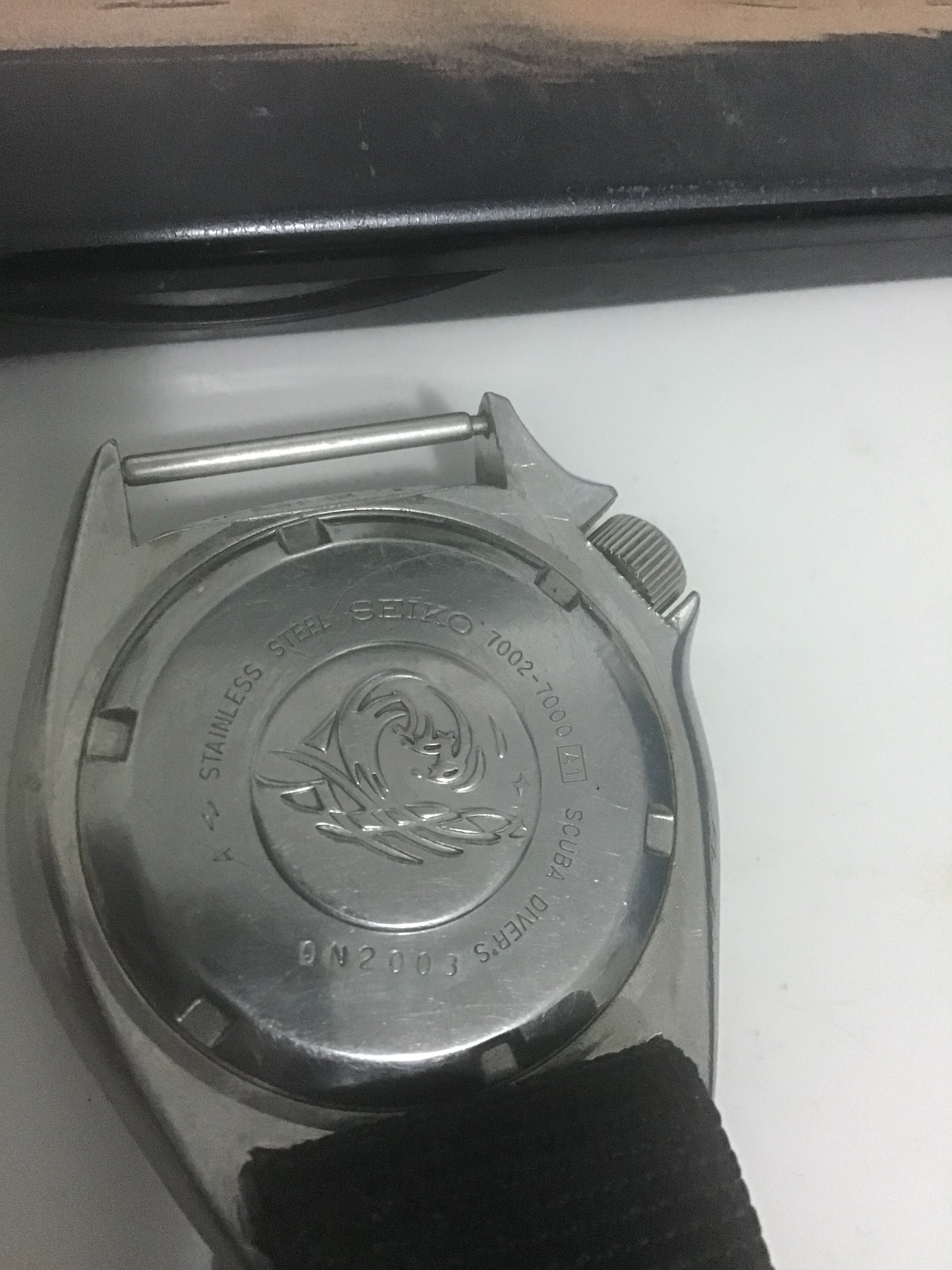

Off topic which model Seiko is this (bug bear of mine is day/ date) is this a mod or standard dial? Thanks
Standard dial
