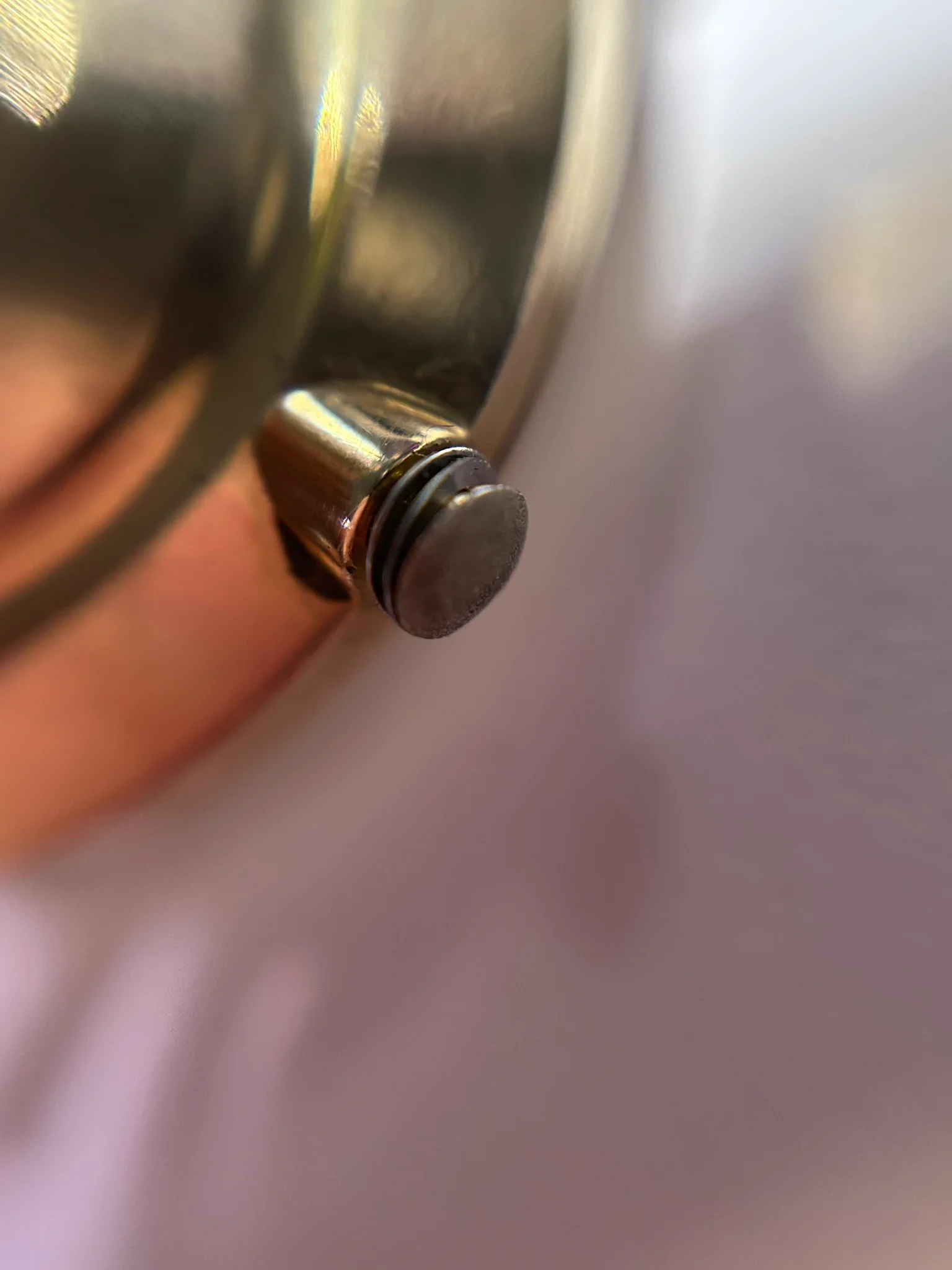

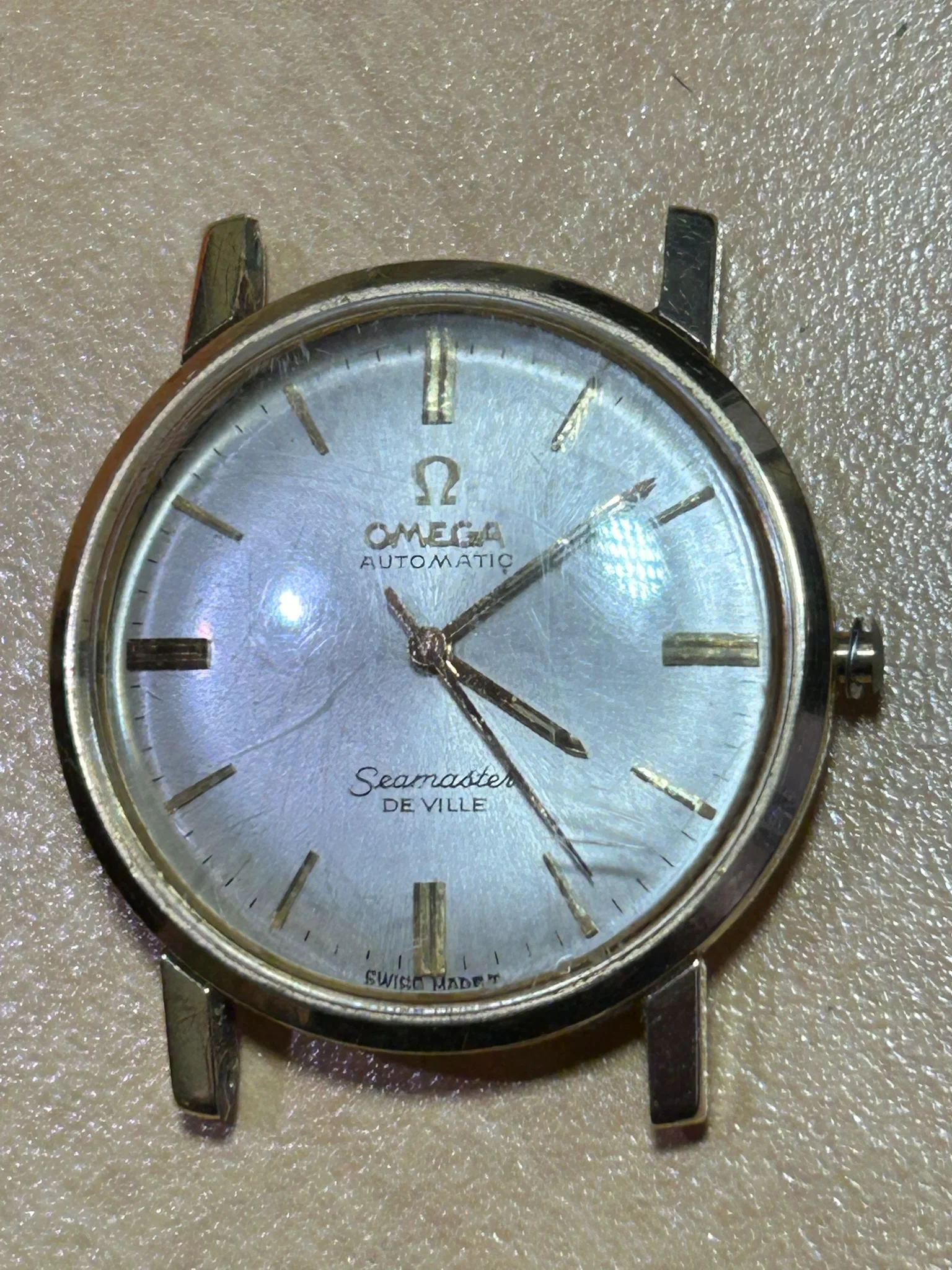

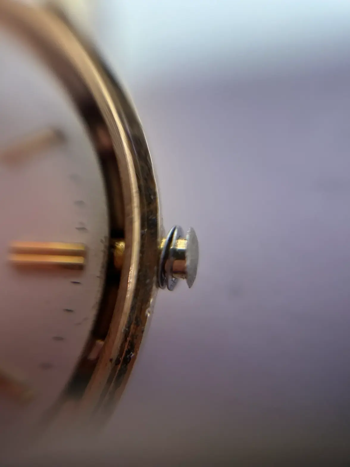

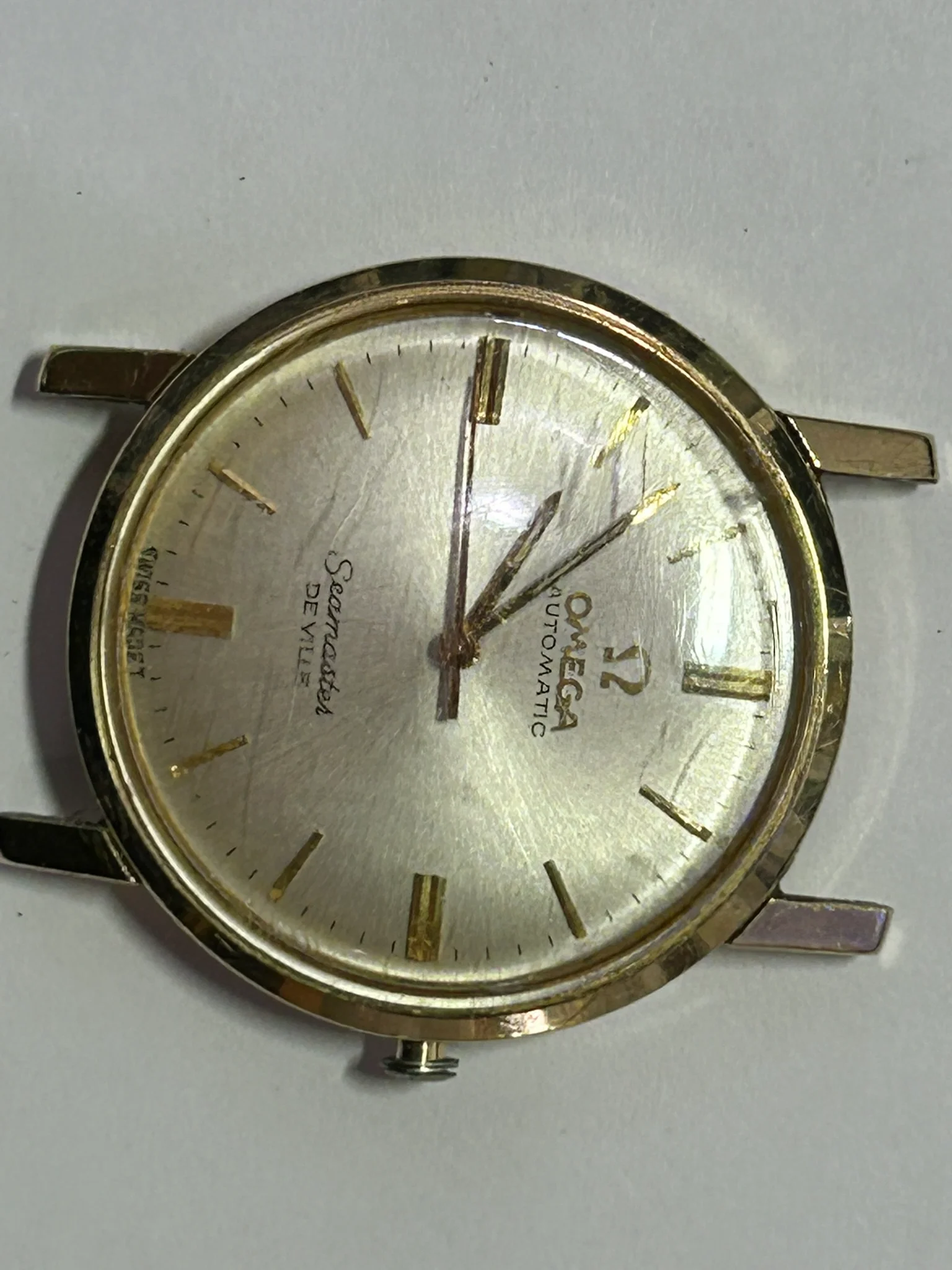

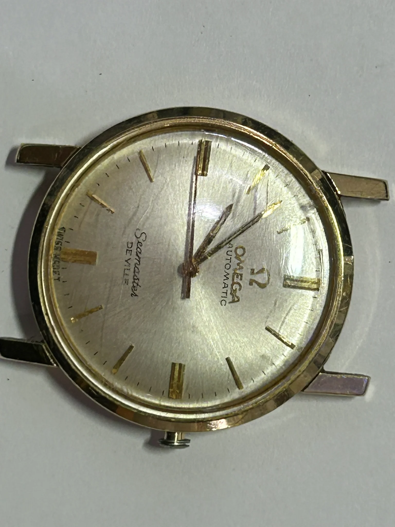

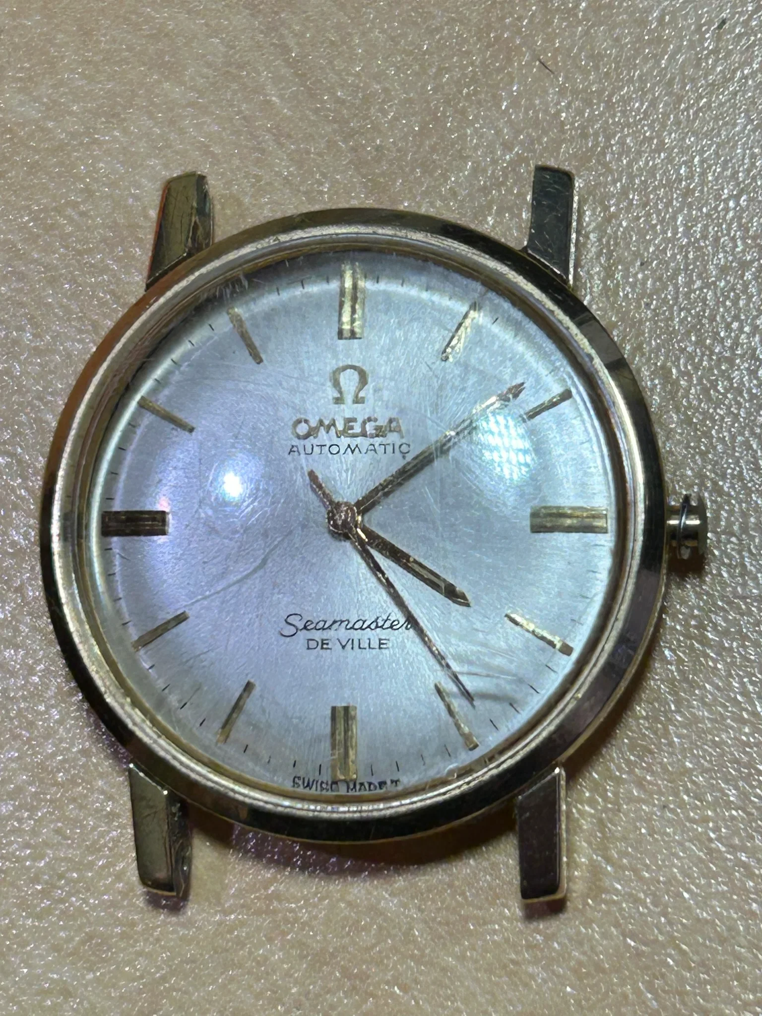

The story as I was told it. My grandfather wasn’t a rich man (delivery driver for ColaCola in the 40’s through 60’s) but this was his ‘everyday’ watch. Unfortunately the bracelet and was lost years ago as he liked twist o flex better.

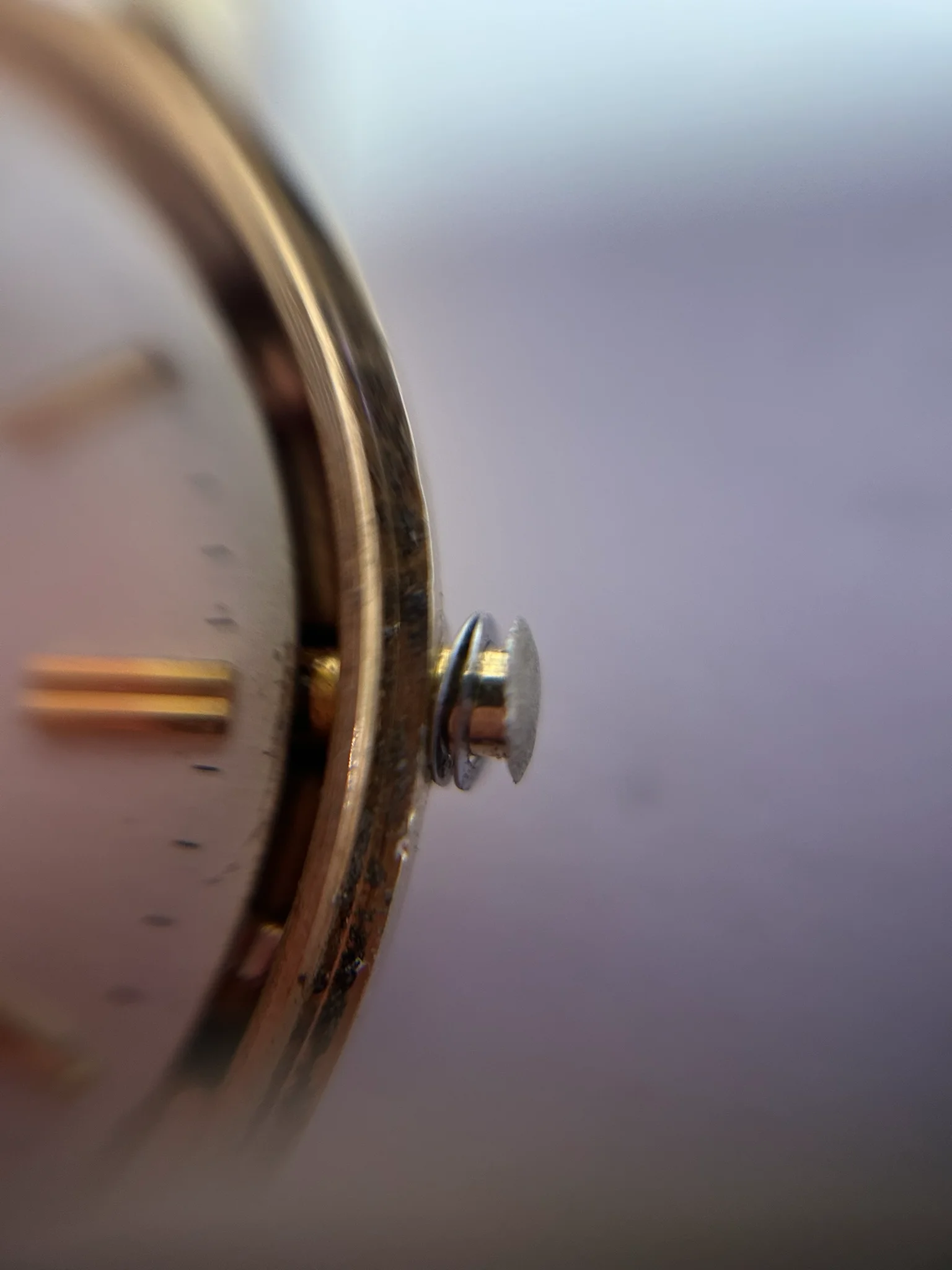

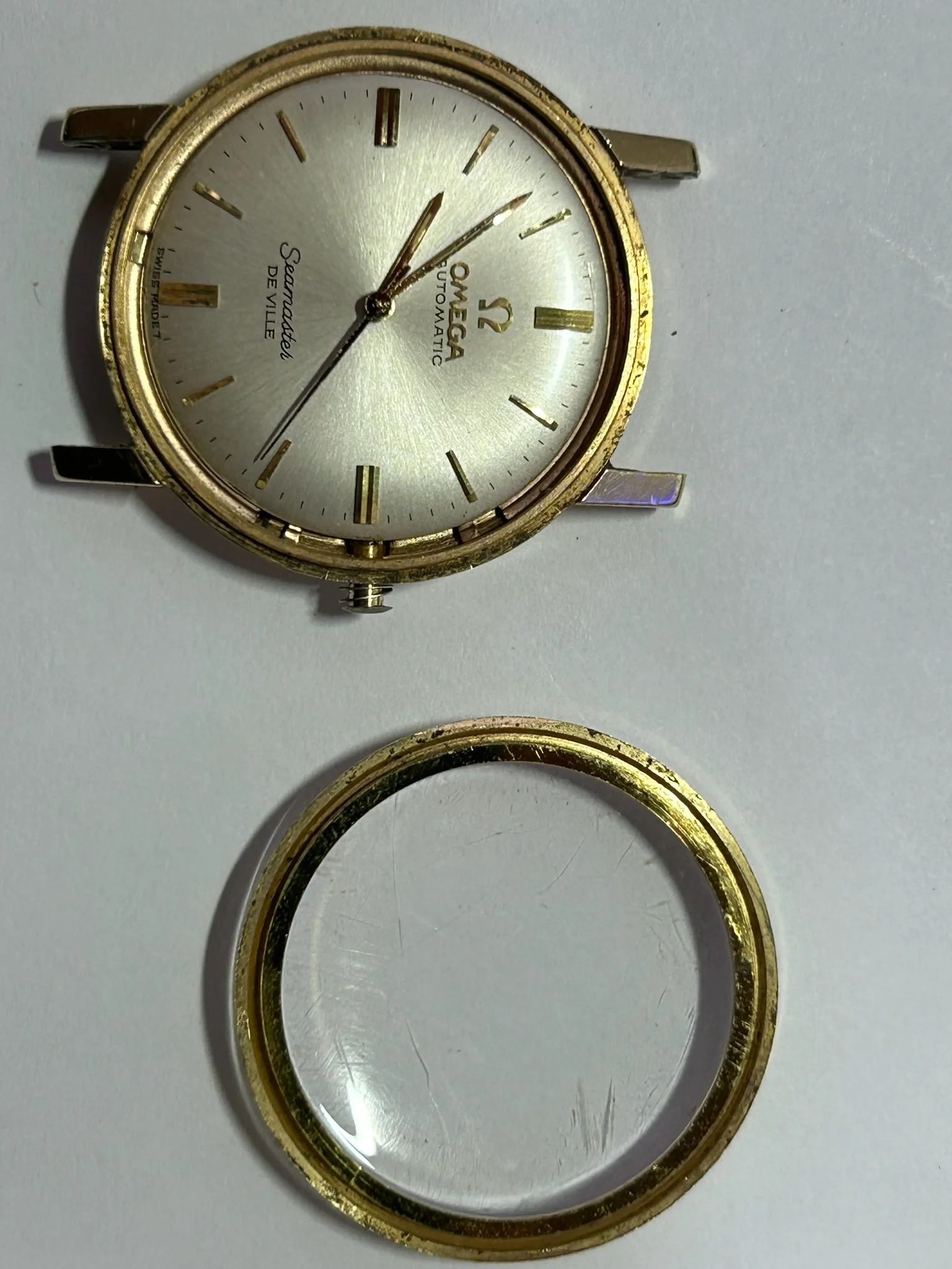

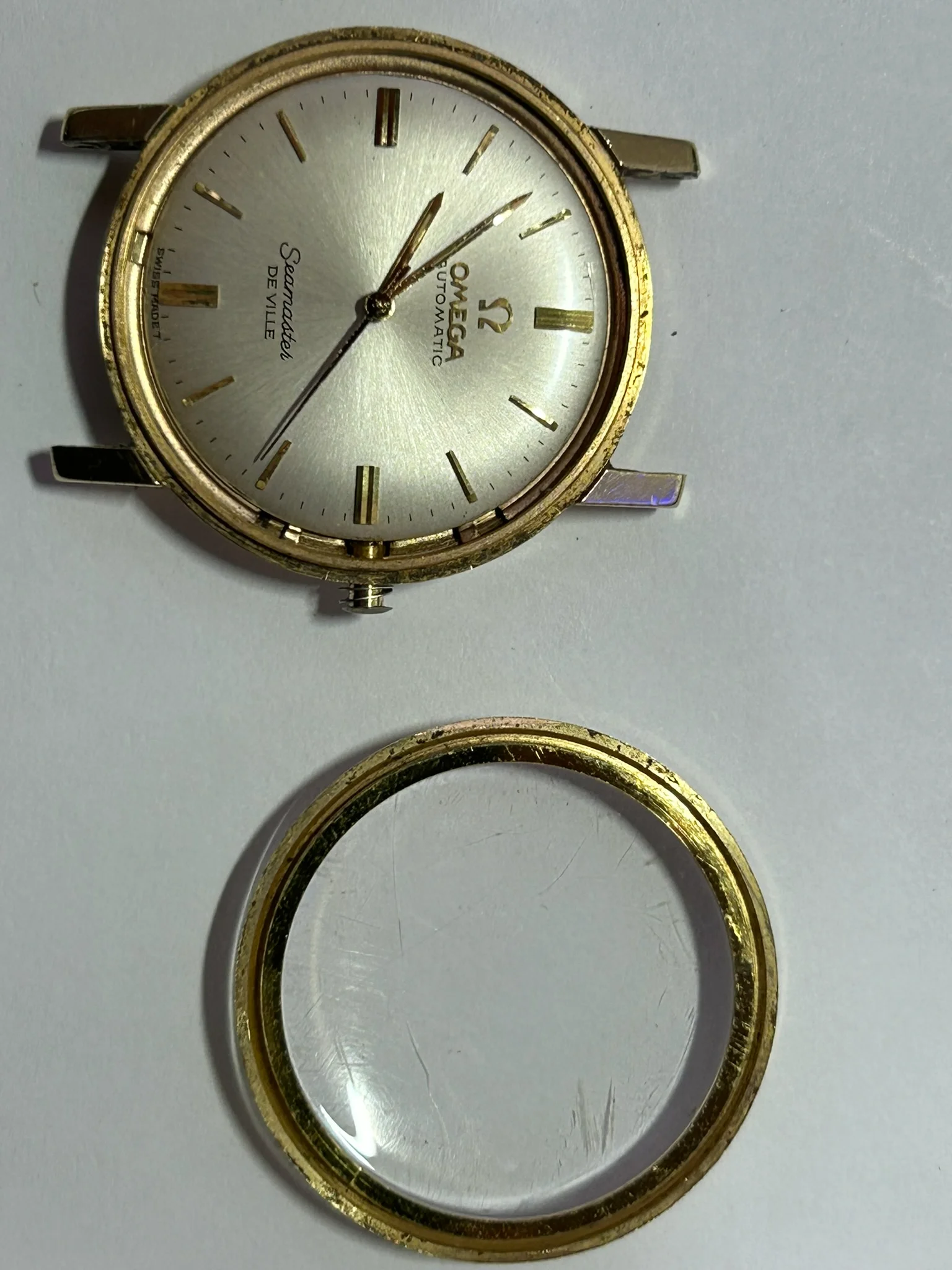

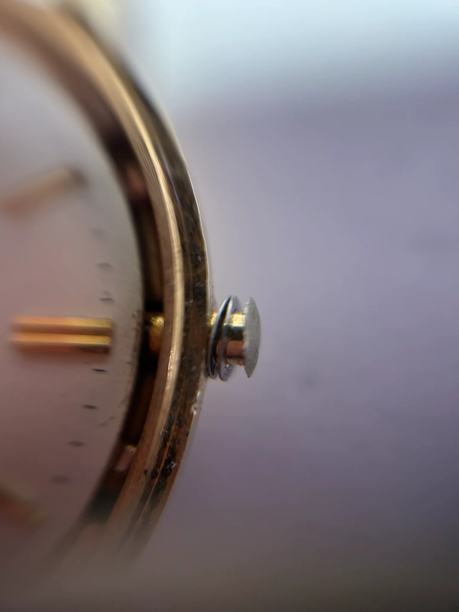

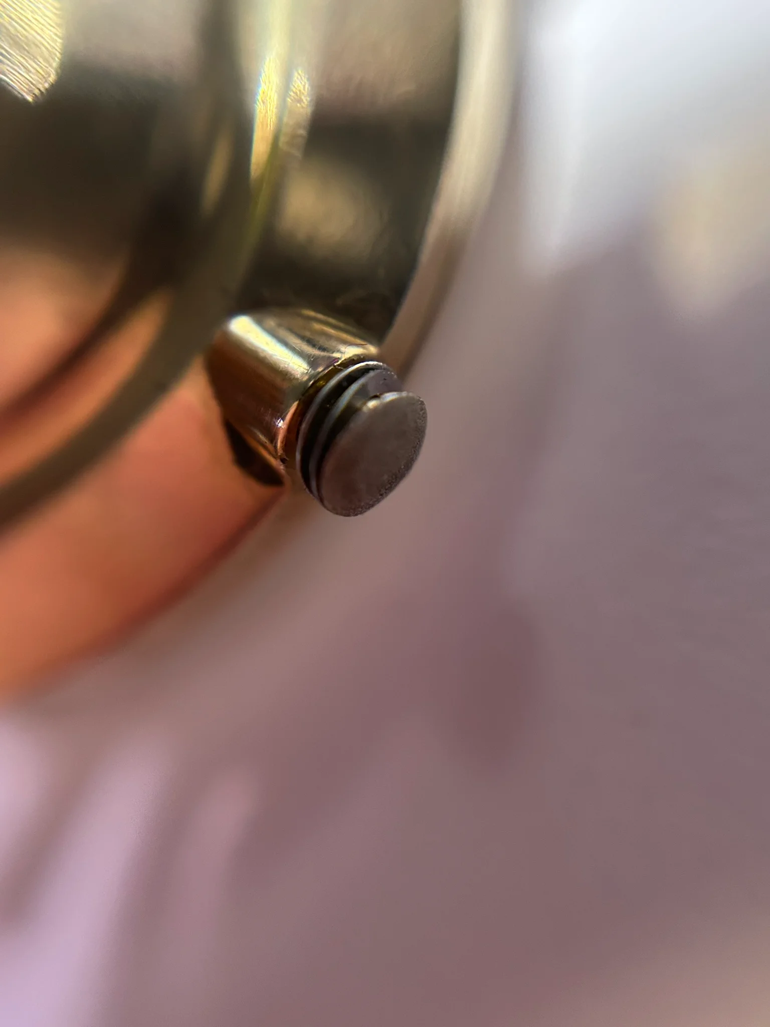

After he died a someone did ‘something’ to it - no idea - but my father wore it for years this way. Check out the pics of the stem. The knurled knob is gone and the remains of a black gasket/washer crumbled off the stem when I got it. Teh case/crystal comes off way easy - like with a plastic tool and just a little pressure. Didn’t dare take it any further apart.
It runs, and the time sets if you pull out firmly on the stem while turning.
Anything special about this model? Or just get a decent leather strap and enjoy it the way it is?

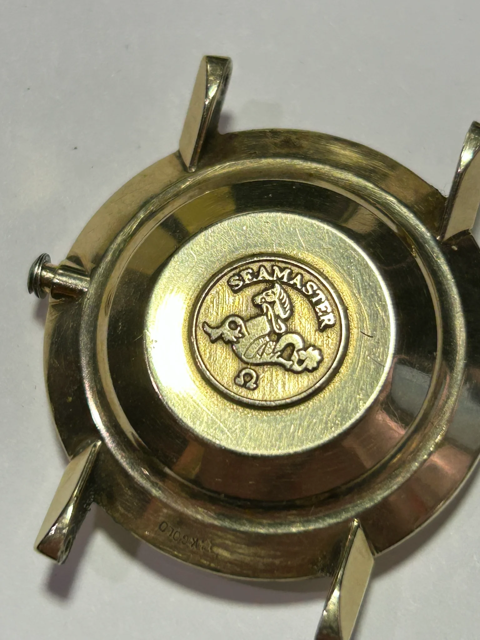

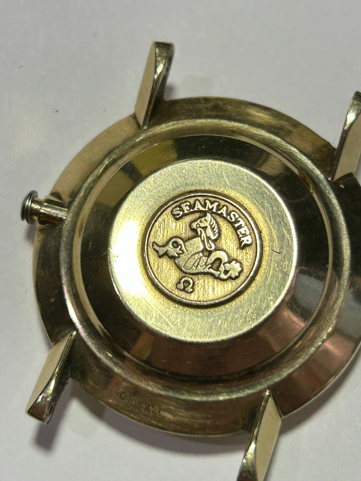

Looks like a smaller size @33mm powered by a 591.
You should have it serviced and get a crown for it.
13,571
23,557
It’s a Seamaster DeVille from the mid to late 60’s so certainly wasn’t his daily watch for his working life in the 40’s and 50’s.
Nice little watch though and crowns are still available so I’d get it serviced, new crown etc and wear it with pride.
As @hoipolloi says, from the caseback it appears to be the smaller 32-33mm version, not the full size 34mm which may or may not be a factor for you.
