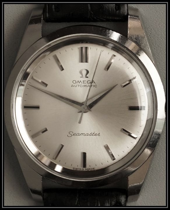

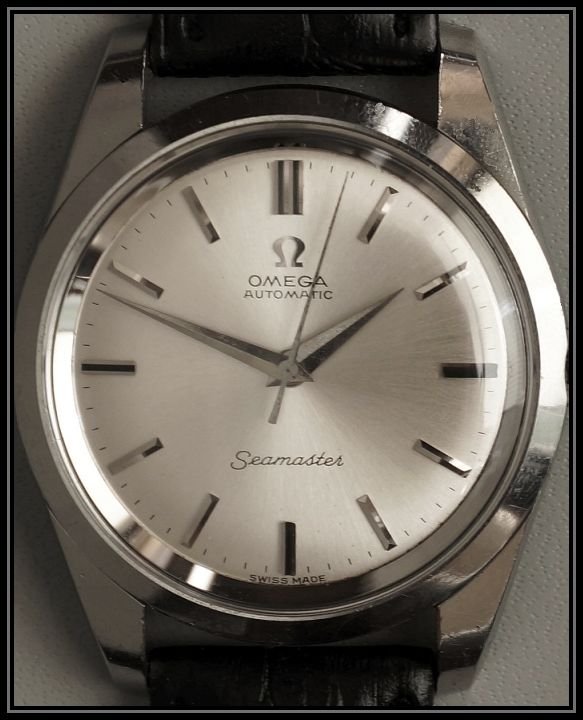

Pay special attention to --- SWISS MADE ---
And SWISS MADE.
The ones with dash Swiss Made dash have black painted hour markers. Not onyx inserts and less desirable.

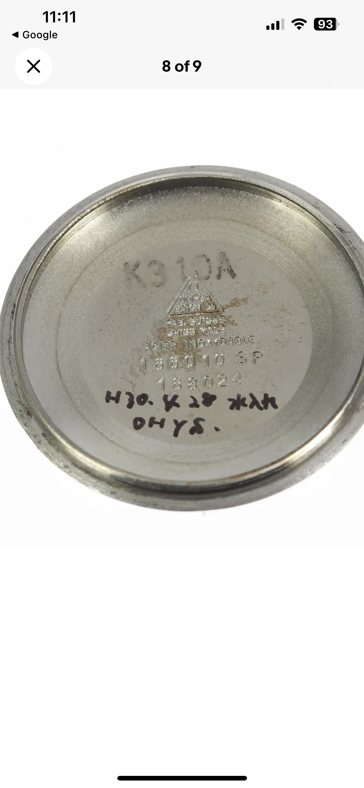

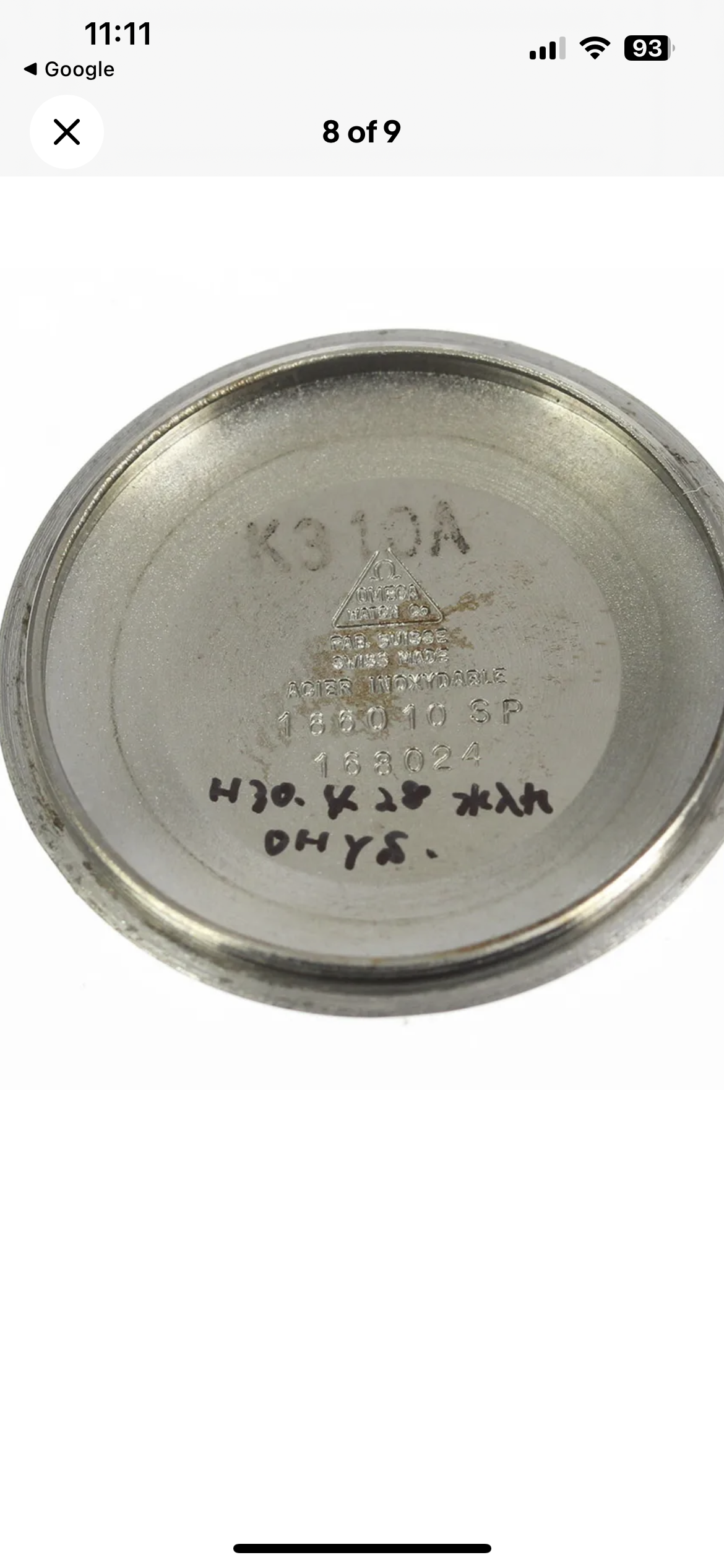

You were asking about the Caseback numbers they can have both the 166.010 and 168.024 same Caseback see example for eBay listing. The chronometer Caseback should have both numbers I think.
And SWISS MADE.
I had no idea onyx inserts were a thing, that’s very cool! Thanks for the tip.

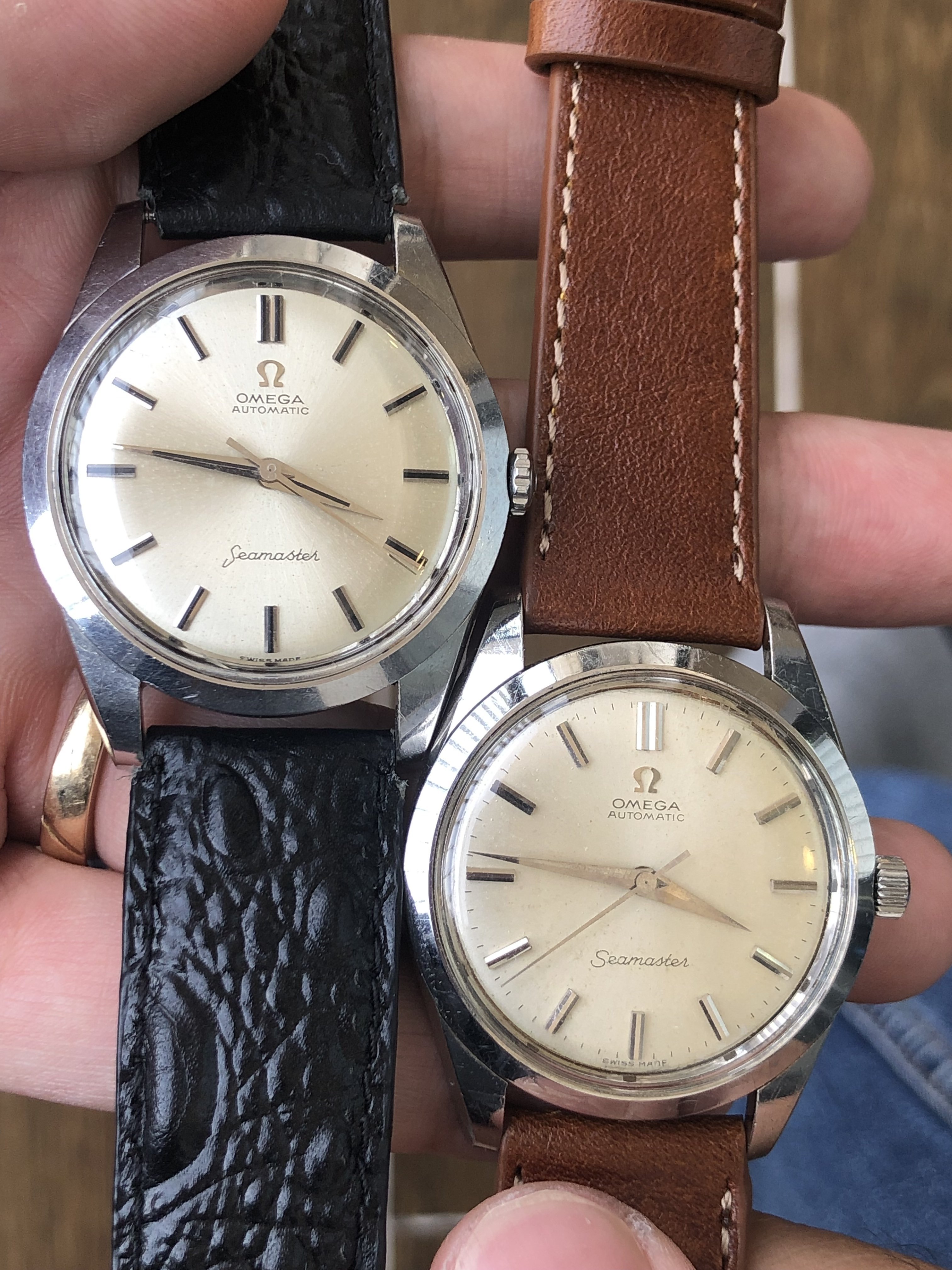

Thank you for your replies! I’ve been continuing to research and look at various examples, and I’m trying to find something I can use as a good solid reference to compare to potential listings. What about this watch as a reference? I would think that if I bought this watch for around $750, I’d be quite satisfied with it.
https://timeanagram.com/en/products/42700
24,838
55,263
From what I can see, it would be a good buy at $750. However, they are asking $1,250. And keep in mind that it will eventually need a service if you're going to wear it regularly.

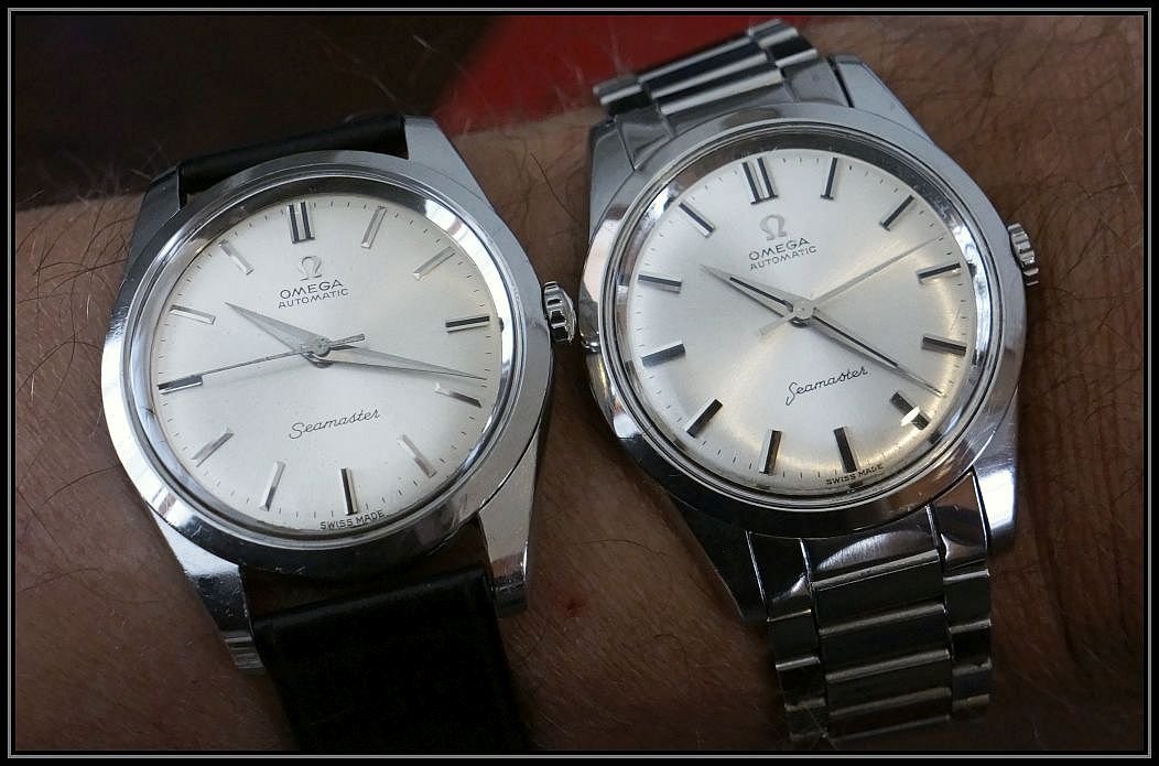

No-date non-chronometer 165.010 is more appealing IMO. And the 165/166.009 case is even nicer. You don't have to buy what everyone else buys. 😀
786
2,473
[/QUOTE]
Yes!!!!

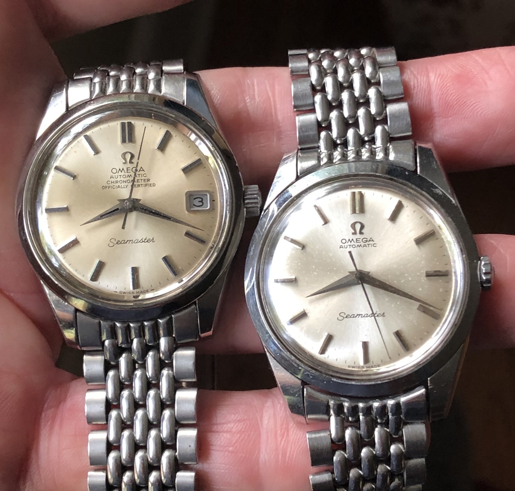

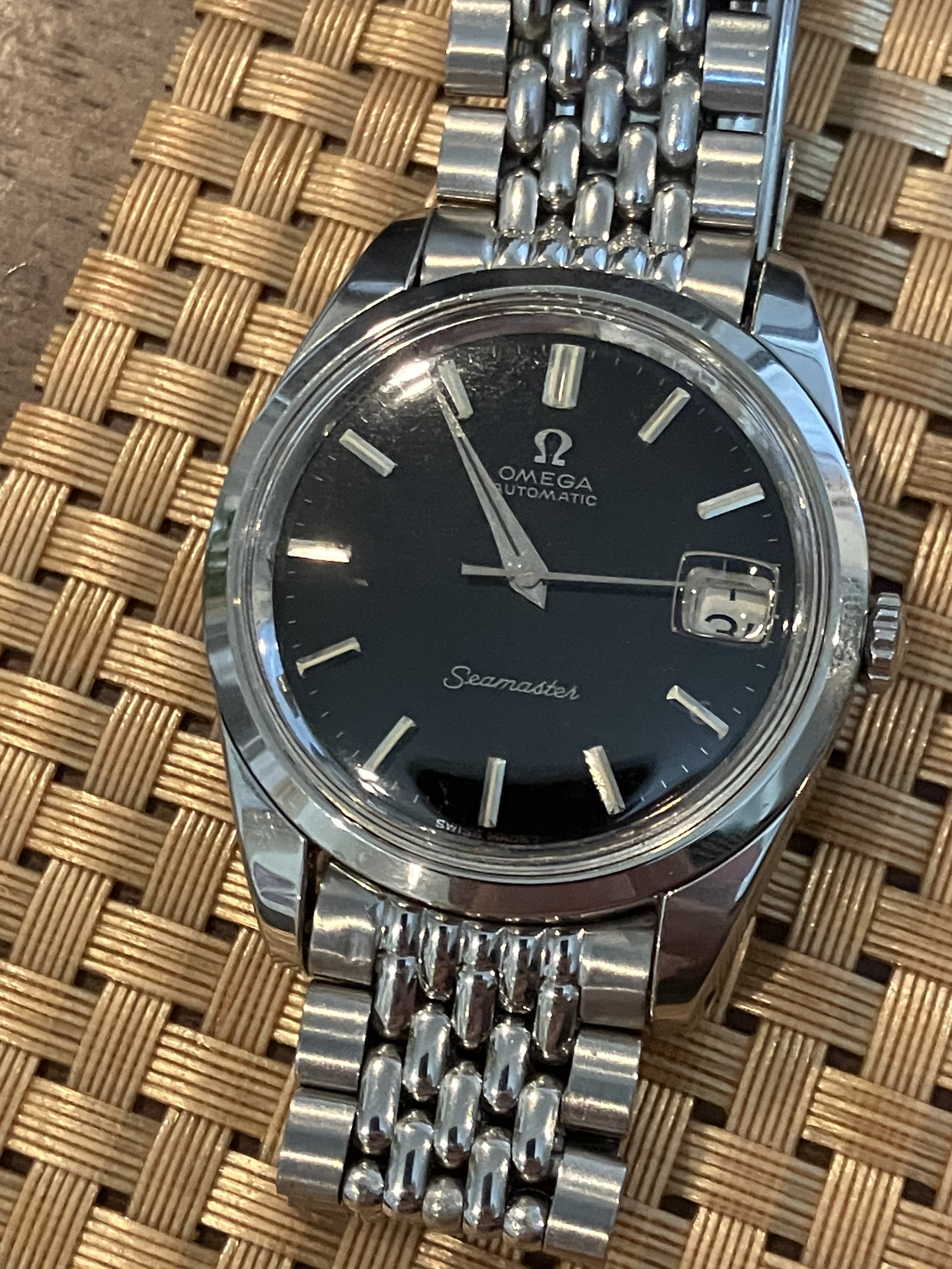

I’m in Japan as well and second all of the advice you’ve gotten here. I’ve bought a number of 166.010 and 168.024 models and agree that they look like a million bucks on a BoR bracelet. They are plentiful here, with varying conditions and prices. If you’re patient, you can definitely land a nice one on Japanese sites.
In addition to @hoipolloi’s point about onyx markers, another factor to keep in mind is the crown. The original thin scalloped crown on the 166.010/165.010 is hard to find because almost every serviced example had it replaced. The original crowns tend to be shot, water-resistancewise, so you should take care not to get caught in the rain with it. 166.024s always seem to have the thicker crown; I’ve never seen one with the thin crown, though I haven’t made any exhaustive search for one.
Also, the cyclops replacement crystal is so common that a lot of Japanese owners must have specifically requested it, maybe for the Rolex look. I think it looks fine on the watch, as does the thicker crown. Original examples tend to go for higher prices. Definitely don’t buy one from a dealer unless it’s original. No point in paying a premium for a piece you could find on Yahoo! Auctions for half the price and a little patience.

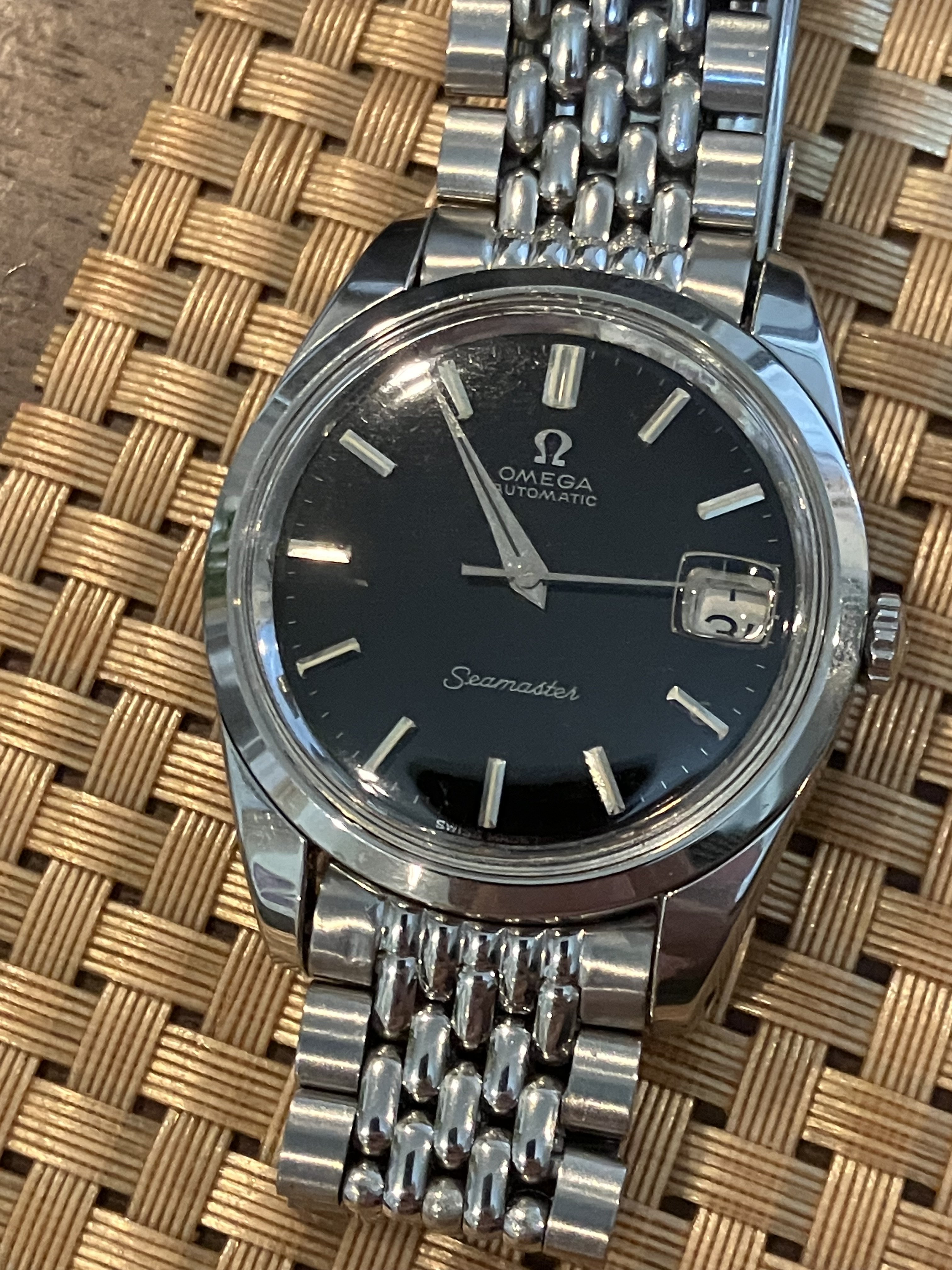

Lastly, the champagne dial on this model is prone to bubbling, giving it a pebbly or spotty look. The ones that are bubbled but not discolored look fine on the wrist and can be a good buy. There are also black-dialed versions out there that look spiffy as hell.
