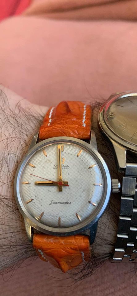

D Posts 23 Likes 1 djcarpentier ·Dec 18, 2022 Hi all. I'm wondering if anyone can help me identify this Seamaster. This is the only image i have. Crown is a service crown. i'm a bit suspicious of the hands as i've not seen an older Seamaster with rectangular hands.
Posts 13,493 Likes 31,814 X350 XJR ·Dec 18, 2022·Vintage Omega Aficionado Your suspicions are correct, those are very incorrect hands. Hard to say much more without some better photos. Edited: Dec 18, 2022

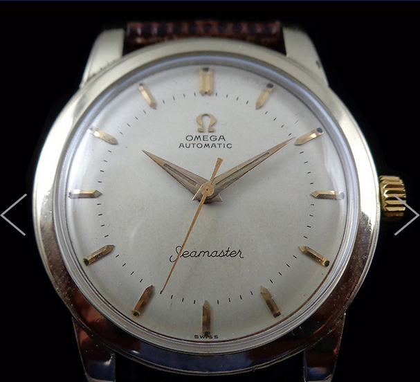

Posts 13,493 Likes 31,814 X350 XJR ·Dec 18, 2022·Vintage Omega Aficionado Should look more or less like this.
