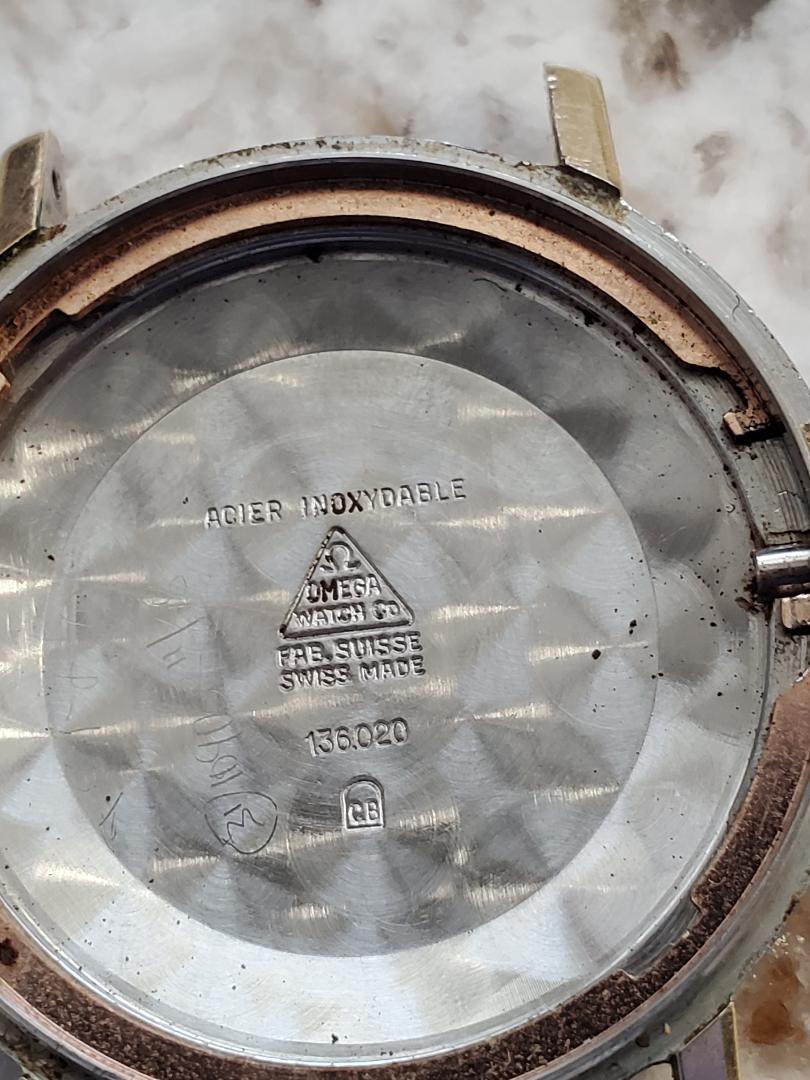

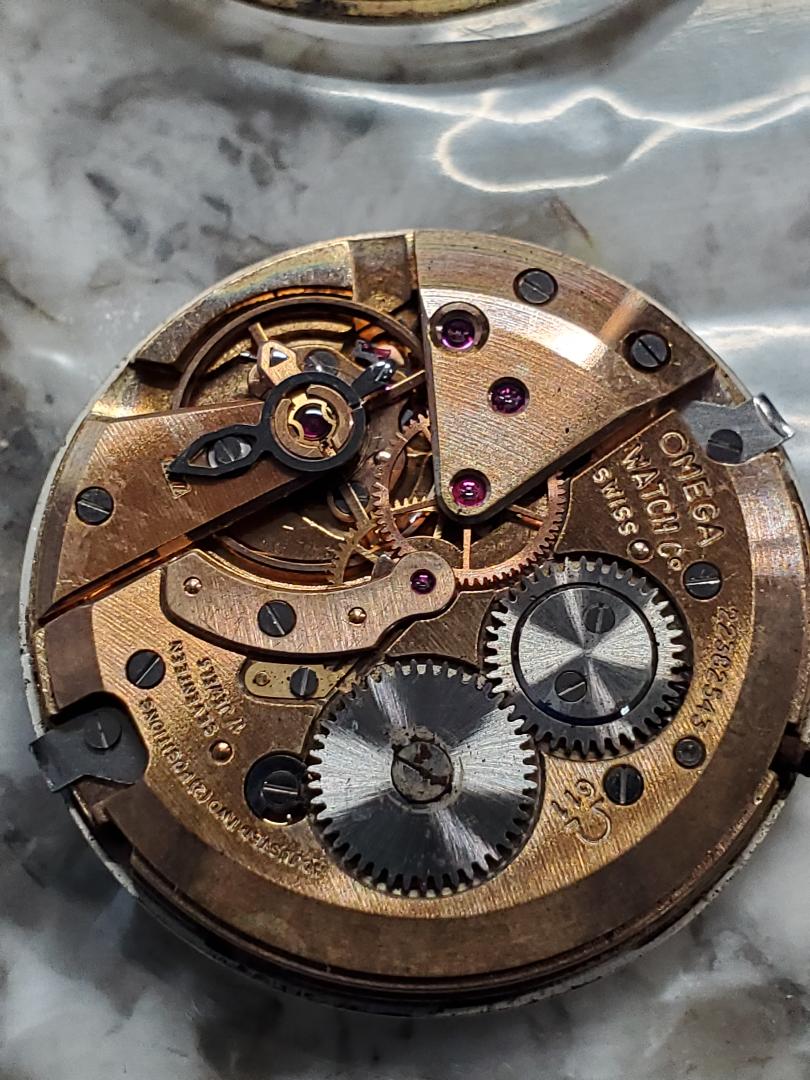

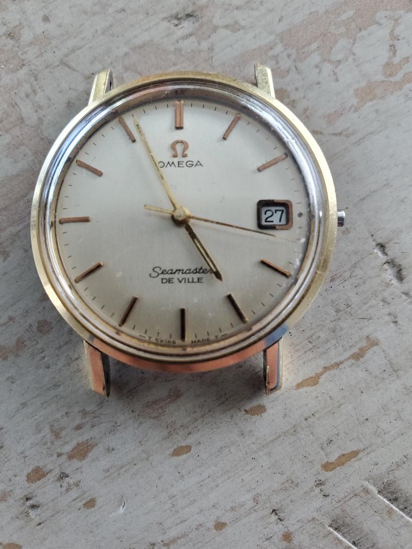

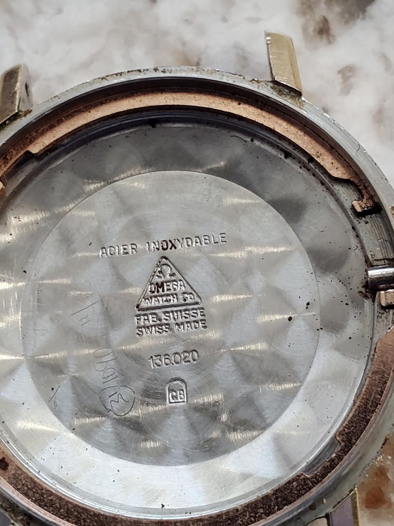

I am new to the board and I am not a big watch person. I came across my 92 year old fathers old Omega watch. He bought it in the 60s but the crown is missing and I think that happened not long after he acquired it. So there it sat in a box for all these years. I decided to see about getting it to work mostly for a keepsake and to wear occasionally. I also think its a handsome looking piece.

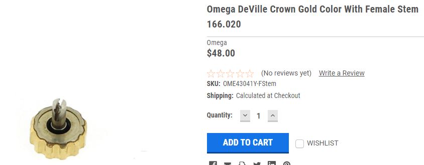

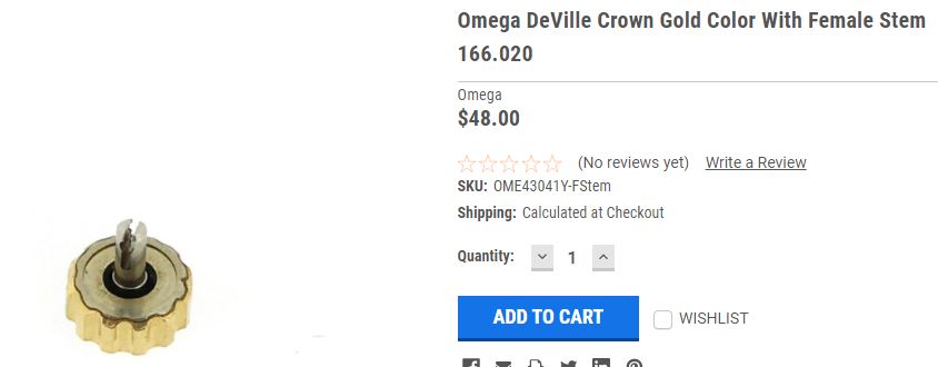

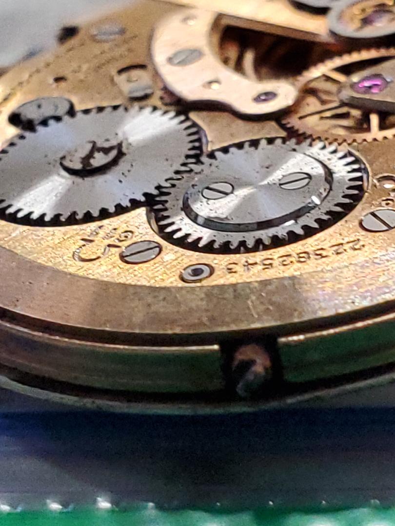

I decided to try and replace the crown and figured it would be easy enough. However, I am having a very hard time because I'm not very savvy with watches. I did open the case and the model is 136.020 and the the caliber is 611. Though I cannot locate the exact model crown, I think there may be other models advertised that may fit(see photo). From what I gather, the crown should have a female stem. If you look at my images, it looks like there is a male stem? I think I'm in the right place from all the very knowledgeable discussions I have read in this forum.

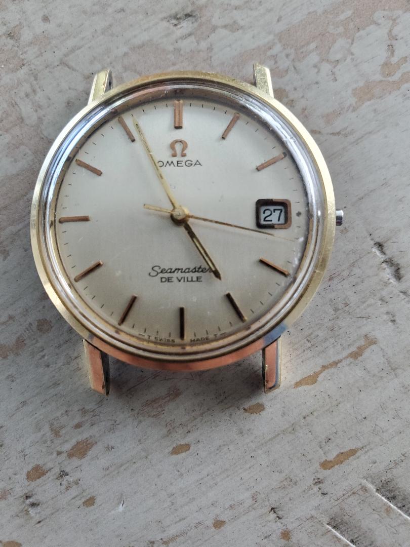

Very nice watch but it certainly looks dirty. For sure, the lubricants are long gone.
I’d say it wants a full service from a qualified watchmaker. Solve the crown at the same time.

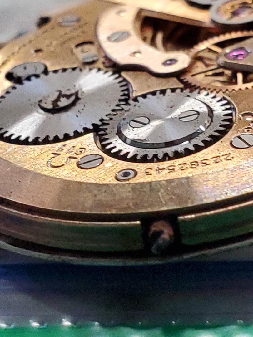

The rusty stem sticking out of the movement likely contributed to the loss of the original crown.

Any new crown is gold plated as opposed to your gold filled case. Not a perfect match, but not much you can do except look for an original.
Email Jules Borel (Google)
State reference number of watch which is 136.020 and caliber 611
Ask for crown with female stem and also male replacement stem
If they have in stock. Order and then get the watch serviced
Also. Crystal looks damaged, so may want to order a replacement if so

I'll play ball and add what you might be missing. You need a stem, crown with female adapter, and likely a crystal (not including movement parts). Depending on who has the parts, you may easily spend $150-200 hunting for these parts yourself. All watchmakers do things differently...some watchmakers will include these parts as part of the flat cost of the service. You may unnecessary increase your bill up to 30%. The watch obviously needs to be serviced and thats indicated by the rust. There is a lot of evidence of water damage. I'd imagine the series of events went like this: father wore --> it got wet --> male stem got rusted --> crown fell off and got lost --> watch sat in a drawer until the present.
