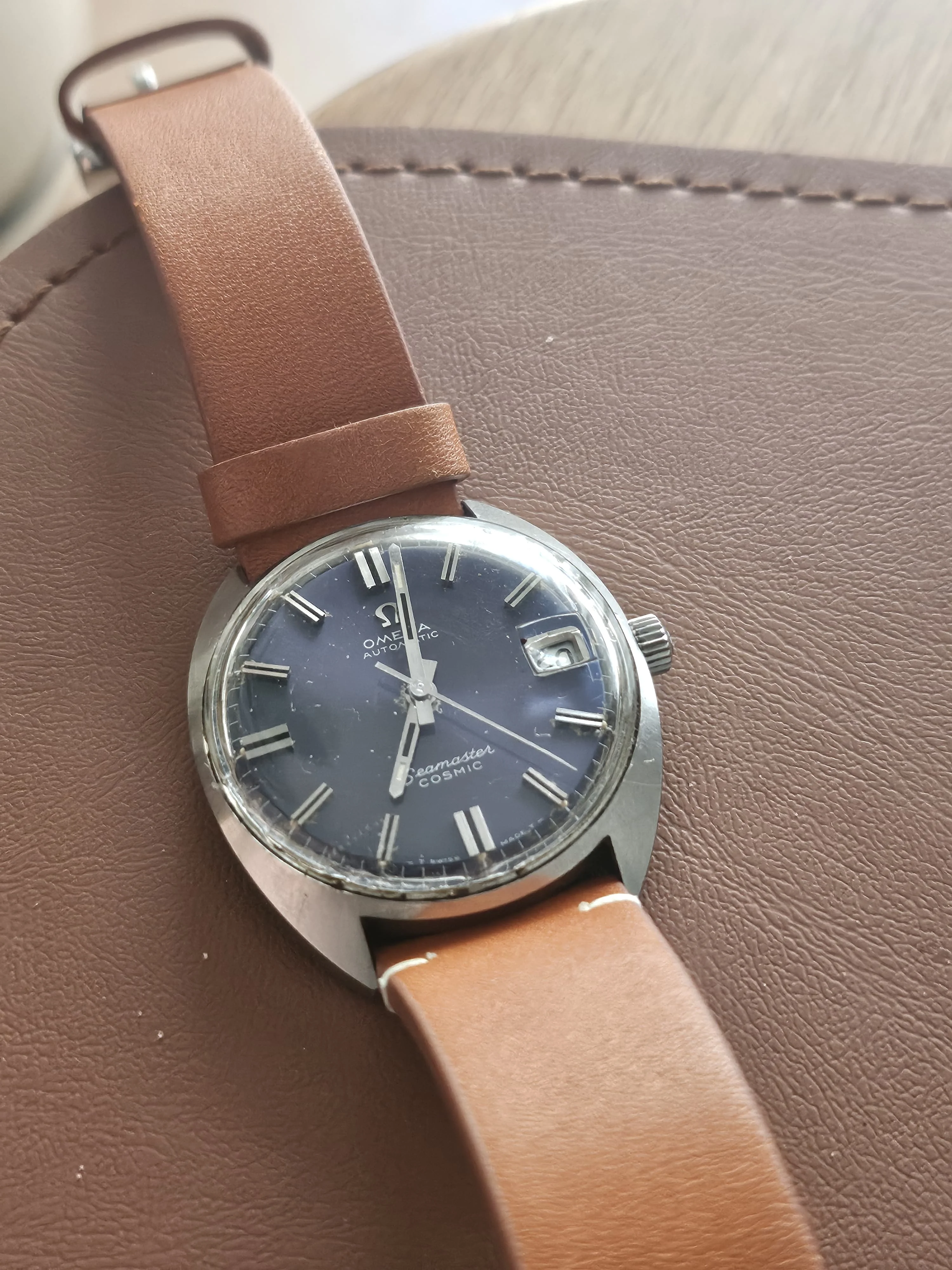

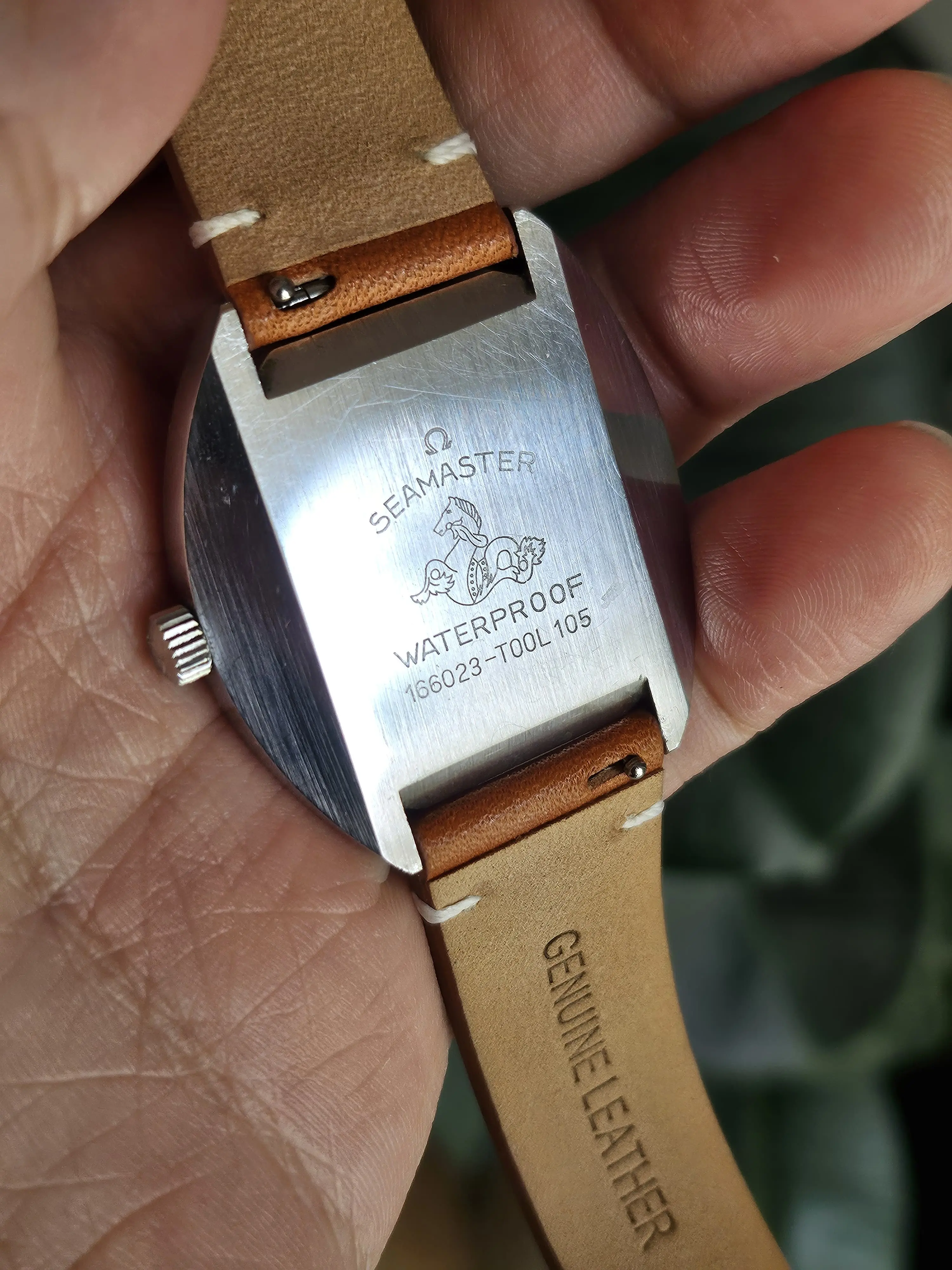

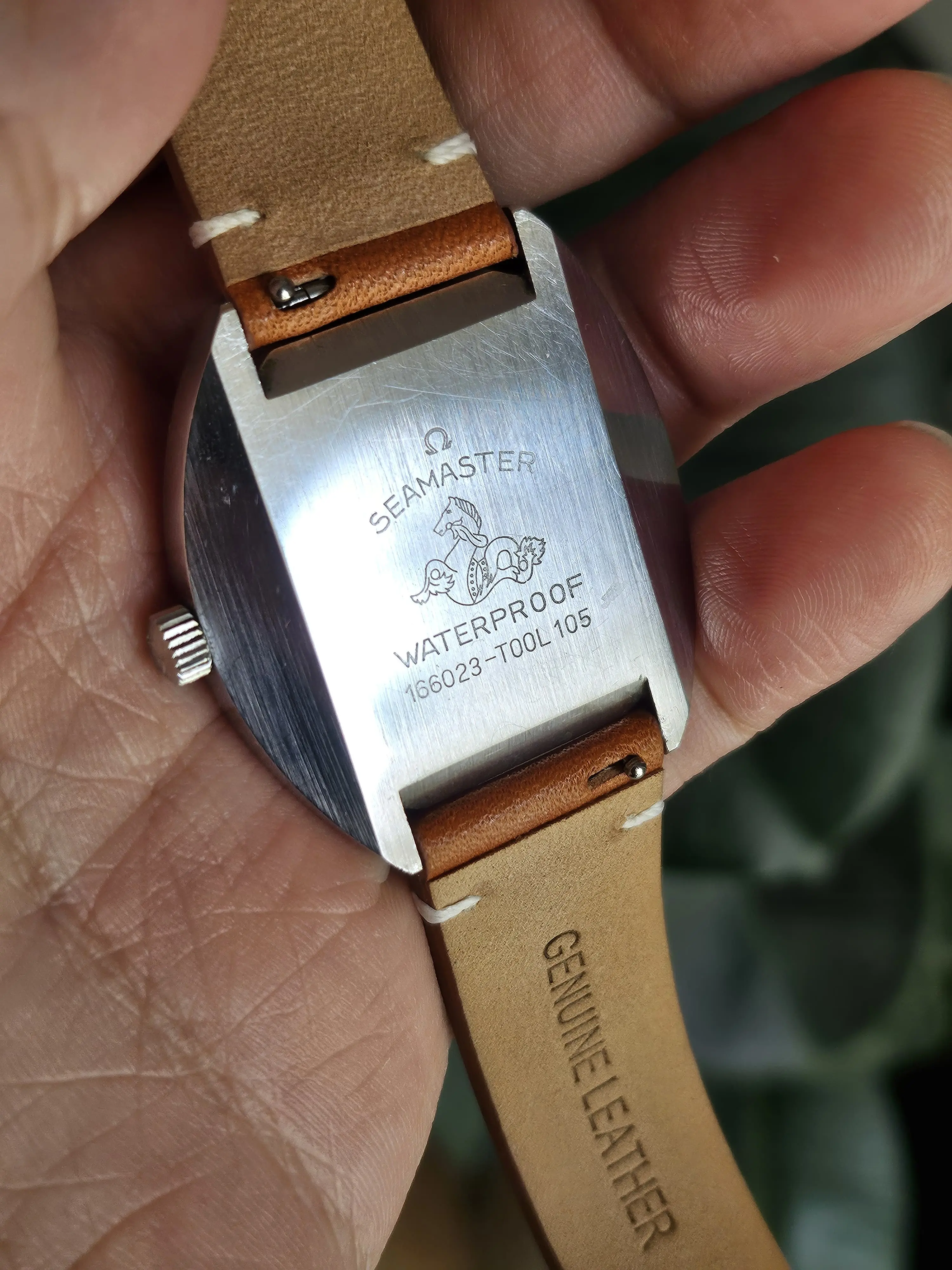

Hi, guys. Can you tell if this is a redial or an original one? The watch is a Seamaster Cosmic ref. 166.023 tool 105 cal. 565. I found matching dials on google and thought it was legut, but after some comments by fellow enthusiasts I'm in doubt.
Thanks!

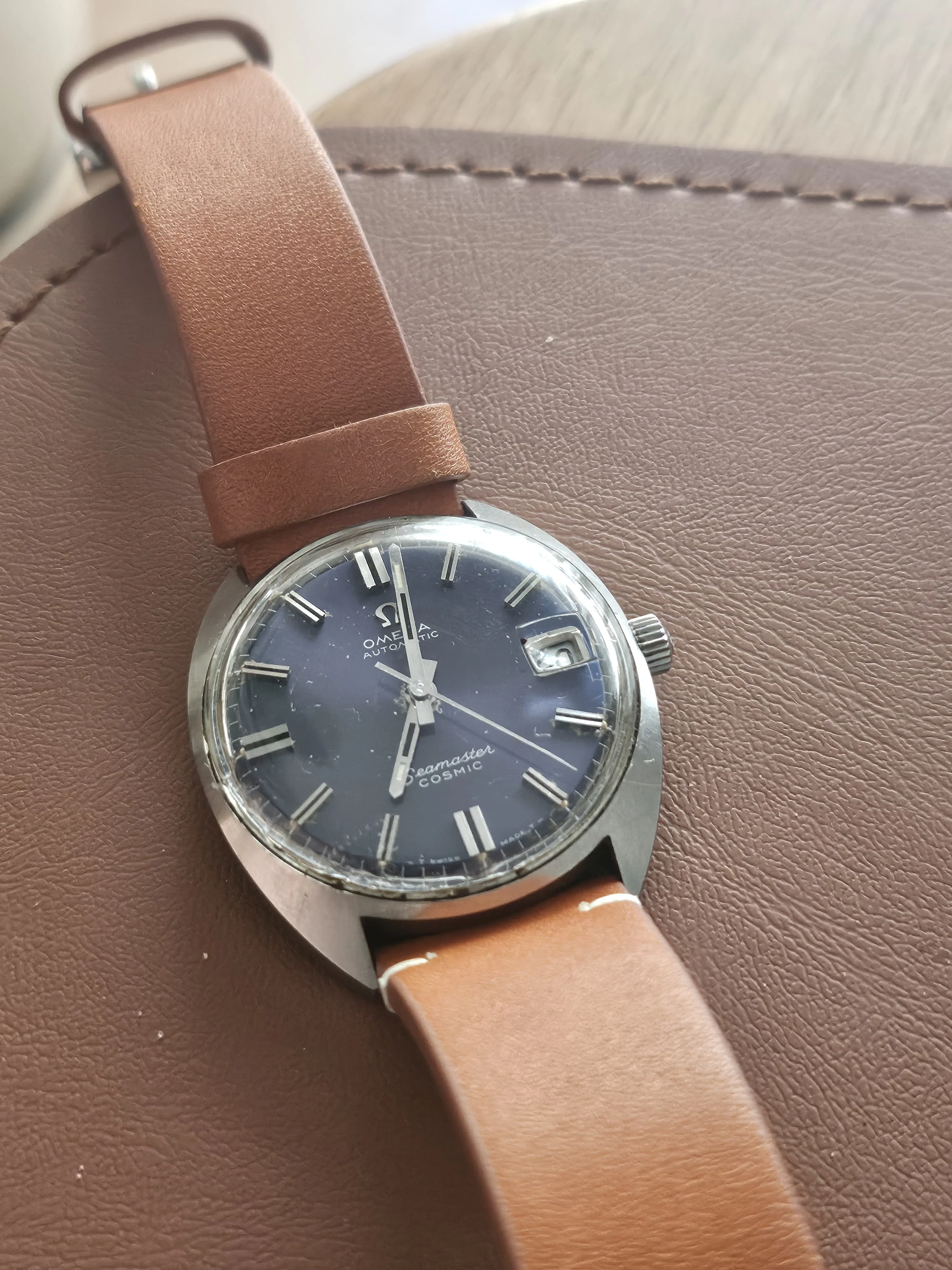

Looks original but also in average condition. Looks at the paint degradation around the edge of the dial

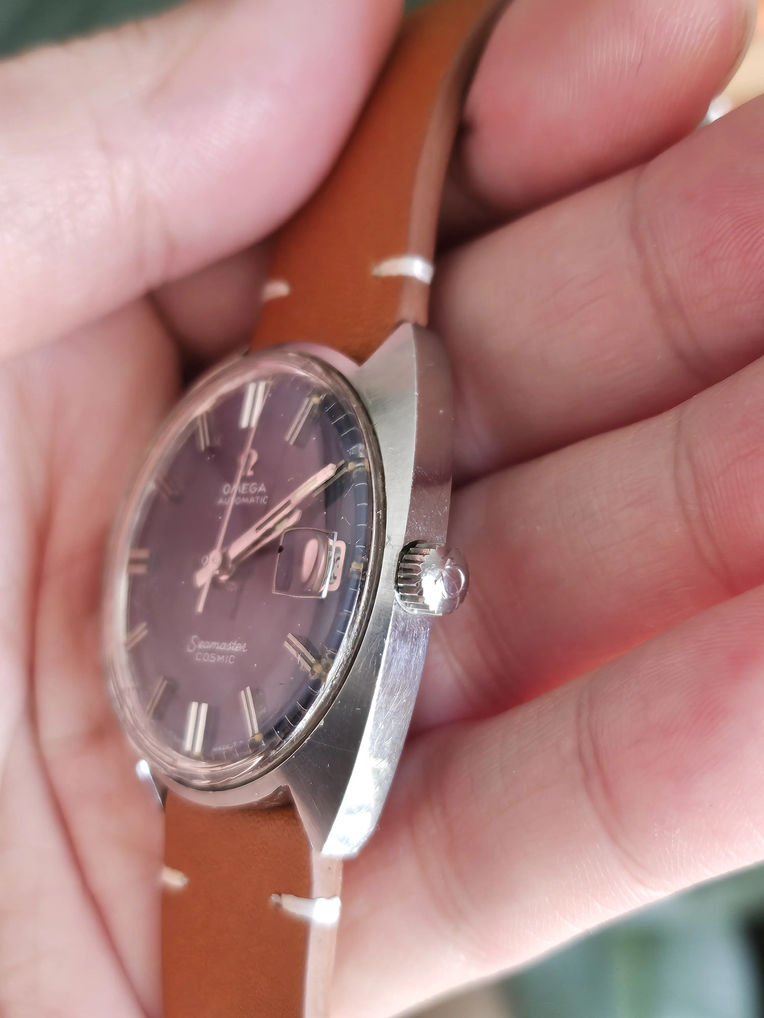

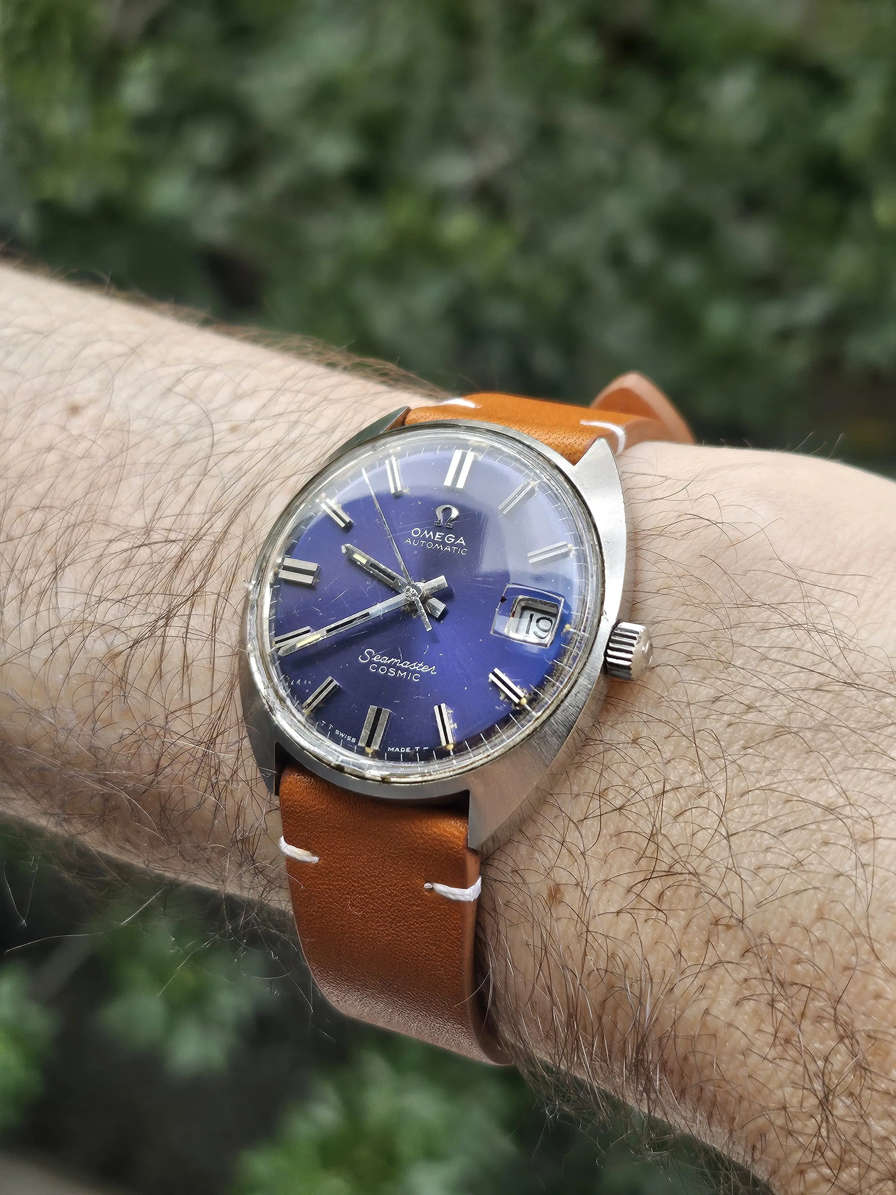

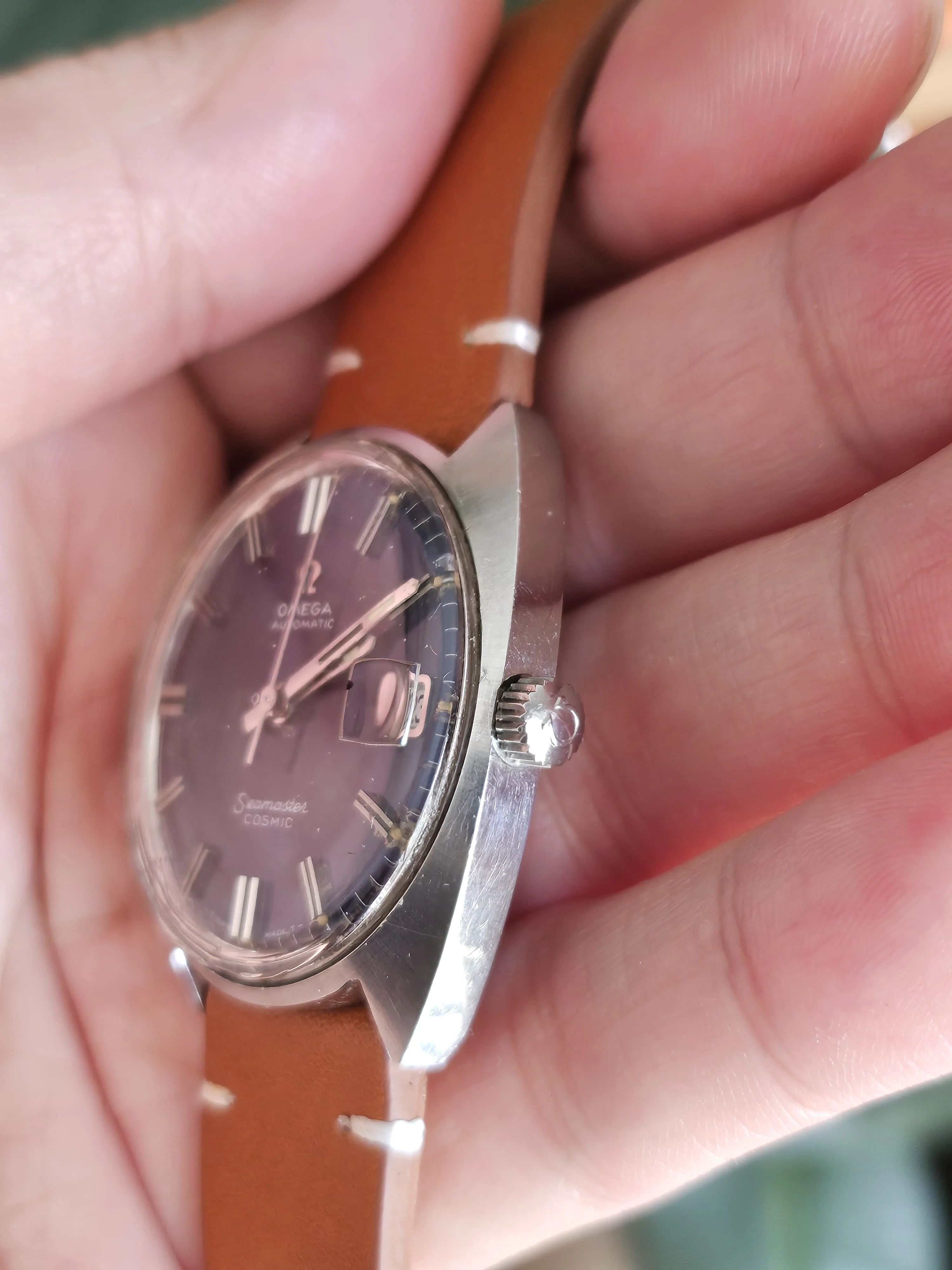

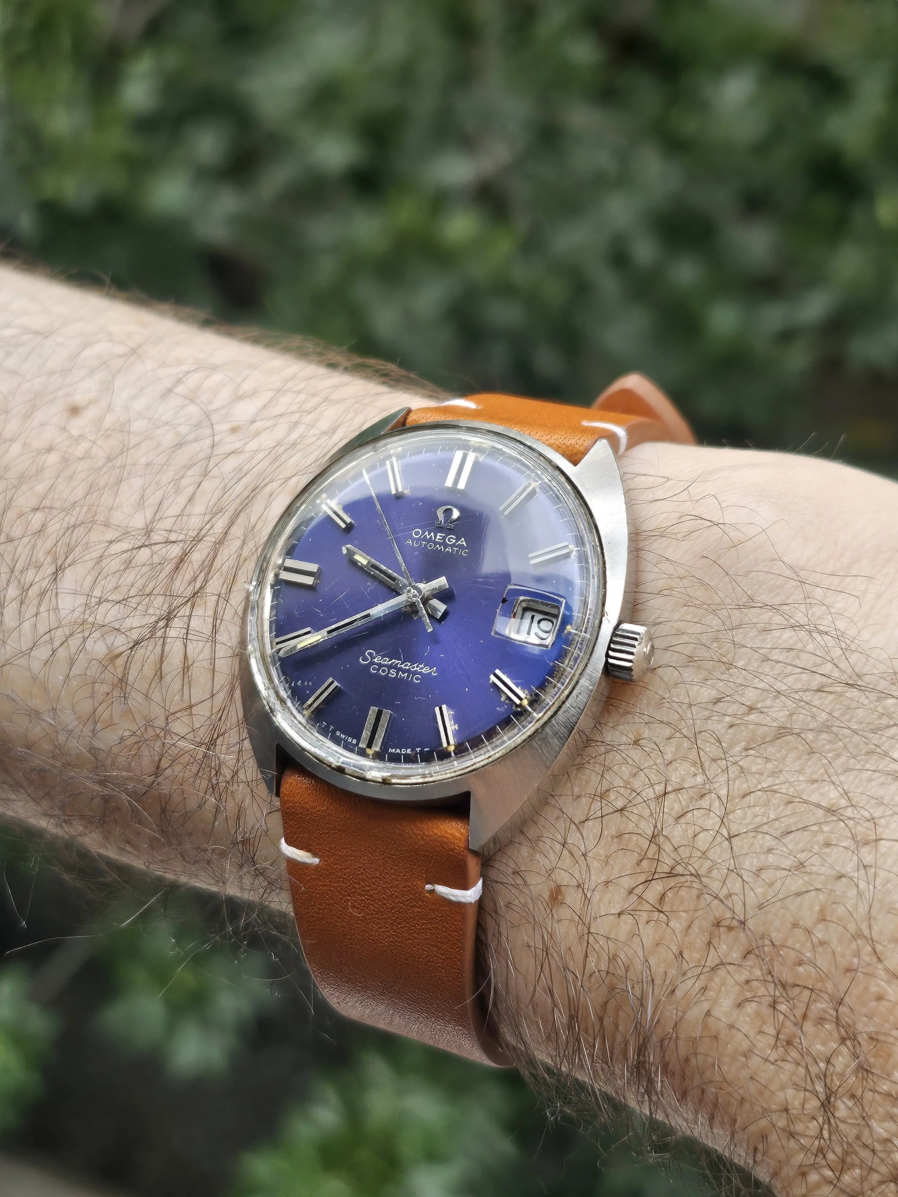

Thanks for your reply! I know it is not in best shape, but I just fell in love with the dial the way it is. Already traded it with a friend, so it is mine right now. Under sunlight it turns to a lovely purple-ish and loved the case polishing too. I don't know if it is the original finishing, but if it was polished it was very well done. I'll leave some more pics down below. Extra question: since the glass is dented between 6 and 8 I'd like to replace it at some point, but I can't source the exact glass with the cyclops. Would be great help if someone knows de part number.

Wow. That violet really pops in the sunlight. Beautiful watch. Congrats👍🏻

This is directly from an older post that archer replied to.
part #063PZ5123 - GLASS PLEXI ST RING D32.94 H4.9.
Better late than never.
