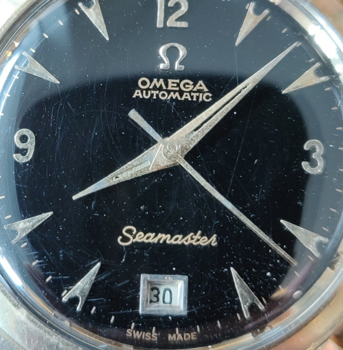

@river9 - Omega used various fonts through the fifties and sixties and I suspect that not every owner would be too worried about the exact font when a dial company redid a dial. I put a few here, but there are others:
https://omegaforums.net/threads/need-help-with-value-of-1955-seamaster.69789/#post-878292
Your watch looks to have a sixties font which wouldn't be correct for a bumper cal 355. Are the hour markers exactly mid way between the ticks? If they are, then a service dial seems a possibility.

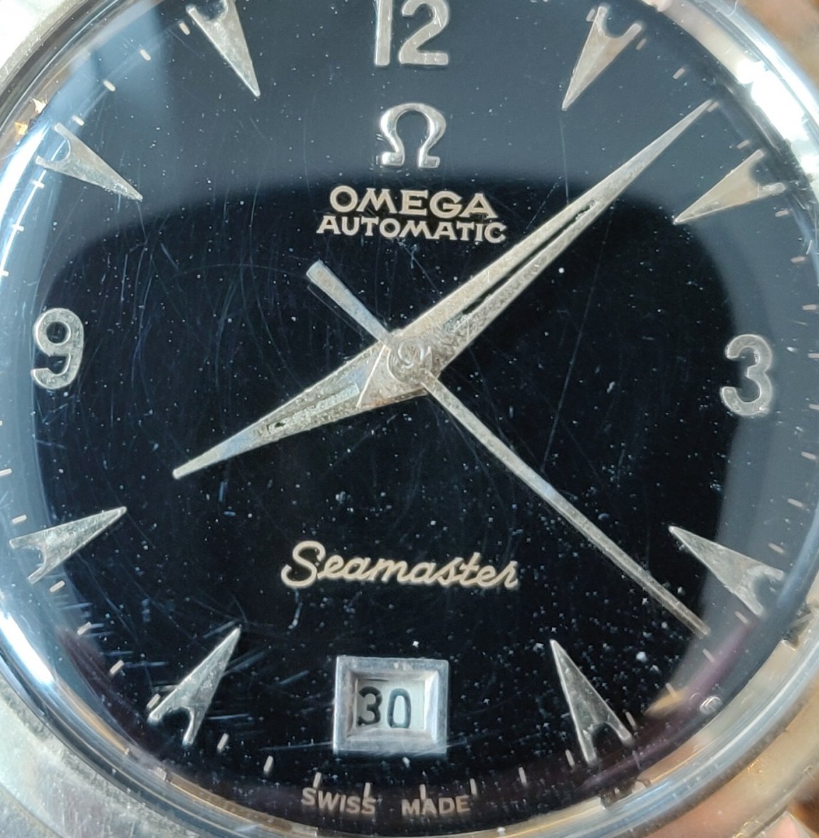

For what it’s worth, I do not believe this to be a service dial. There are too many small issues. The one that hasn’t been discussed yet but that jumped out to me straight away are the elongated hash marks are 3/6/9/12. Omega typically thickened the hash marks here, not elongated them.

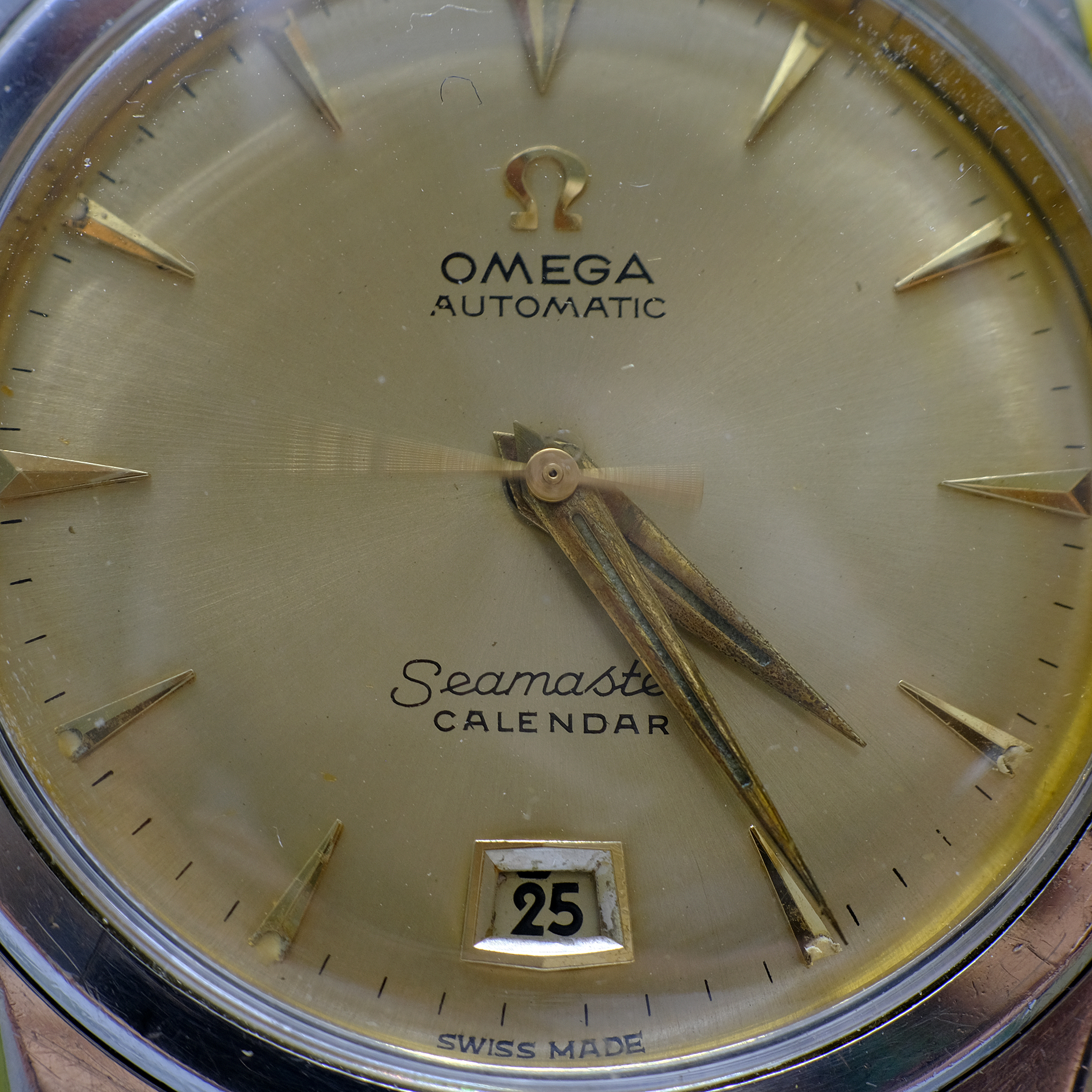

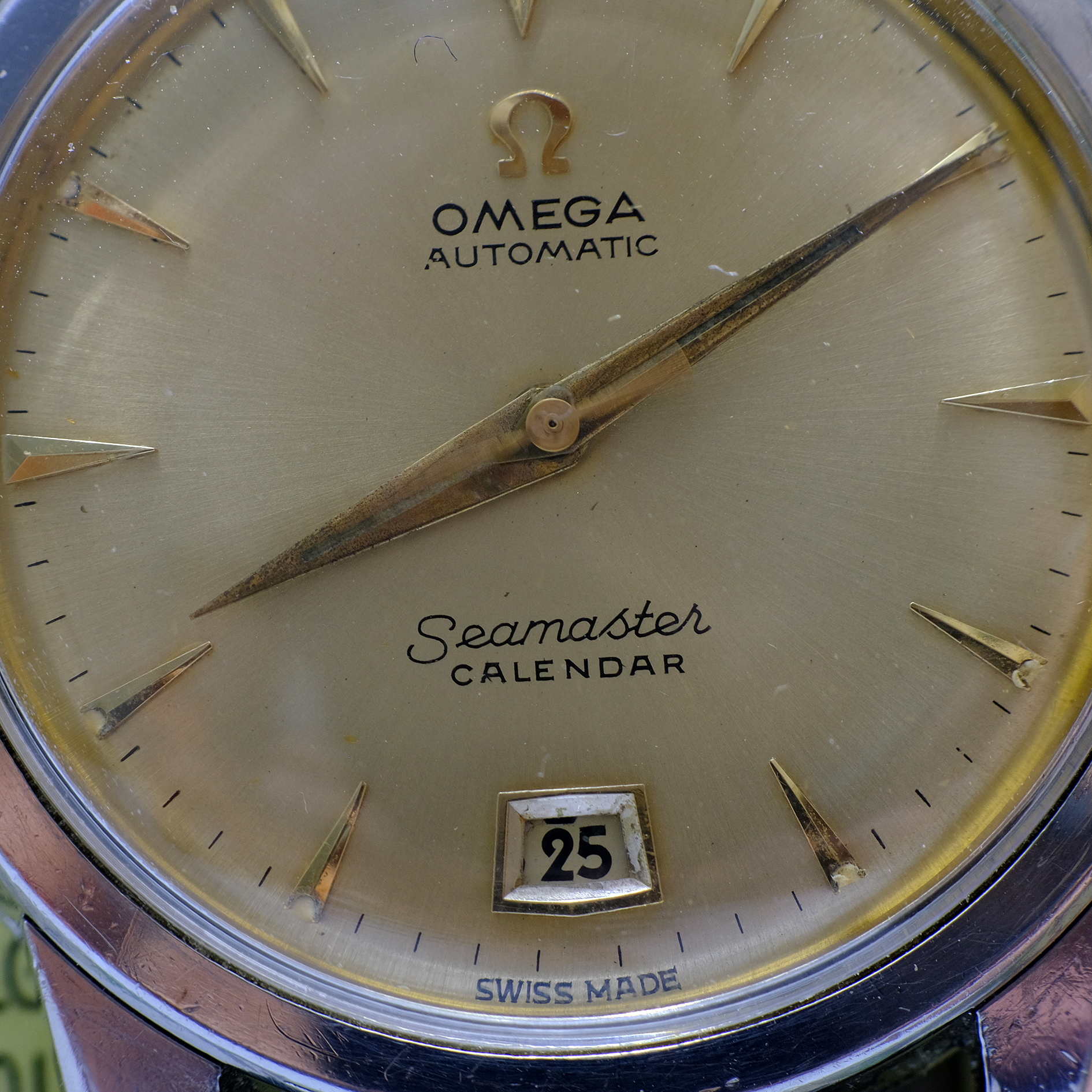

Thank you for reply.
I will try to make some more dial macros of my Seamaster cal 355 bumper with ref 2757-4-SC. I have asked in another thread about that dial. https://omegaforums.net/threads/omega-dial-font-script-questions.140251/
There are some closeup photos of the dial (will try to recover original pic or even better take some more to illustrate my question)
Sorry I dont understand. Did you mean my Seamaseter or it was about the black dialed Seamaster already sold on Vietnamese watch forum, the one I talked about at the begining of this entry?
I was referring to the black dial one.

they paint everything with same brush over there. I think.
Too thick brush perhaps? ... Still wonder why those "artists" didn't think about choosing correct "S" shape when they redialed ::facepalm1::
