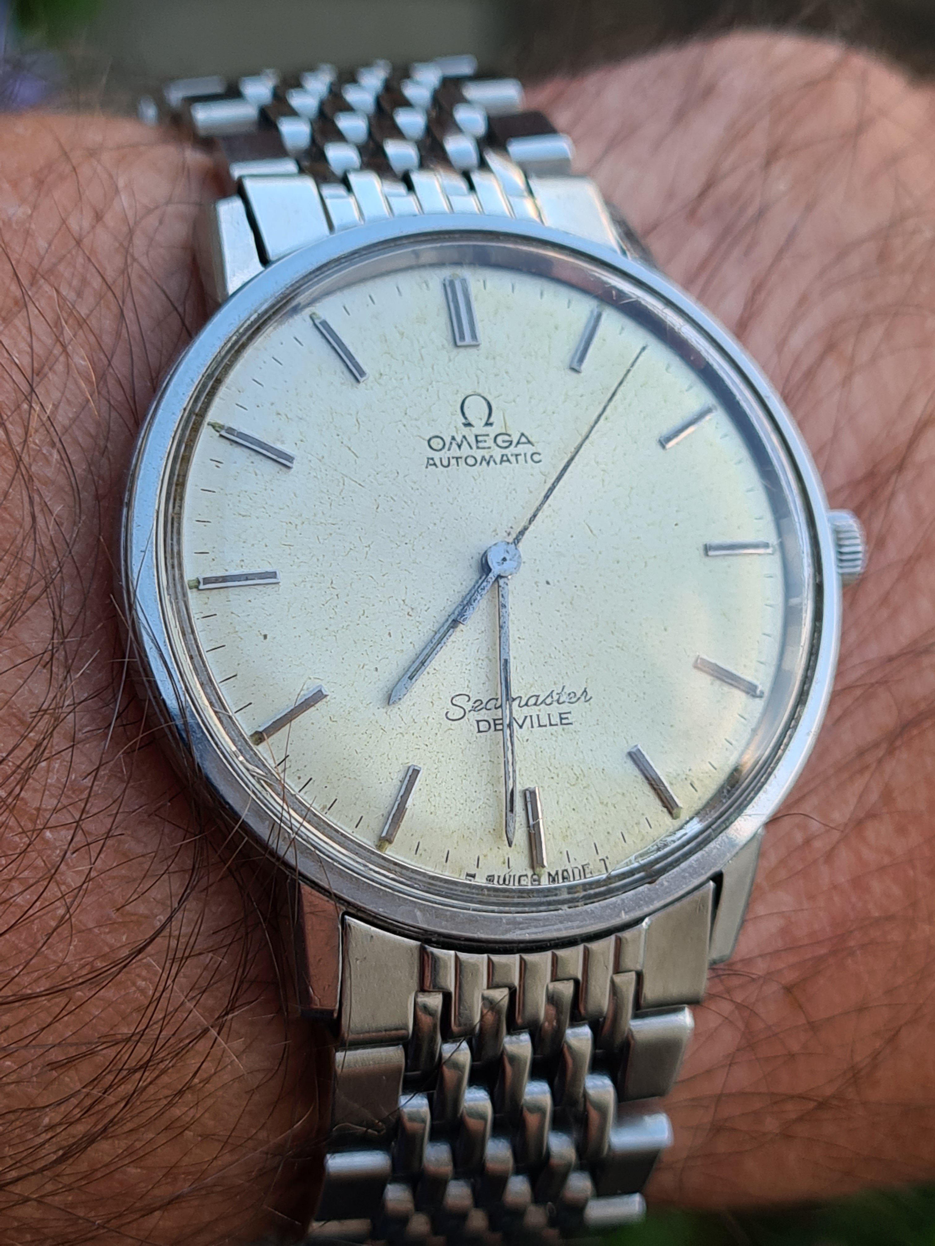

I would also like to source an Omega crystal for my Dad's 165.007 Calibre 711(thank you to @X350 XJR for identifying the watch), and send both watches to be done.
Can anyone advise the part number, or where I can look this up?
Photo of Dad's watch today:

Here’s a link to the crown/glass/gasket list. Looks like a PZ 5024.
https://omegaforums.net/threads/crown-glass-gasket-list.81619/

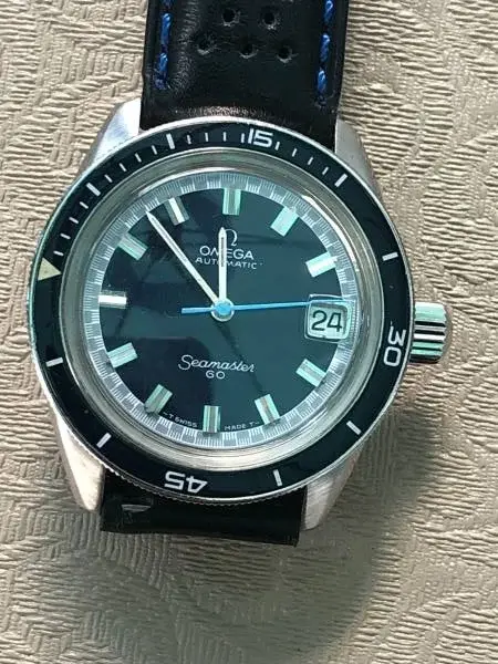

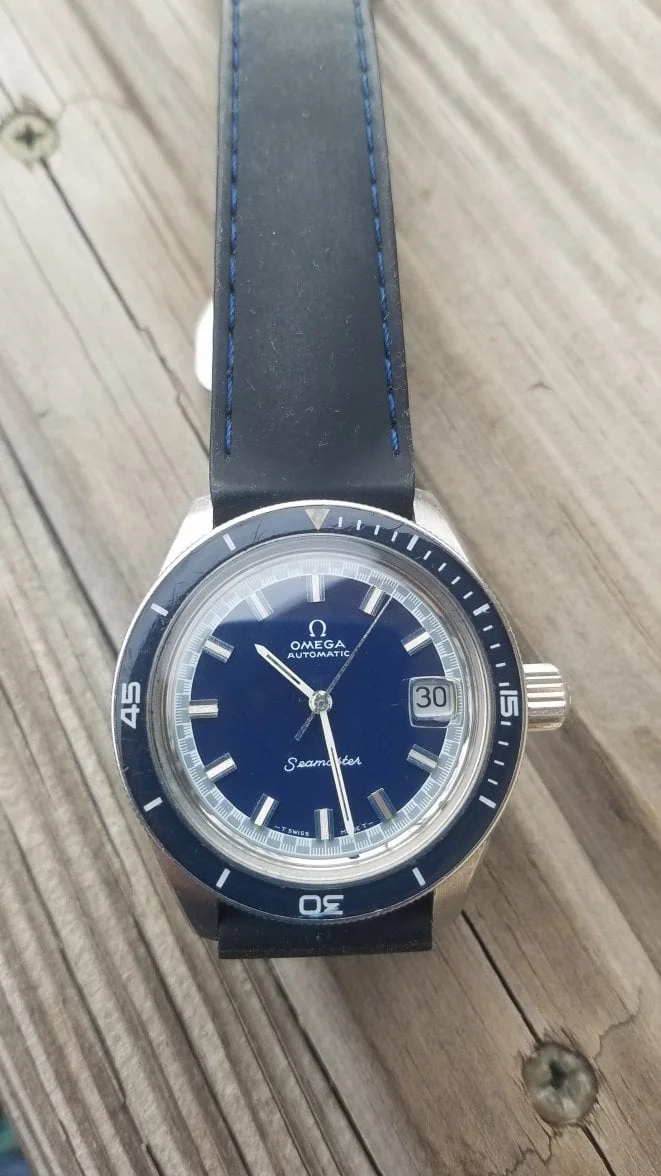

Have seen 166.062 with the loupe over the date as shown on the attached pictures, would the crystal then be PZ5155L ?
